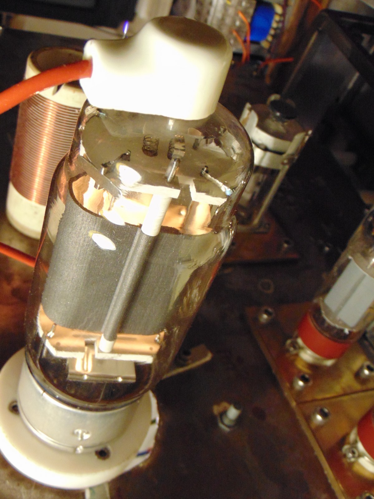

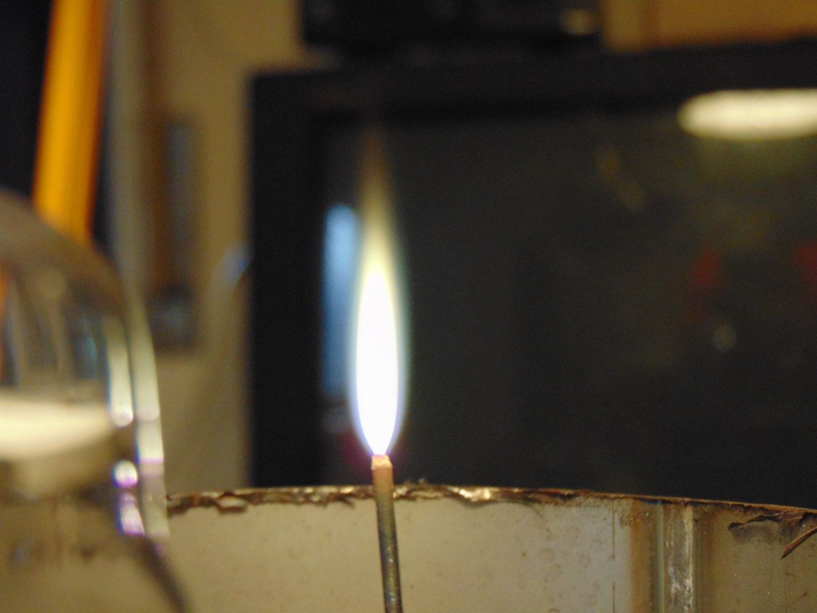

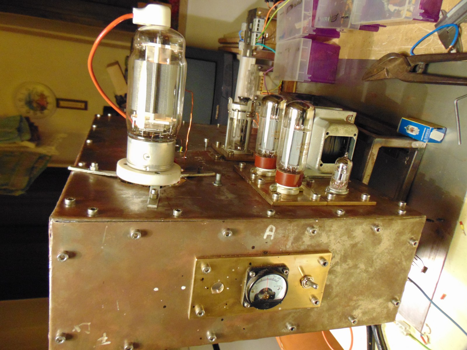

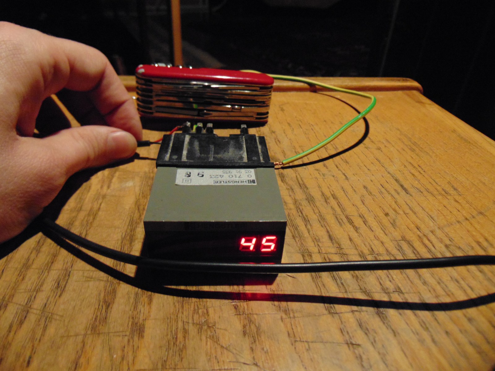

Hi all!
I'm back!

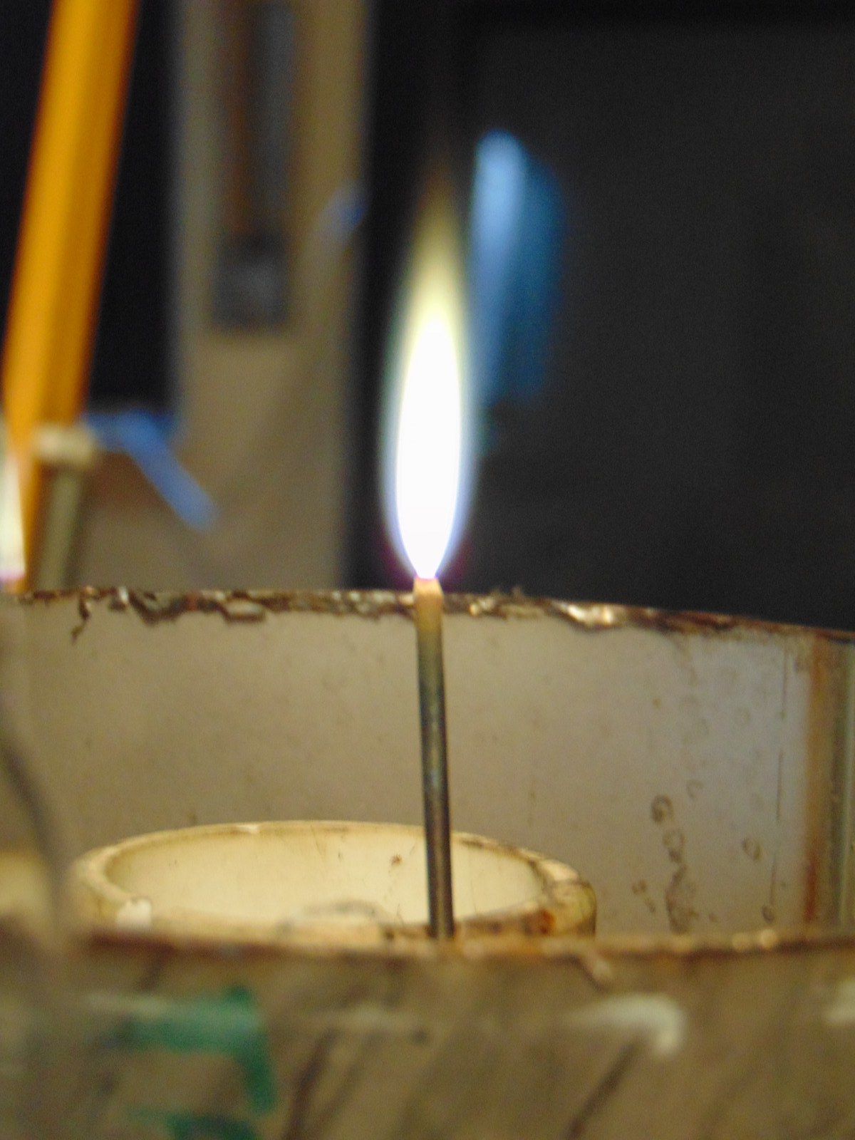

I'm trying to do an experiment with old 813 tube.
Few words about, old circuit tuned for last plasma tweeter is completely out of focus, the circuit is running, but very bad. Flame is tiny, and the circuit draws few current, but it's normal. Volume is not so high, but the quality of sound at first listening is always impressive like my last prototype. A very good thing: There are no troubles about noise.
Attachment 20041 Attachment 20042 Attachment 20043
Attachment 20044 Attachment 20045

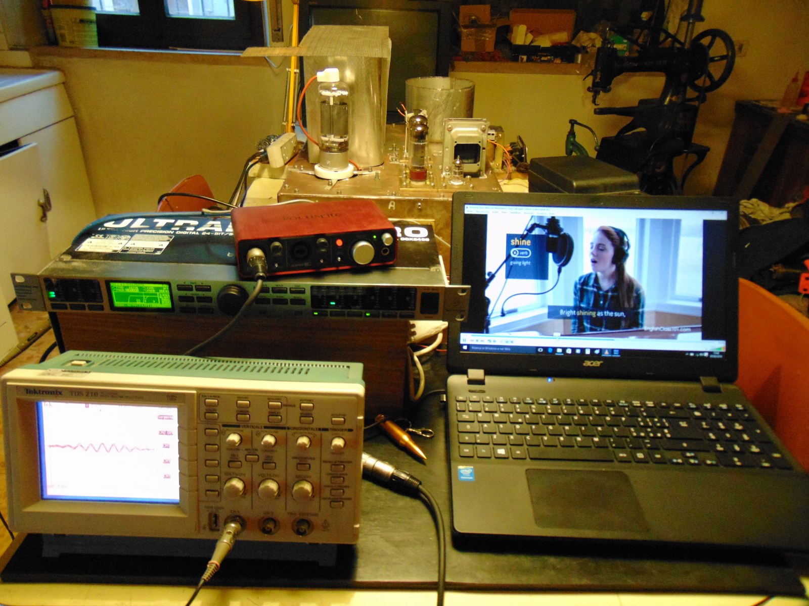

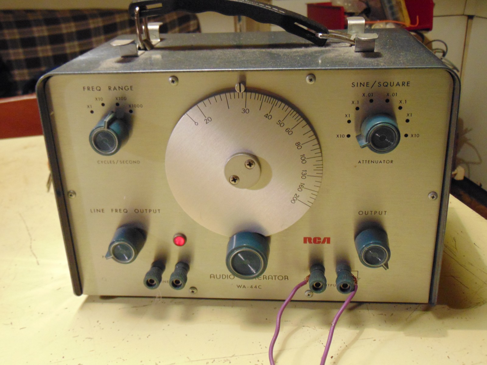

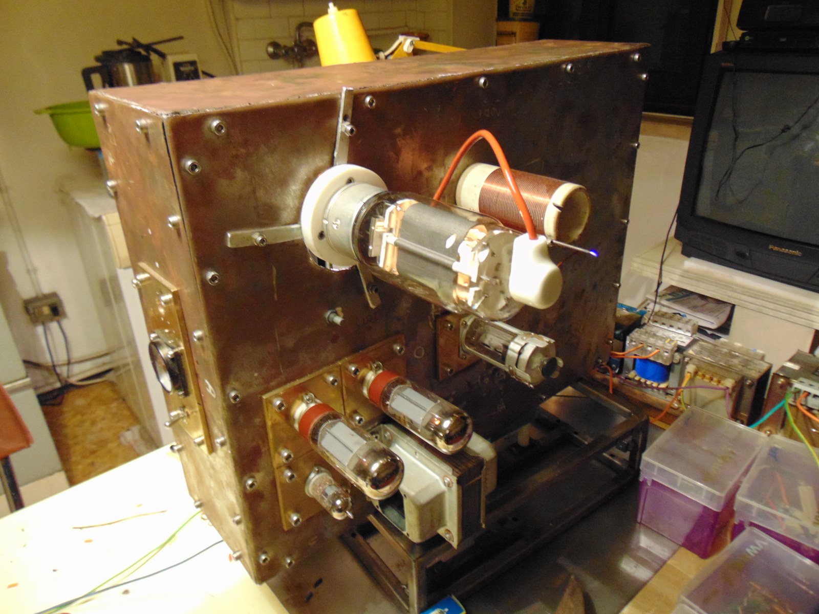

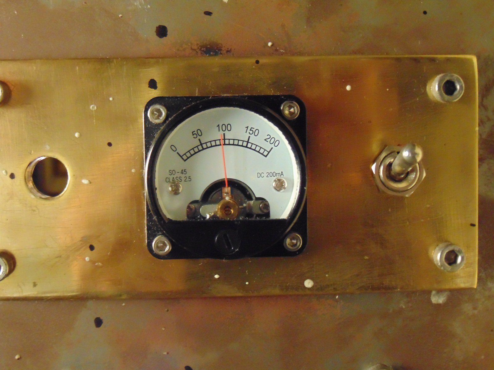

4 Attachment(s)
Hi all
New update, I changed lot of parts of circuit, in order to have more efficiency, spl and distortion, I'm in the right way.
Tweeter perform well from 300hz to 20khz now, lot of work to do to reach perfection!
I will build soon a coiler, I need to build special transformers for audio gear.

:clapping: I applaud your tenacity with this project and glad you are still pursuing it!
PJ
Thank you PJ!
That's a long project unluckily :(
It's not like a normal amplifier, more or less a matter of a couple of resistor to achive the result, this plasma is really a beast.
I'm glad there are encouraging results, I'm a bit scared at the same time about the horn size for an ultimate version, 300hz tractrix horn is more or less half meter wide not possibile to made with my lathe, I'll have to make composite or cast... difficult choices!

Yep R&D takes time and some head scratching. Seems to me on the Horn you could size it for 1/4-1/2 wave and get reasonable results??
