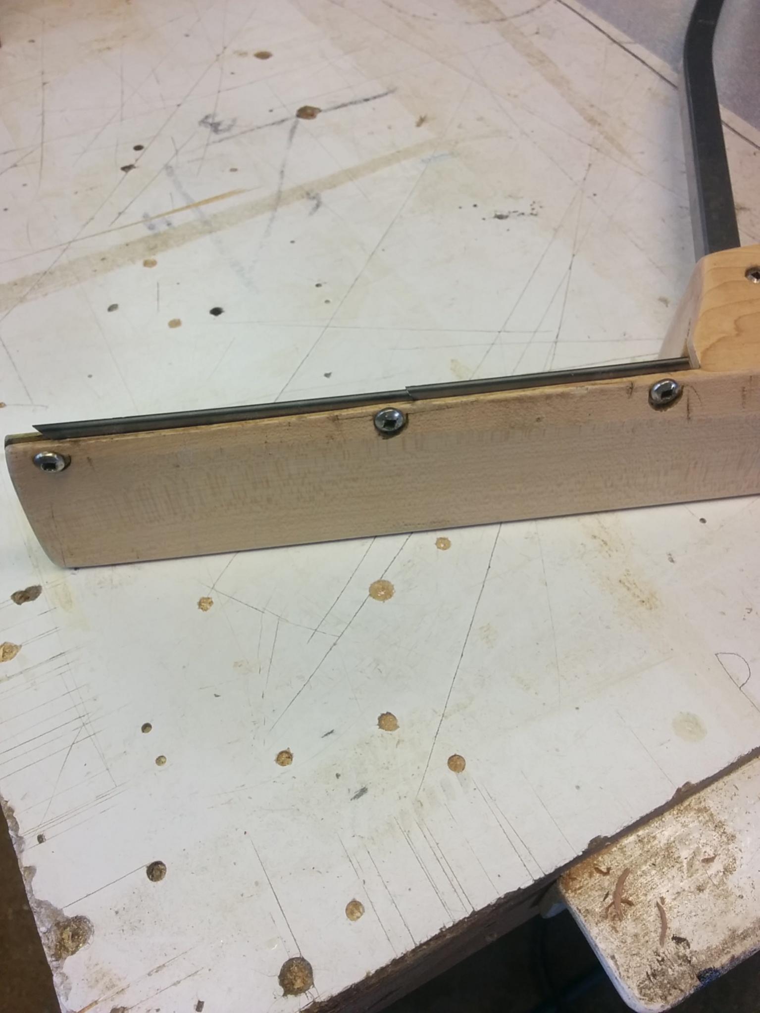

    Hi Supercrowe,
    Great idea! Have you got a closeup photo of the head showing the attachment of the utility knife blades? Post the pic here and I'll get the tool added to the site.
    Ken
    Jan 2014
    Headingley, Manitoba. It is just on the outside of Winnipeg and has a population of 3500.
    9
    Thanked 7 Times in 3 Posts
    Supercrowe's Tools
    Here are some pictures. I made a couple of versions. One way double sided, ambidextrous. The other one sided, which I like better. It offers more control, especially when you are swinging this around. But, it's no more dangerous than a gas weed whacker at full song with a metal blade.
    Note the use of carbide blades and the use of rareGRASS WHIP THAT USES REPLACEABLE UTILTY KNIFE BLADES-img_20150515_190642.jpgClick image for larger version.
ID:	3706 earth magnets to hold the blades in place while you put it back together. The brass plate is threaded and that takes most of the impacts and sandwiches the blades together against the rock hard sugar maple body of the tool.

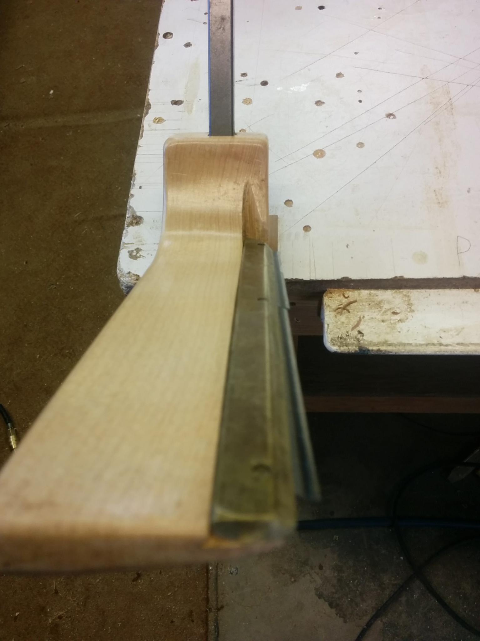

    Here is another picture of the home made grass whip.
