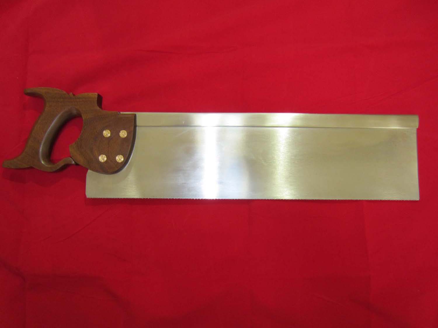

    This is a miter saw I did for a local contractor with reversed teeth so that it cuts on the pull stroke.

    Great looking miter saw. Great job as always, Rob.
    Al
