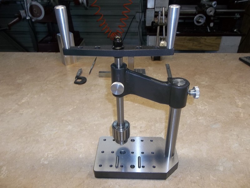

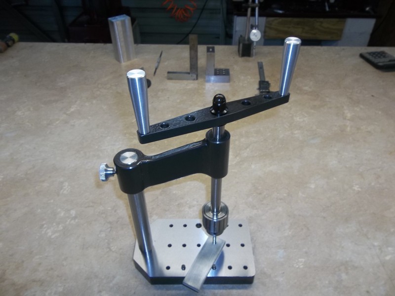

    I built this little tapper for the sole purpose of tapping a hole at 90 deg. Everyone knows how easy it is to tap a hole by eye and be a little out of perpendicular, I don't do a lot of hand tapping but this will take the guess work out , Most of the holes I tap (about 90%) are drilled and tapped in the mill or lathe.
    I put a 0-3/8" Jacobs chuck on the spindle to accommodate taps up to 3/8" but I seriously doubt I tap anything larger than a #10, In fact I built it for smaller taps specifically, You can also put a countersink in the chuck and chamfer holes, you can put reamers in as well.
    There are 3 rows of .257" holes for inserting 1/4" dowel pins to rest the work against while tapping, There is a 7/16" hole in the center for chips to exit and tap clearance and two 1/4" counter bored holes for mounting purposes.
    Click here to purchase a set of these plans http://www.homemadetools.net/forum/t...-machine-51083
    Below are some photos
    Thanks for looking and happy machining
    Doug

    Above photo shows the spindle in the yoke with the Jacobs chuck and it's locking knob, Both locking knobs have a piece of 3/16" round delrin under them to prevent scoring the shafts, The spindle was made from a piece of 5/8" O.D. 303 stainless steel
    Above photo shows the handle fully assembled and installed on the spindle, There is custom made acorn nut on top of the handle along with two custom made flat washers, one washer under the handle and one under the acorn nut, the two washers and acorn nut have been blackened

    Above photo shows the machine fully assembled with a piece of material drilled and ready for tapping resting against a dowel pin
    Above photo shows another view of the machine ready to tap

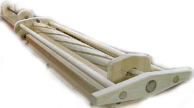

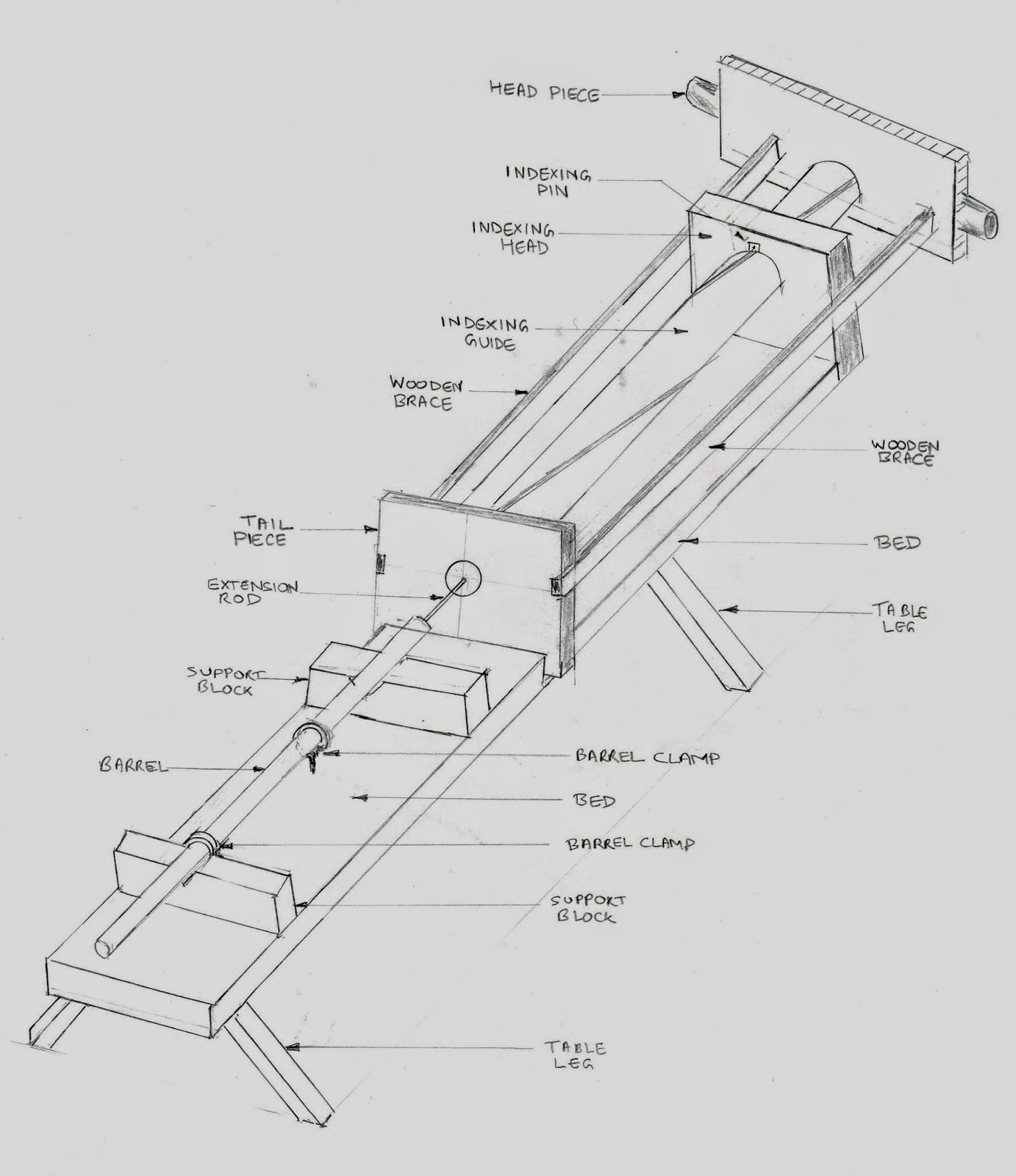

    Hand Tapping Machine-m6-open.jpgHand Tapping Machine-rifling-machine001.jpgHand Tapping Machine-ririling-buttons-bits.jpgHand Tapping Machine-ririling-maching2.jpgneed somthingm like that for my barrel reamer wana help me on my Rifiling project maybe we could come up with a new tool

    You want to make a barrel reaming tool or a rifling tool ? or both ? Anything can be made, what caliber is it ? how long is the barrel?

    got a .22 home made barrel its 1/2 od and 5/16 id x 18in long see my rifiling machine build I want to make a home made button thinking of using a spiral end mill and either pulling it through or pushing into the barrel using your set up or a modified verson I think it could work I am new at this and I figgure you would have some Ideas???
