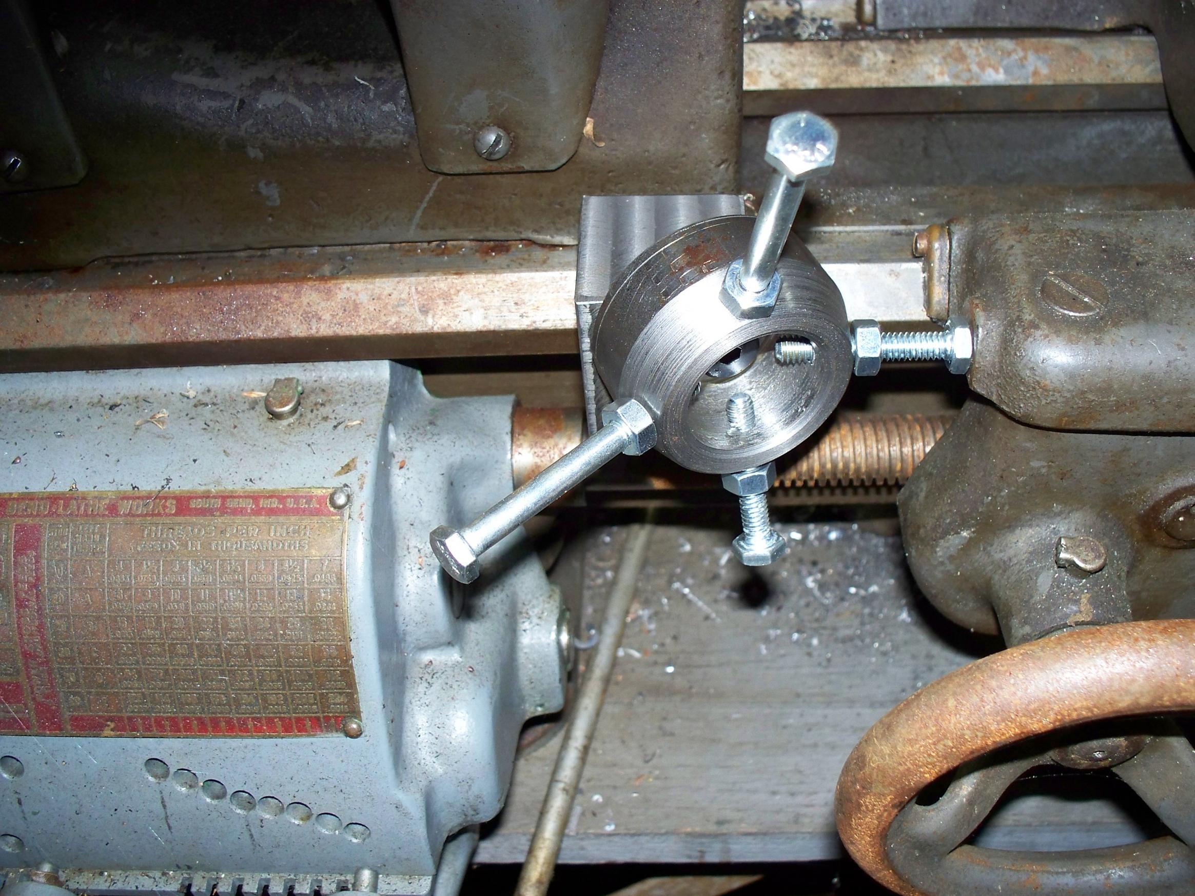

    Handy 4 position lathe carriage stop for my South Bend lathe
    I use this handy four position carriage stop when working close to the collet. The stop pins rotate at a 45 degree angle using hex bolts for stops. Each position has a ball and spring index. Works great.Handy 4 position lathe carriage stop for my South Bend lathe-south-bend-4-way-stop-001.jpg

    Very handy, I need to make something like this for my lathe!
