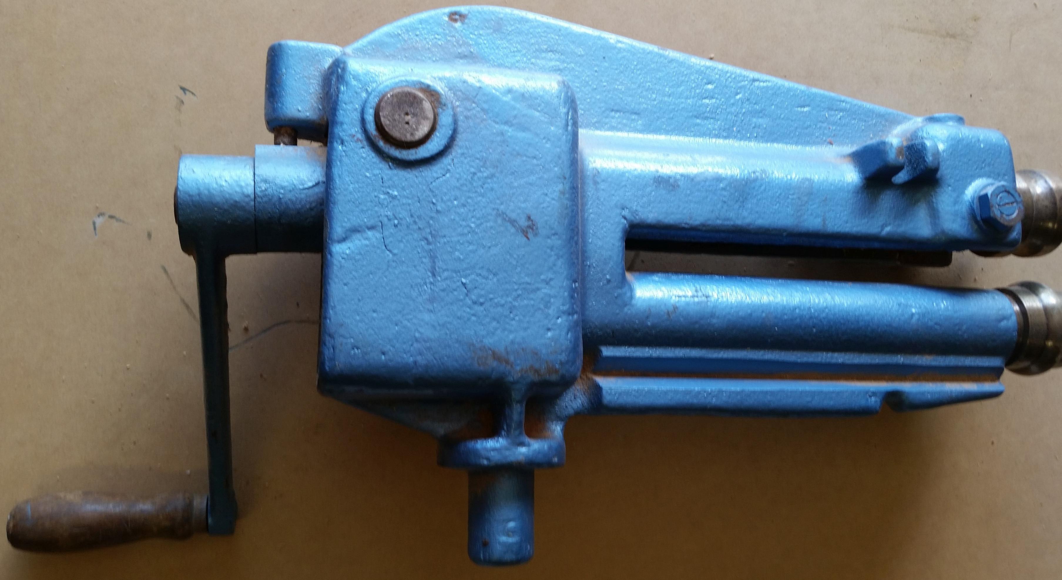

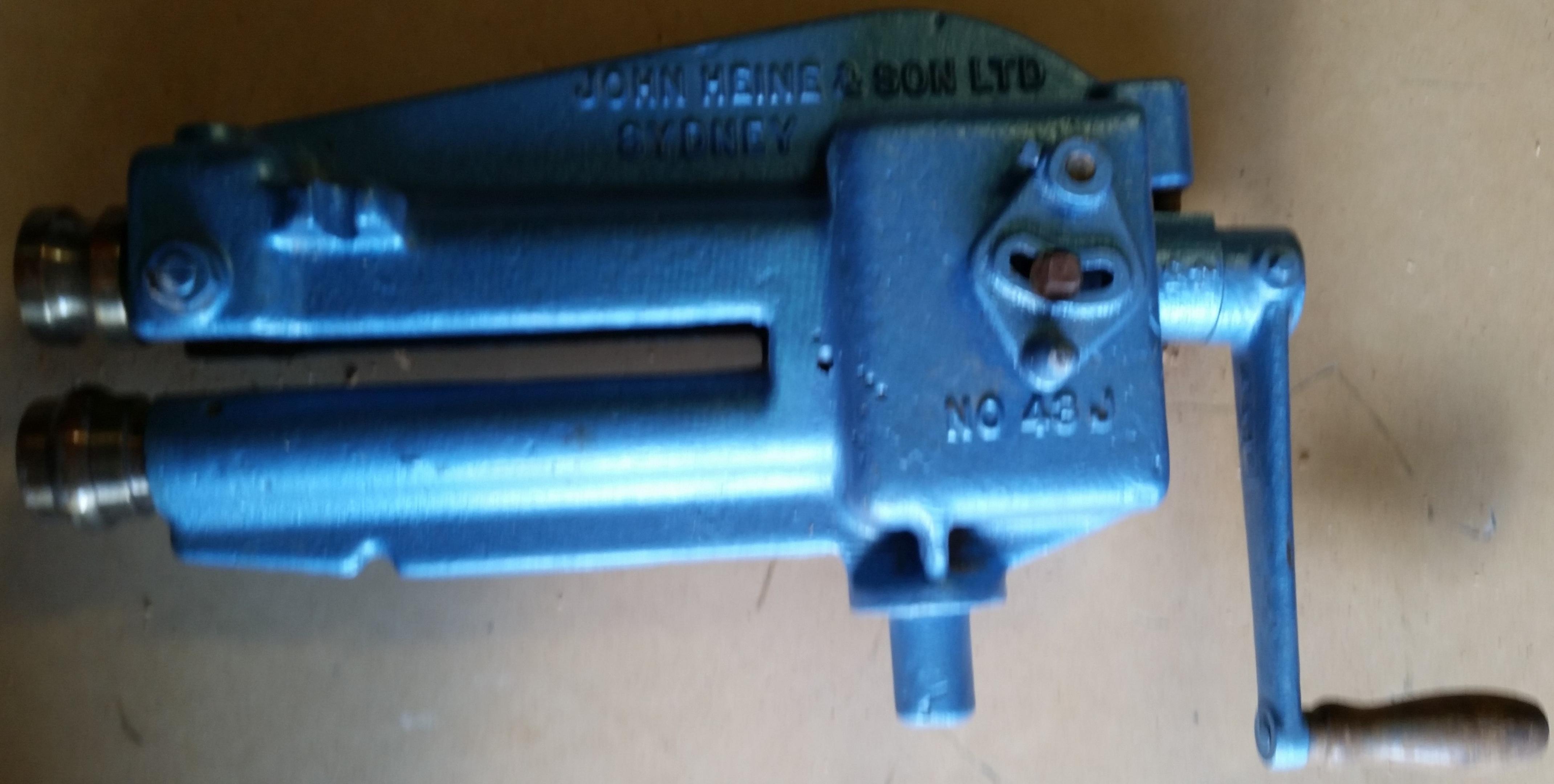

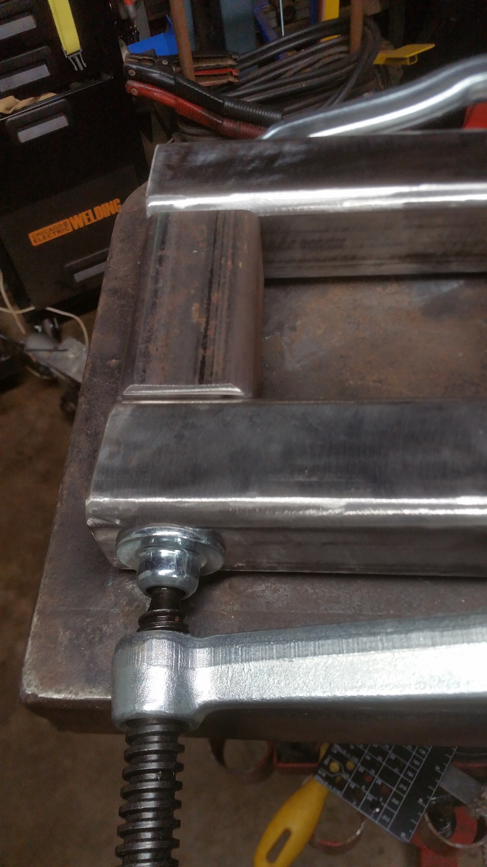

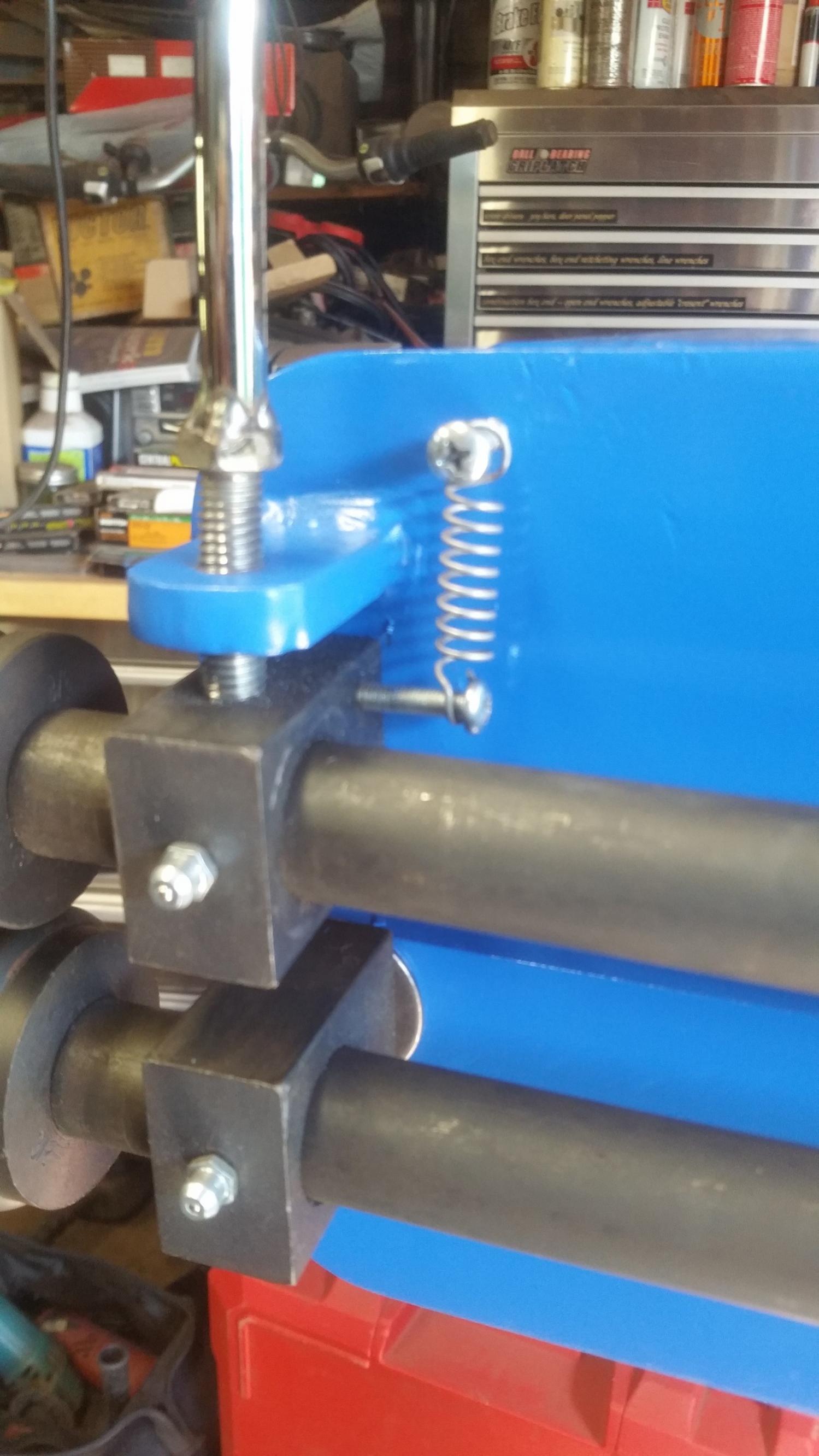

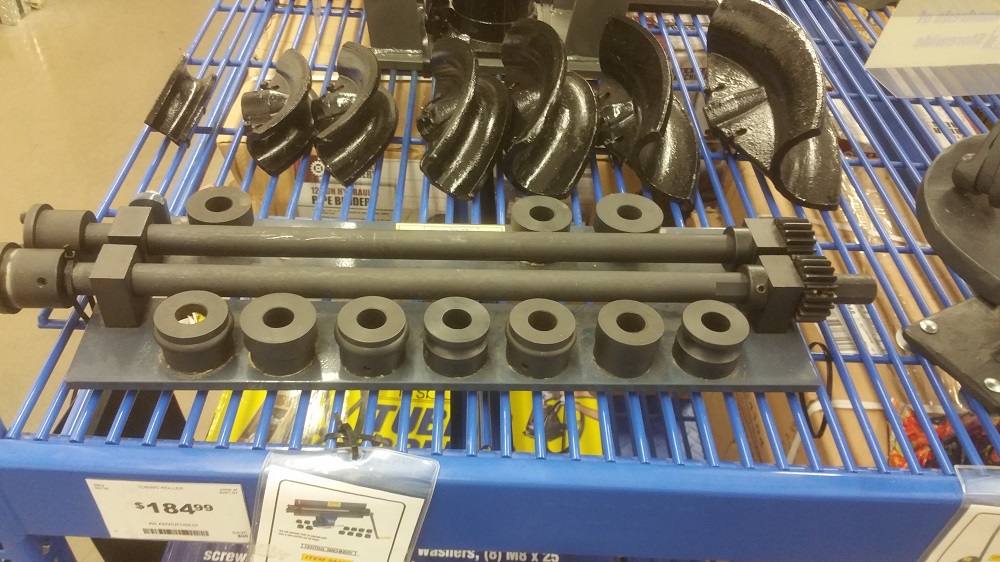

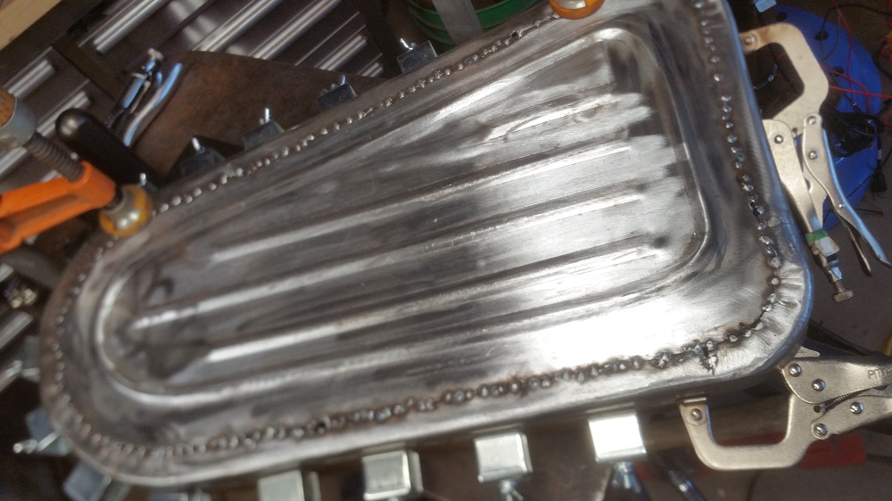

Harbor Freight bead roller upgrade
Attachment 9586Attachment 9587Attachment 9588Attachment 9589Attachment 9590Attachment 9591Attachment 9592Attachment 9593Attachment 9594Attachment 9595Attachment 9596Attachment 9597

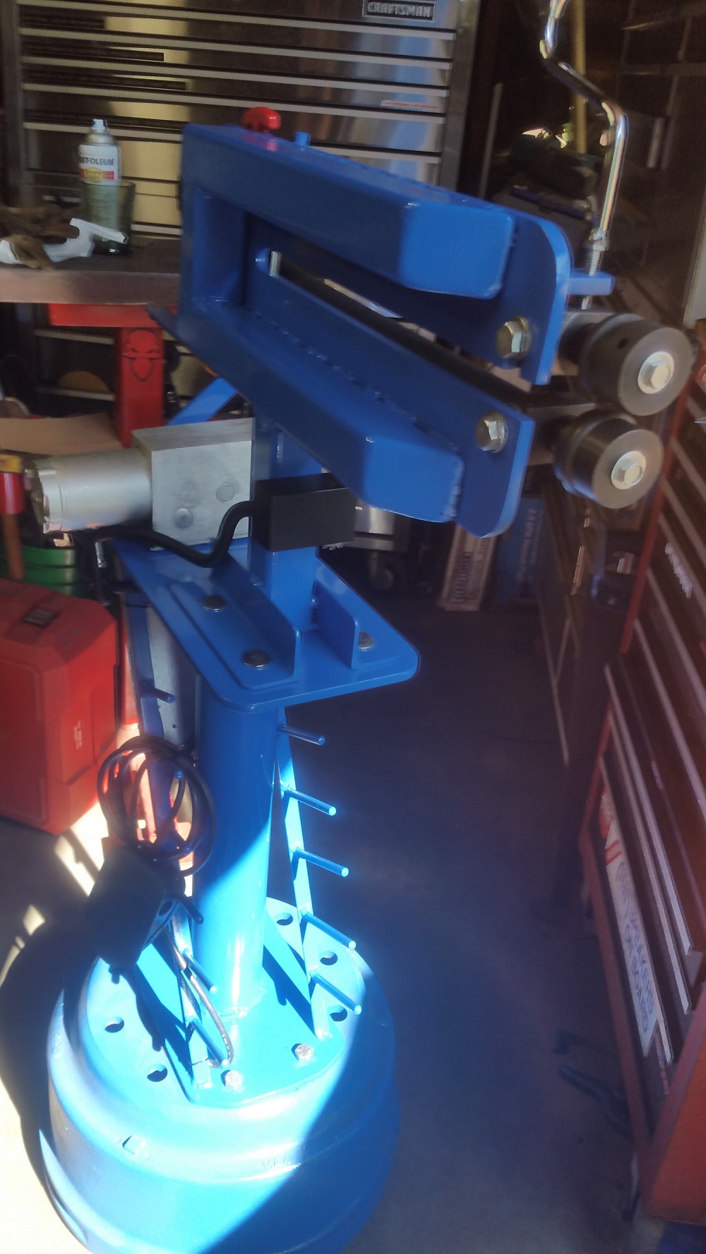

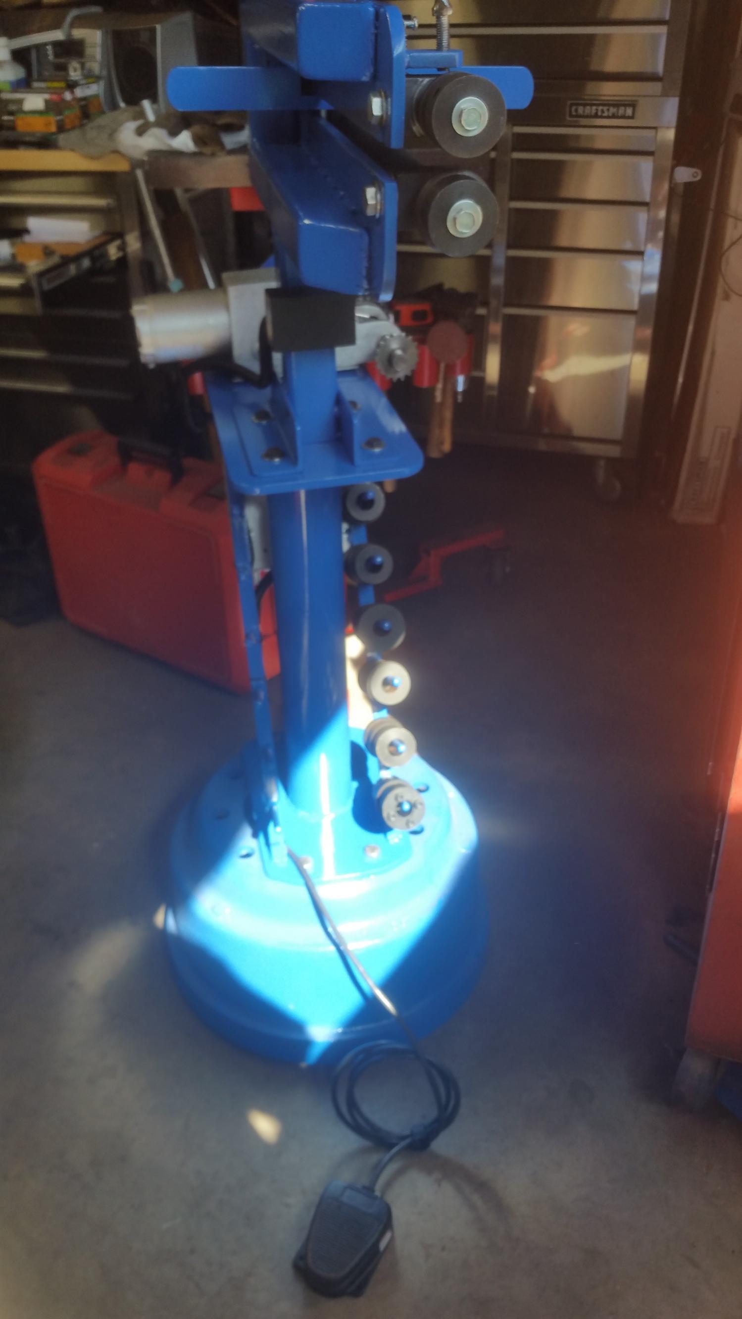

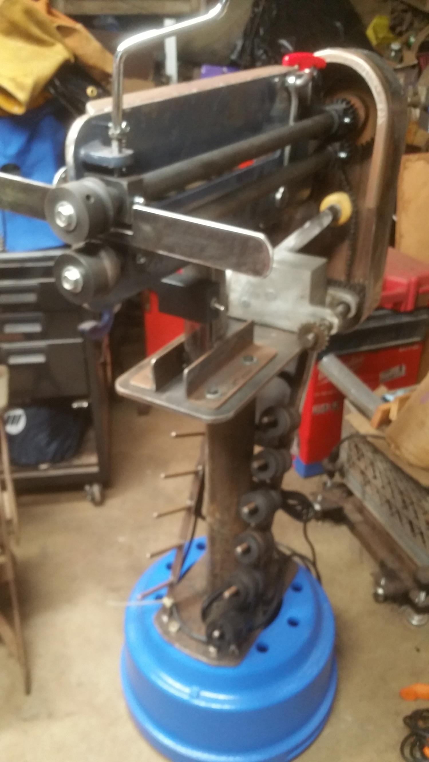

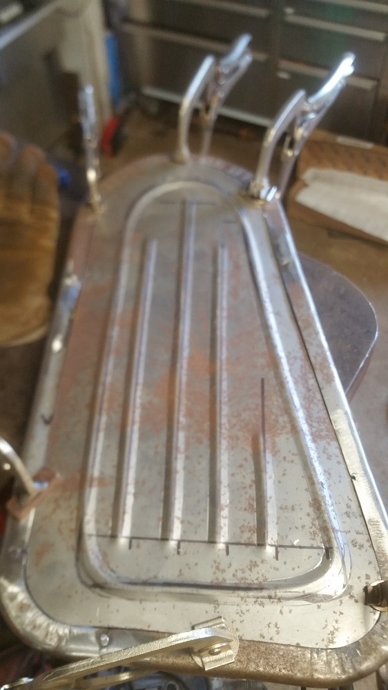

Here's my nearly completed motorized bead roller from H.F. I used a motor from a motorized stair climbing hand truck(dolly) and a 5 volt/15 amp power supply also added a foot pedal and wired in a single pole double throw switch to reverse the polarities and motor direction. works pretty well, but may have to upgrade the toggle switch.
