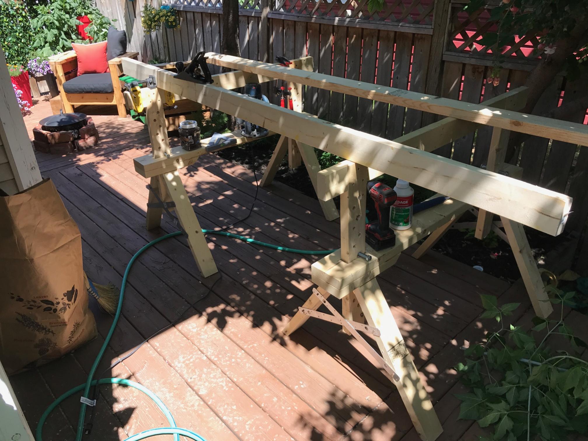

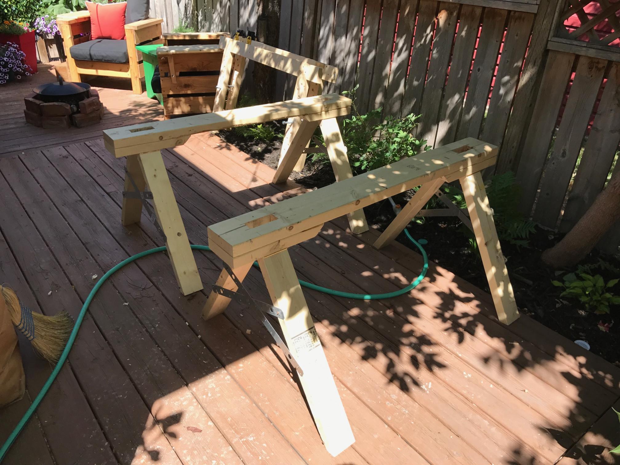

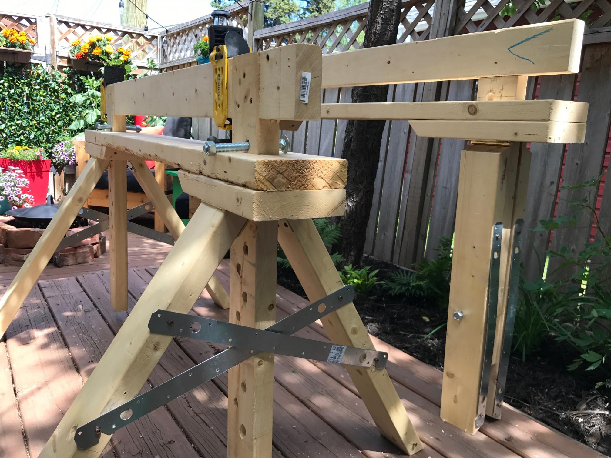

Heavy Duty Adjustable Height Saw Horse

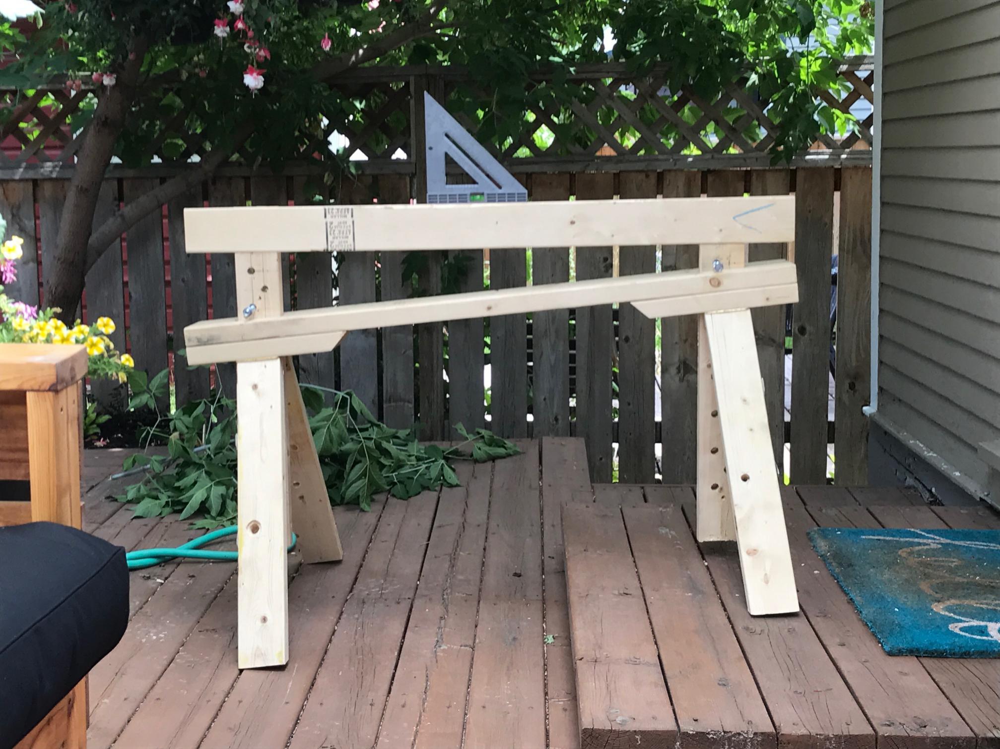

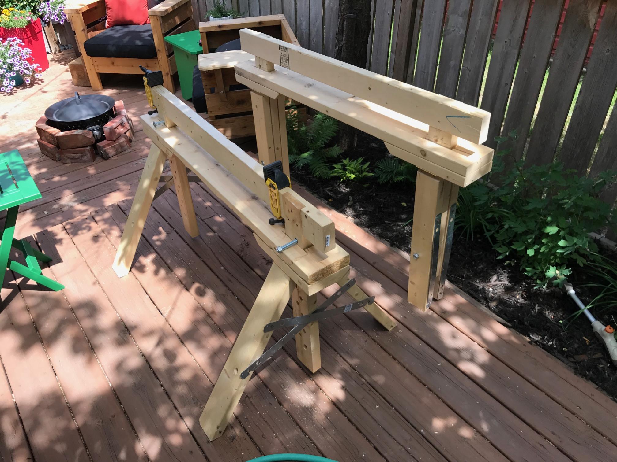

These folding saw horses are adjustable from 2' to 4'. The legs have a wide stance (25 degrees) for stability at full height and they are each hinged on a heavy duty 3 1/2" door hinge. The legs are cross braced by Simpson Strong Tie straps that hook into screw heads.

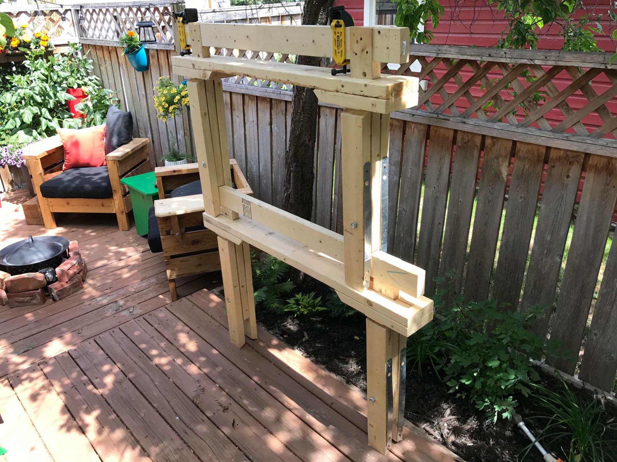

The adjustable upper frame is joined with half-lap joints and is tightly fitted in two mortises in the base and are held in position with carriage bolts in offset holes every 1 1/2".
These bolts also secure the legs in the stowed position.

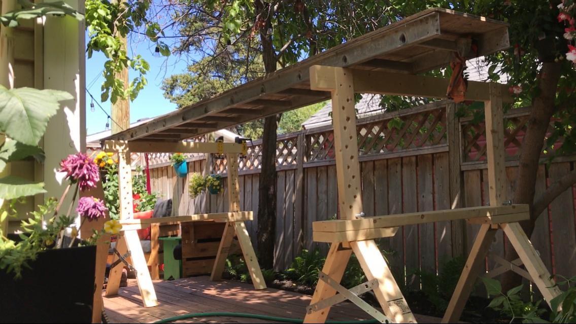

The upper frame can be set on an angle to adjust for uneven terrain.
Made from dimensional 2x4 and 2x6 lumber and weighs 30lbs each.
