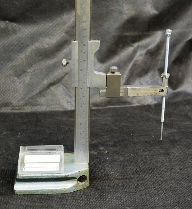

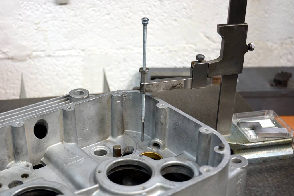

    i started this topic with just a single modification to a measuring device, namely a vernier height gauge to help with reverse engineering a set of motorcycle crankcases. I had to make or modify a number of other tools as well. Here are some of them. Cheap calipers came in for some surgery to adapt them to specific tasks.
    Height gauge addition.-heightgaugedepth.jpg Height gauge addition.-heightgaugedepth2.jpg Click thumbnails for full size images
    This my version of commercially available depth gauge addition. I used a 4 mm threaded rod with a lock nut above the holding beam which is threaded. At the bottom I fixed a carbide "probe". Firstly I set the vernier to a convenient nearest 10 mm setting and then I adjust the probe and lock it to a reference which may be zero at the base surface or it could be a reference surface on the part to be measured.

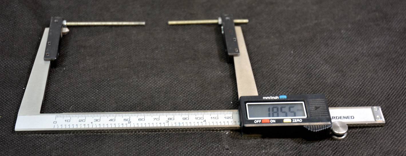

    Height gauge addition.-discbrakecaliper.jpg Height gauge addition.-brakedisccaliper2.jpg

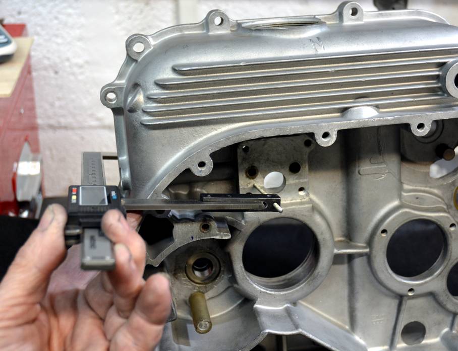

    A while back a local Lidl store had brake disc calipers on offer. Due to its long jaws it has been very useful for various purposes. here you can see how I added to its utility by adding clamps to hold some threaded rod. This allows me to get very quick thickness measurements in awkward places. I could get the same results in most, but not all, areas by using the depth gauge modification above from both sides, but using the caliper is much faster. the RH pic. shows how it is used.

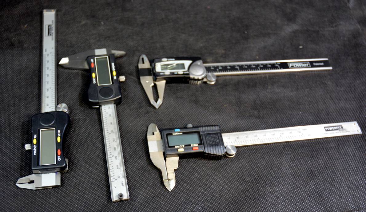

    Here are some modified calipers. On the left I have cut off the OD measuring jaws, which allows it to fit some bores to measure grooves or spacing directly. The second one has been shortened to allow it to fit into smaller spaces, the usual depth gauge rod has been cut off also. A small bolt has been added at the end to act as a stop. The stub of the cutoff depth rod will bear against the bolt so the plastic case is protected.
    The other two have just had the jaws modified to allow them to be used where there would otherwise be some interference.
    All of the modifications here have been done to satisfy a practical requirement, none have been done on a basis of "it might be useful one rainy day".

    I like all your caliper mods. The shortened calipers are very handy for slipping into a pocket when off to do some shopping; especially since metric and inferial are just a button touch away. HF used to sell 3" cheapies. I have a pair and they are my shopping calipers as well as being very useful for in situ measurements when the mill spindle is down close to the workpiece.
    Another handy caliper modification is to center drill two spots, one on each jaw, separated by a convenient distance, e.g. 0.2". Now, to set your dividers to a desired radius, stick the points into the spots and open the calipers until they read the radius minus the separation distance.
    Also, novices should be aware that calipers are a good substitute for fine tweezers when needing to remove one of those annoying steel splinters from a finger.
    Marv, that is a useful tip.
    Another great idea, I have been getting too many aluminium splinters lately which I have been removing with tweezers from a Swiss Army knife but some are very hard to get a hold on. I'll try the caliper method on the next one.
