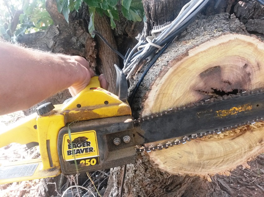

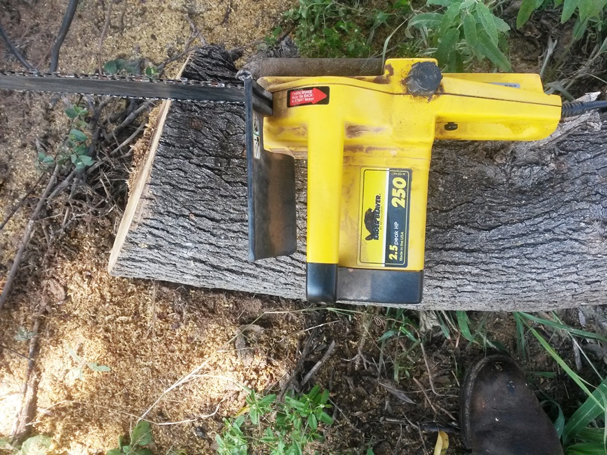

    A little chain saw that I found tossed in the garbage.
    I plugged it in and nothing. worked the blade brake back and forth several times and tried it again this time it worked I filled the bar oil res. then cut this limb the chain needs sharpening and adjusting but otherwise it did a fine job. I like electrics for trimming and have owned a few of the cheap ones
    The McCuulloch Eager beaver electric 250 2.5 HP is not a real expensive one nor is it the cheapest. I rate them somewhere in the middle.
    The limb I cut was a real challenge for any electric and some gas powered since it was fruitless Mulberry 14" diameter
