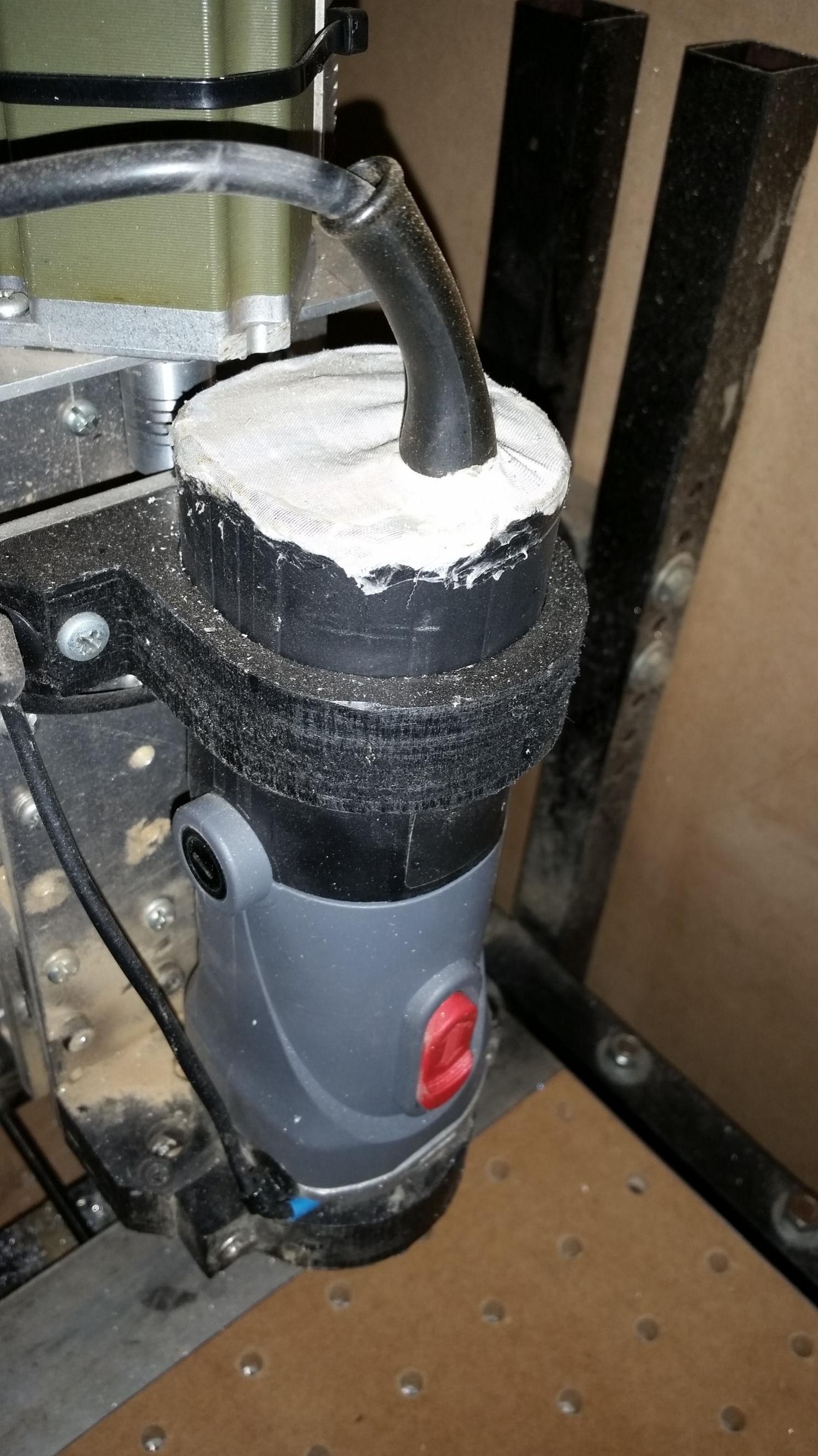

    I see that you made it to mill wood, but how will it perform milling aluminum?
  4. #14
    Supporting Member scorch's Avatar
    Apr 2015
    Oakdale, MN
    61
    9
    Thanked 132 Times in 30 Posts
    scorch's Tools
    Quote Originally Posted by owc View Post
    I think the mount will do fine with aluminum. It is really stout. I am a little worried about where the aluminum chips are going to go with the router running. There is a lot of airflow coming from the bottom of the router. I have a feeling there is going to be aluminum chips all over the workshop and potentially inside the router.
  5. #15
    May 2015
    16
    Thanked 49 Times in 8 Posts
    baskarz's Tools
    Yep aluminium chips go EVERYWHERE, learnt that the fun way.
    And they did eventually get sucked into the router and went *splat*.
    luckily it was only a brief short and i just took it apart and cleaned it all up.
    I ended up hotgluing some material to the air inlet on the router and works perfectly.

    Tnx to Scorch & Baskarz. I will WATCH the chips.
