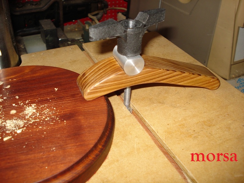

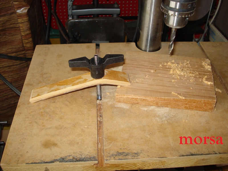

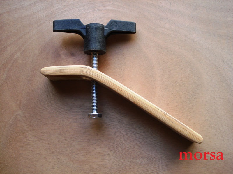

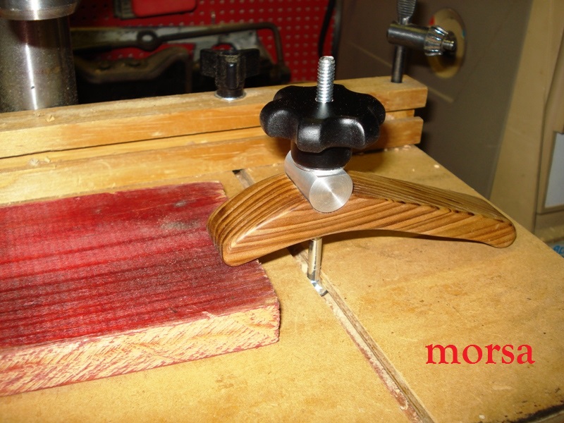

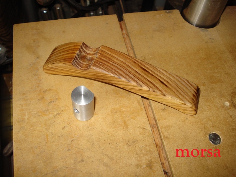

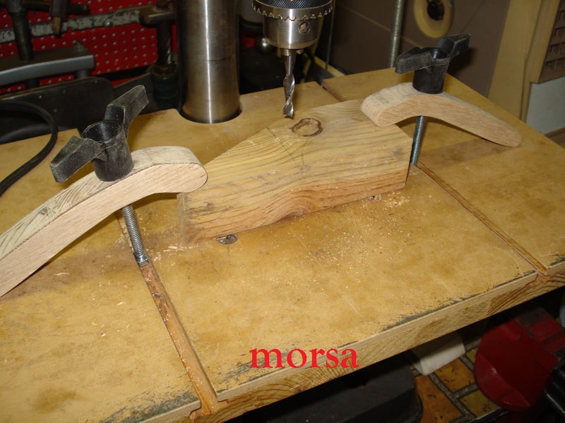

A while ago, I needed some hold down clamps for the homemade T-slots at the drill press table; eventually, I had three different versions, and they all worked well:

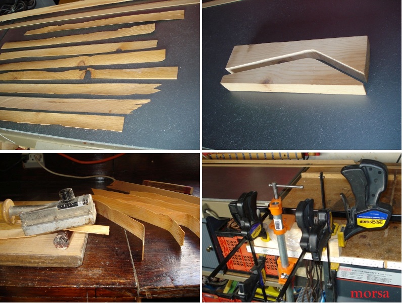

1- First attempt was bending and gluing thin strips of wood
Attachment 15052
Attachment 15053
Attachment 15054

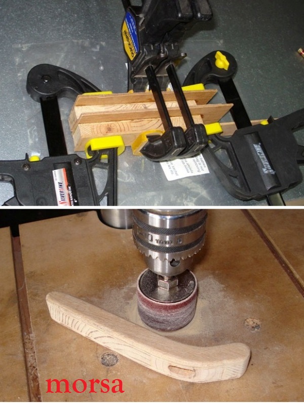

2- Second approach was to cut the shape in plywood
Attachment 15055
Attachment 15056
Attachment 15057
Attachment 15058

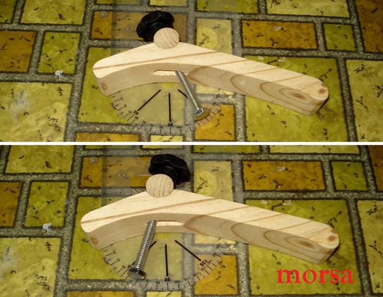

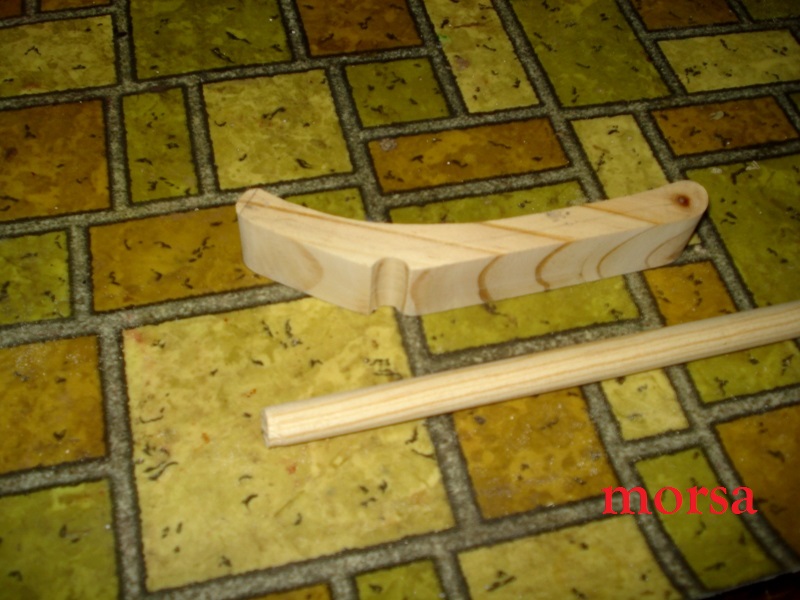

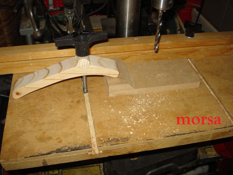

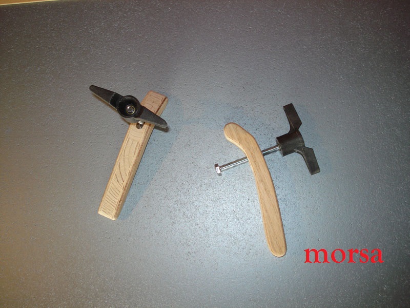

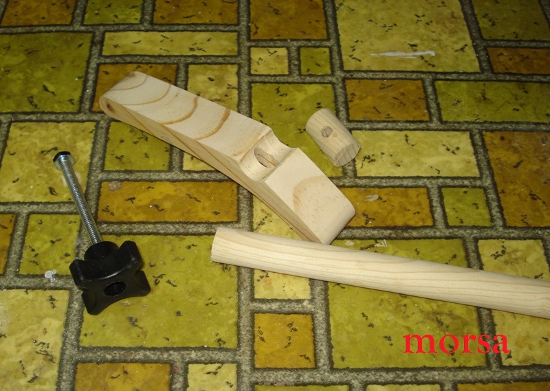

3- The third attempt was cutting the shape in solid wood and adding a pivoting dowel
Attachment 15059
Attachment 15060
Attachment 15061
Attachment 15062

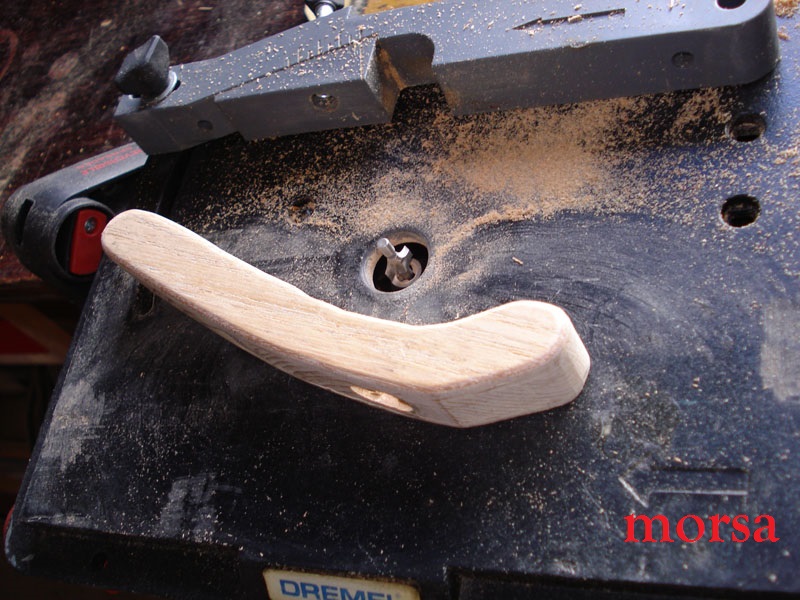

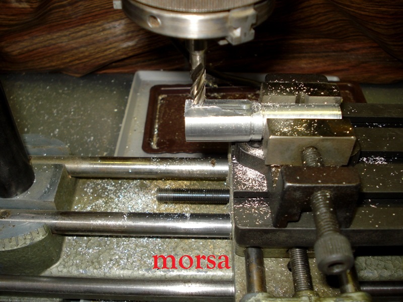

4- A variant of the previous model consisted of making the pivot with aluminum
Attachment 15063
Attachment 15064
Attachment 15065
Attachment 15066
Either of the models are easy to make, and are an alternative to commercial hold down clamps; in addition, you could make them in two or three different lengths.
