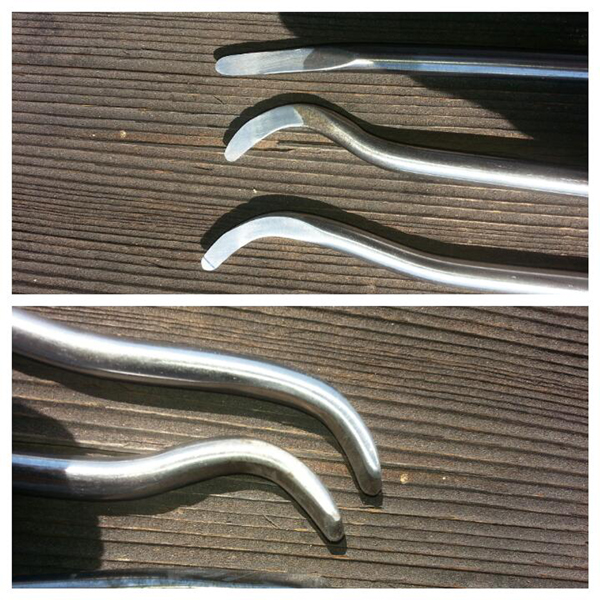

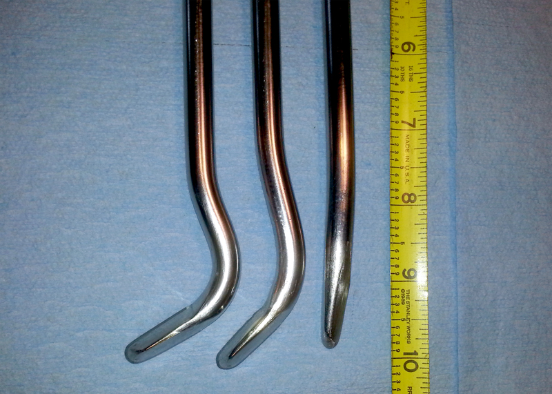

This was another project for my Woodworking Guru friend which took me down many paths and taxed my skill levels and tiny shop pretty good. He wanted a set of 3, 3/8" hollower to match his 1/4" set of Keltons which are quite nice tools made in New Zealand. His weighted handle is double ended and accepts 1/4" (6mm) and 3/8" (10mm) tools. As I know less than a little about these I asked him to borrow the set for a couple of days to figure out what I needed to do to build them from 3/8" O1. Here is a picture of his 1/4" set. As you can see there is a shallow curve, a medium and an acute curve and the two latter are actually compound bends. We'll get to the relief angles later.
Basically I measured everything I could and actually made tracings of them in my engineering book. Also got the length specs from their website and scaled everything up to 3/8" including the radii. Upon close inspection I realized these actually have some (carbide probably) inset for the cutting edge.

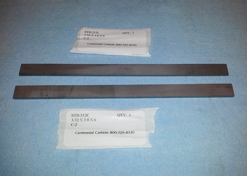

Now I had to figure out how to do those compound bends and that's when I whipped up the "Rod Bender, Cheap n' Cheerful" I posted earlier. I also wasn't convinced my heat treatment would hold up so I ordered up some C2 Carbide from a great source I found on line. Centennial Carbide is a great source with good prices and Nice folks which I felt would be a good share here. Here is what I got but they also have fine grain also.

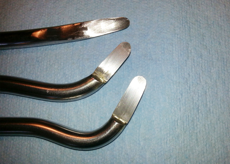

The basic profiling of the cutting area went pretty well but worked diligently to get them flat to get a good silver braze for the carbide. I thought I had a Dremel diamond wheel for the carbide but didn't so I ended up snapping the 1/16" off in the vice....not pretty but close enough to work. Silver soldered them and proceed to work the relief angles like I did the first one. This was tough because I couldn't work the carbide with my Silicone Carbide belts and ended up using my 120 grit diamond grinding wheel and a double sided lapping plate, 6" plate I made. I have 2, a 360 & a 600, then hand DMT's up to Extra fine (800-1000G). In some ways these were tougher to bring to edge and profile than sharpening my 27" Katana which has a convex profile and edge over a long run. because one little lack of concentration or slip with the diamond would cost me a half hour some times.

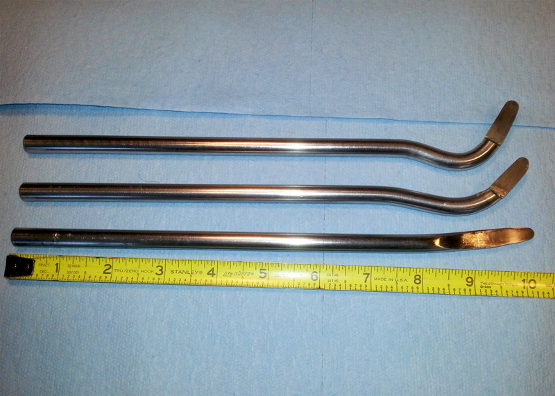

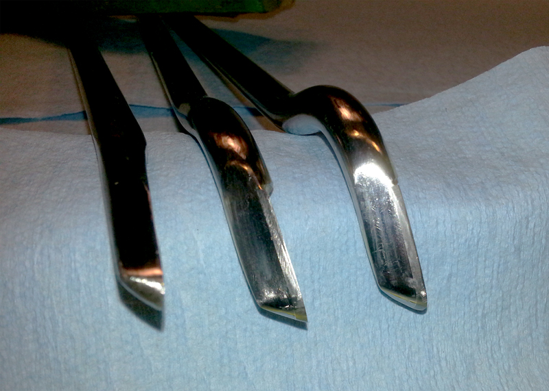

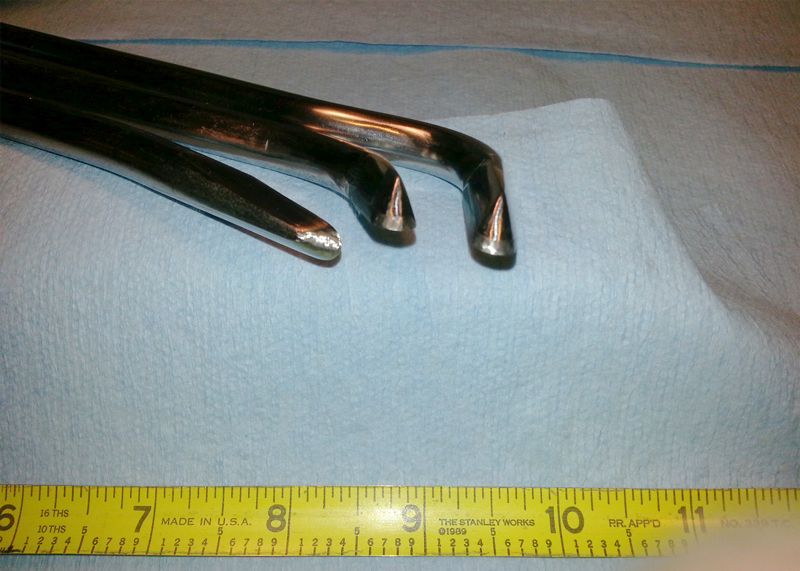

Here are the finals of what I made for him.
Attachment 14302 Attachment 14303
Attachment 14304 Attachment 14305
Attachment 14306
Hemingway this is turning into a book in my normal spew...bottom line I got the relief angles to what I thought was right and sharp as I thought was proper. Gave them to him to try...not as good as the first one. He recommended going to a relief like the round insert his Big O' Hollower uses which it 30º...so I did and it works. I still have some concerns this is too steep for some of the gnarly stuff he chews up but time will tell. One did get a tiny chip because the piece he was working had a crack all the way across and the interrupted cut of it gave it a beating but it's still cutting.

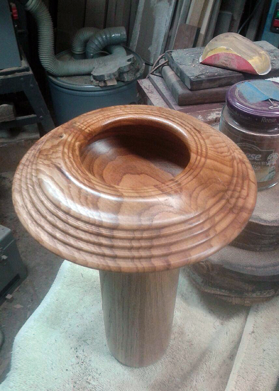

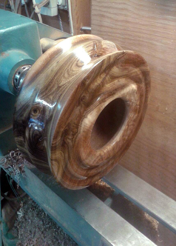

Also wanted to share a couple of his pieces he's made. This is a small sample of his bowls but the Walnut cutting board I got from his is Awesome. He has an eye for finding the grain and bringing it out like few can, IMHO.
