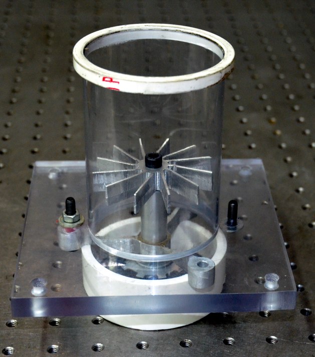

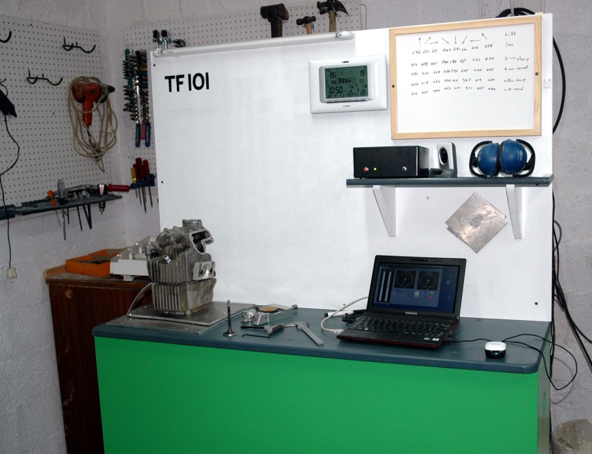

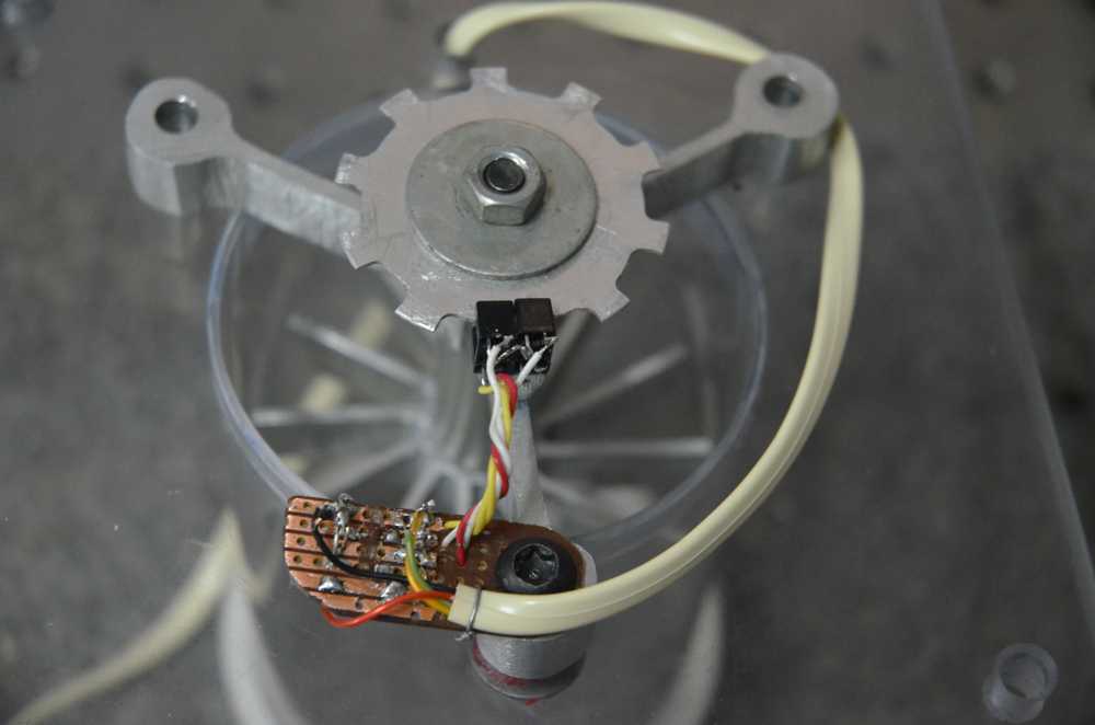

I assume that you are talking about the flow bench? I keep trying to find the time for that, actually I must have at least 100 projects that I would like to document, I create them quicker than I can write about them.
Attachment 27309 Attachment 27310 Attachment 27311 Click for full size images.
For the time being here are some pix of the bench and some of my swirl meter.

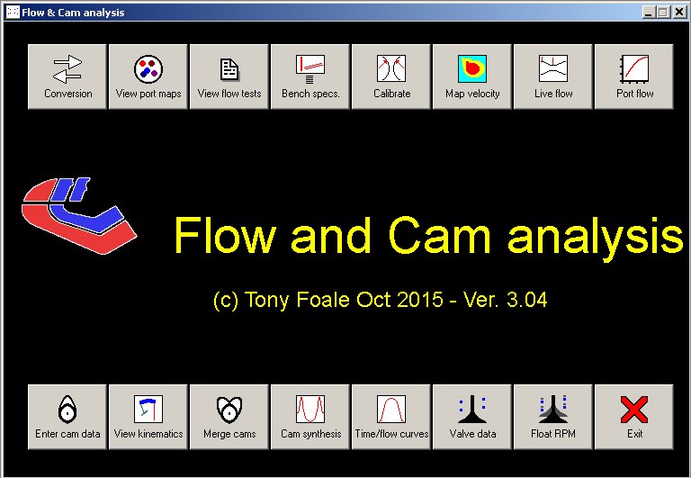

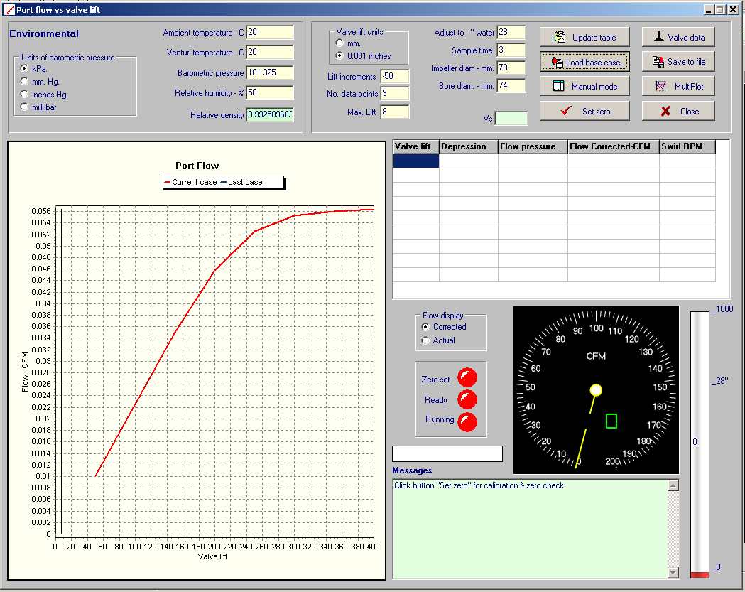

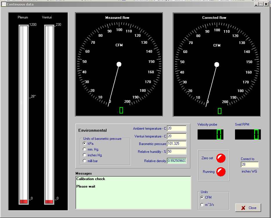

Here are some shots of the software.
