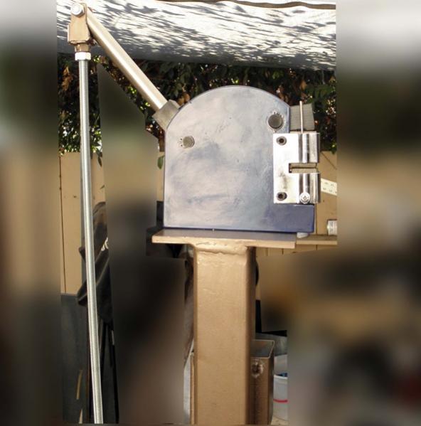

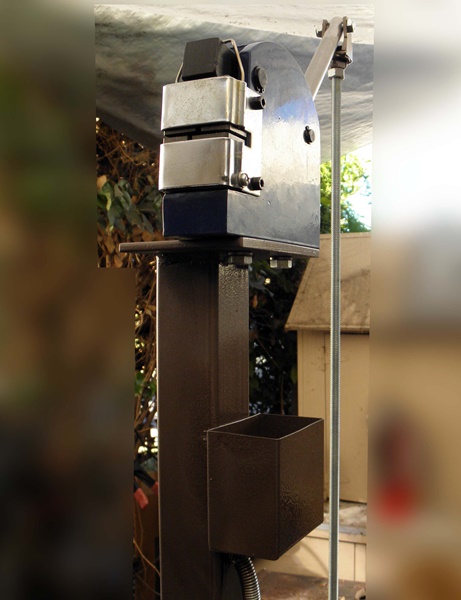

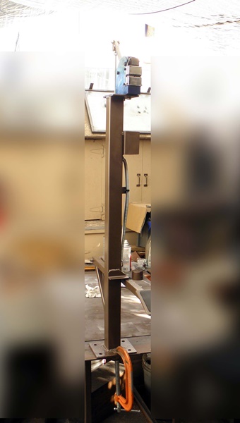

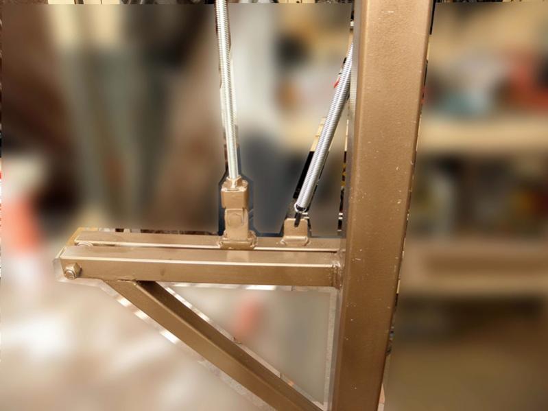

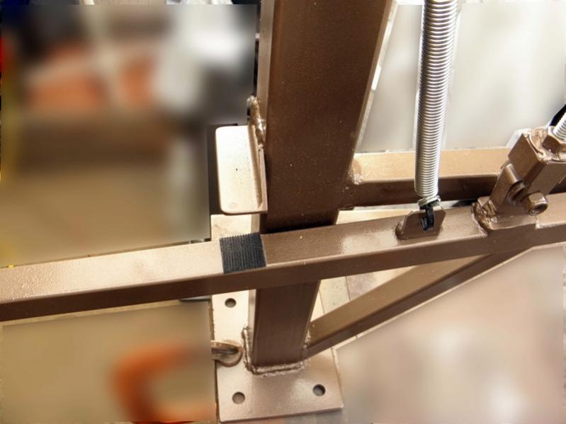

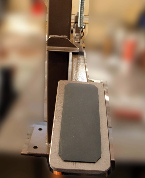

Home Shrinker-Streatcher Stand.
DIY Shrinker-Streatcher Stand.
Made from 2x2x1/8 inch square tubing and 1x1x 1/16 square tubing, 1/4 inch steel plate, screen door spring,3/8 threaded rod,sheetmetal.
Special Thanks to Ron over at metalmeet.com for the free plans for this stand which I found on youtube.:clapping: https://www.youtube.com/watch?featur...&v=7ZdFtGeVJvw
His is the double version I made a single version with a small box on the post to keep the second set of jaws in. His has a H base While mine is set up to be bolted to the cement floor.
