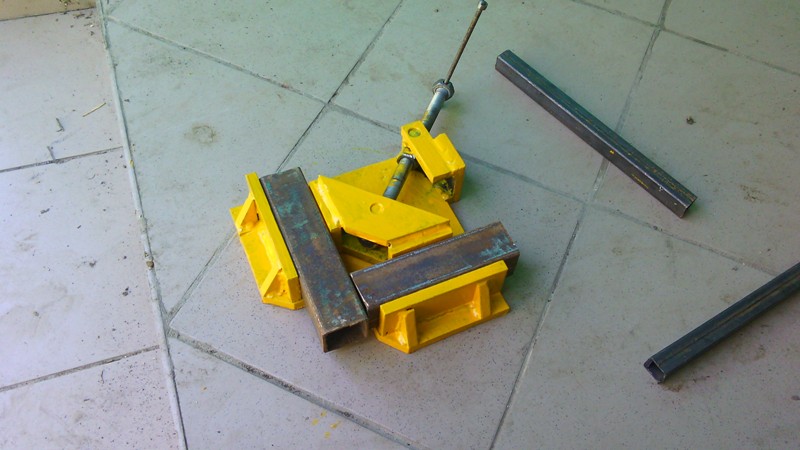

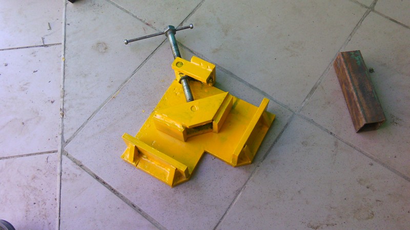

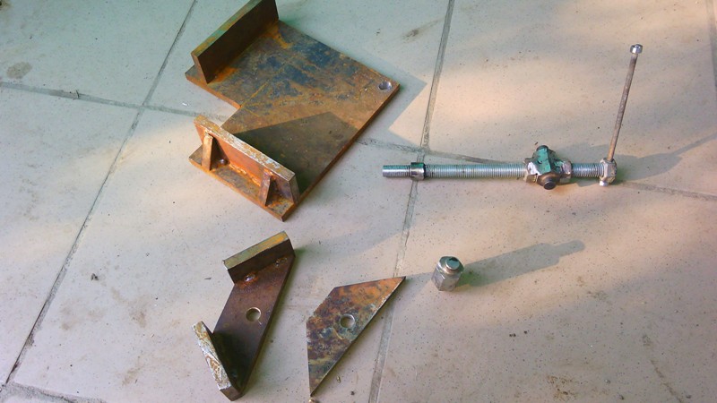

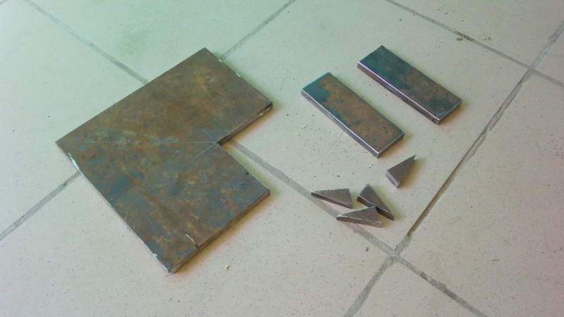

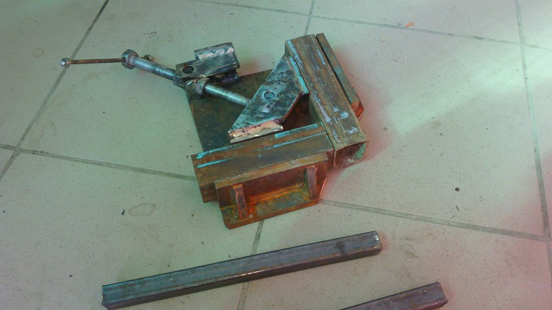

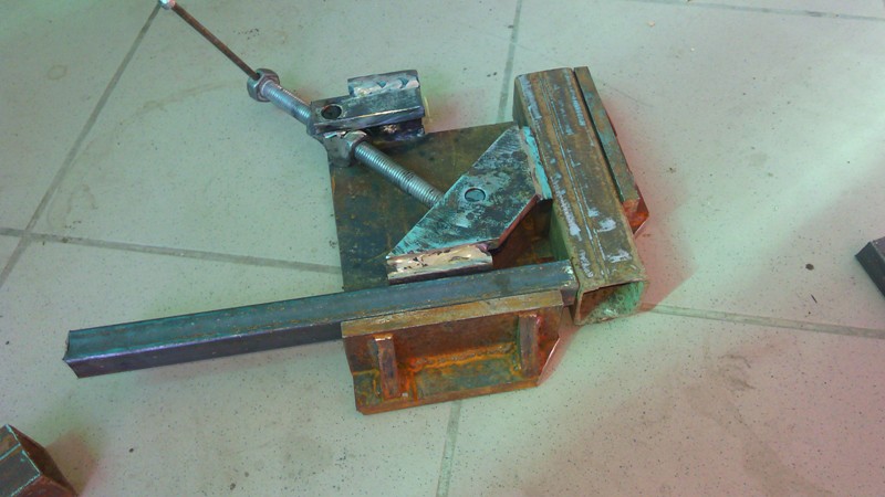

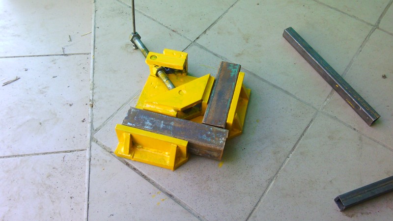

    Homemade angle clamp
    Homemade angle clamp made of sheet metal 10 mm

    Nice design, I have not seen one before that can hold a mix of sizes of material, very useful for fabrication.

    Another fine job. Well done. I particularly like your design that enables it to hold unmatched material sizes. I initially wondered why you bothered to pivot the clamp nut, but it was all revealed in the end.
