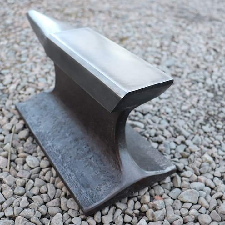

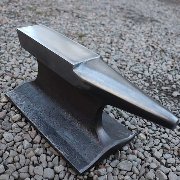

Made a new RR-track anvil.
Lenght 450mm / about 18"
Made with the same way than earlier one.
This is also for shaped for shaping sheet metals.
Attachment 33258
Attachment 33259
Hardening was made in heat treating oven. Started with preheating it to 660 degrees of celsius, temperature was raised 200 degrees / hour. Then it was heated to 1000 degrees and hold in that temperature 30 minutes.
After that it was cooled to water. And finally heated to 300 degrees of celsius and kept 4 hours in that temperature, and cooled to water.
