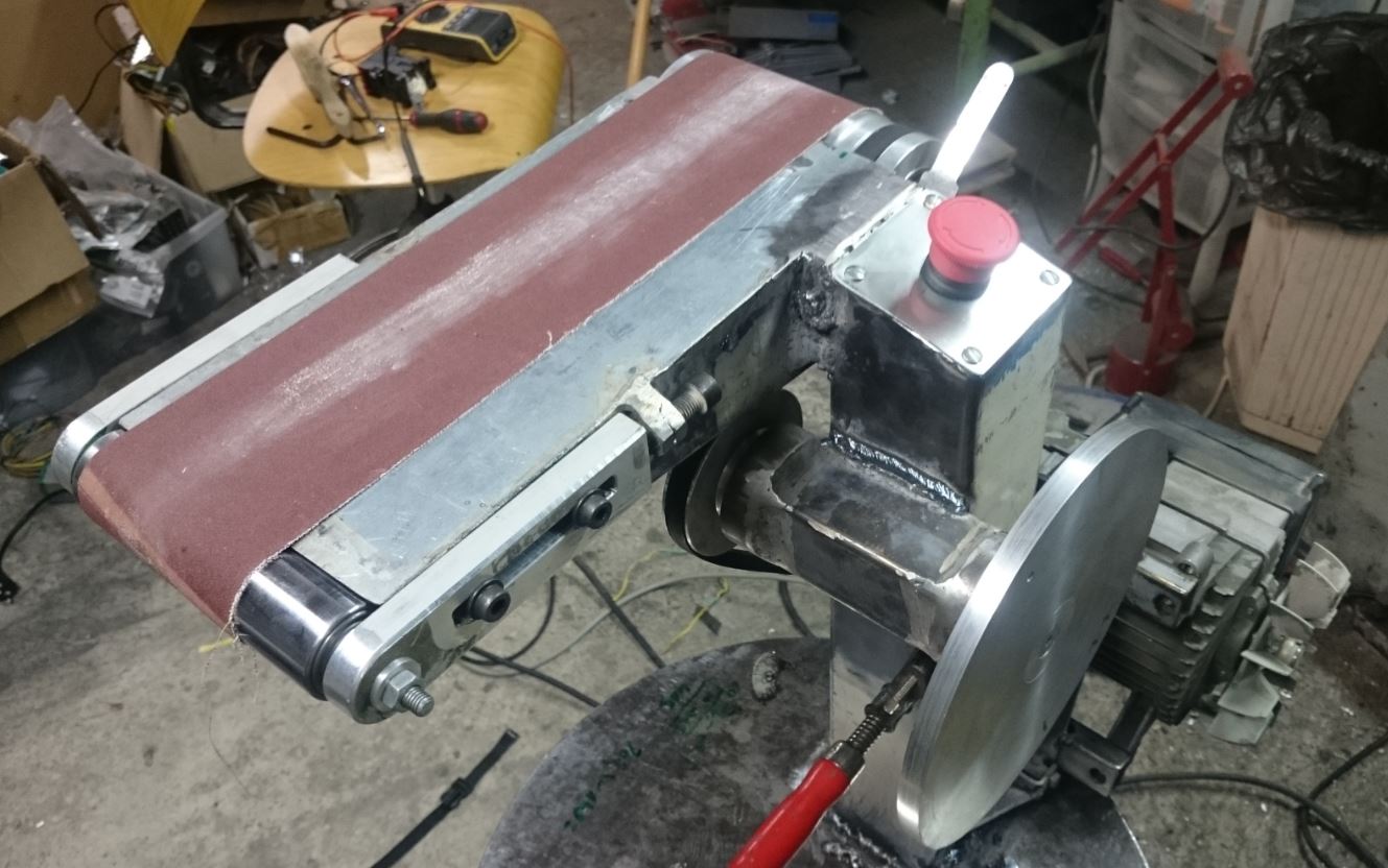

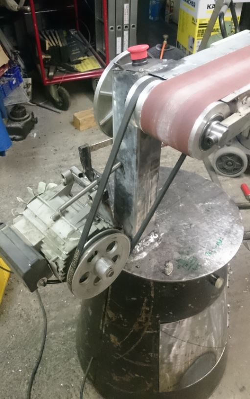

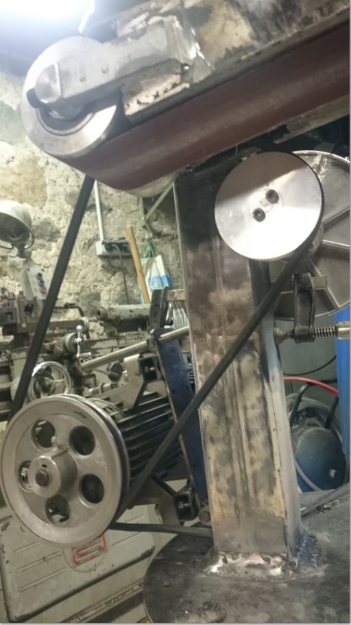

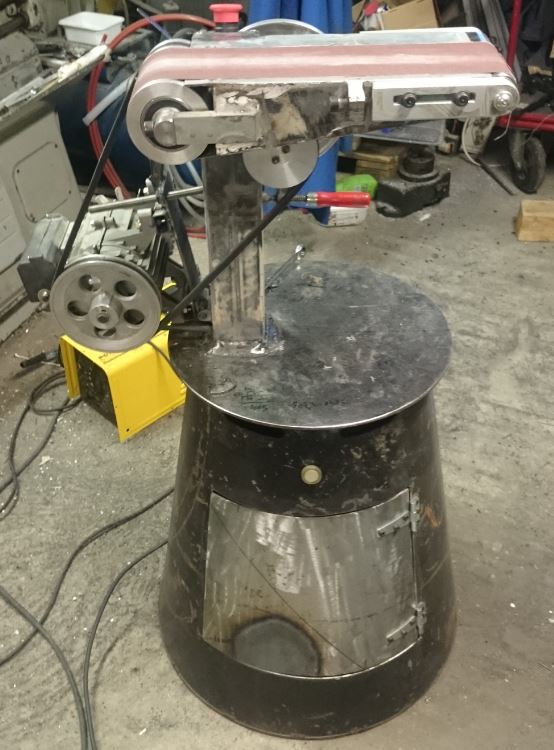

After a lot of tinkering, then metal working, I finally get most of the job done, and am pleased to present you my home made grinder.
Everything is from industrial trash, only things bought are grinding bands, disks for grinder and welding sticks.
Motor is 2kW 2800rpm for around 1480 m/min (4855,643feet/min) band feed.
I still have to finish the disk part, that I intend to equip with a tilt table.
Please feel free to comment or to make any suggestion! :)
