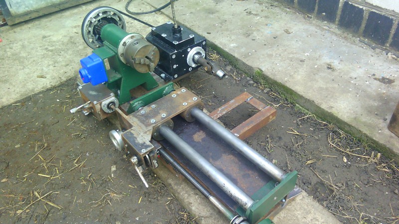

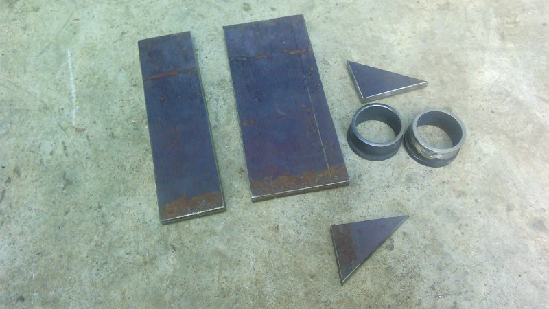

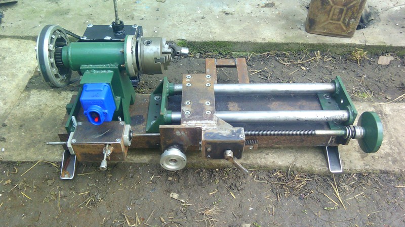

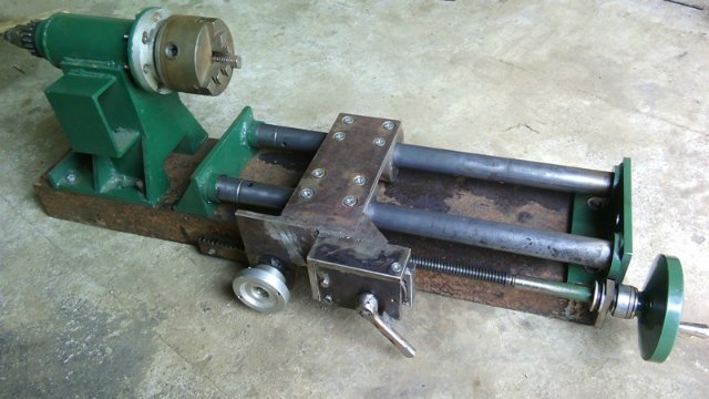

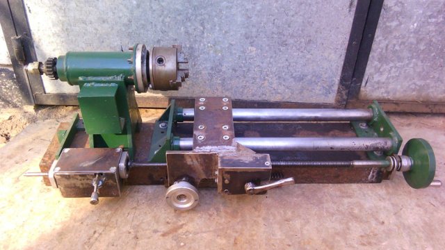

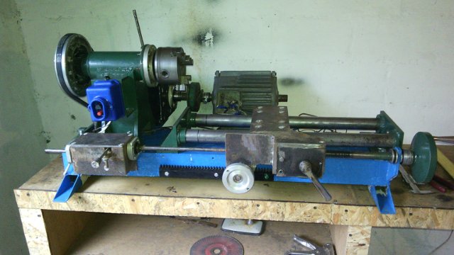

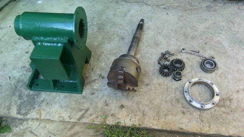

Hello. I want to share my project. This lathe machine for metal, construction began six months ago. I'll start my story about the front pastern. For the construction of boxes used sheet metal 10 mm.
Attachment 6884
Attachment 6885
Attachment 6886

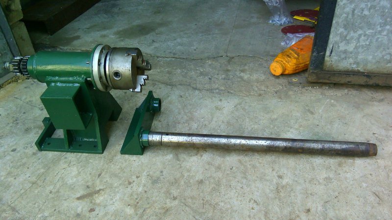

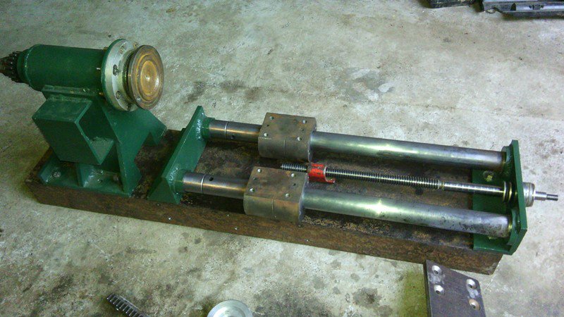

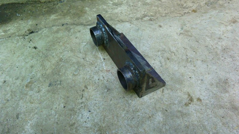

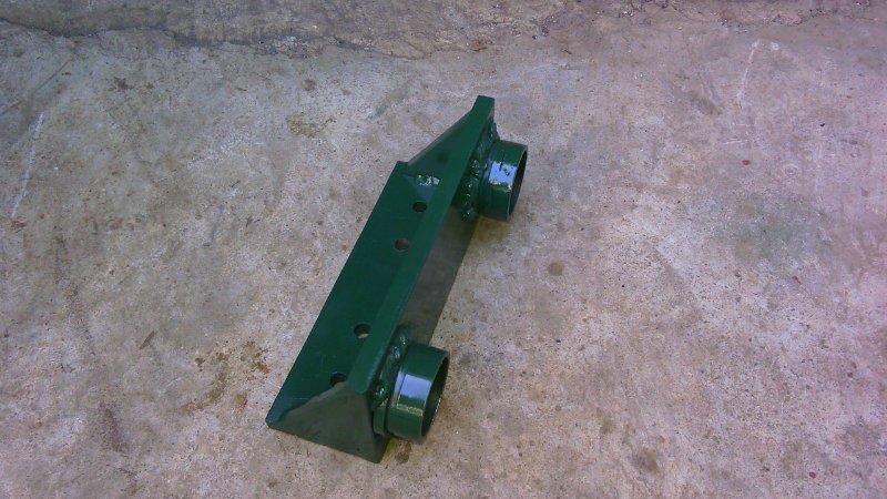

The process of creating front pastern
https://www.youtube.com/watch?v=E-As4tECwcQ

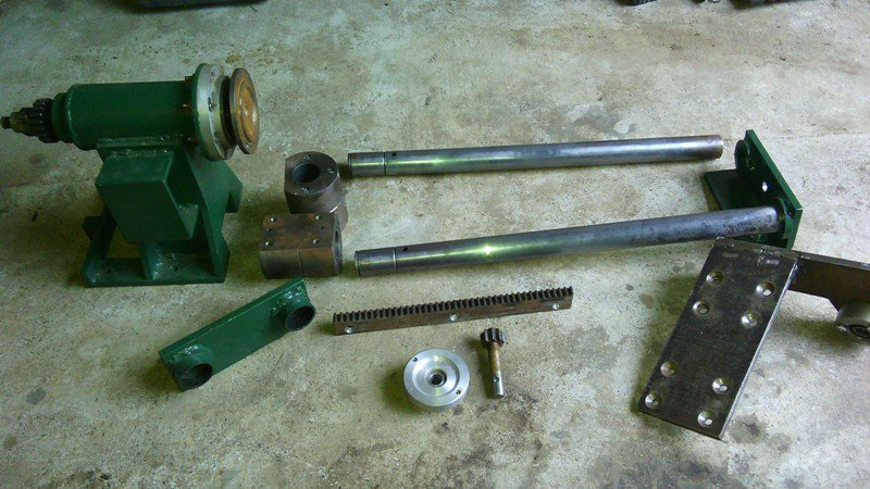

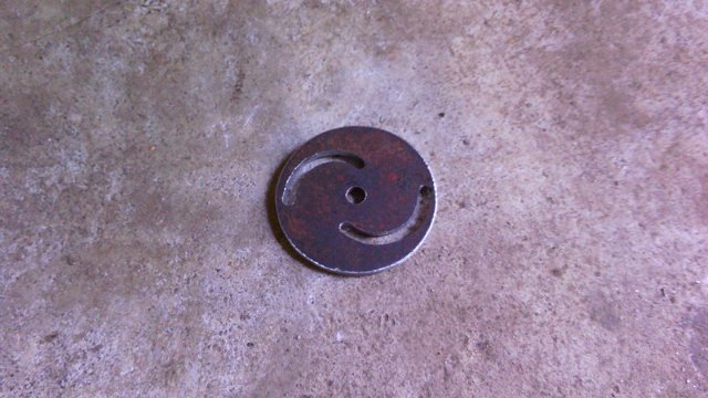

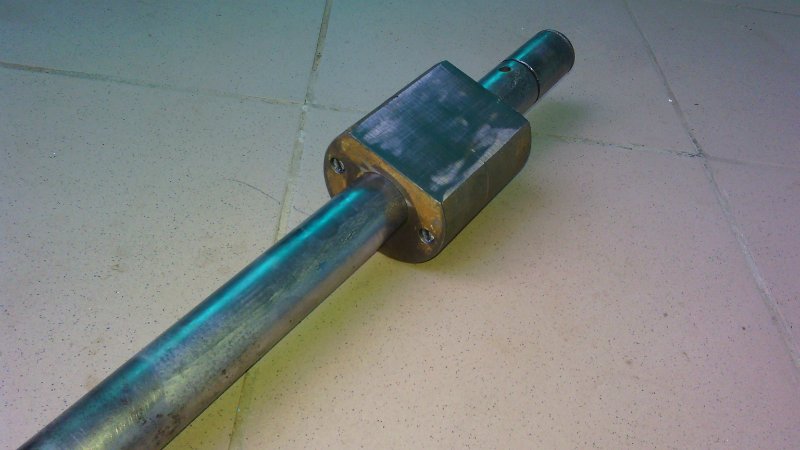

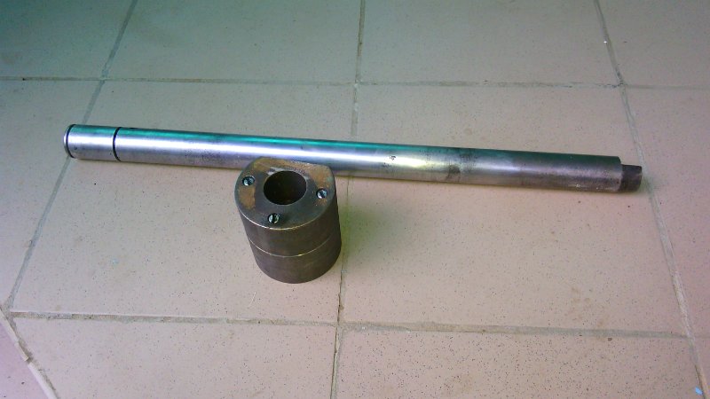

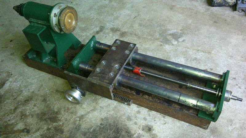

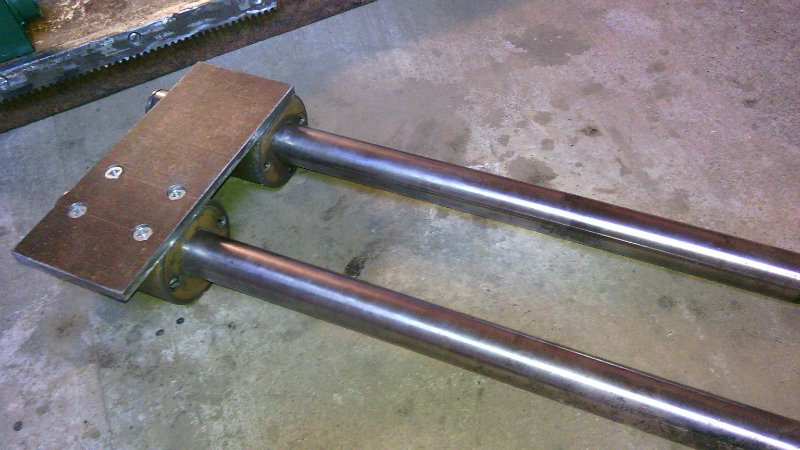

Fasteners for steel rod and iron bushings. Rods diameter 36mm, length 54 cm, diameter bushings 75mm.
Attachment 6887
Attachment 6888
Attachment 6889
Attachment 6890
Attachment 6891
Attachment 6892
Attachment 6893
Demonstration of work

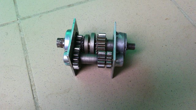

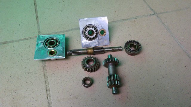

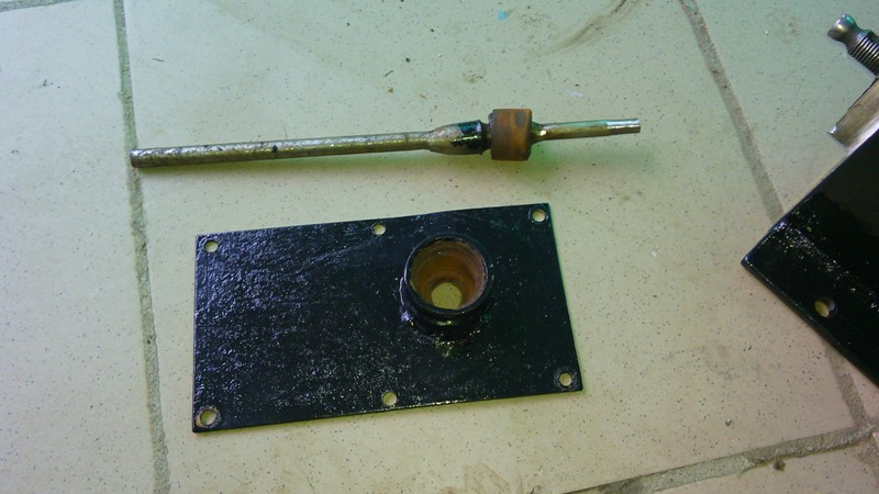

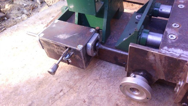

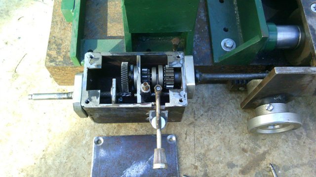

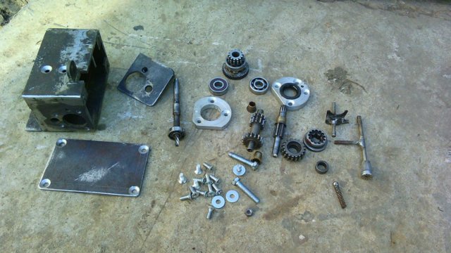

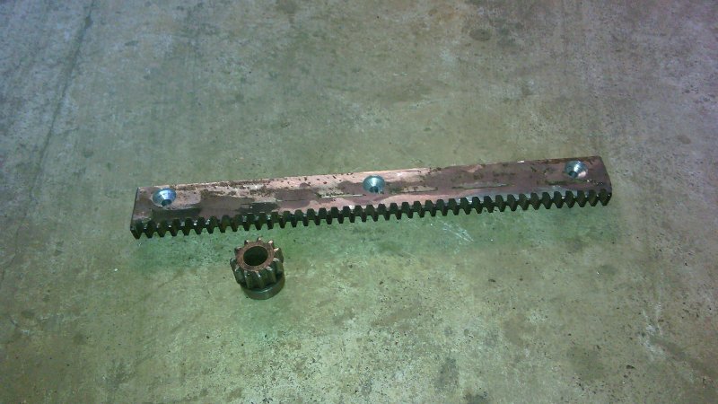

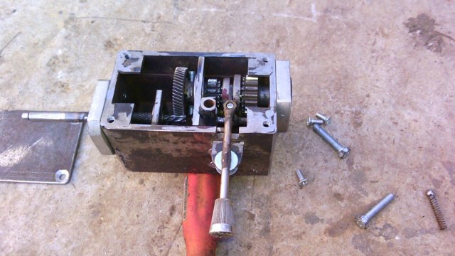

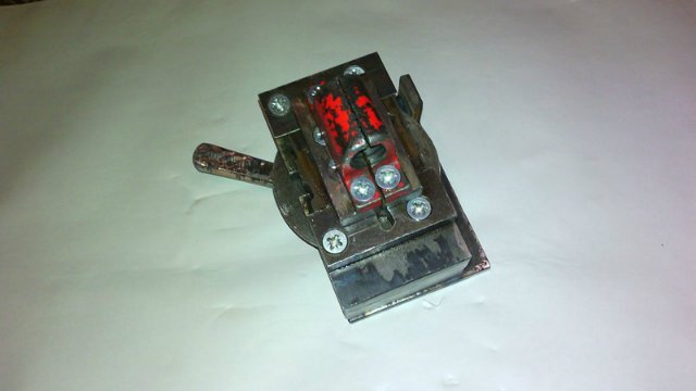

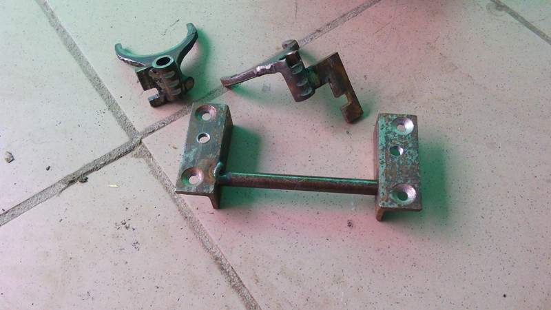

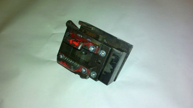

Gearbox for lead screw. Gearbox has 2 speed, gears from mini motorcycle, and the old drill.

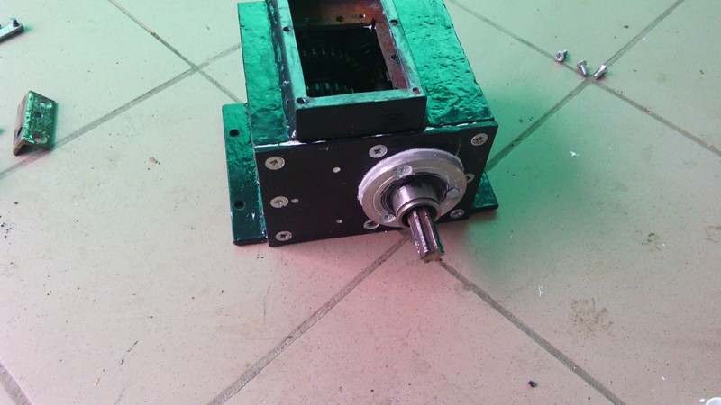

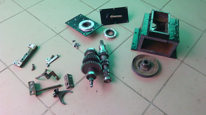

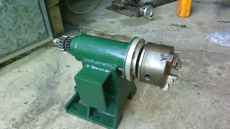

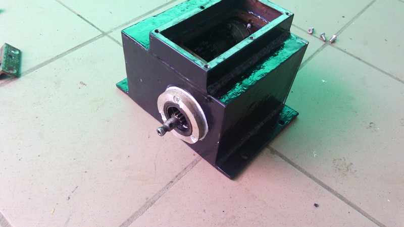

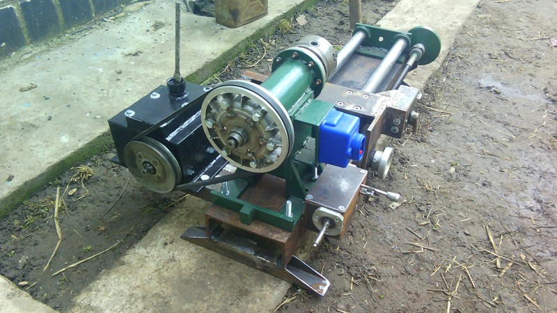

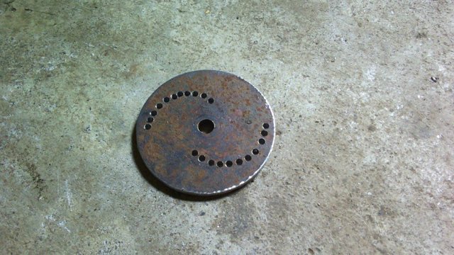

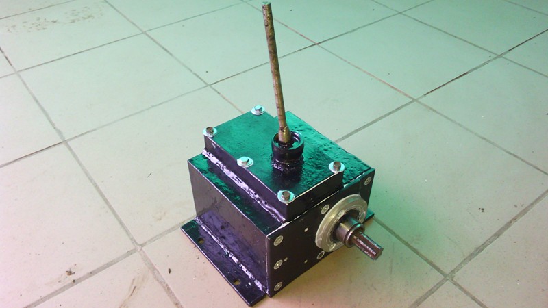

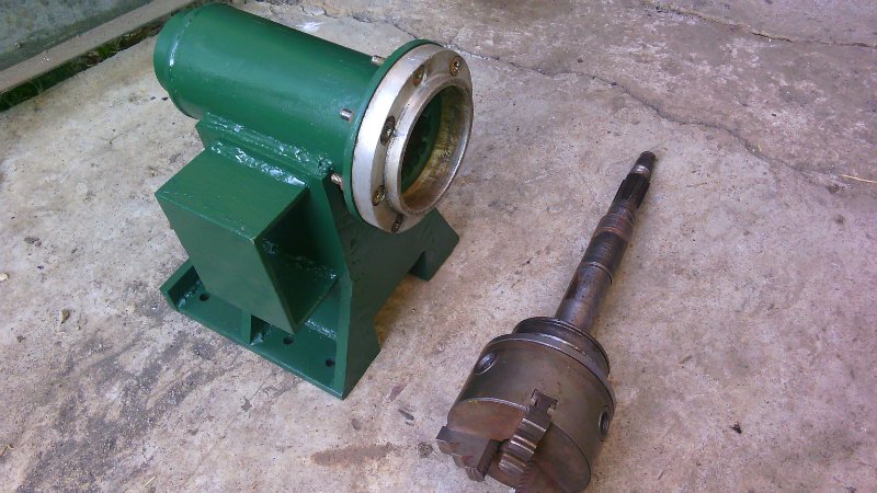

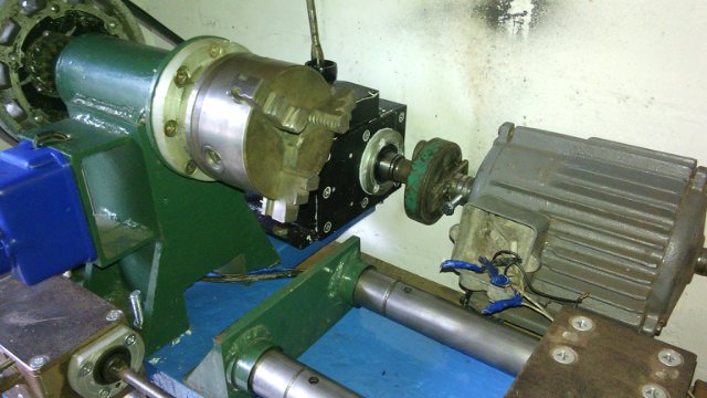

Gearbox to the spindle. Gear used by motorcycle "Dnepr".
Attachment 6916
Attachment 6917
Attachment 6918
Attachment 6919
Attachment 6920
Attachment 6921
Attachment 6922
Motor power of 1 kW.
Attachment 6923
Attachment 6924
Attachment 6925
Attachment 6926
Attachment 6927
