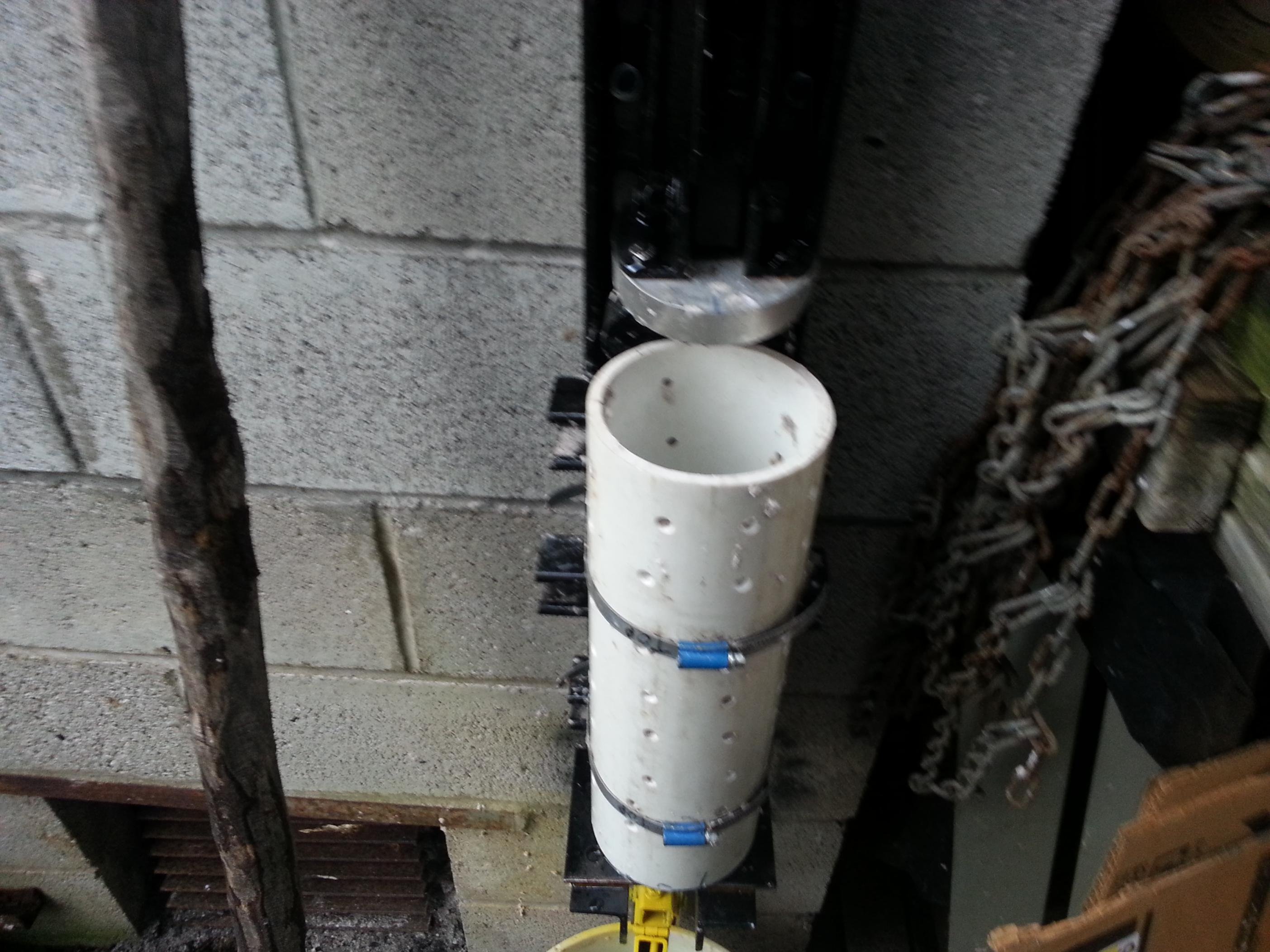

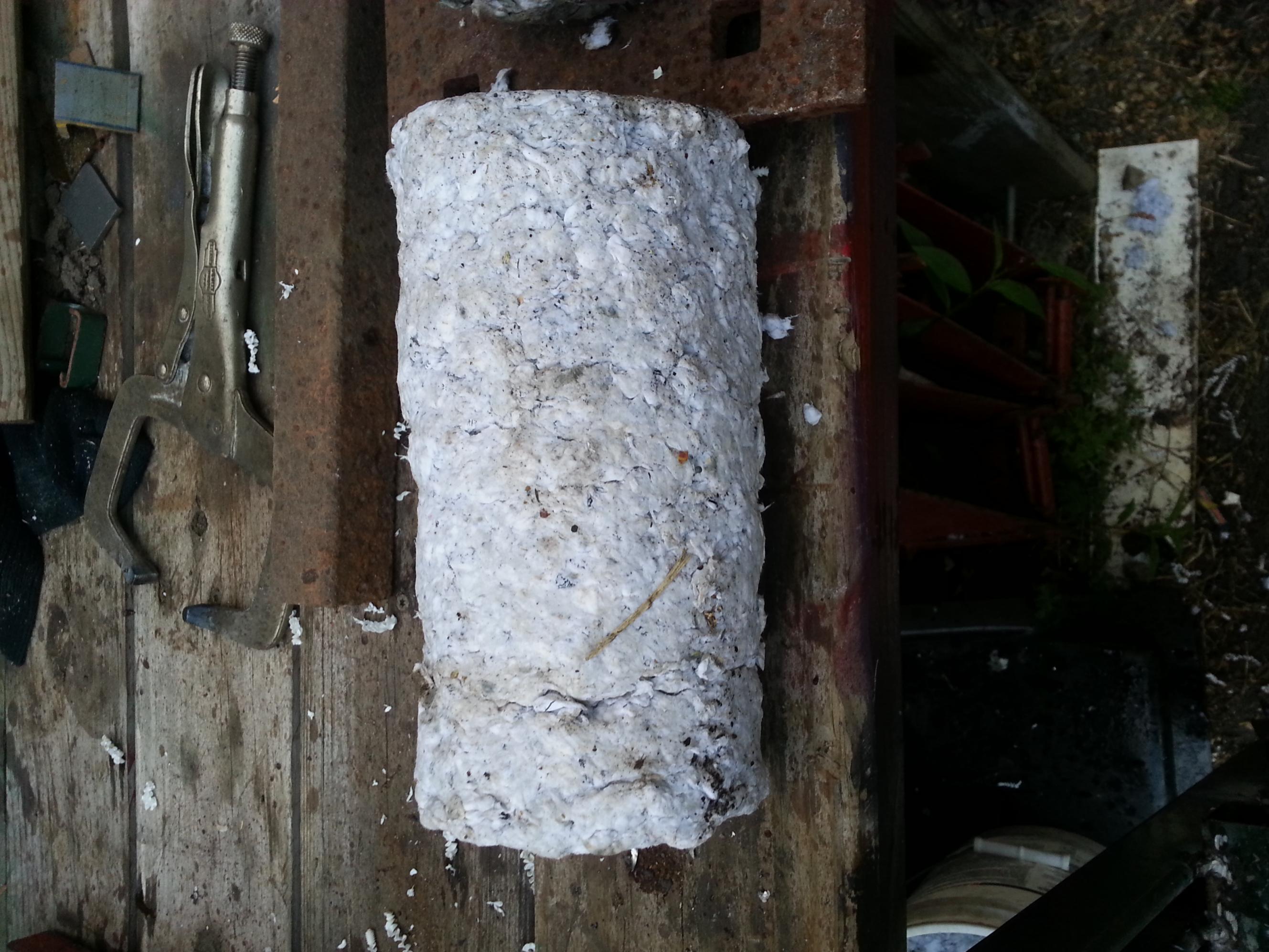

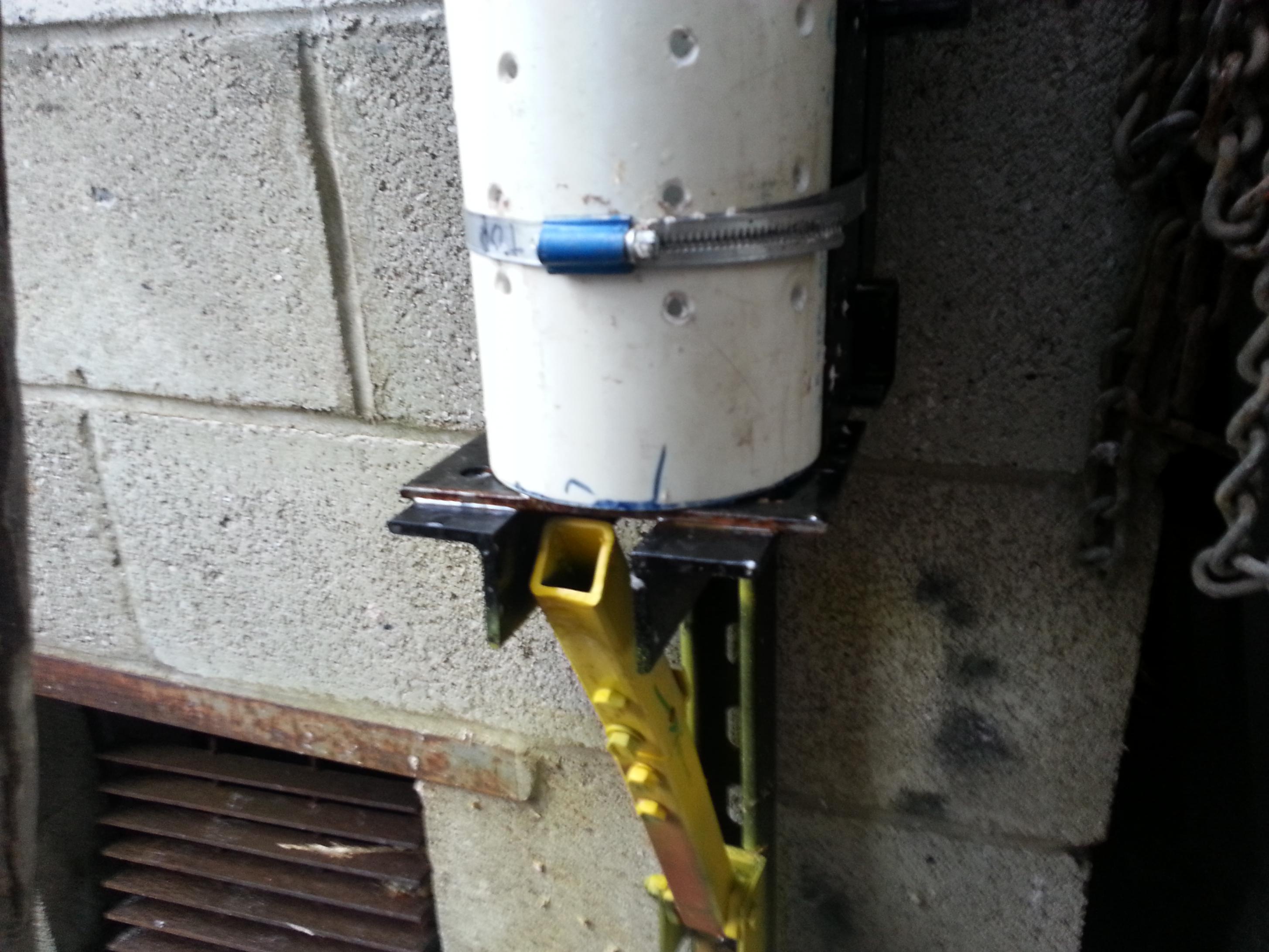

    I decided to try out the paper logs. Whipped this up out of "uni-strut" and some angle. Little welding and a few bolts. The only piece I had to buy was the 3.75" x .75" thick aluminum "presser puck", total cost in this baby, $3.00! Free firewood! The logs are coming out pretty nice, about 4" diameter by 12" long. Should work in my fireplace on my deck after they dry out okay. Used paper, cardboard, and some sawdust in a 5 gallon bucket, mixed with a drywall stirrer in a drill. This was the second or third log in the photo above, next ones came out even better. Probably able to make 10-20 in an hour if I had enough "mash" mixed up. Get about 4 logs from a five gallon bucket, have to leave room for mixing with drill. If you heat with wood you should definietly check this process out! It would be even better with an air cylinder to do the pressing but it does not take a lot of effort even with just a lever. My lever is giving me 4 to 1 ratio or so and compacts the log pretty good. Have not had one dry enough to burn yet but people I've talked to say they last nearly as long as a real wood log. We shall seen.

    You don't say if you mix water with it or how much if you do! With out some type of liquid I don't see how it would hold together.

    You use enough water to make the paper soft so you can grind it to a pulp. Then you press it. The amount of water will vary. You are going to squeeze the water out when making the log.

    Thanks NortonDommi! I never found he need for a "binder" it sticks together just fine with nothing but hand pressure applied to the lever. I burned a few a couple of weekends ago in the fireplace on the deck and the did well. They burn about as long as an actual seasoned wood log of roughly the same diameter. Don't know if a concrete mixer would pulverize and mix the paper well enough. I guess it would after some time. I try to add least amount water possible so drying time is not so long. I went and toured a place that makes the firewood "bricks". They use a hydraulic press of course, but they add nothing but sawdust. Pressure alone binds their bricks and the operator told me they are pressing at about 4000 psi. They do not even add water to the sawdust.
