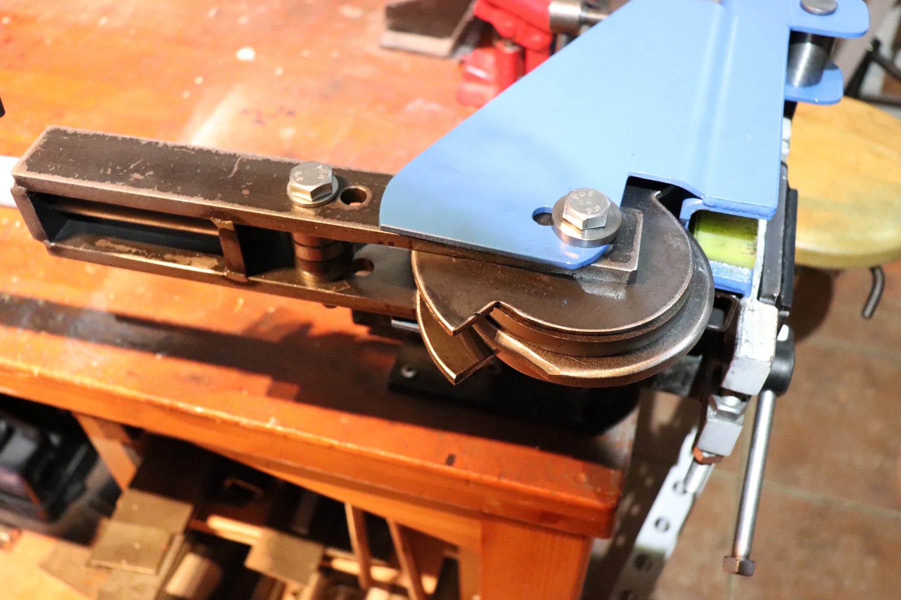

Homemade manual square tube bender
This is my homemade manual square tube bender:
https://www.youtube.com/watch?v=6s5DMjmzrew

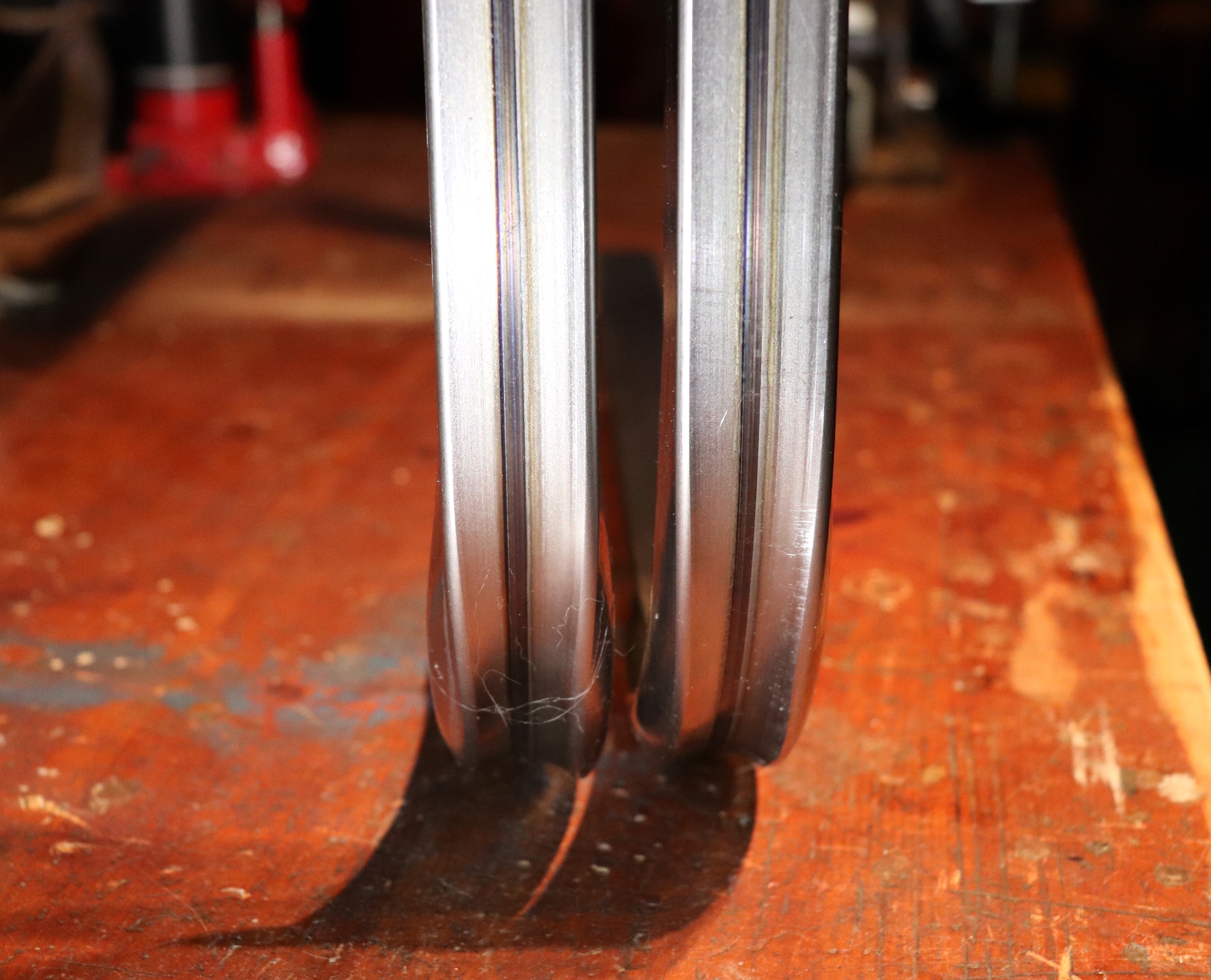

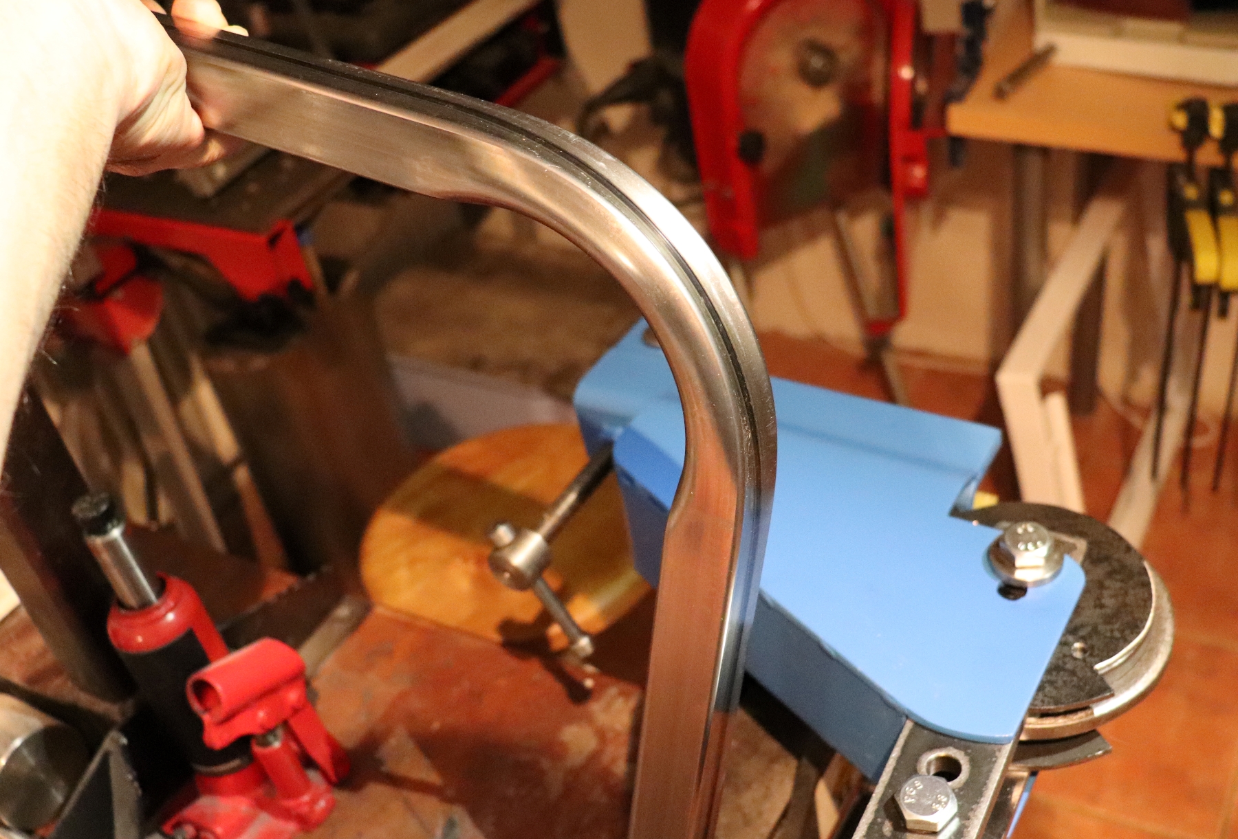

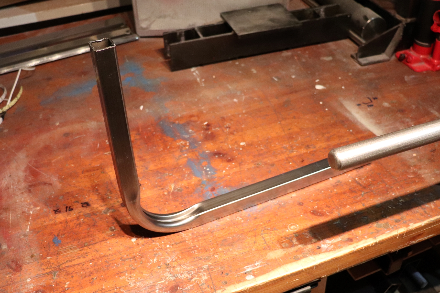

Makes 0-90 degree bends to 25mm ( 1" )- 30mm square tubes.

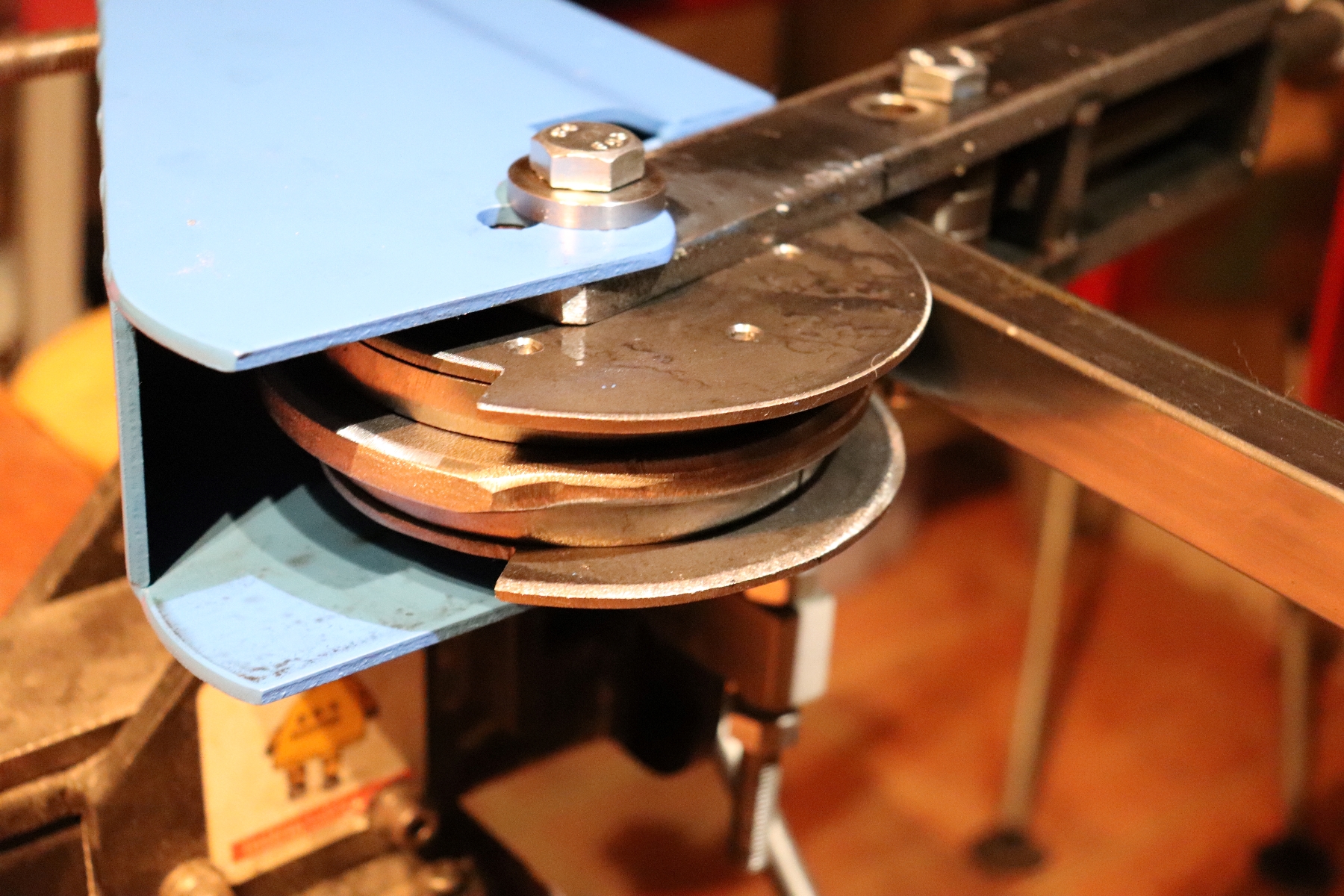

Bending radius is 50mm ( 2" )

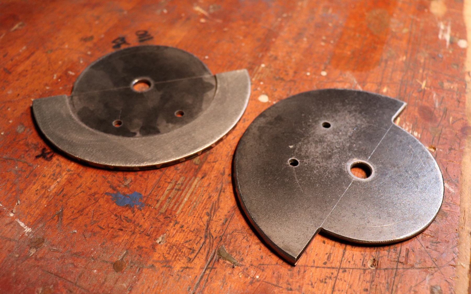

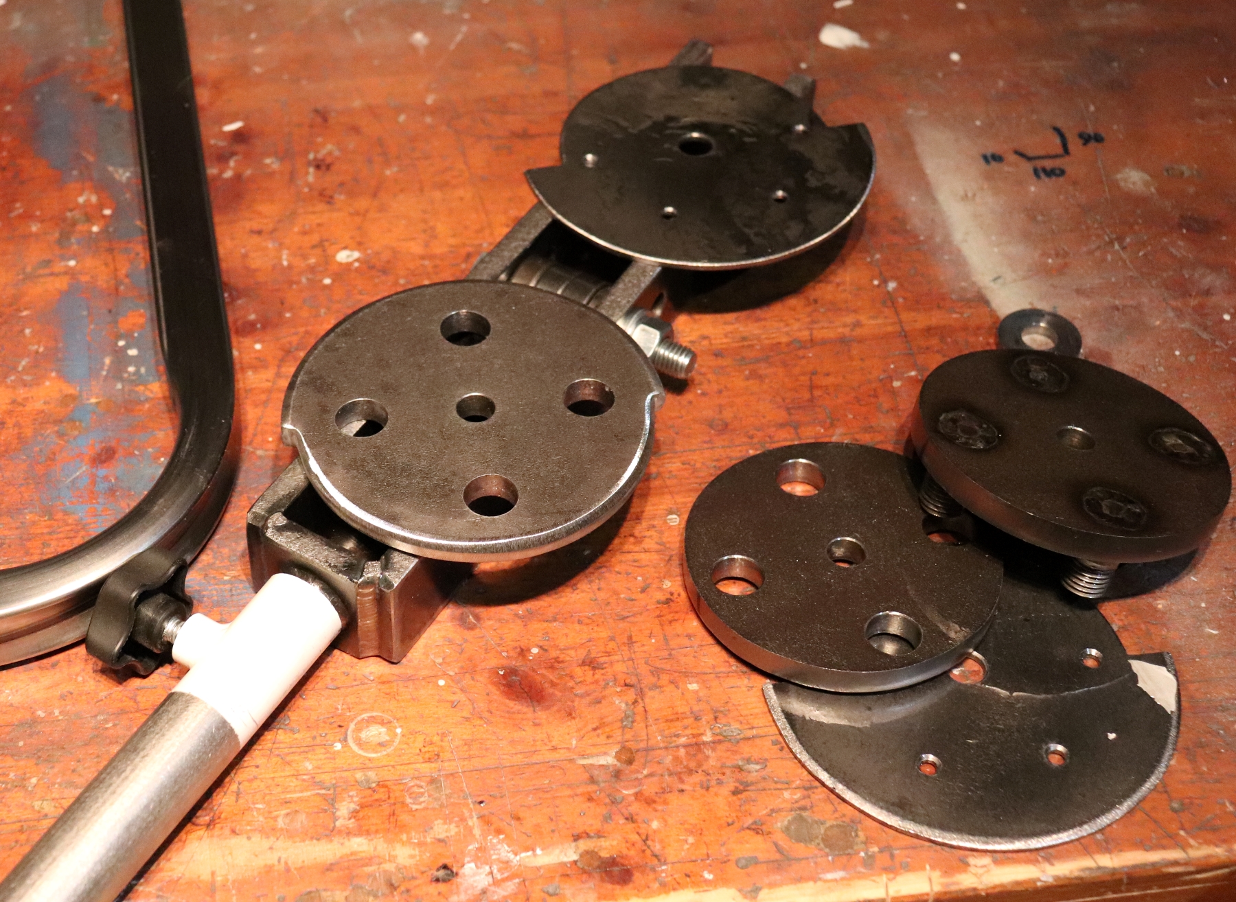

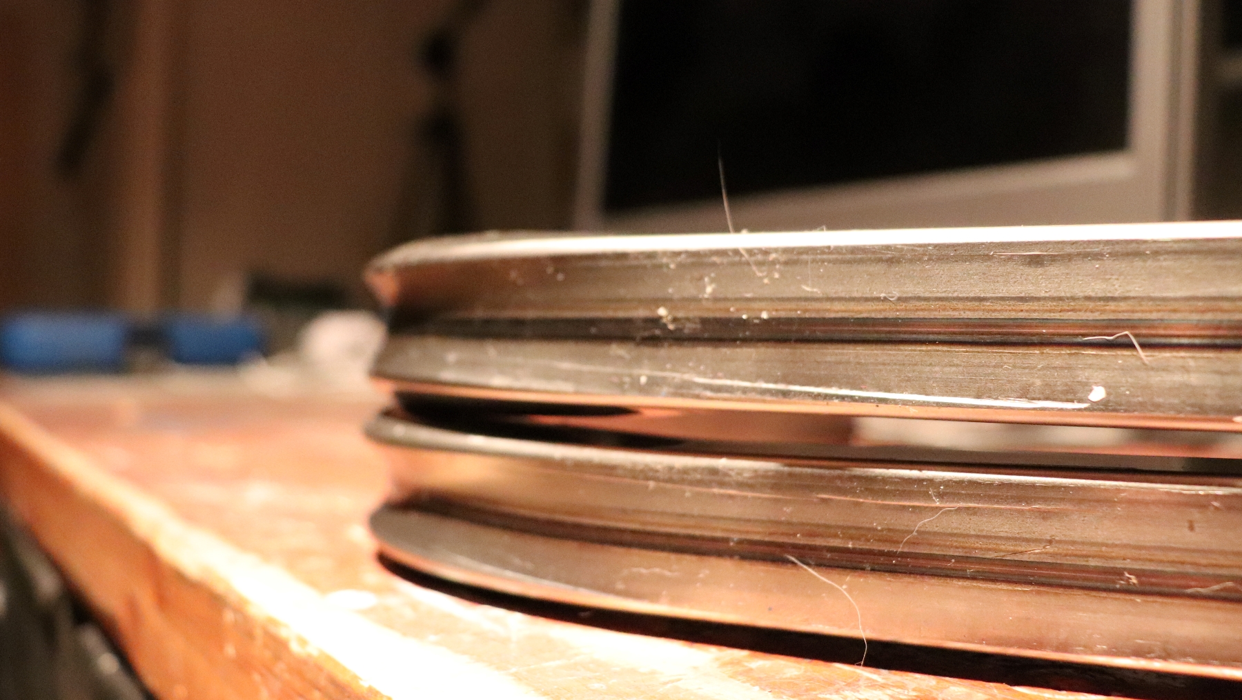

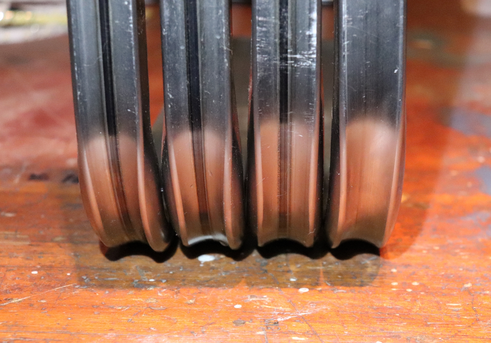

Way that i used for making die, works with round tubes / pipes too.

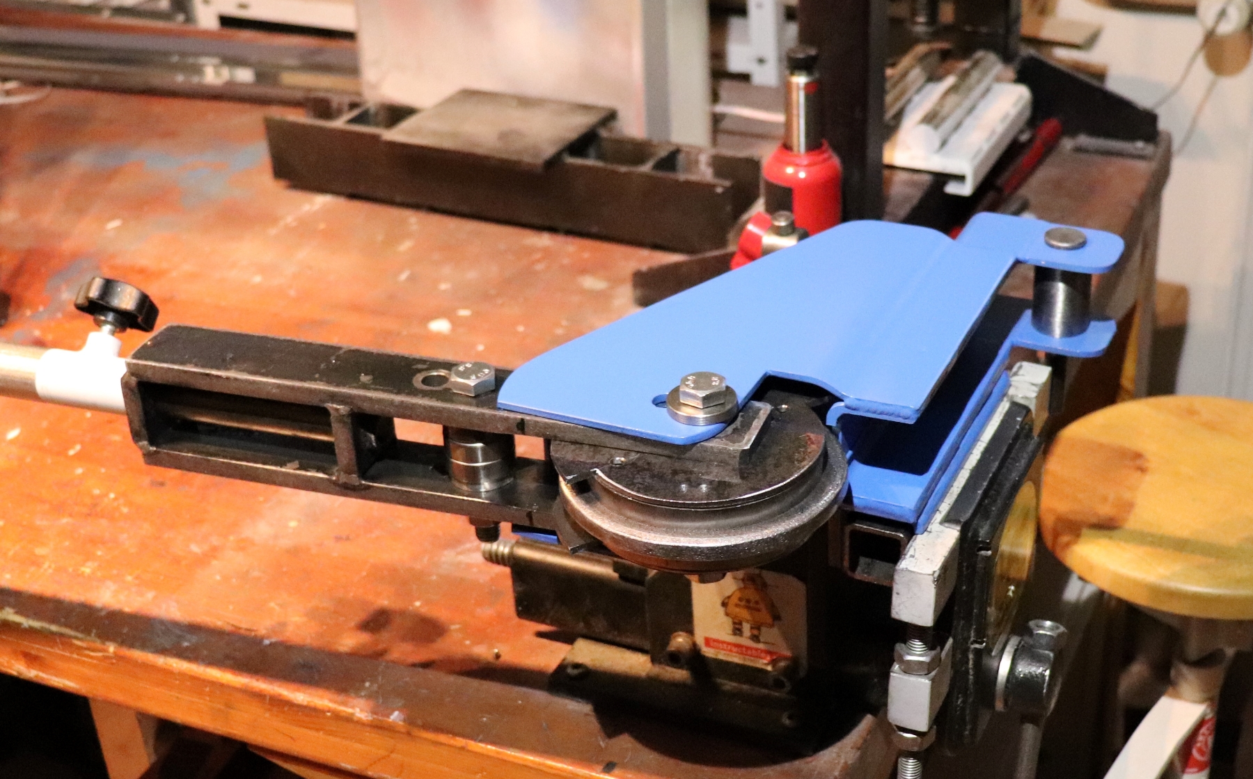

Tool:
Attachment 26952

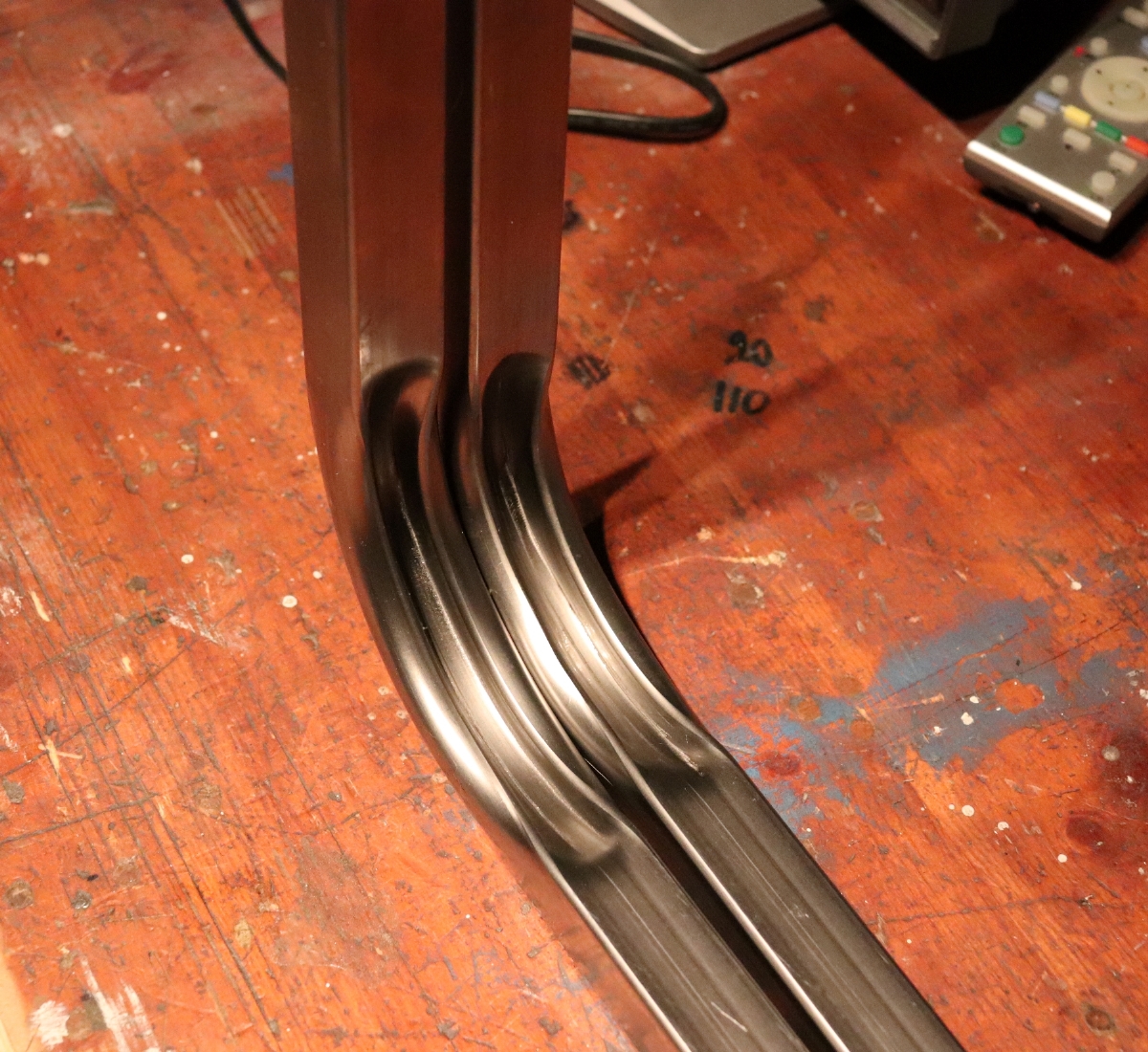

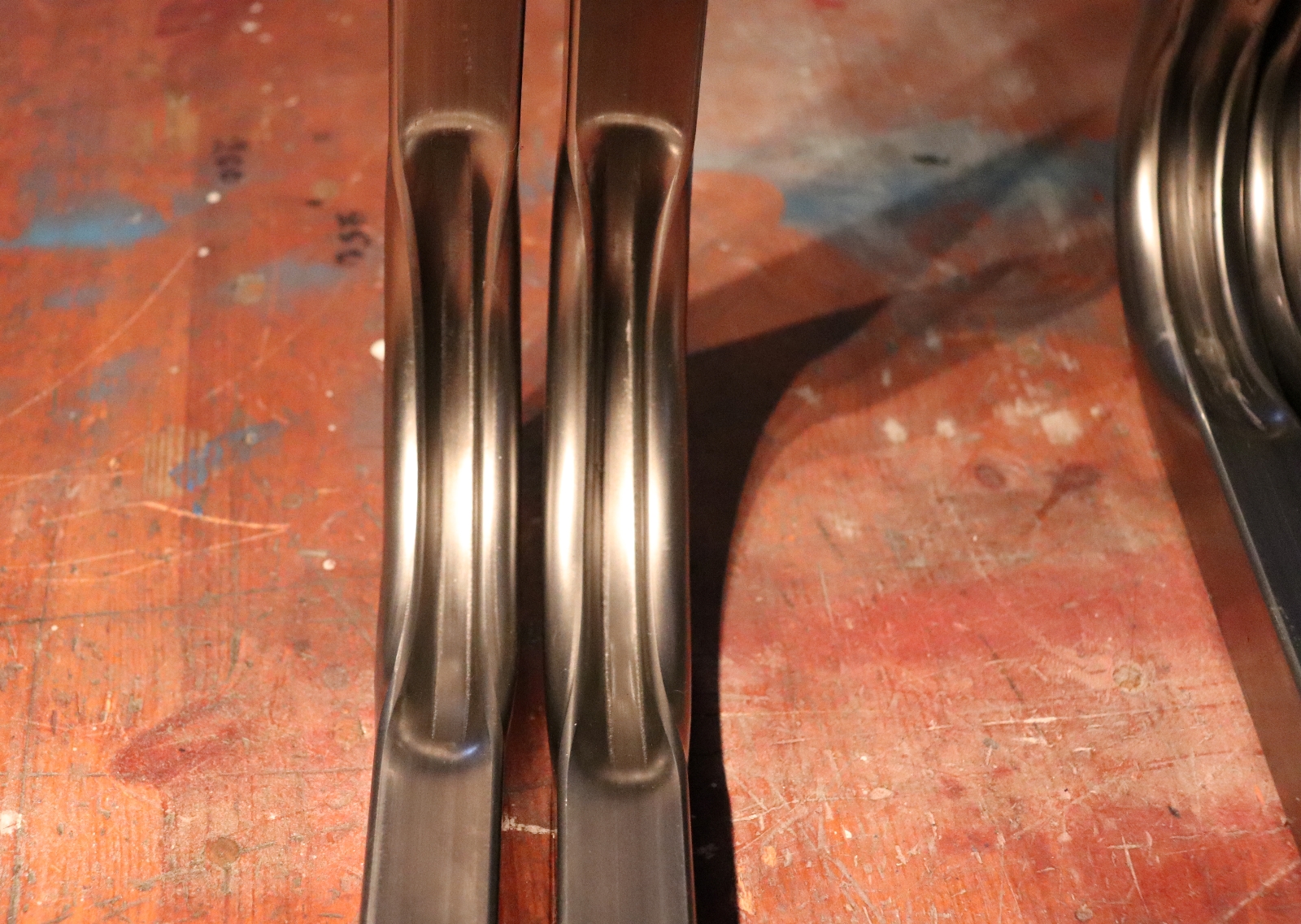

Result:
Attachment 26953Attachment 26954
Fast to use, and somewhat easy and cheap to make.
Die is made from 10mm and 4mm plate.
Arm for the bender made from 50mm x 10mm flat bar and 20mm axle
Body of the bender is 5mm plate and 50 x 50 x 5mm square tube.
