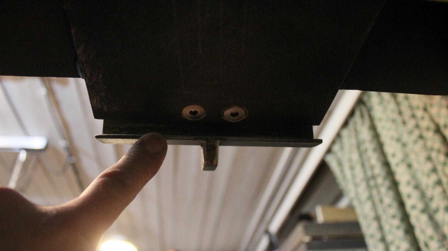

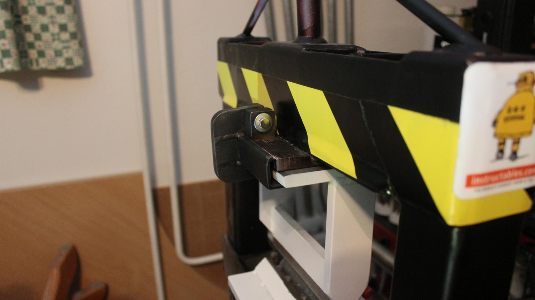

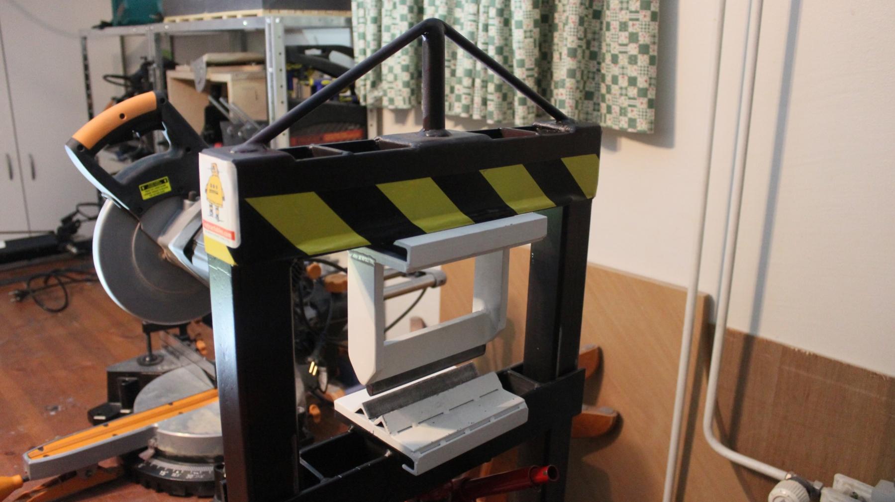

Made a simple improvement from scrap metal that i had.
Latch that holds the upper die. Little more "professional" looking than using clamp.
Because latch works like a hinge, it works even that i have used 10-12mm thick plates when i made my die set.
