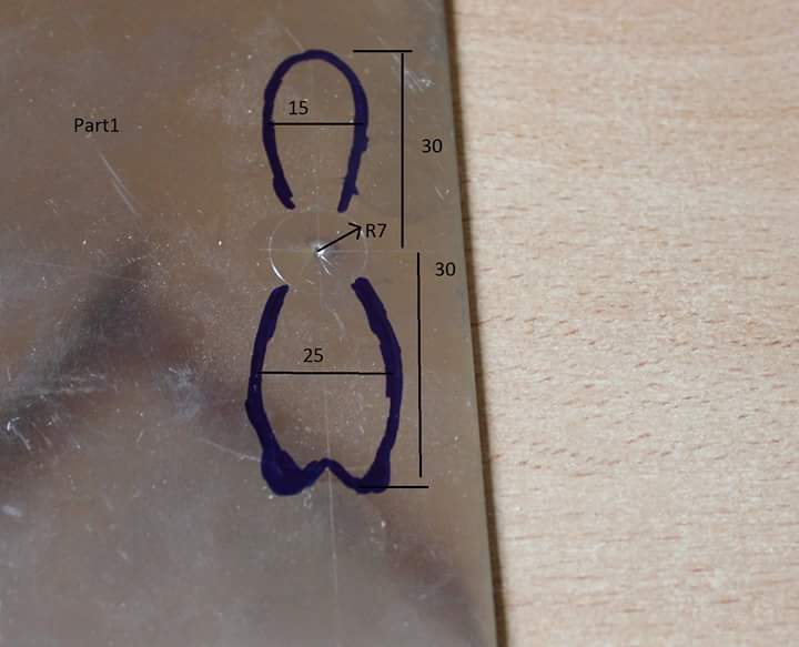

Homemade stainless rose.
Hi.

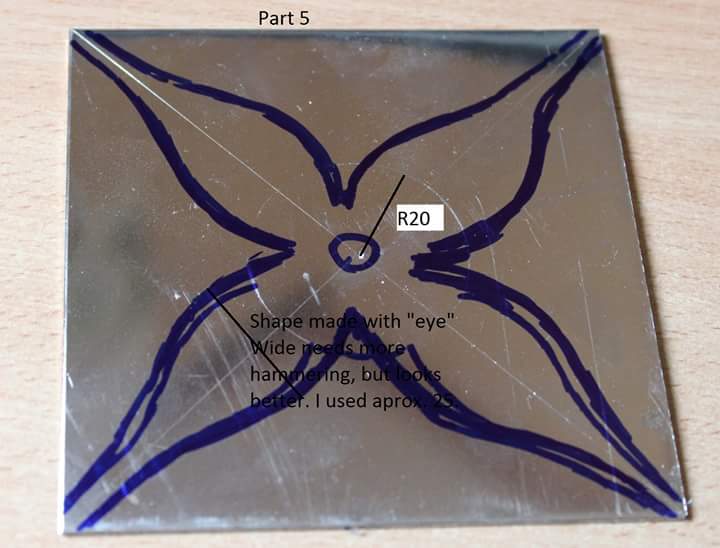

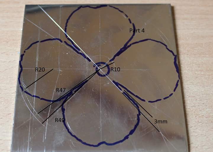

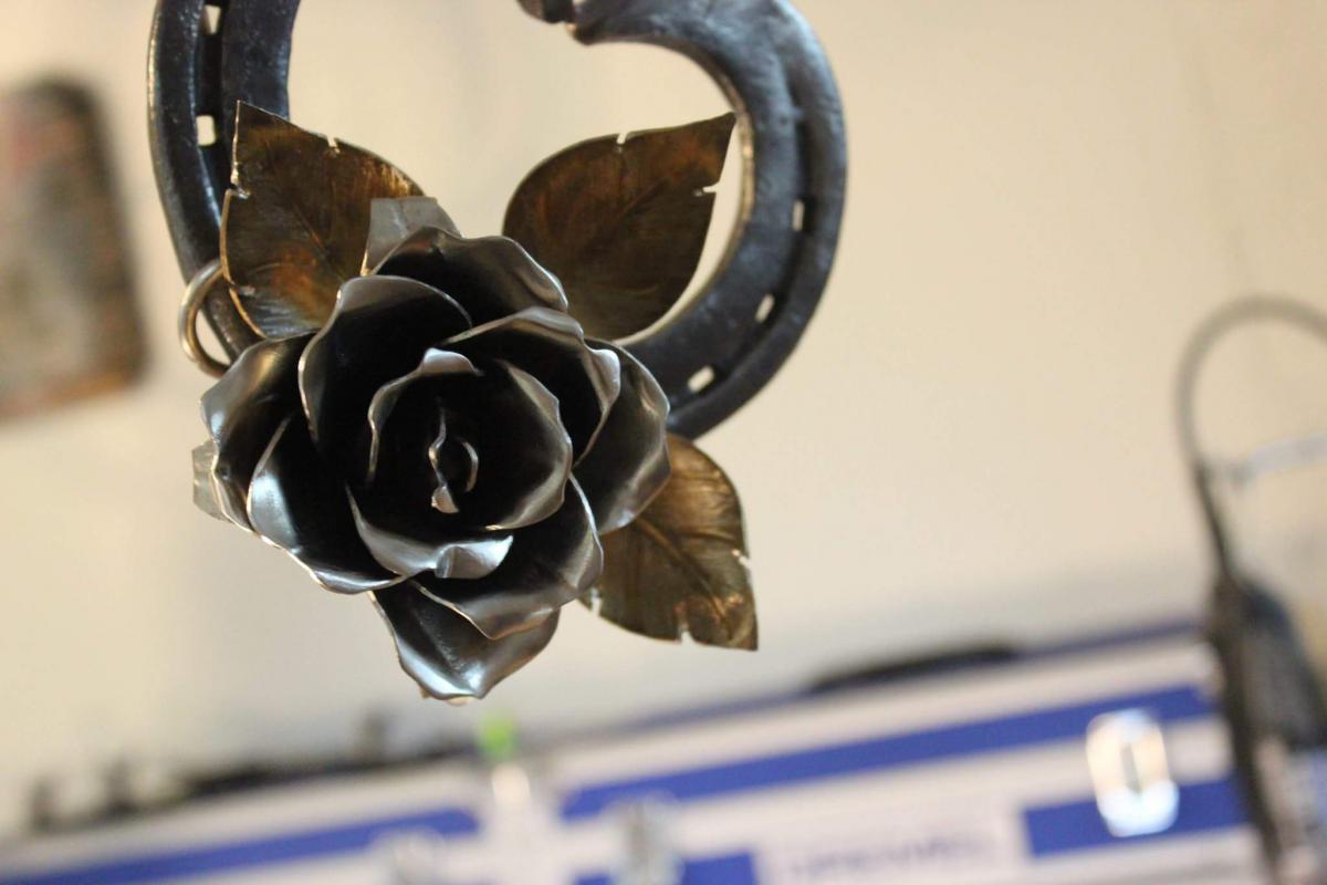

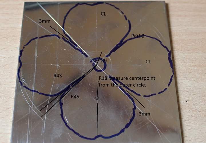

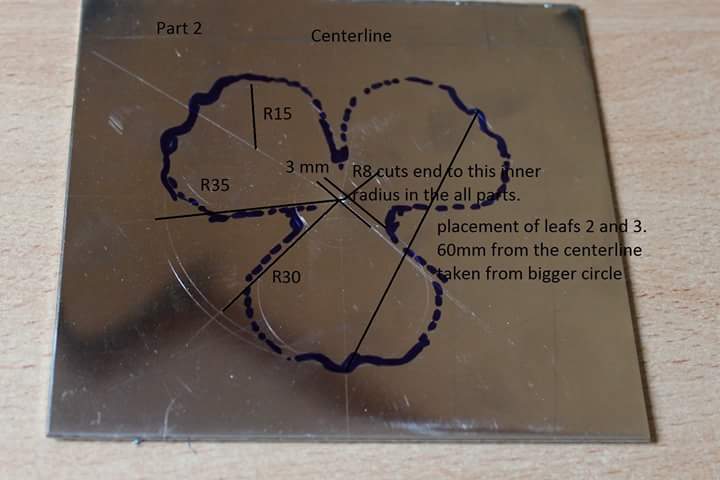

This is my homemade rose. Made from 1.5 mm thick stainless steel.
Here is the part one:
https://youtu.be/fmf6t5dh72M
Second part is coming soon.
I tried to find simple way to make it.
My solution is made from five parts.
Attachment 12488
Attachment 12489
Attachment 12490
Attachment 12491
Attachment 12492

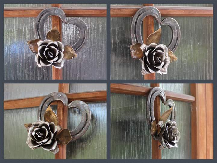

1 Attachment(s)
Thanks buddy!
Here's the finished product at the door of the happy home. ☺
Attachment 13372
