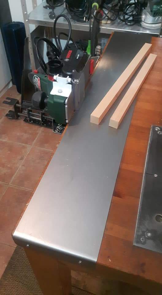

Homemade table mount for powerplane.

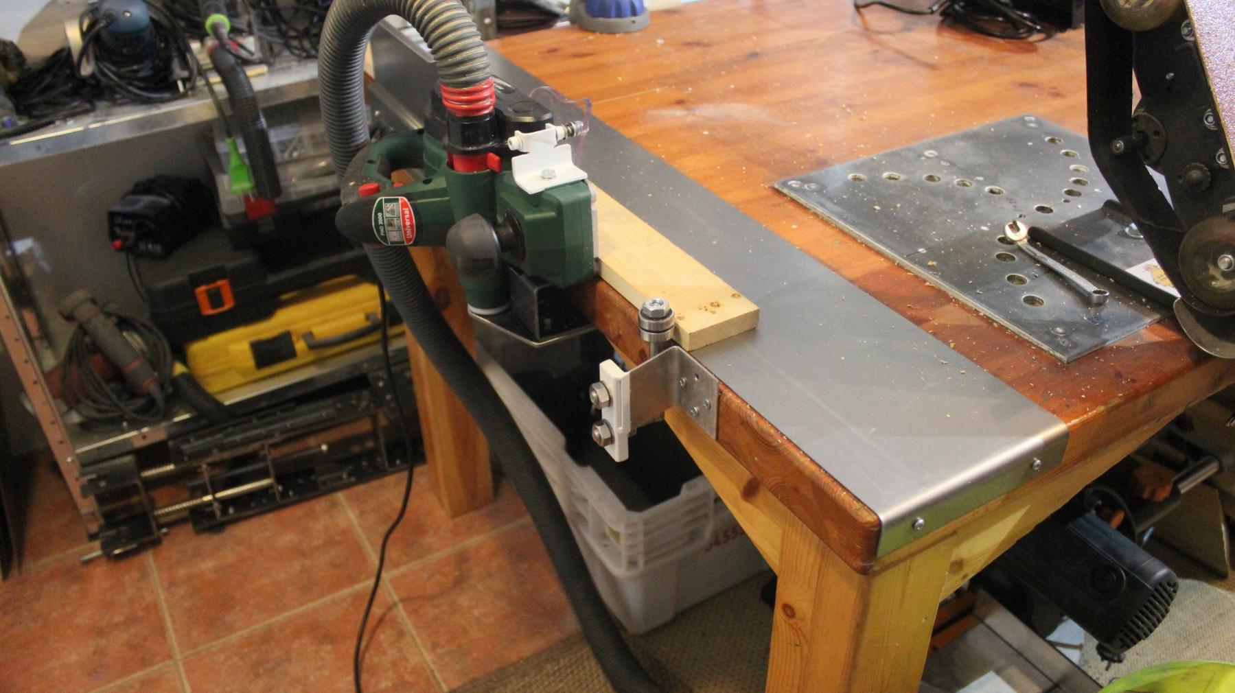

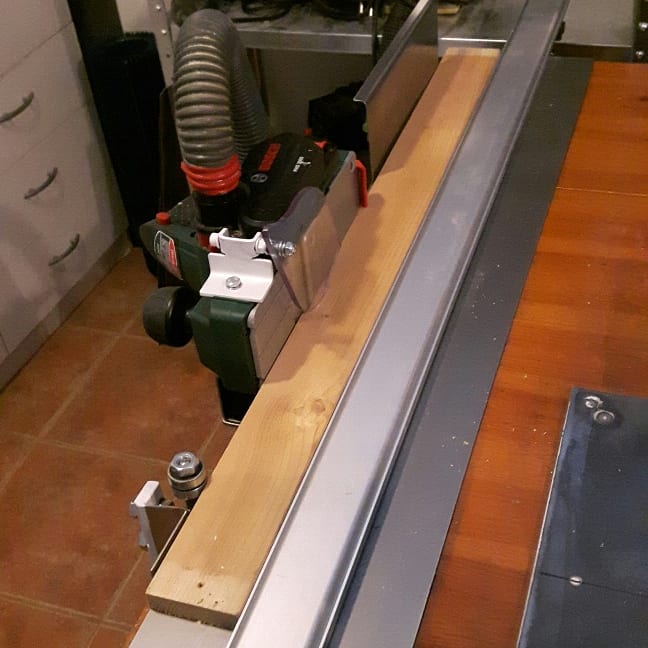

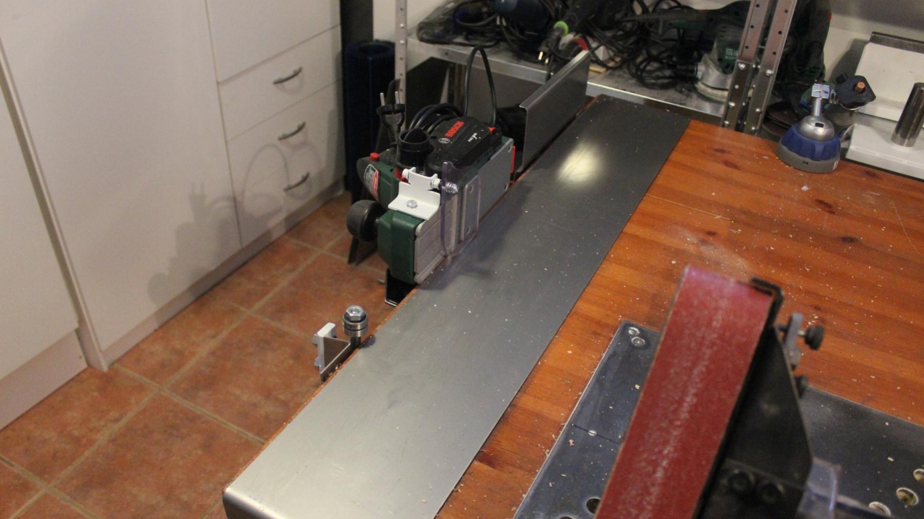

Made a table mount for my powerplane.
Easy to connect and remove after use.
Planned dedicated table at first, but noticed that it takes too much space. So, i decided to make this.

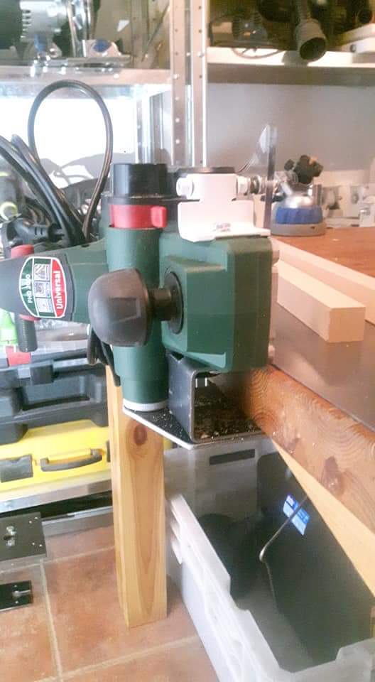

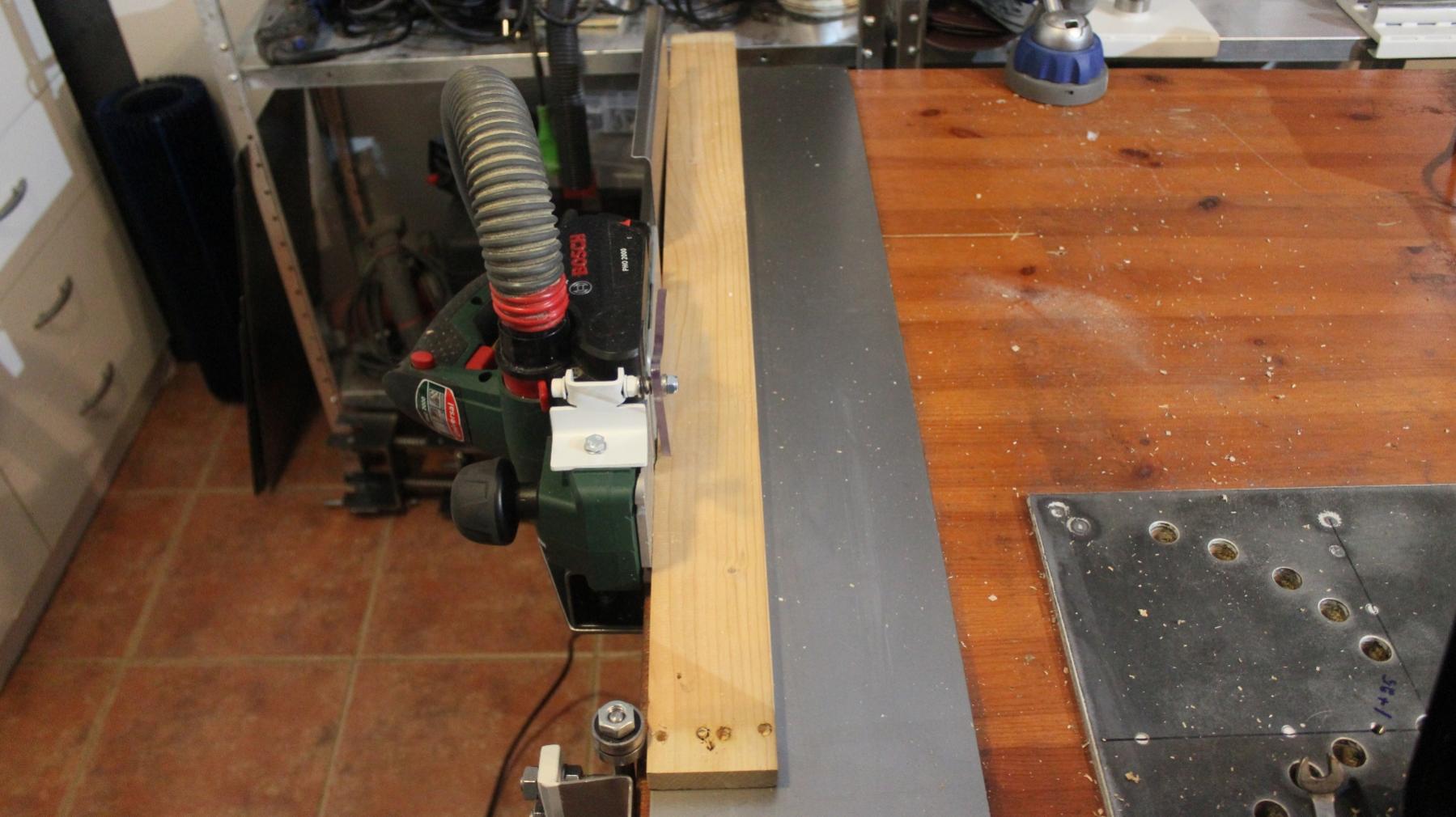

Actual mount. My plane has two extraction ports, i decided to use one to get firm connection.
Port is cone shaped, i turned a piece of nylon to fit in.
Inner end is 44mm diameter, outer 46. Cone shape is 25mm long. Nylon plug is connented to mounting plate with M8 bolt.

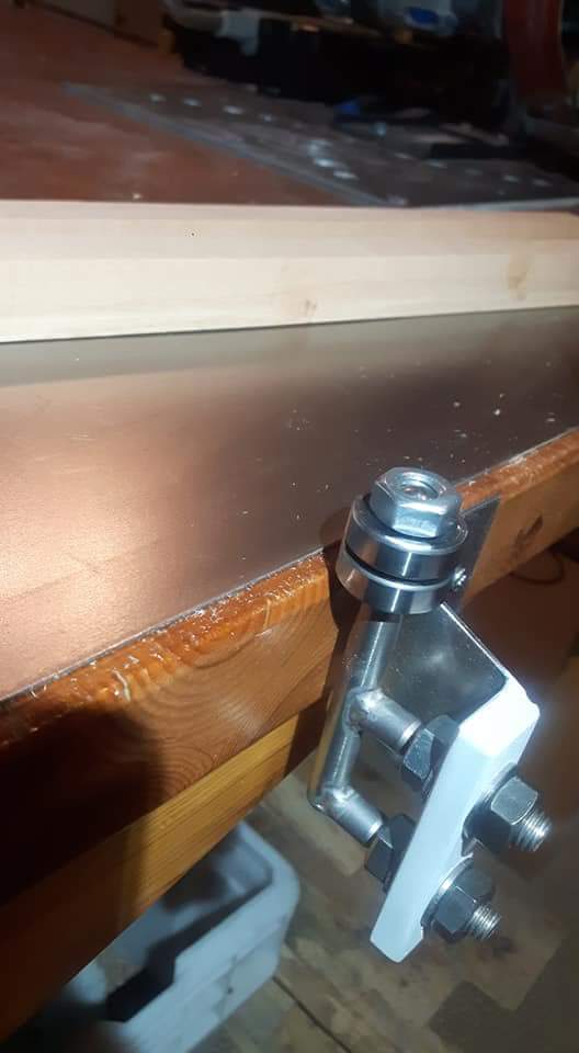

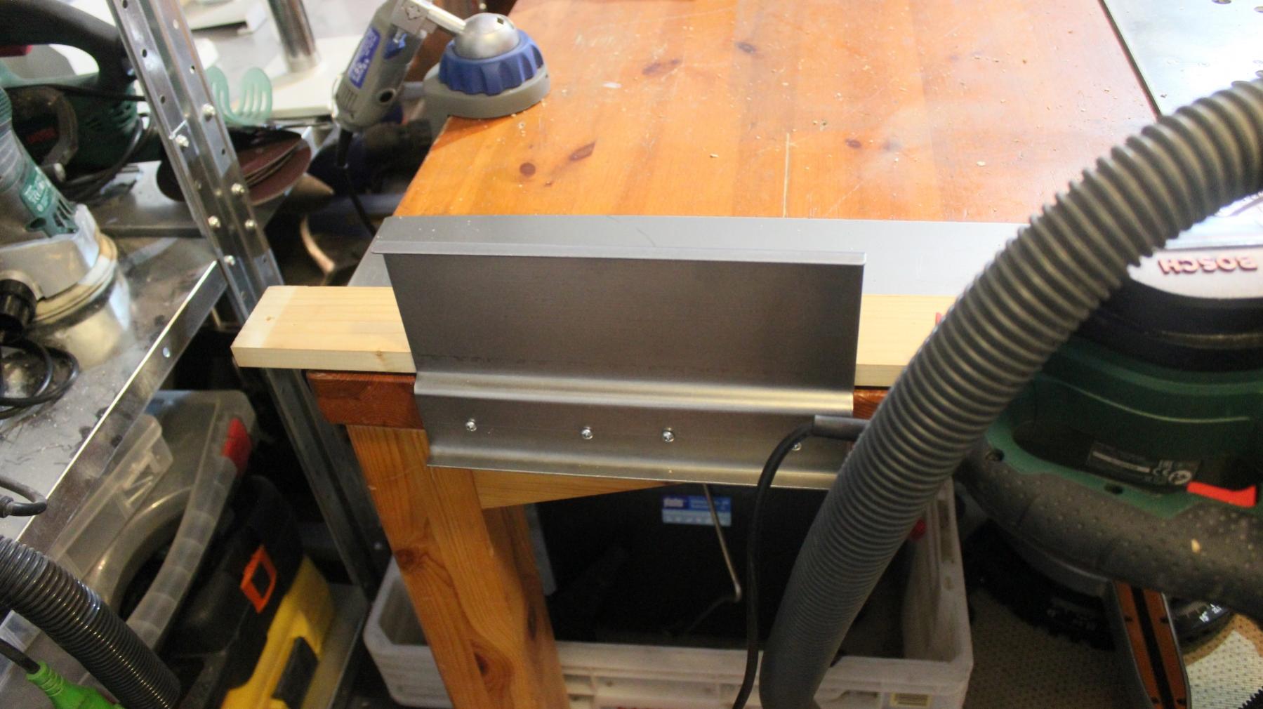

Outfeed support. Bolts, steel and bearings.

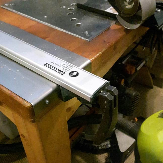

Attachment 22614
2mm steel plate. For better slide. Secured with screws from both ends. And epoxy from the middle.
