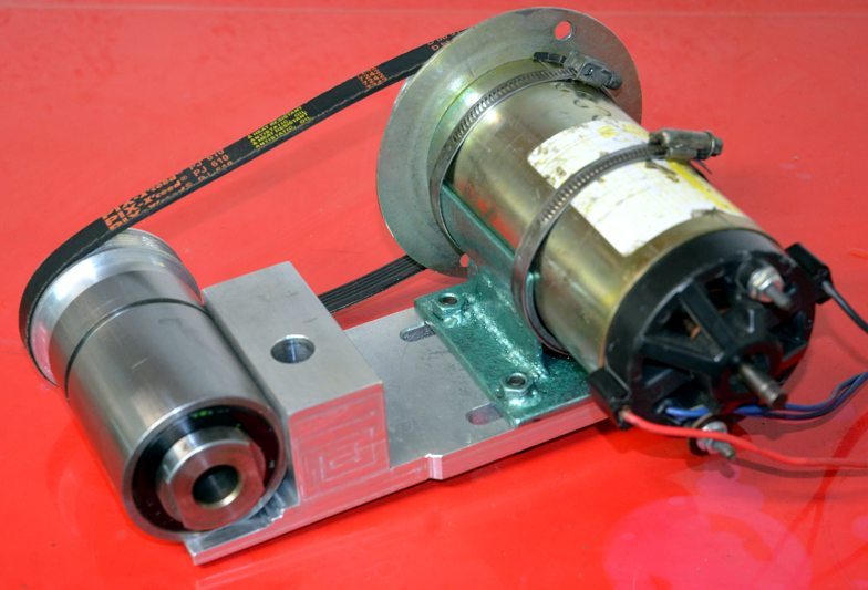

    The basics

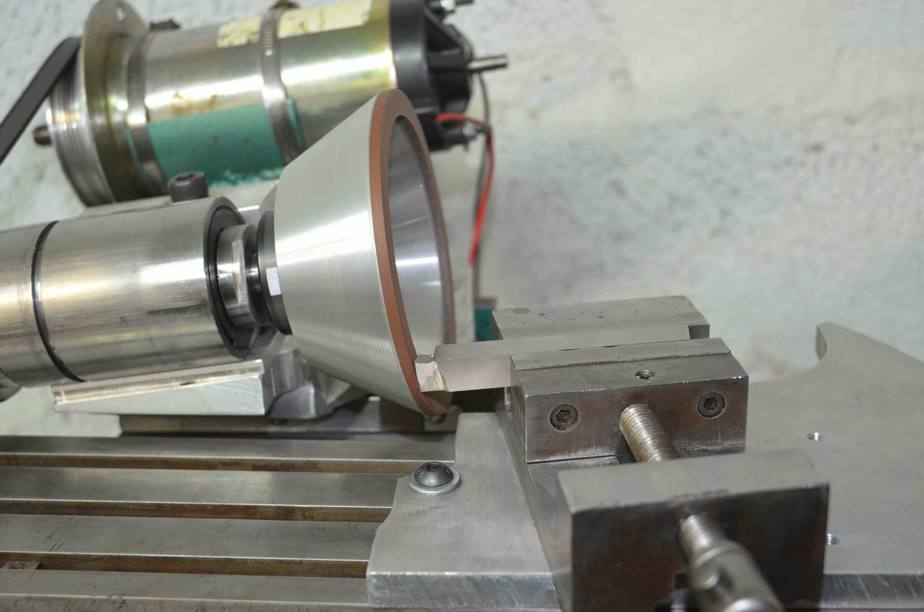

    Three existing items formed the base components of this machine. I had previously built a tool post grinder for my lathe but it was made with a consideration that it might prove useful to be able to attach it to other machines as well. A T&C grinder had been rattling around in the deeper recesses of my mind for quite some time, and the tool post grinder was the final piece of the puzzle.
    A while back I bought, at a flea market, what appeared to be a quill and spindle from a small mill/drill machine. I knew it would be useful one day and it was cheap as well. The spindle had an internal Morse taper No. 2 which was ideal for the grinding wheel arbours as we’ll see. It was as if it was made for my grinder. To power it I wanted a variable speed motor. Options for that were a small 3 phase motor with a variable frequency drive for control or a DC motor which could be controlled by the applied voltage. I had a 2hp DC motor from an exercise treadmill and I decided to use that. The following picture illustrates how the grinding head was constructed from those parts plus some aluminium from the scrap box.
    DC motors have their speed controlled by the applied voltage, for initial testing I simply used a Variac (a variable voltage auto-transformer). Later I made a PWM (Pulse Width Modulation) system for control, I used a double 555 timer chip to provide the variable width timing pulses which were sent to the motor control MOSFET through a gate driver chip for fast switching. Very simple, very few components and which are dirt cheap these days.
    Attachment 15827
    The grinding head, showing the re-purposed mill/drill quill and spindle on the left and the DC motor salvaged from an exercise machine, on the right. The large hole in the aluminium block is to mount the assembly in place of a lathe tool post. Note the MT2 taper in the spindle.

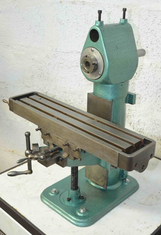

    I also had a small horizontal milling machine which I made from scratch in the 1960s. It hadn’t been used for 50 years and looked to be in poor shape but after dismantling and cleaning it came up as new. It was an ideal platform on which to mount the grinding head to make a capable T&C grinding machine. The mill was described on this forum in a prior posting.
    Attachment 15828
    The small horizontal milling machine which I made around 55 years ago. A good clean and a coat of paint had it back to its former glory. The milling head will be replaced with the tool post grinder head.

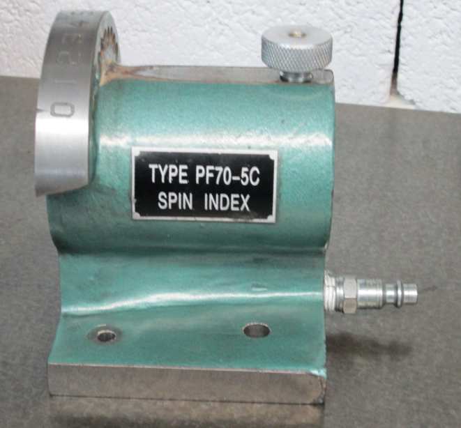

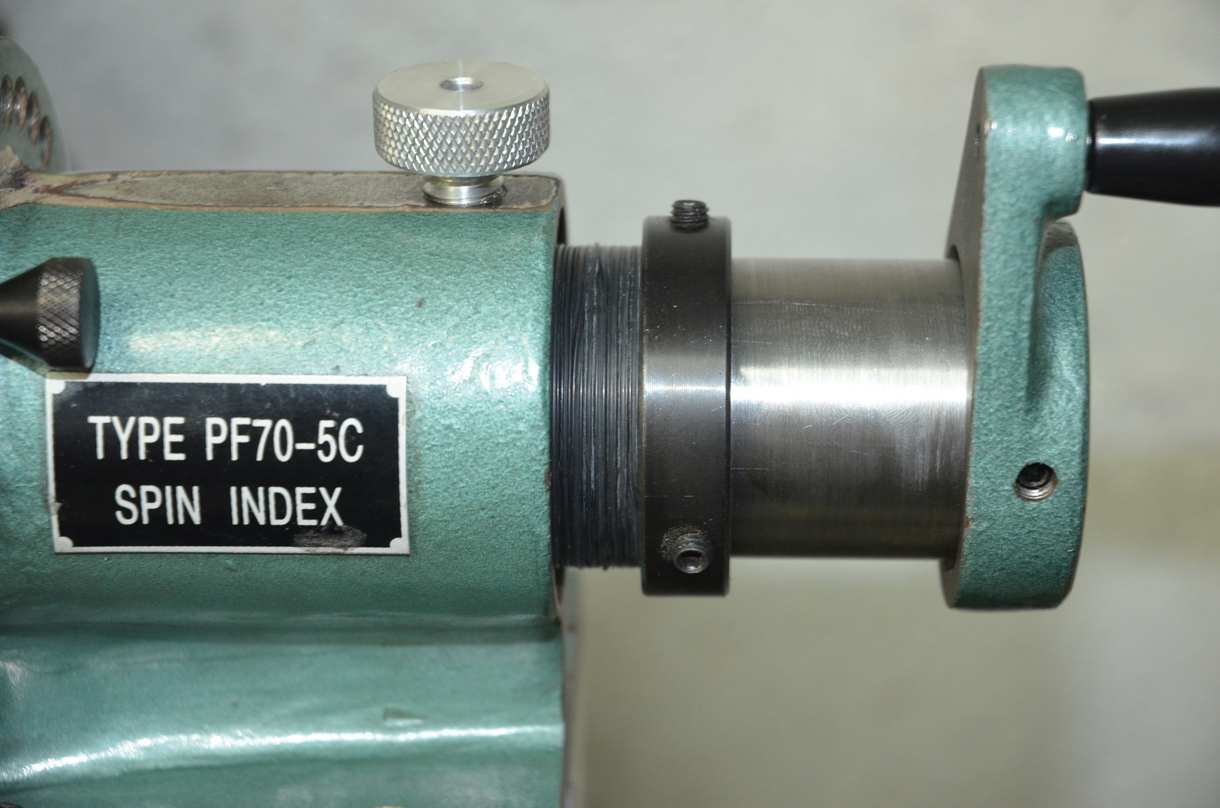

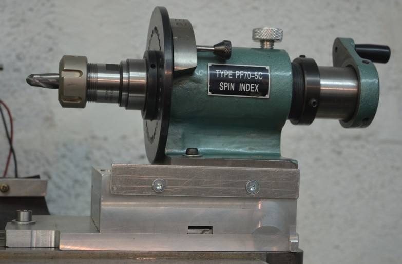

    The third item to complete the machine is a what is called a Spin Indexer (or Spindexer). Which is a holding fixture with a vernier adjustment which allows rotary motion in 1 degree increments. It comes with a through hole to take 5C collets. I also have an ER25 chuck with a 5C arbour so overall I am well covered to hold drills and milling cutters from 1mm to 25mm. This indexer will allow drill bits and milling cutters etc. to be rotated about their own axis to present the cutting edges in turn to the grinding surface.
    I made some modifications to improve the spindexer which are outlined in Appendix 1, at the end of this document.

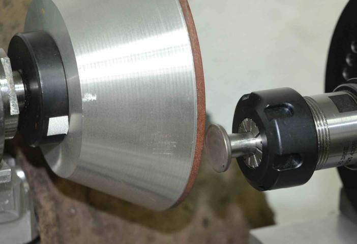

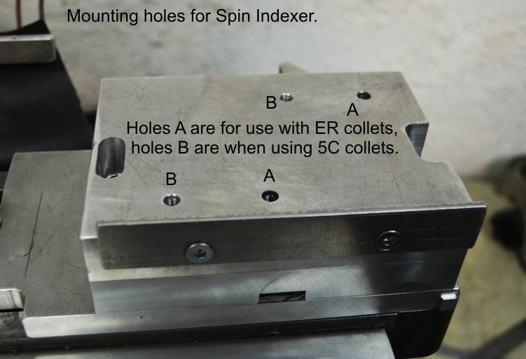

    An aluminium block is the mounting for the grinding head. It is spigoted to the vertical mill column and can rotate about a Z-axis. The block is offset to the left to reduce the needed overhang of the mill table and indexer. The Spin Indexer is mounted directly to the mill table, this will be changed later.
    The only items that I didn’t already have were suitable grinding wheels. There are many shapes of wheel available for T&C sharpening but unless you are sharpening tools on a frequent basis it becomes uneconomic to keep a wheel for every type of required cut. I choose to get identical flaring cups, one of CBN and another of diamond. Flaring cups are a good overall compromise and allow most types of cutting. CBN is great for steel tools, it cuts cool and can be used dry or with liquid coolant, it has high metal removal rates and wears very little itself. Diamond is the abrasive of choice for use with tungsten carbide tools, but is unsuitable for steel.

    The smaller industrial grinding wheels like these generally have a 1.25” (31.75mm) mounting hole. Rather than remove each wheel from a single arbour when a wheel change is necessary I decided to mount each wheel on its own arbour and then change wheels and arbours together in the interests of accuracy and repeatability. This was the main advantage of using a spindle with a MT2 taper. The easiest and quickest way to get suitable arbours was to use standard arbours made for boring heads, modified by turning the mounting down to 1.25”.
    Homemade Tool & Cutter grinder (with a difference).-tandc-grinder-0.jpg Homemade Tool & Cutter grinder (with a difference).-tandc-grinder-35b.jpg Homemade Tool & Cutter grinder (with a difference).-tandc-grinder-35.jpg
    Left shows the threaded arbour for a boring head. The thread was turned off down to a parallel diameter of 1.25” to suit the wheels.The others show the assembled wheel and arbour complete with a draw bar to hold the taper into the grinder spindle.

    The construction and manner of use of my T&C grinder evolved over the short period of the few days of its construction. Normally, I tend to think through every aspect of something that I am about to make but in this case I didn’t. I started making it without much prior thought and as a result I had to make a few changes along the way. There were basically 3 iterations.

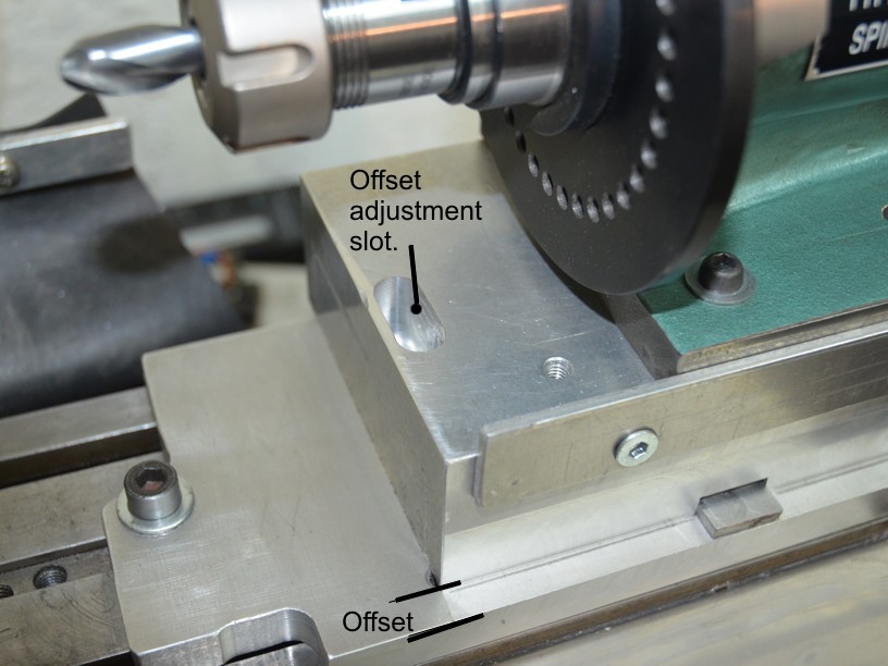

    The first saw the Spindexer bolted directly to the mill table with the grinding head able to rotate about a vertical Z-axis. This allowed the stone to be presented to the tool at appropriate angles to get the rake and clearance angles required. This arrangement enabled the vast majority of bits and cutters to be ground but a notable exception was rounded nose cutters. To grind such tools it is necessary to be able to rotate the tool point itself about a vertical axis. That on its own was insufficient though, as it would be impossible to grind the clearance angle equally around the curved nose.

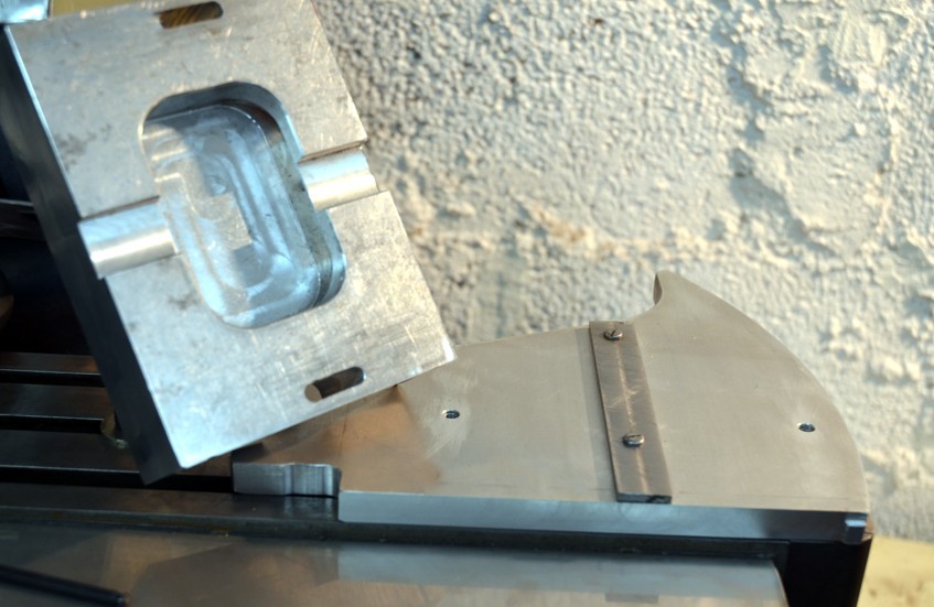

    The next iteration was to solve those problems. The Spindexer was mounted on a plate which could rotate about a vertical pivot bolt and the grinding head was then rotated a fixed amount about a horizontal Y-axis by machining its mounting plate at a 7 degree angle, which is a good compromise 1st clearance angle for many tools. The machine now did a good job of ball ended cutter as well as drill bits, end mills and slot drills but it lost the ability to face off a badly damaged tool flat at 90 deg. to clean it up to start over. It also became less suitable for grinding the flutes of tools.
    The third and hopefully final iteration had the Spindexer raised up on a block to achieve more clearance under the grinding wheel, when fitted with a cover. The block at 45mm high is taller than necessary but it was the most suitable piece in the scrap box. Another change was the insertion of a removable wedge shaped spacer under the grinding head. This spacer brought the spindle axis back to horizontal, but the simple removal of the spacer allows the return to an angled wheel face permitting the sharpening of rounded nose cutters.
    Although the grinding head still has the ability to rotate about the vertical Z-axis, I have yet to encounter a situation where this would help in the 3rd and current iteration.

    Grinder mounting block after being machined at an angle of 7 deg. So far this has only been used for sharpening radiused cutters. The other pix. show the wedge shaped spacer which, when fitted, returns the wheel face to the vertical.

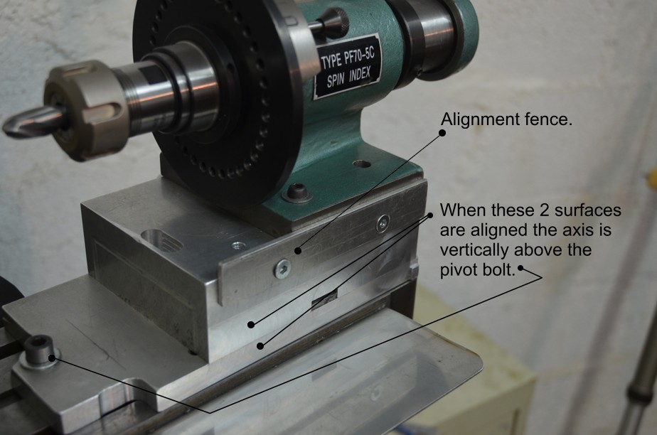

    Mounting plate for the spindexer. Pivoted about a vertical axis, just visible at the top of the photo. Graduated 0 to 45 deg.
    Homemade Tool & Cutter grinder (with a difference).-tandc-grinder-14b.jpg Homemade Tool & Cutter grinder (with a difference).-tandc-grinder-15.jpg Homemade Tool & Cutter grinder (with a difference).-tandc-grinder-14a.jpg
    The above 3 photos show the rotation of the spindexer about a vertical axis to grind all the way around the end of a ball ended cutter.

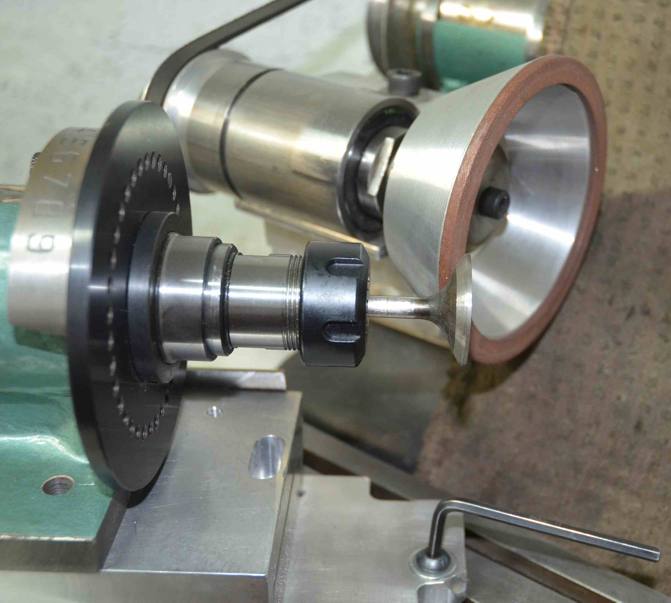

    Here we can see how the centre of the radius on the end a ball ended cutter needs to be aligned with the vertical pivot axis of rotation of the mounting plate of the spindexer.

    Once that I had established that the tool was working OK I fashioned up a cover for the wheel from some sheet aluminium off-cuts that I had left from making some motorcycle fuel tanks. Not visible in these photos is a tube welded to the rear of the cover for connection to a shop-vac. That catches ALL the grinding dust and the rest of the machine requires no additional protective covering. The Gorilla tape fixing of the outer cover was just a temporary measure while I experimented with the size of the opening. I wanted to keep it as small as possible to keep the entrance air velocity high to carry all dust in, but I needed it large enough not to hinder access for the tool nor hinder vision.

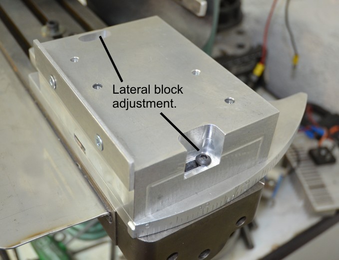

    I hadn’t considered a wheel cover originally and when fitted it prevented lifting the table and spindexer to the required height. As shown above this was solved by lifting the spindexer with the aid of an aluminium block. The block came out of the scrap box and was thicker than strictly necessary at 45mm. I could have milled it thinner but there was no disadvantage with leaving it thick. The addition of this block allowed me add the ability to offset the spindexer laterally (Y axis). I have already described the necessity of aligning the spindexer axis directly above the pivot axis of the mounting plate for ball end cutters. However, that is no good for doing cutters which just have rounded edges rather than being full ball nosed. To grind rounded edge cutters the tool bit has to be offset laterally such that the centre of curvature is aligned vertically with the pivot axis.
    The following photos show details of the block and the slide and groove used to maintain alignment. The pocket in the base of the block is just a legacy of the block’s previous life.
    Homemade Tool & Cutter grinder (with a difference).-tandc-grinder-34.jpg Homemade Tool & Cutter grinder (with a difference).-tandc-grinder-32.jpg Homemade Tool & Cutter grinder (with a difference).-tandc-grinder-33.jpg

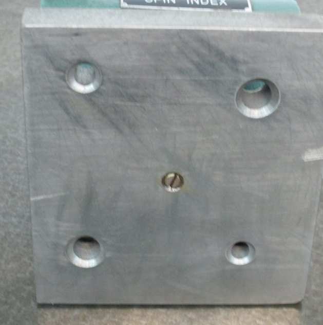

    The above show details of the block lateral fixing method. Note also the two pairs of mounting holes for the spindexer. The forward pair are for use when using 5C collets for tool holding and the rearward pair are when the ER25 collets are used. The side fence on the front of the block is for easy alignment of the spindexer when moved fore and aft.
    Homemade Tool & Cutter grinder (with a difference).-tandc-grinder-29.jpg Homemade Tool & Cutter grinder (with a difference).-tandc-grinder-30.jpg
    These show the assembled spindexer and mounting block etc. The relevant parts and adjustments are annotated.

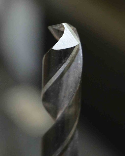

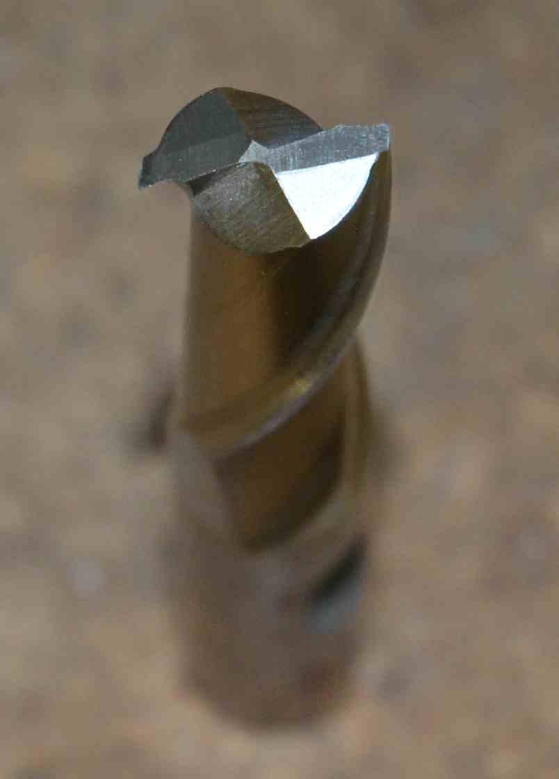

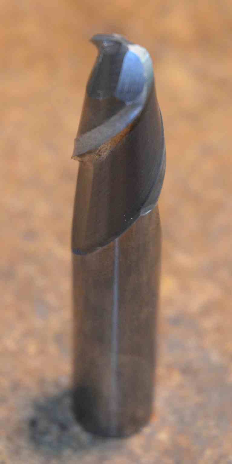

    Homemade Tool & Cutter grinder (with a difference).-facet4.jpg Homemade Tool & Cutter grinder (with a difference).-tandc-grinder-18.jpg Homemade Tool & Cutter grinder (with a difference).-tandc-grinder-08a.jpg Homemade Tool & Cutter grinder (with a difference).-tandc-grinder-09.jpg

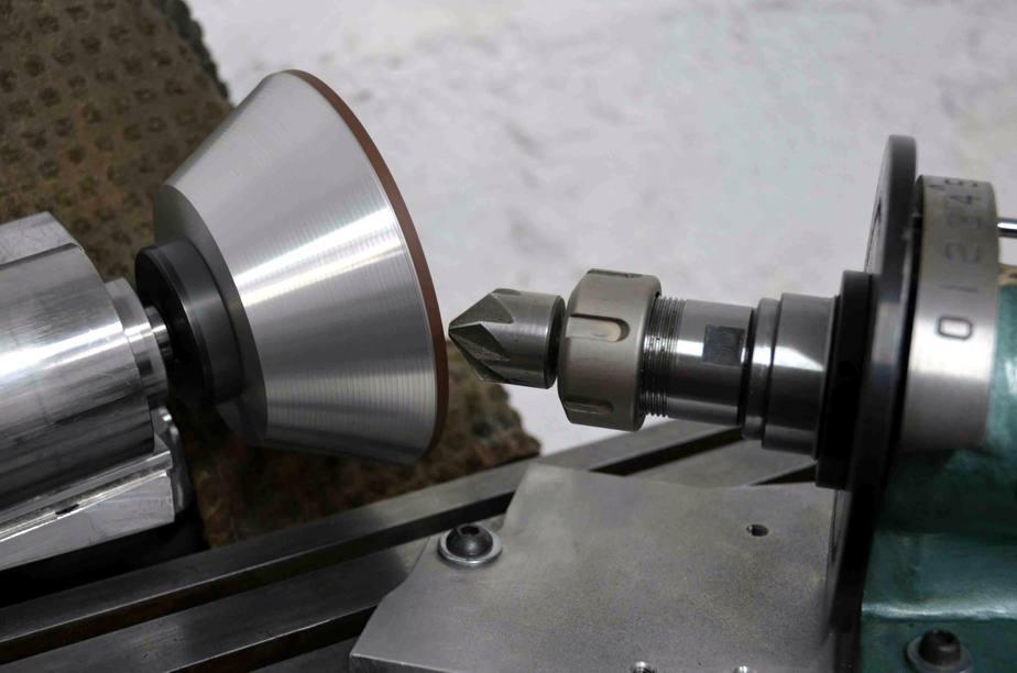

    Here are some examples of tools sharpened as test items during the rapid evolution of this T&C grinder.
    Homemade Tool & Cutter grinder (with a difference).-tandc-grinder-19.jpg Name:  cs 04.jpg

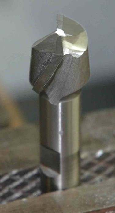

    Demonstrating how a multi-toothed countersink bit is ground. Unfortunately, a single flute version such as the one to the right is not so easy. The smooth surface back away from the cutting edge is not a true cone shape but is a section of a spiral or helix. A cone would not cut properly, the bit would just rub. Therefore it becomes necessary to advance the bit into the grinding wheel as it is rotated. There are different ways to do this but with a spindexer the most obvious way is by means of a face cam. I have not implemented that yet and it will probably wait until I have a bunch of those to refresh. In any case as long as the spiral/cone surface is not damaged these bits can be sharpened by grinding on the cutting edge.

    Although built to be a T&C grinder I have found several other uses for it. Two of which shown above. One show it being used to reface a valve. I have a dedicated valve grinder and I had spent some time in the past looking at it with a view to using it as the base for the T&C grinder, but I never found a good way of doing it. Otherwise this post would have been describing that. The other photo shows it facing off a tappet base, It did a great job of that.

    Appendix 1– modifications to the spindexer
    In common with many tools from the east, I regarded the spindexer as a kit of assembled parts which needed finishing.
    My first task was to dismantle spindexer and machine all surfaces, the base and side/end edges, true to the spindle bore. The bore itself was pretty good and parallel as far as I could measure it. I made a mandrel that fitted the bore and used that as the reference for the other machining operations. I can now trust the alignment of the device.

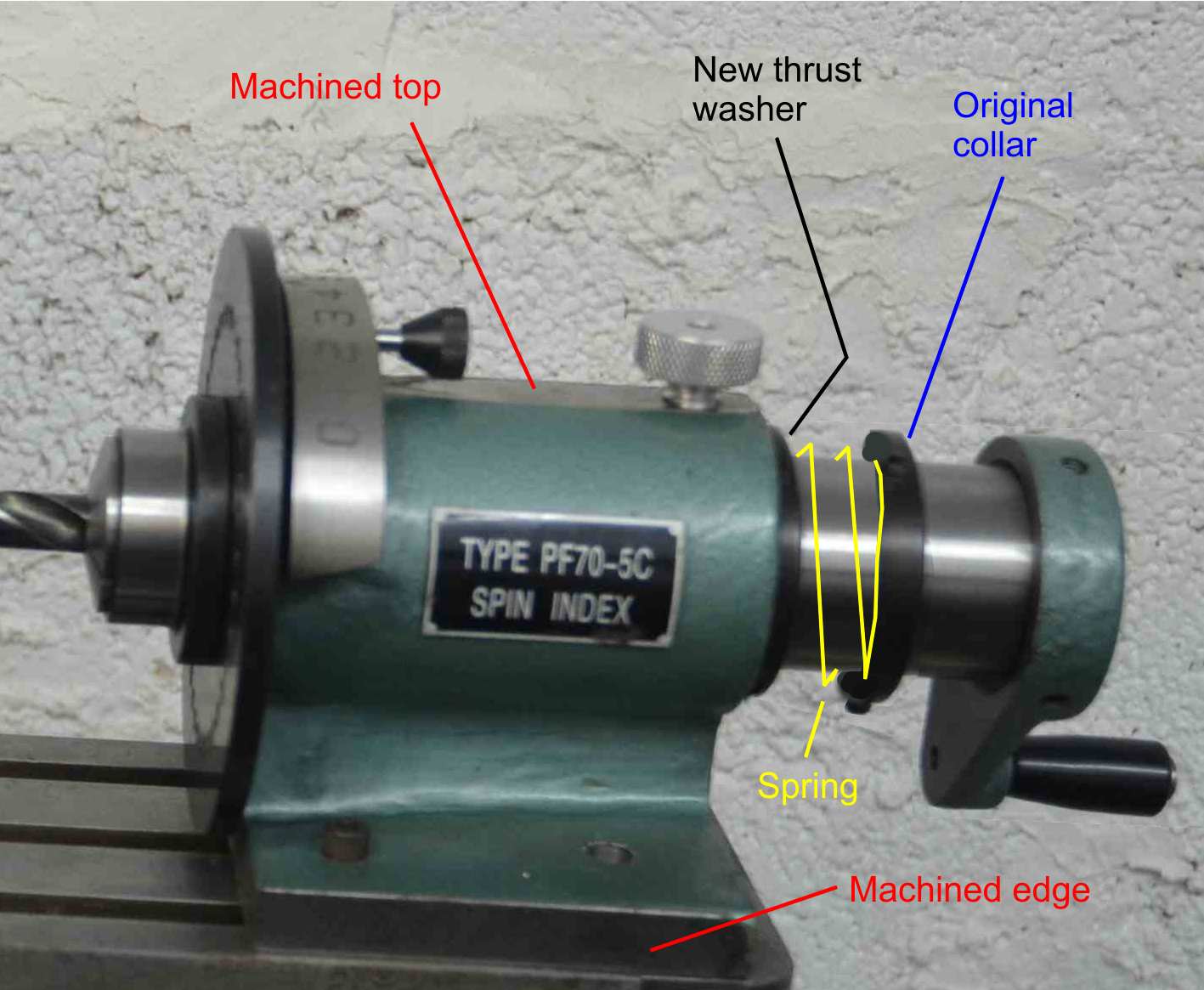

    The second thing that needed attention was the method of end float control of the rotating hollow shaft. The stock system is a collar on the rear of the shaft which is held in place by 3 grub screws. It was next to impossible to set this to zero end float without making it stiff and notchy to rotate. End float can affect the depth of the grinding cut and so it is important to remove it to achieve equal height cutting edges on multi-flute tools. The following shows how I proposed a spring loaded collar system to take care of the end float.
    As it turned out I couldn’t find a suitable sized spring but I did have a bunch of X section O-rings, so I packed a few of those on the shaft in place of the proposed spring and said goodbye to end float problems. The following shows the actual solution with the stack of O-rings in front of the original collar.

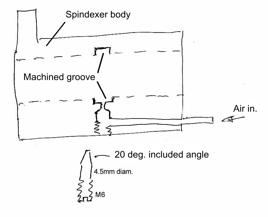

    The final modification is to help with grinding the flutes of end mills and reamers. So far the examples shown for grinding tools have focussed on the end cutting edges but side cutting milling tools, drill bits and reamers also get worn on the flutes. Drill bits, mostly have their flute wear near the cutting end and we also rely on drill bits being a given diameter. So often it is better to simply cut off the end part and regrind only the tip. Reamers also are important to be a specified size but they tend to wear over a lot of their length so the only real reclaiming option is to grind the reamer down to the next useful diameter. Milling cutters, on the other hand, are still useful even when ground a little undersize. In order to cut helical flutes it is necessary to move the bit being sharpened along its axis at the same time as rotating it. To allow axial motion with the spindexer it is only necessary to remove the end float collar (and O-rings in my case). The shaft can be moved radially and axially. A stop is used on one flute to maintain the correct helix angle as the tool is fed along the grinding wheel. To achieve a smooth and accurate action whilst doing this double movement, it is necessary to have as friction free and smooth action as possible. The stock spindexer motion wasn’t bad but I thought that it could be improved by making the spindle float on air – turn it into an air bearing. To this end I machined a groove around the inside of the spindexer bore and drilled some holes to feed it with air as shown in this sketch.
    I have designed flat surface air bearing before and so I knew a tad about the requirements. To get a successful efficient air bearing it is not just sufficient to feed air to a groove, at some pressures it might seem to work OK until loaded. It is necessary to feed the air in through a restriction fed from a reservoir. Larger feed pipes are usually sufficient for this. In order to have some setup tuning capability I made an adjustable restrictor as shown above. I put Loctite on the threads, and adjusted the screw for the best action and let the Loctite set.
    Without the air feed the shaft will rotate between a half and a full revolution when spun by hand, with the air bearing working it will spin for several turns and the whole action is much smoother. Air consumption is minimal and with fading hearing I can’t hear the air exiting, but my dogs can. The air bearing is only used when doing flutes, it is not necessary for normal point sharpening.
    Appendix 2 – Explanation of single angle setting
    I had a hard time believing how complex the usual multi-axis T&C grinders were. It was the idea of cutting down on the number of independent axes to making just two that appealed to me. Just as if you want to move on an X,Y plane from 0,0 to 10,25 you can do it the long way and move to 10, 0 and then 10, 25 or the easy way in a single shorter diagonal move direct to 10, 25. You can do the same with angles. A simple calculation results in a single angle between the drill bit and the face of the wheel.
    Imagine a plain flat rest set at 90deg to the face (side) of the wheel, then lay the drill bit on that with the cutting edge horizontal and the drill angled on the rest such that the whole cutting edge is touching the wheel. If you ground the bit like that you'd get zero clearance angle, but now rotate the bit about its own axis. Now you have a non zero clearance angle but the outside edge will have pulled away from the wheel, now angle the bit a little until all the cutting edge is touching. In that position you only have to plunge the bit into the wheel to grind the first facet of a 4 facet bit. Twist the bit some more and re-angle it and you can grind the next facet with more clearance.
    So instead of a relatively complex sharpener all you need to do to grind a 4 facet bit is to mount your drill in some form of holder which can rest on a horizontal plane normal to the wheel and be angled sideways and with provision to rotate the bit about its own axis. I see a $40 spin indexer fitted with an ER25 collect chuck as the bit holder.
    To use, just insert the bit in the chuck, angle and rotate it according to the calculations for the required bit included angle and clearance angle and plunge into the wheel up to a set stop or other means of determining the grinding depth. Or else you could feed the wheel to the work.

    Here are a couple of photos to go with the sketch of the air bearing modifications.
