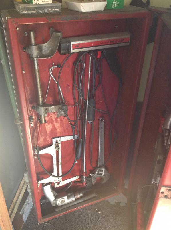

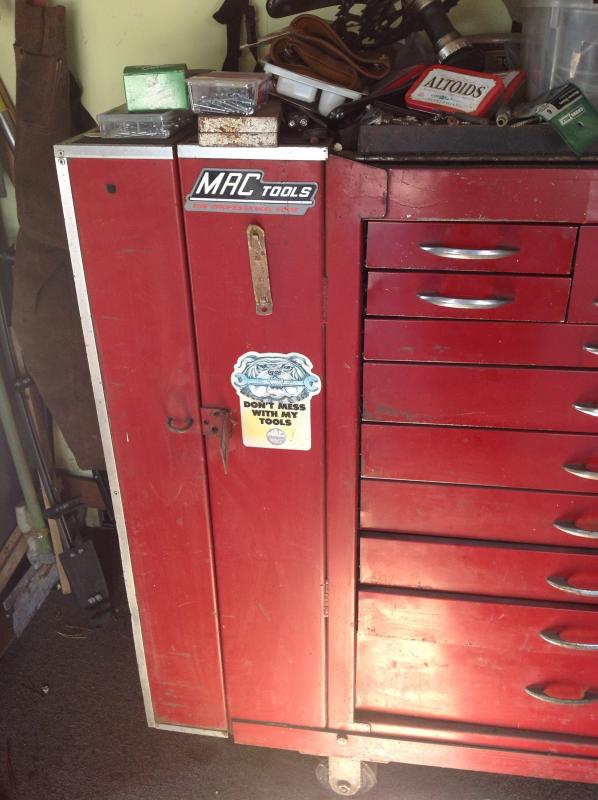

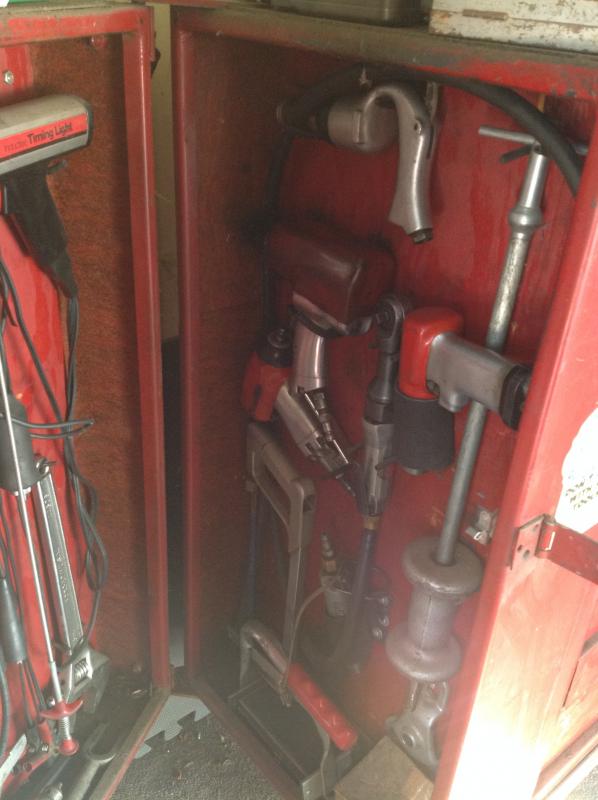

In the thread about shop organizing I mentioned one my first major tool organization projects in '83. As a line mech I realized my rollaway was being eaten up by air tools and test equipment. For me top boxes never worked as the top of my rollaway was also often my only workbench. So to address the air tools/test equipement I decided to build what I call a clam shell box for the left end of the rollaway so everything could hang instead. I had the main body of each side broke with the tops and bottoms separate and welded them in. The whole thing is 14ga. And rather than pegboard I just used 3/4" plywood painted and used nails with rubber vac hose as the hangers because I knew where everything was going to go anyway. The main box is an old Waterloo with a SnapOn side box and two other boxes I fabbed underneath and behind to make it all usable. The first pic also demonstrates why I don't have any fixed benches because even though that stuff on top is all stuff I can't toss, I don't have a use or place for it yet :(
