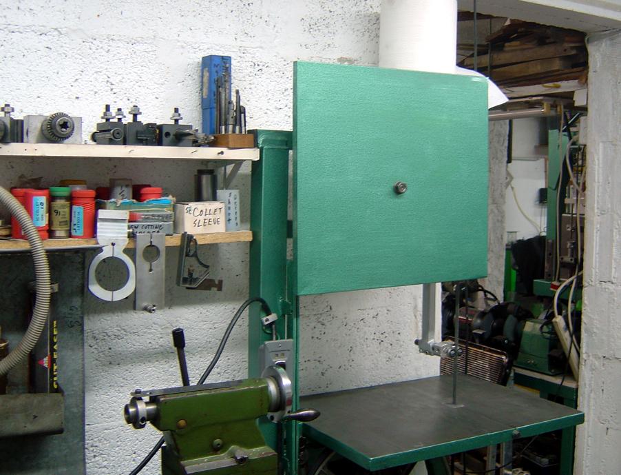

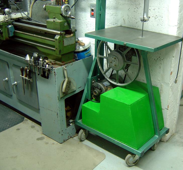

    I added a couple of finishing touches to the bandsaw.
    Homemade vertical bandsaw.-toolbox-01.jpg Click thumbnails for full size.
    Putting empty space to good use with a storage box for spare blades and other saw related bits and pieces.
    Top wheel cover, a safety feature. Made from the top off a disused washing machine.
    There are a few more things to add when I get the time and inclination. Some wheel and blade brushes to keep the sawdust from embedding into the wheel tyres, a cover over the motor to keep the sawdust out and I might 3D print a little box under the table to attach a shopvac hose to.
