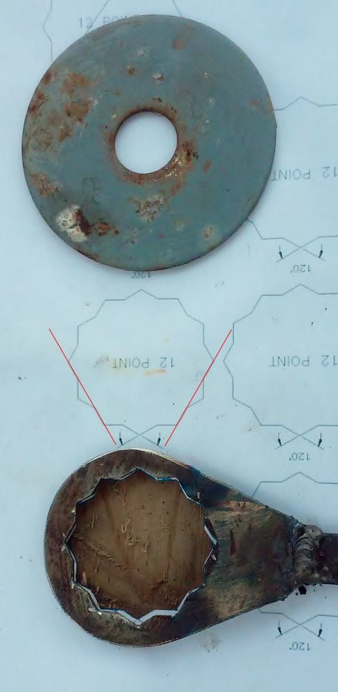

I used a thin blade in a 4 1/2" grinder to cut out a 12 point 40mm wrench shape from a 3mm thick piece of steel. I copied an image from the net and printed it out, adjusting the image size until it printed out at 40mm across the flats. Cutting from both sides the 3mm thick washer and then I finished it off with a hacksaw blade and a file. I'll be honest, it would have been a lot easier if I'd had a 40mm bolt or nut to keep checking progress on but hey, it got the job done in the end, I just needed a little more space than I'd have needed if the wrench was a 100% tight fit. I then shaped the excess metal away and welded the results onto an old fire poker.

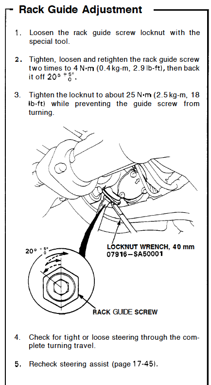

You use the tool to back off the lock nut. Spray everything with WD40 and then tighten and back off the central slipper adjustment nut a few times to get it really free. Then run it up until it's just nipped up tight (specs say 4nm, which isn't much) and then back it off 20 degrees. I folded a piece of paper over and over until it was 20 degrees on my kids protractor and then held it up behind the 14mm spanner when I backed it off.
Attachment 19945
