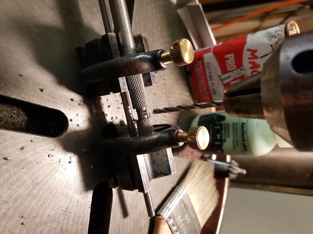

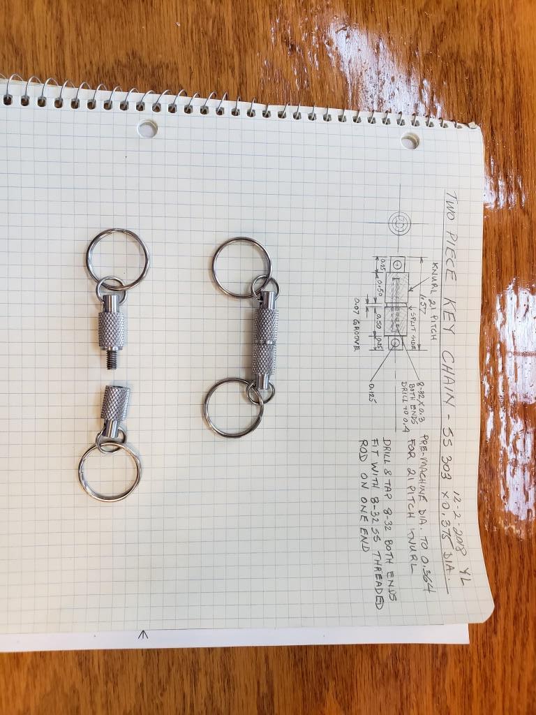

Along the lines of my previous postings for "kitchen utensils" with knurled stainless steel handles (see e.g., http://www.homemadetools.net/forum/k...323#post107011 ), I made key chains that are allow the house key and car key to be separated (great for valet parking).
Attachment 26771

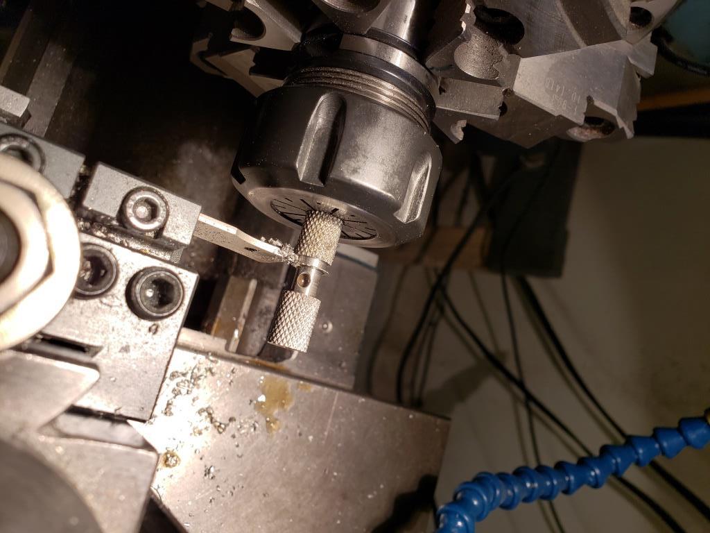

The key chain can be separated into two individual parts by unscrewing a stainless steel 8-32 threaded part. The main body of the key chain is made from 0.375" diameter stainless steel 303 rod turned-down to 0.364" for a very clean 21 pitch knurl application. I used a 8-32 SS all-thread rod attached with Loctite 620 rather than single point threading or cutting with a 8-32 die. Every way would work very well but by taping a 8-32 thread and gluing in the 8-32 threaded rod was a much easier operation.

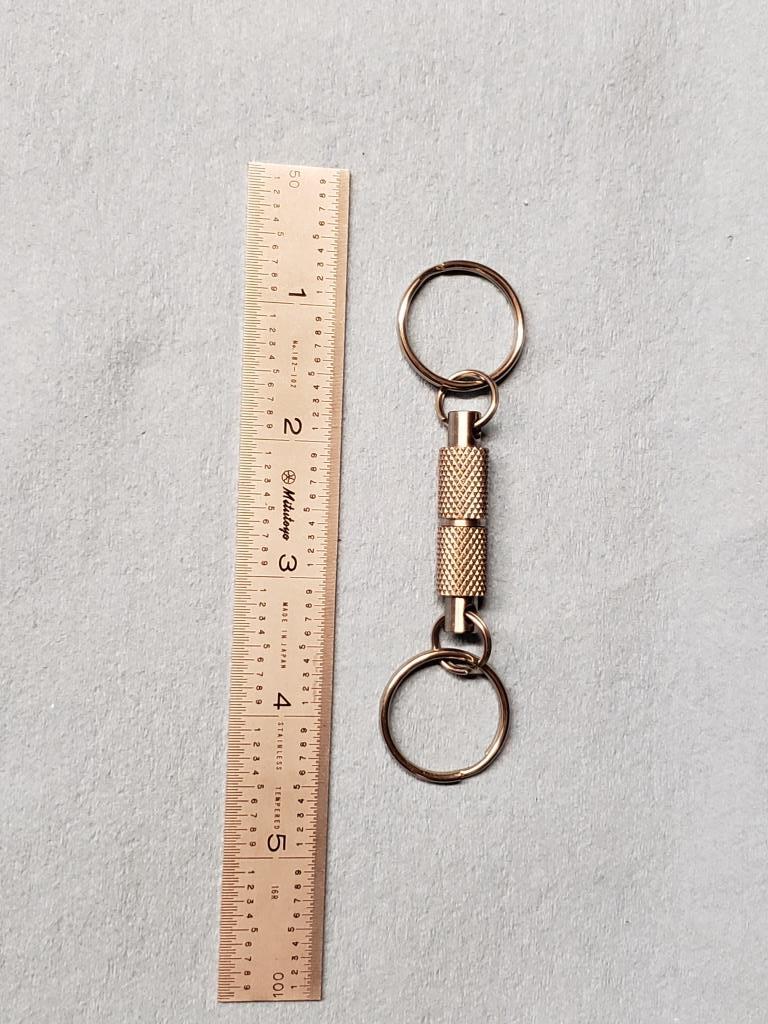

I bought the stainless steel rings at Amazon and the combined small and large pair allow a very flexible key chain for being in your pocket or purse.
Attachment 26773 Attachment 26774

There has been some discussion about knurling at HMT and YouTube. In my experience the best way is to pre-calculate and then machine the ideal basic diameter for the knurl pitch before doing the knurling. There are formulas for this but as they say now "there is an app for this" on your smartphone. I use the phone app "Knurling Calculator" for the Imperial pitch knurls from 12 to 80 TPI. It works perfectly each time. In stainless steel, it takes me only two passes from right to left and then back left to right at 140 RPM and a slow longitudinal power feed with lubricating oil when using a simple scissor-type knurling tool (see http://www.homemadetools.net/forum/k...7860#post24656 ). This method guarantees a perfect knurl every time.
