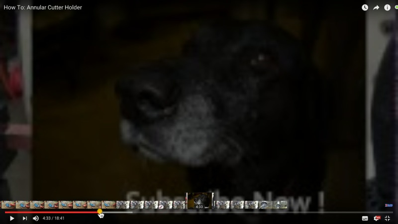

Hi Tsanga,
I've looked your video with interest, but why put in it those disturbing images, they cause total alarm against fraud on my computer???:headscratch:
Attachment 17354
Have a nice day.
