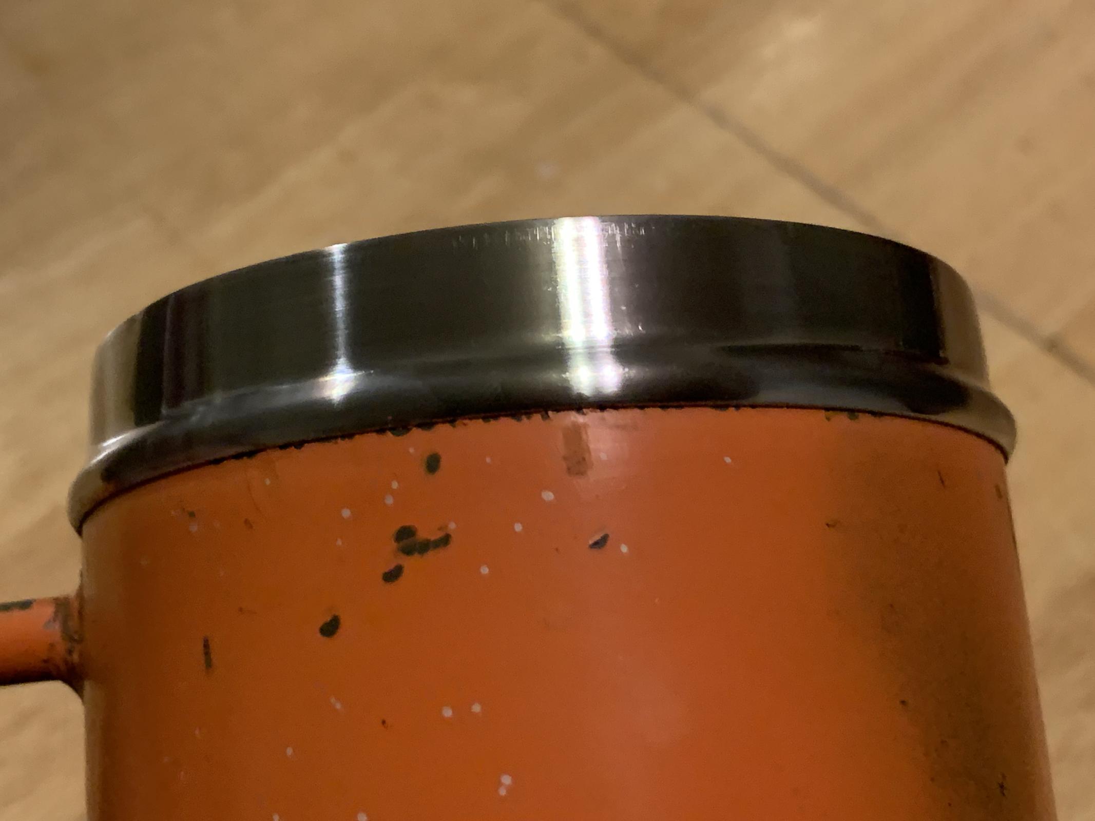

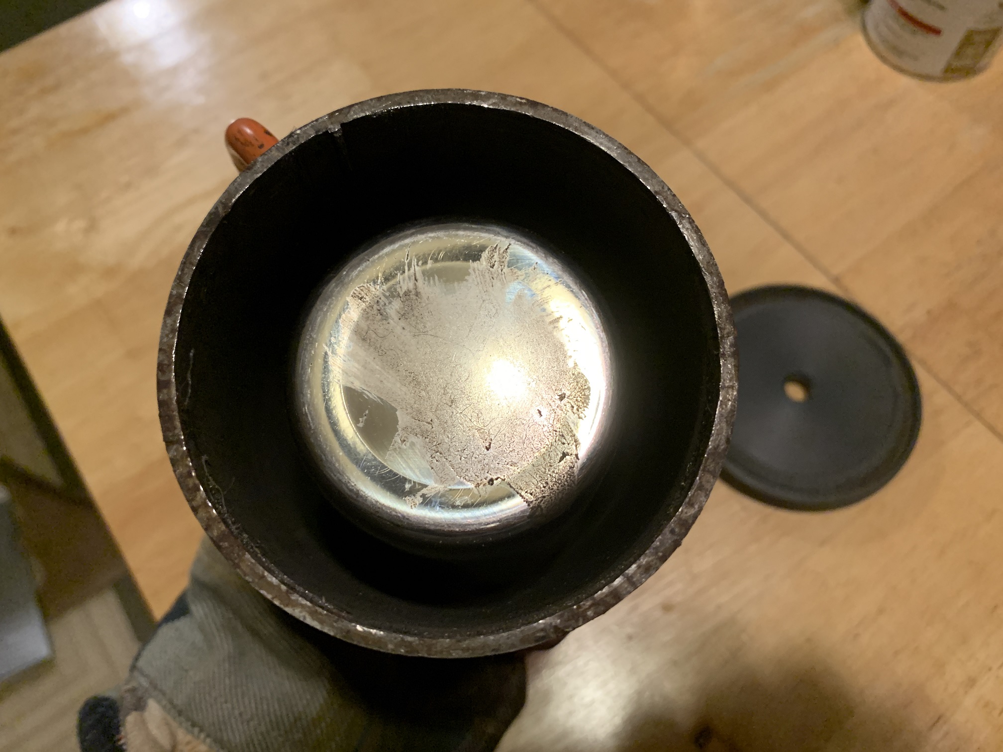

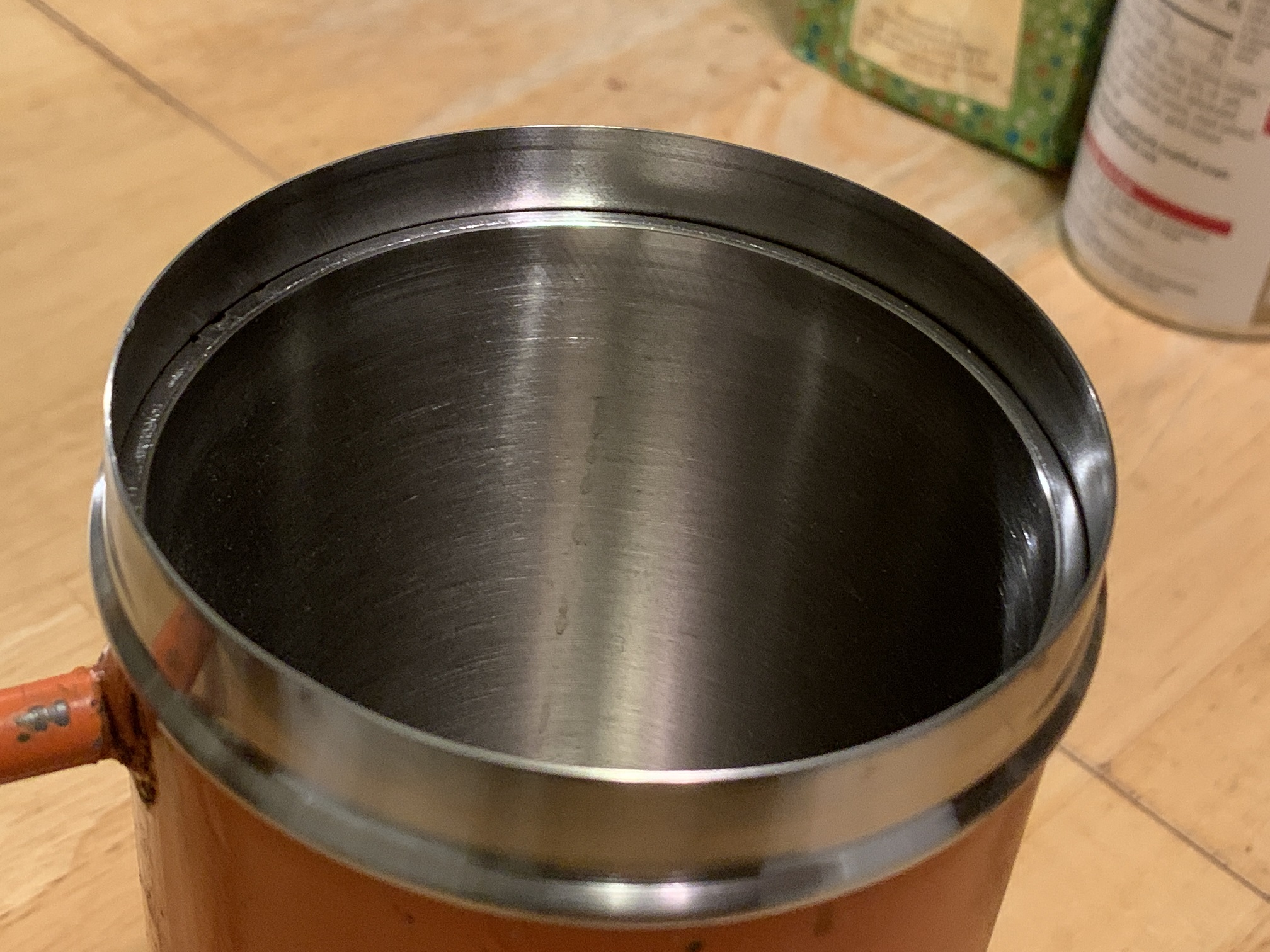

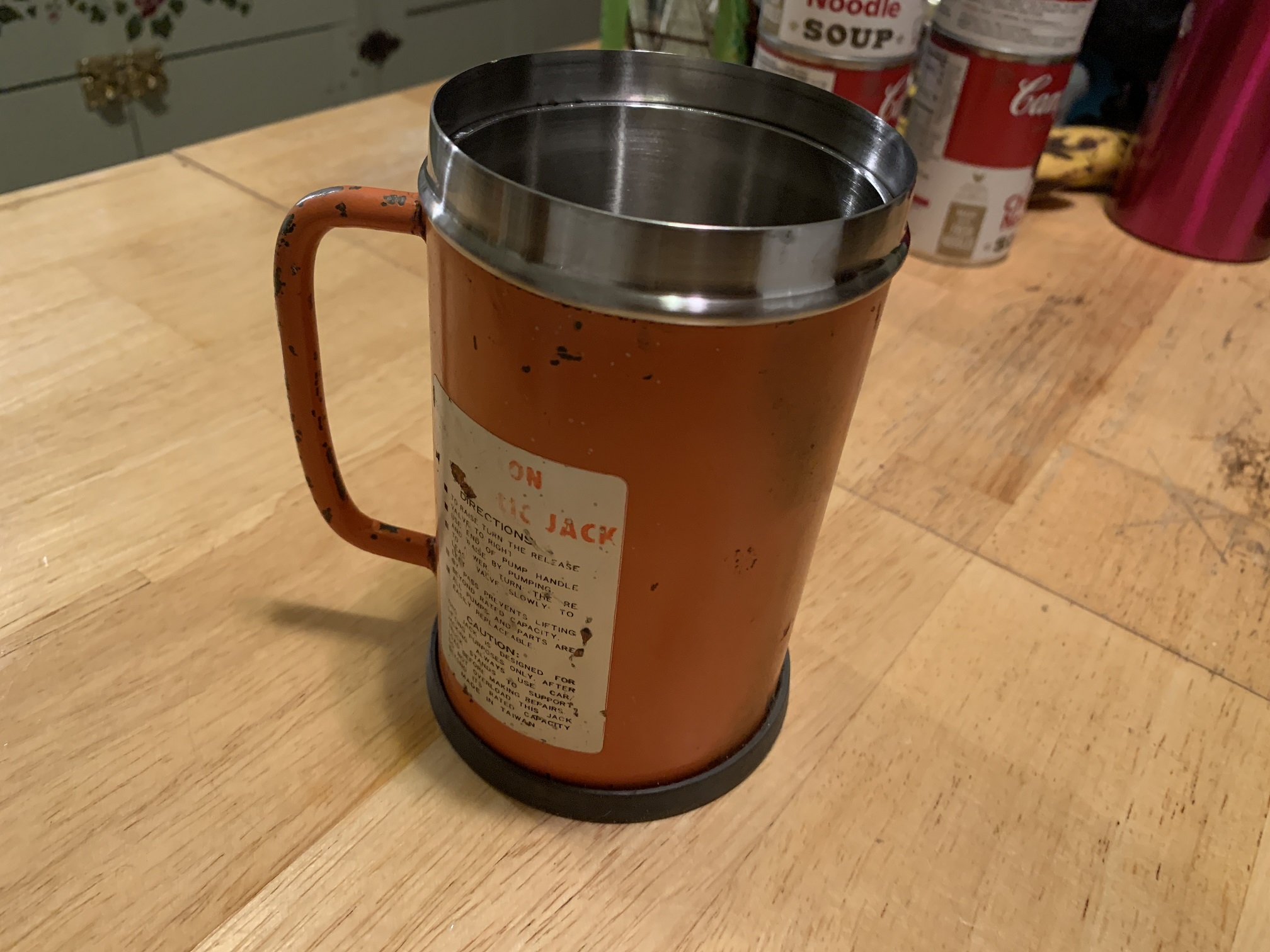

I had set this mug aside since my last post because I couldn't find a proper cup to replace the temporary one. I found a Grey Goose drink mixer cup, which has more volume and thicker walls, but didn't have no idea how to fit it (I wanted it to be purely mechanical - no adhesive) until this past weekend.
What I did was cut the cup down so that it wedge into the jack barrel with a bit still proud of the top. I used the very hydro press this jack came from to force the bottle over the cup. Then I trimmed the rim of the cup and the top of the bottle to make an interference fit, then crammed them together.
Now it's as done as it'll get for now. Maybe ever.
