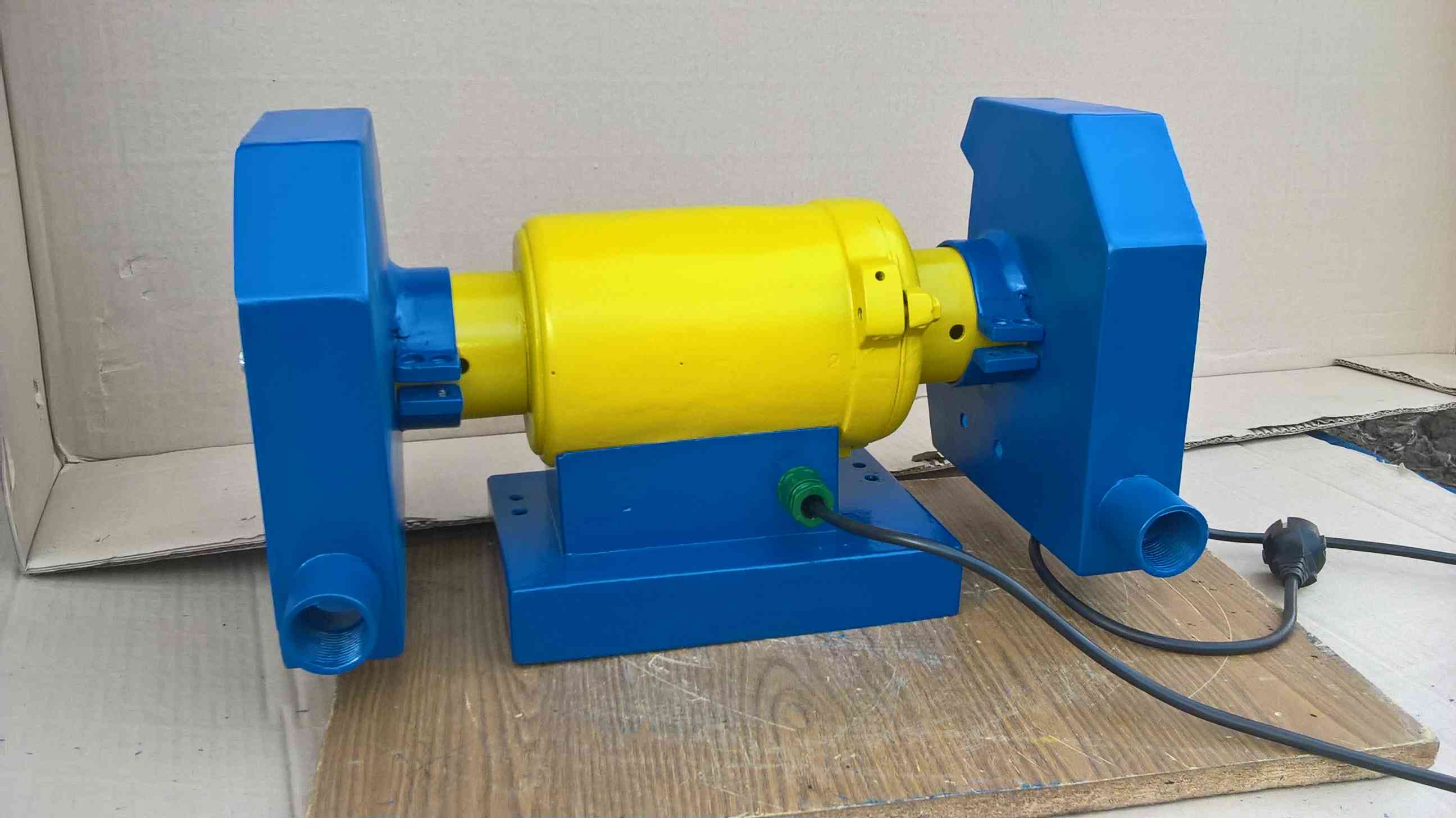

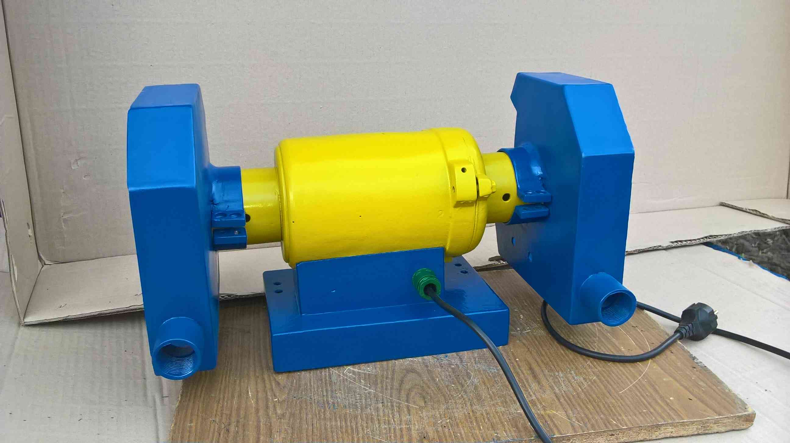

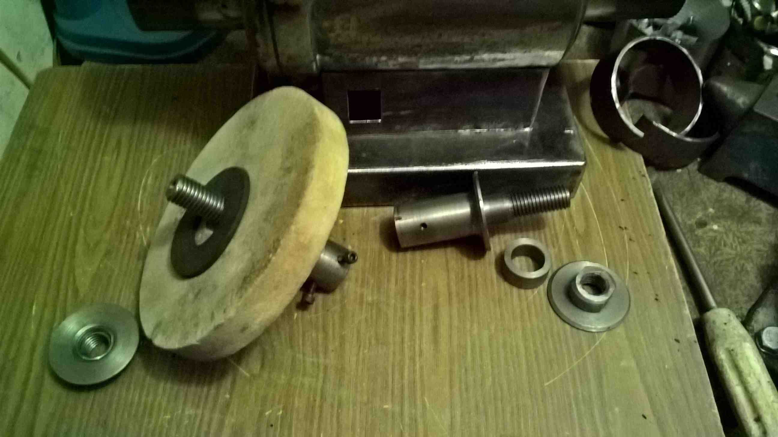

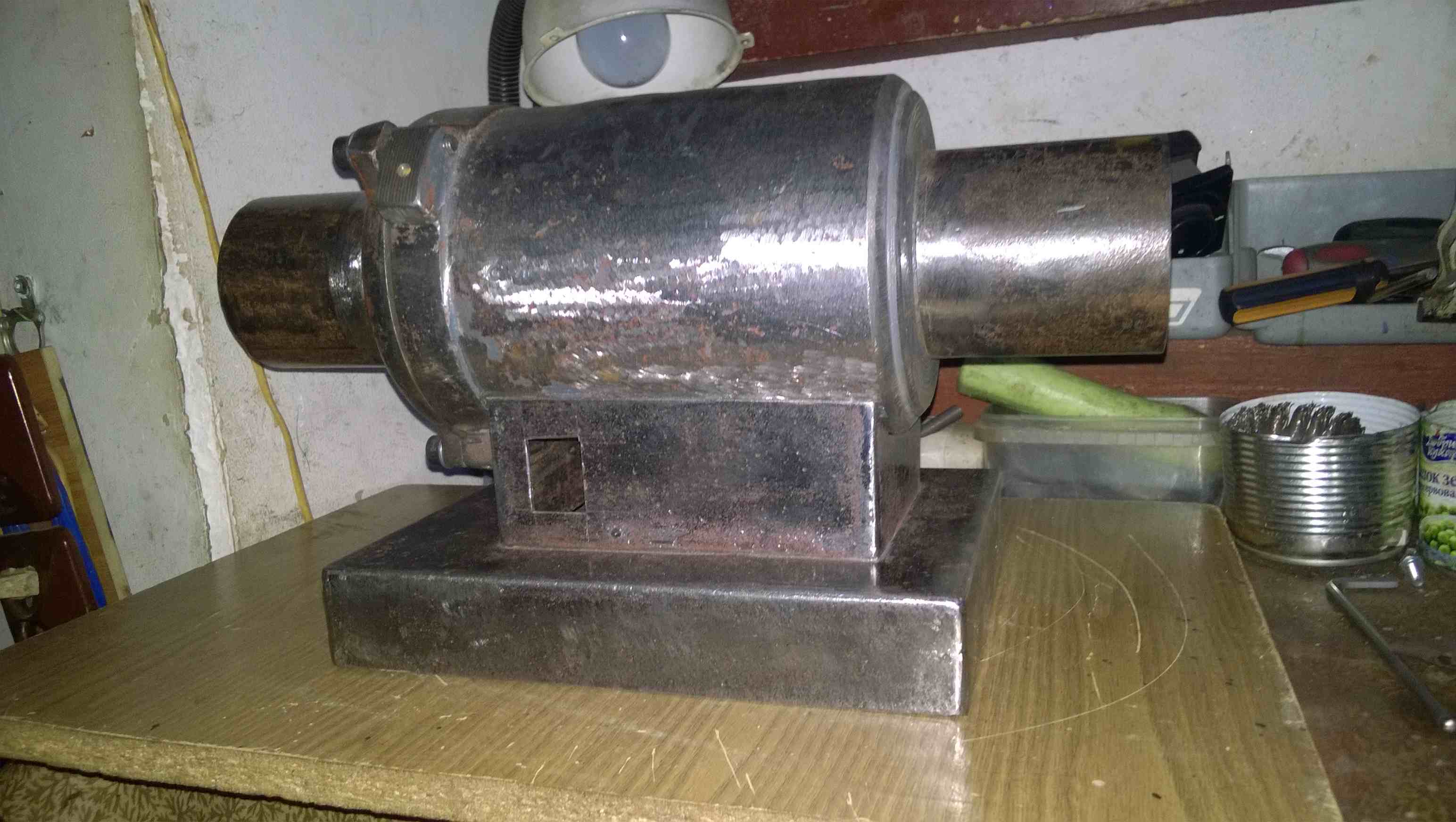

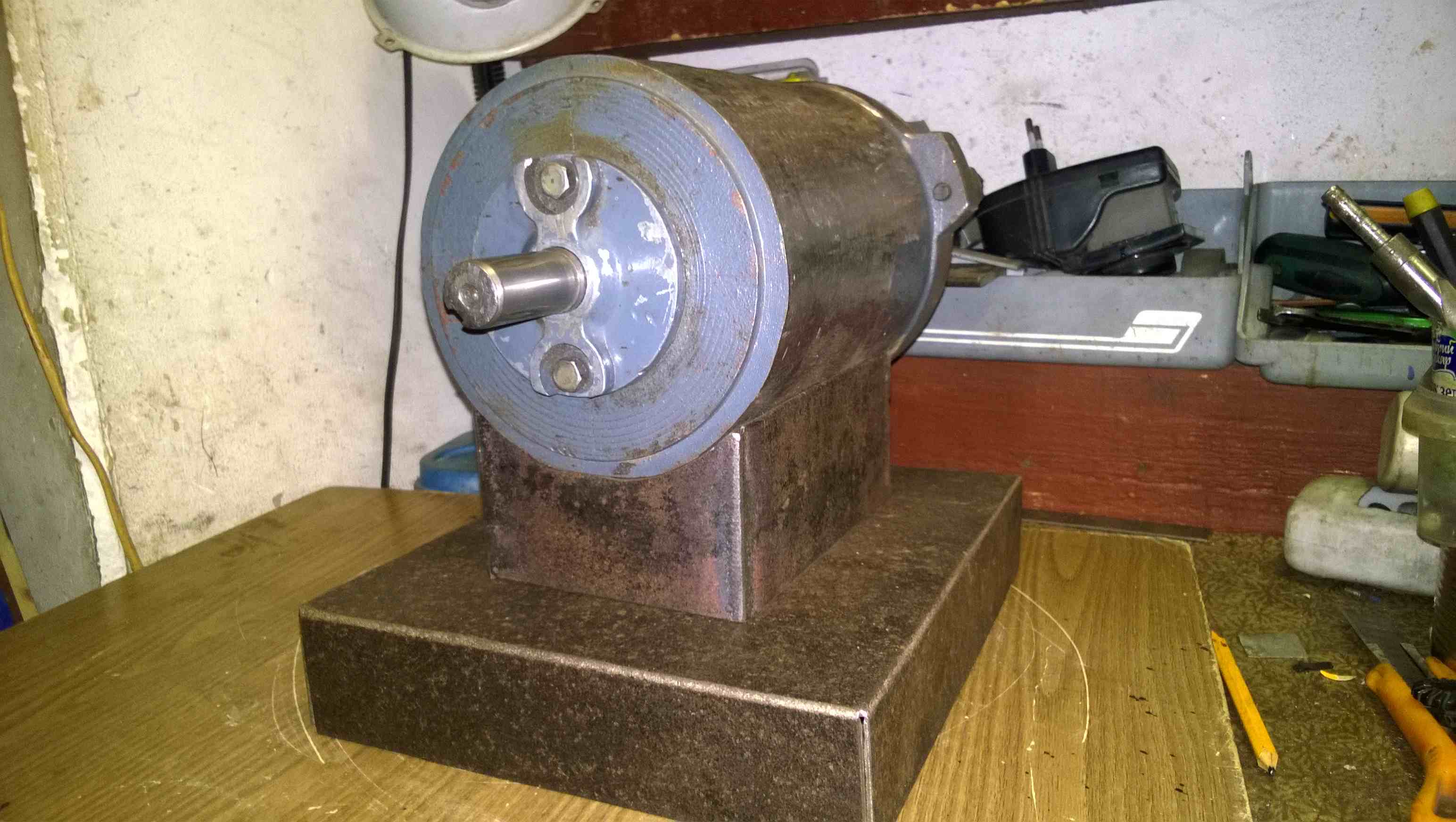

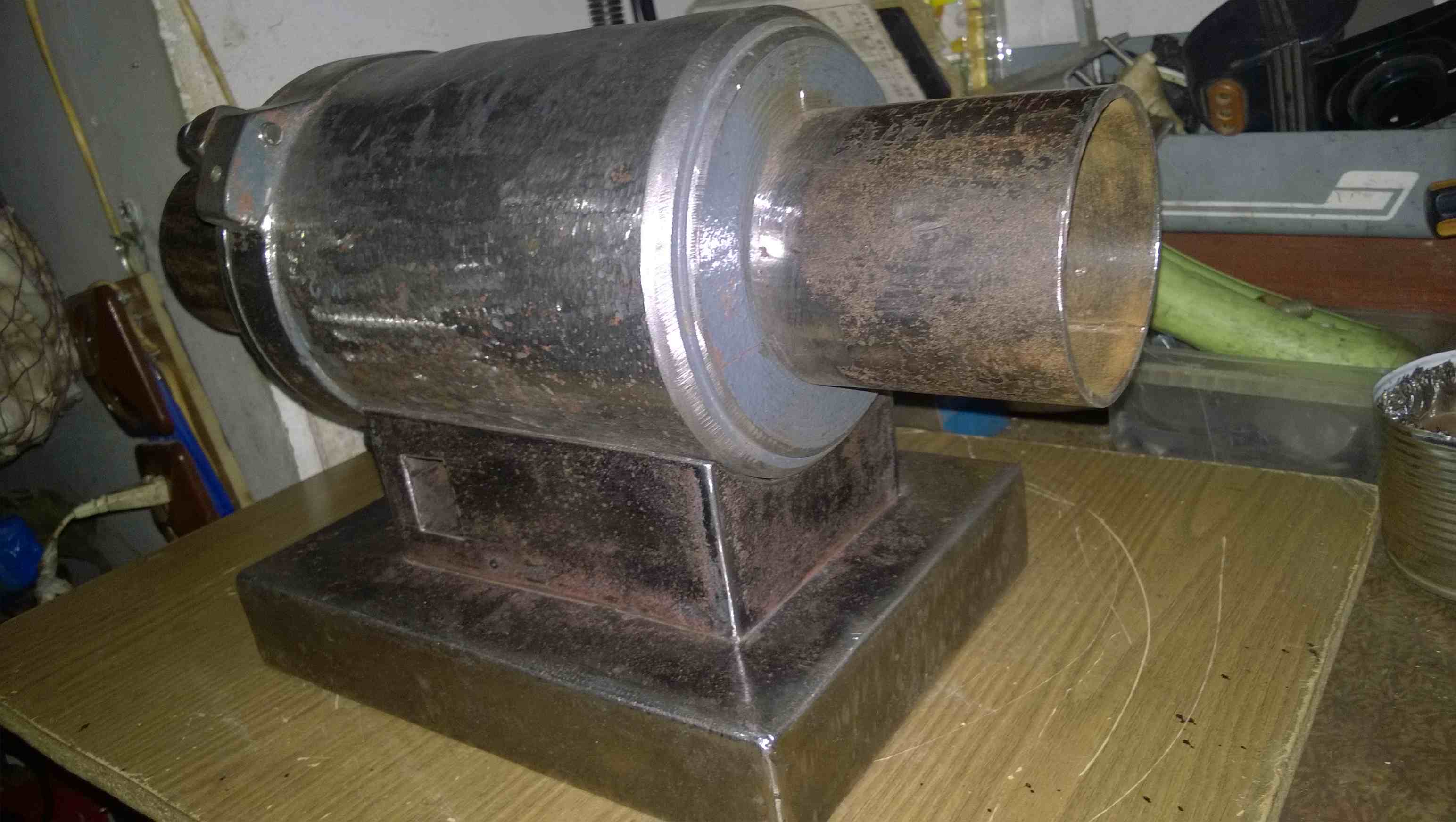

Here is one more of my work Bench Grinder .
Attachment 18357Attachment 18358Attachment 18359

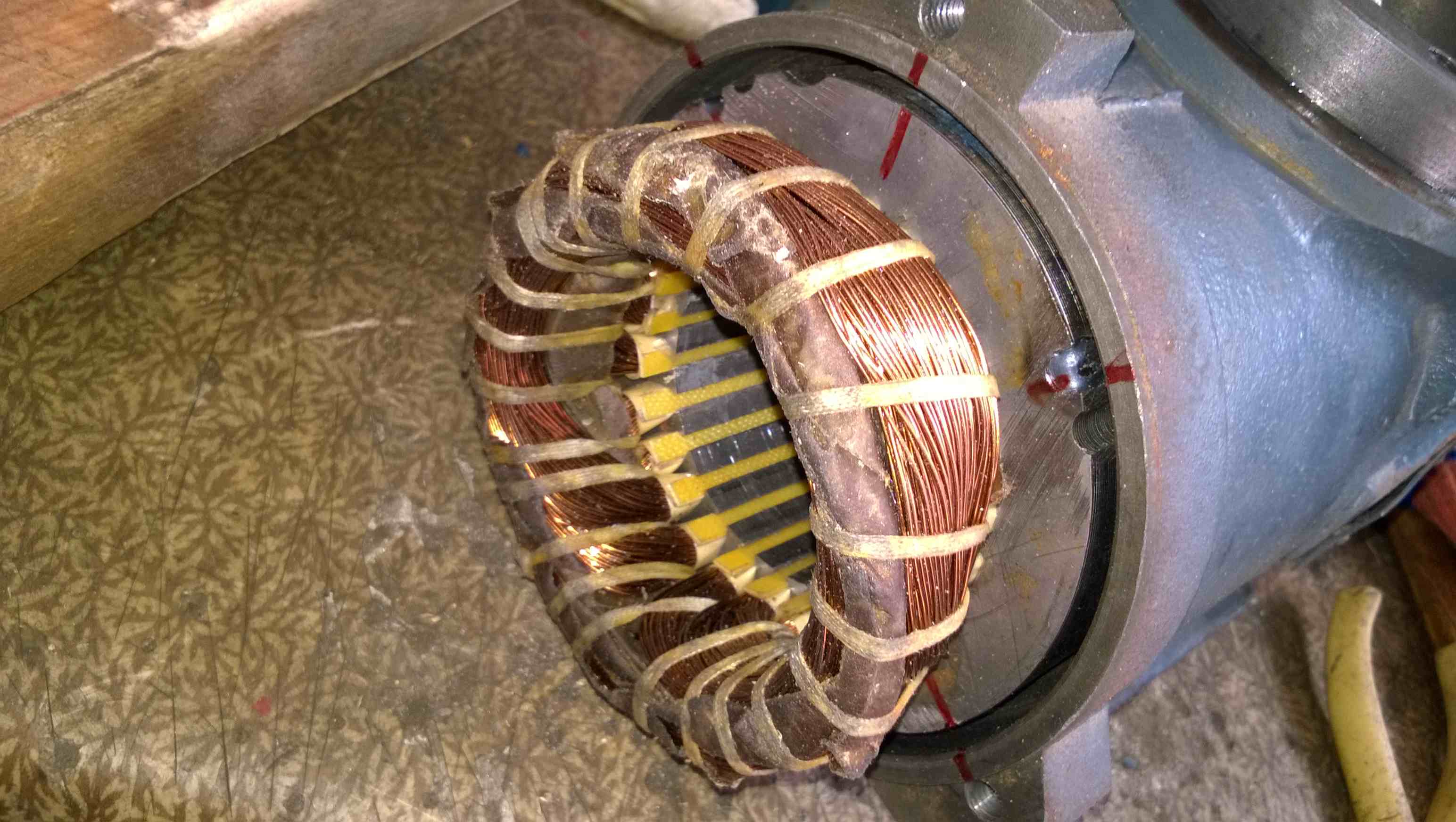

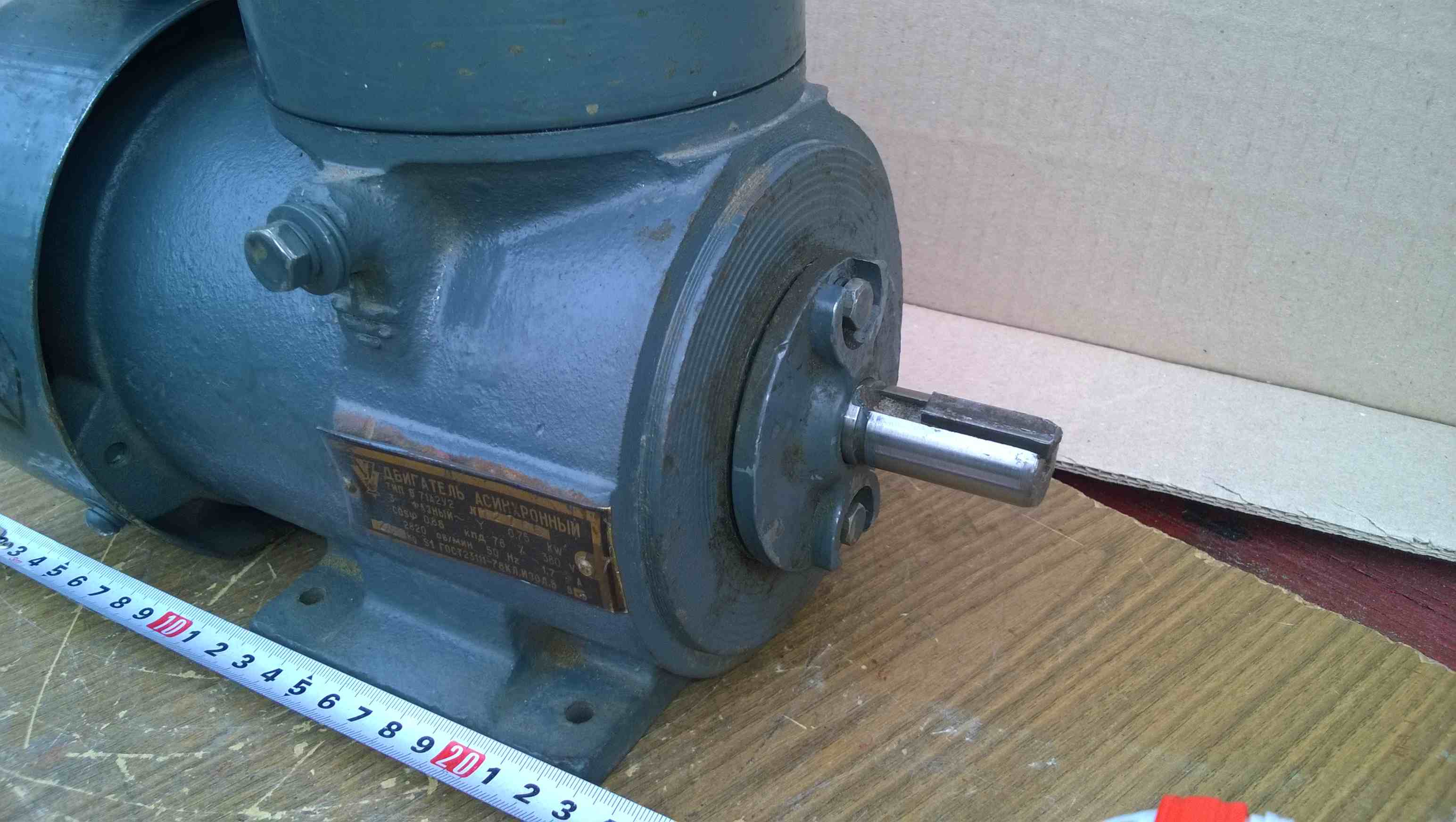

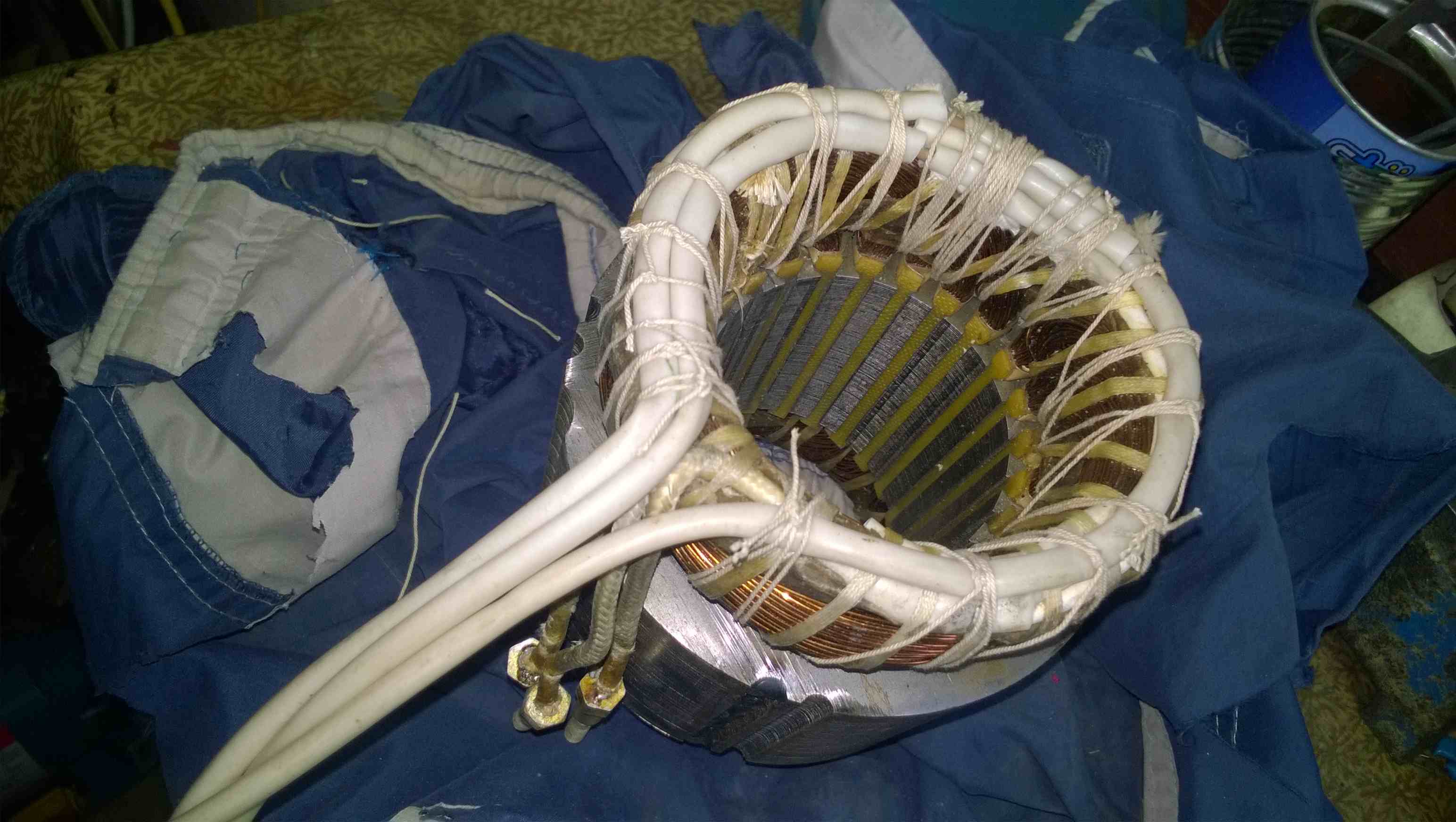

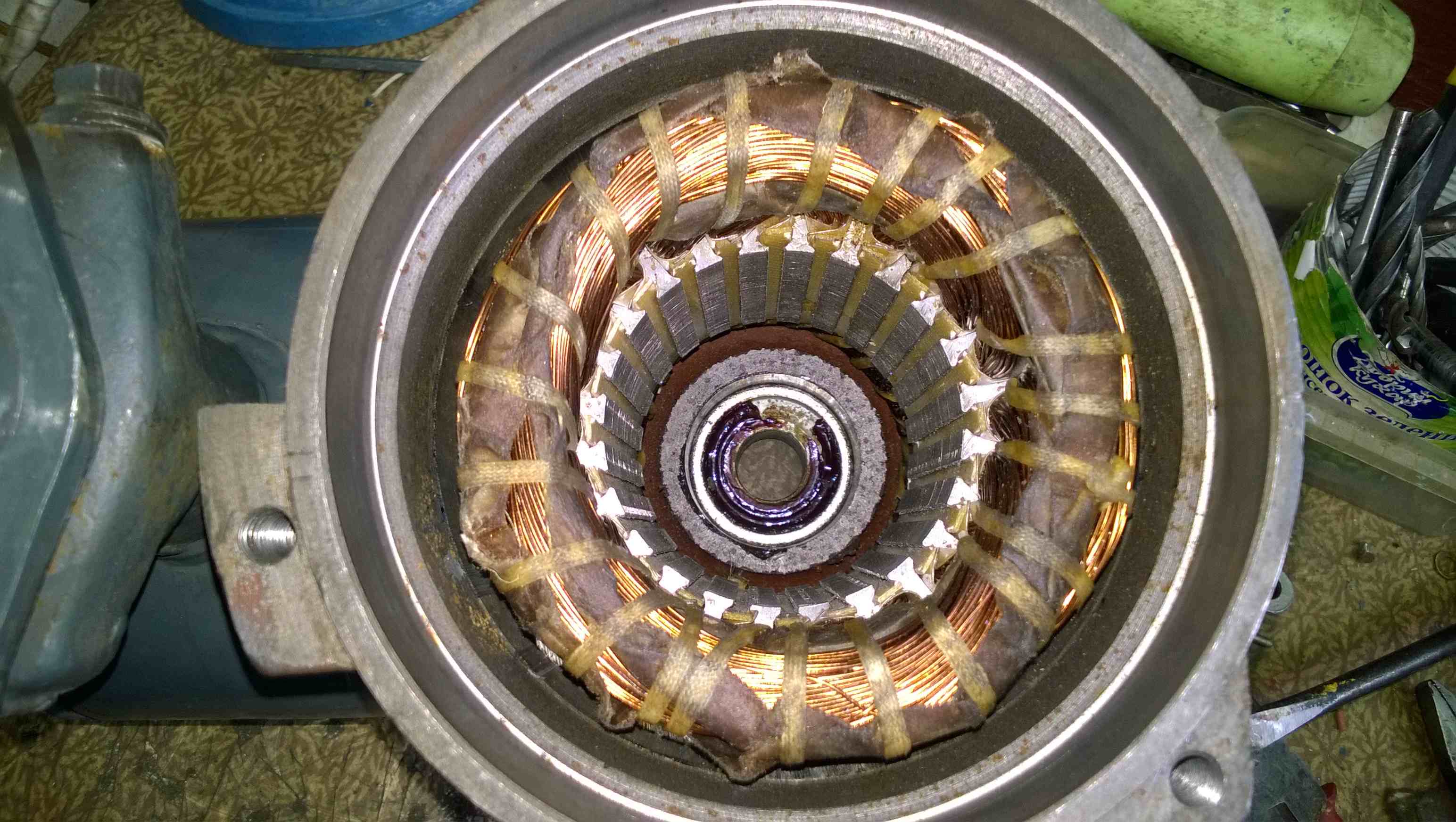

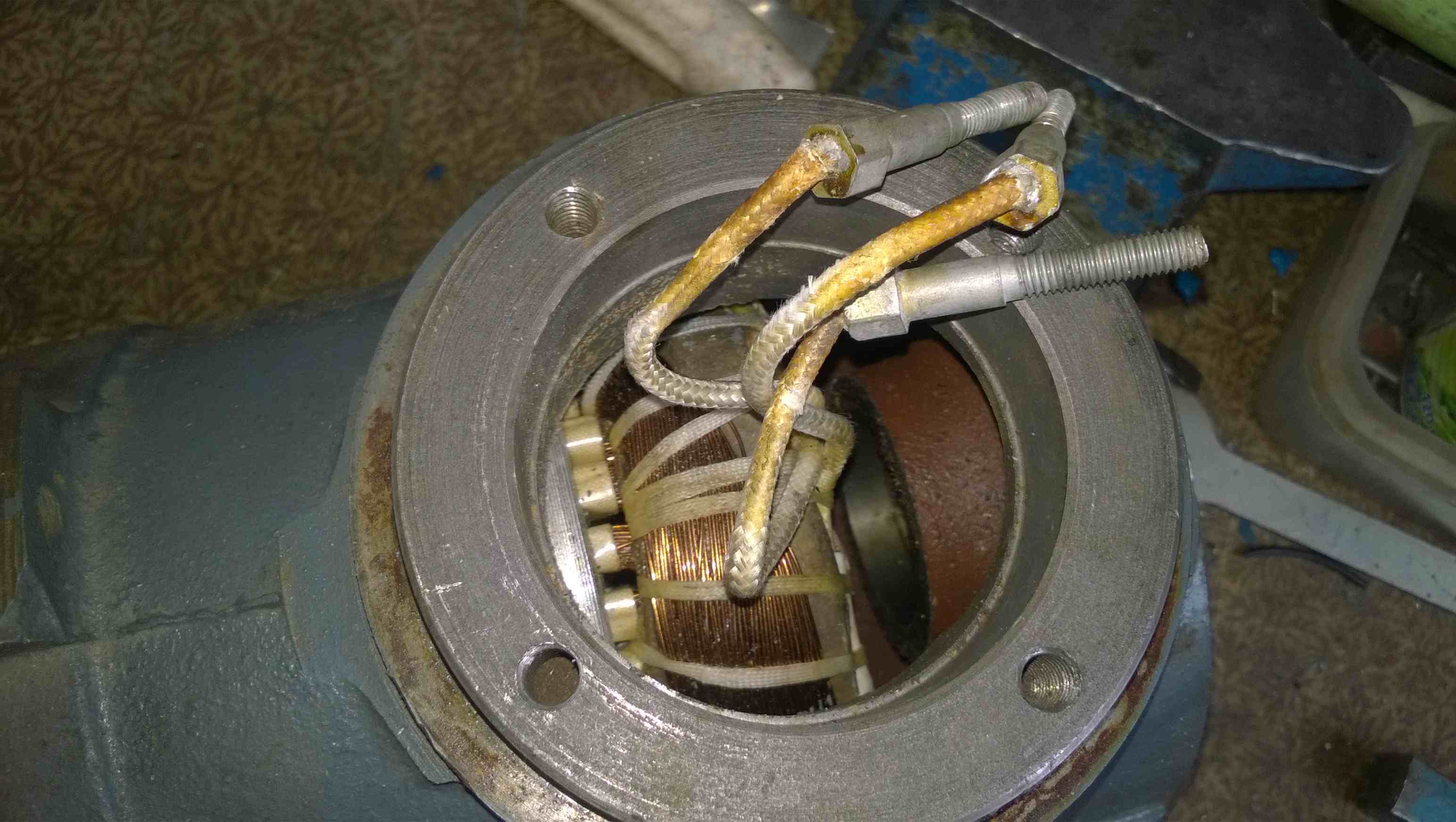

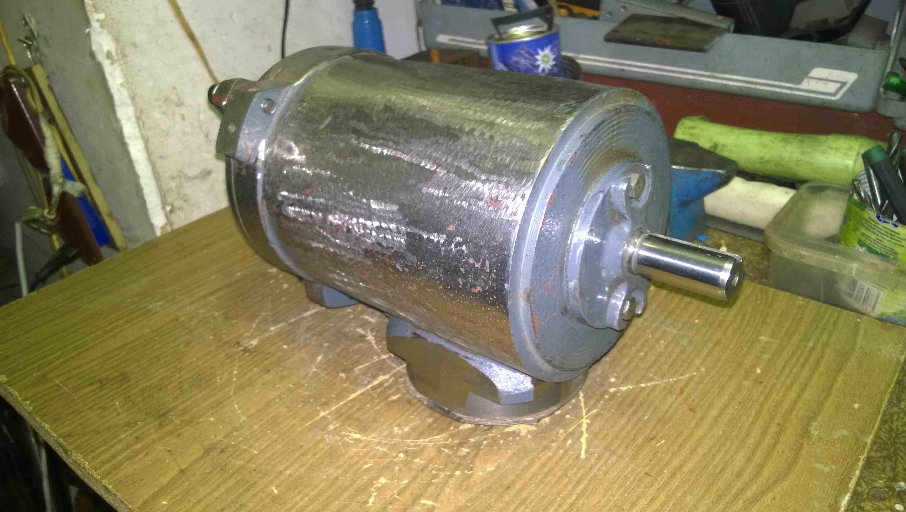

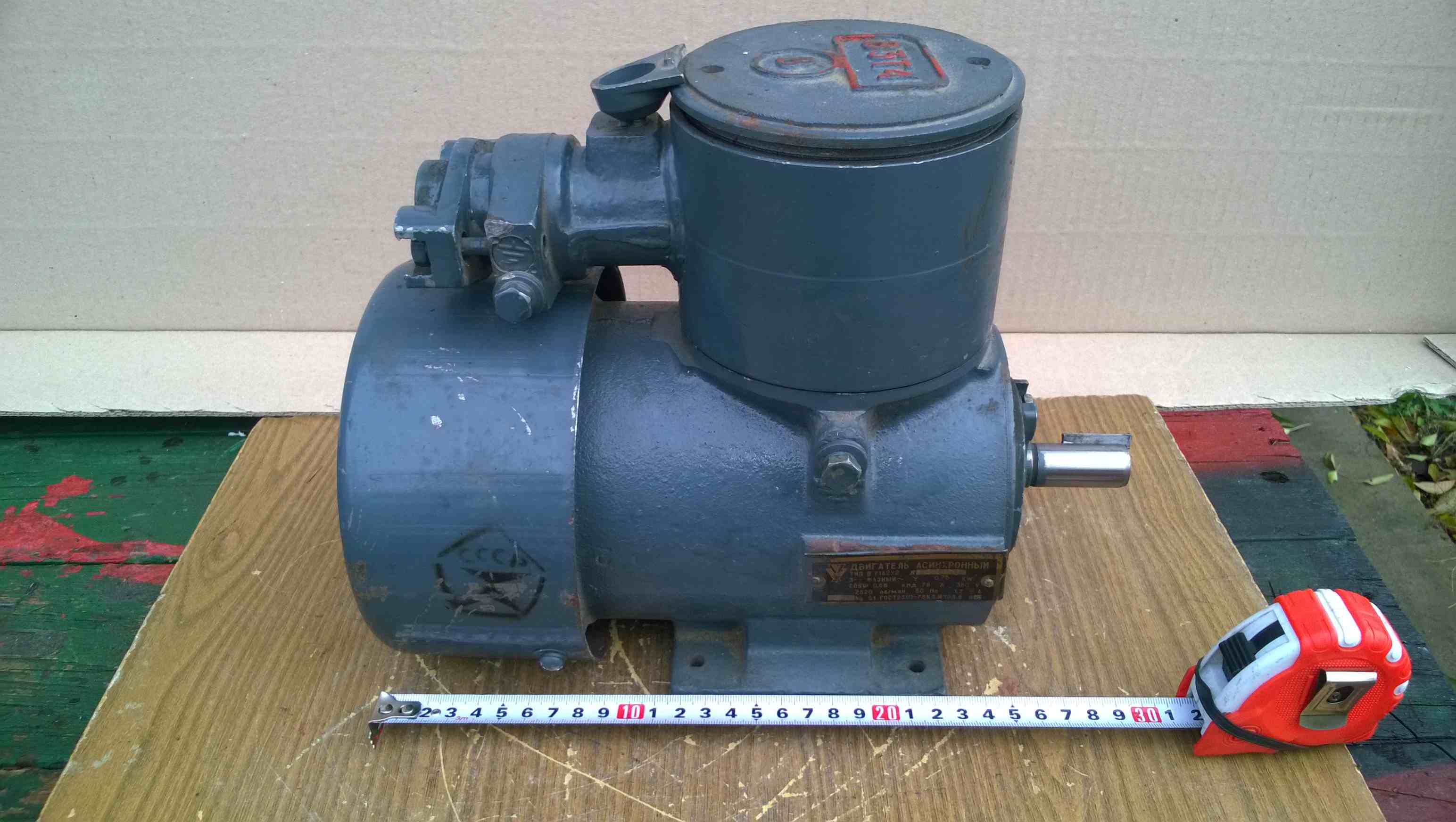

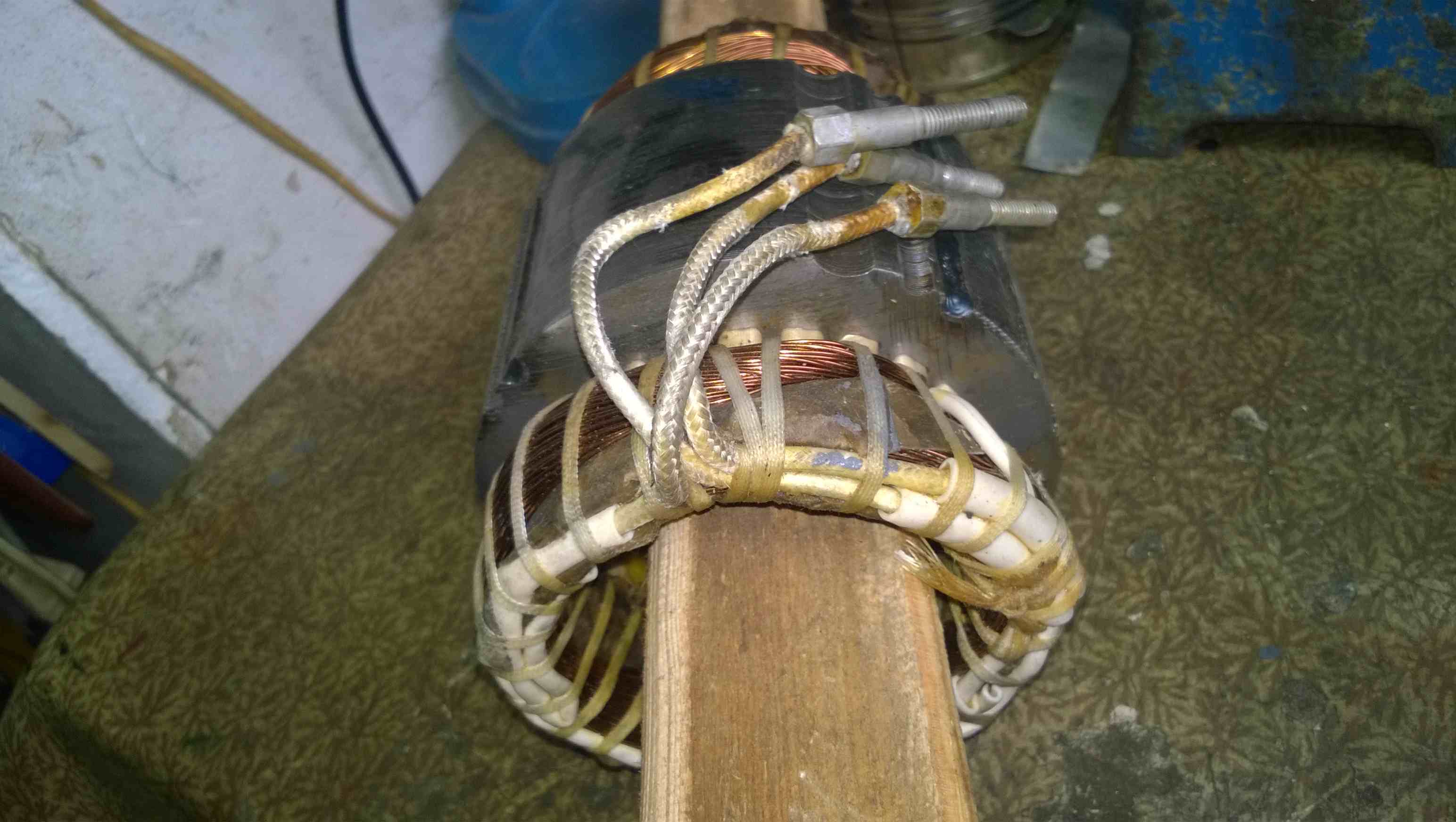

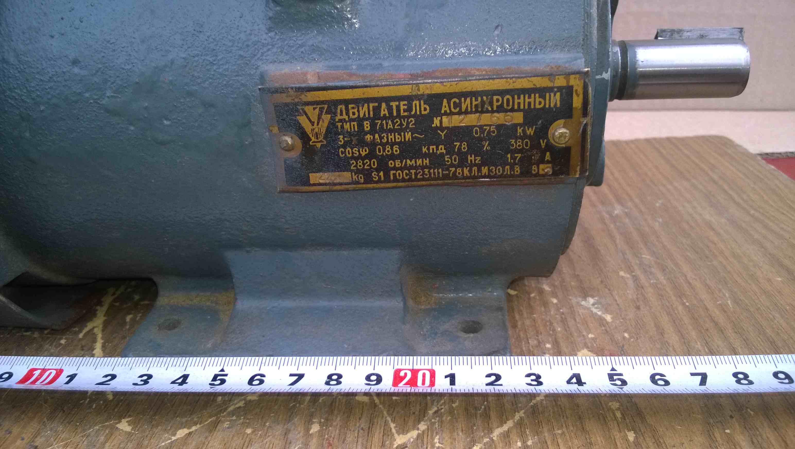

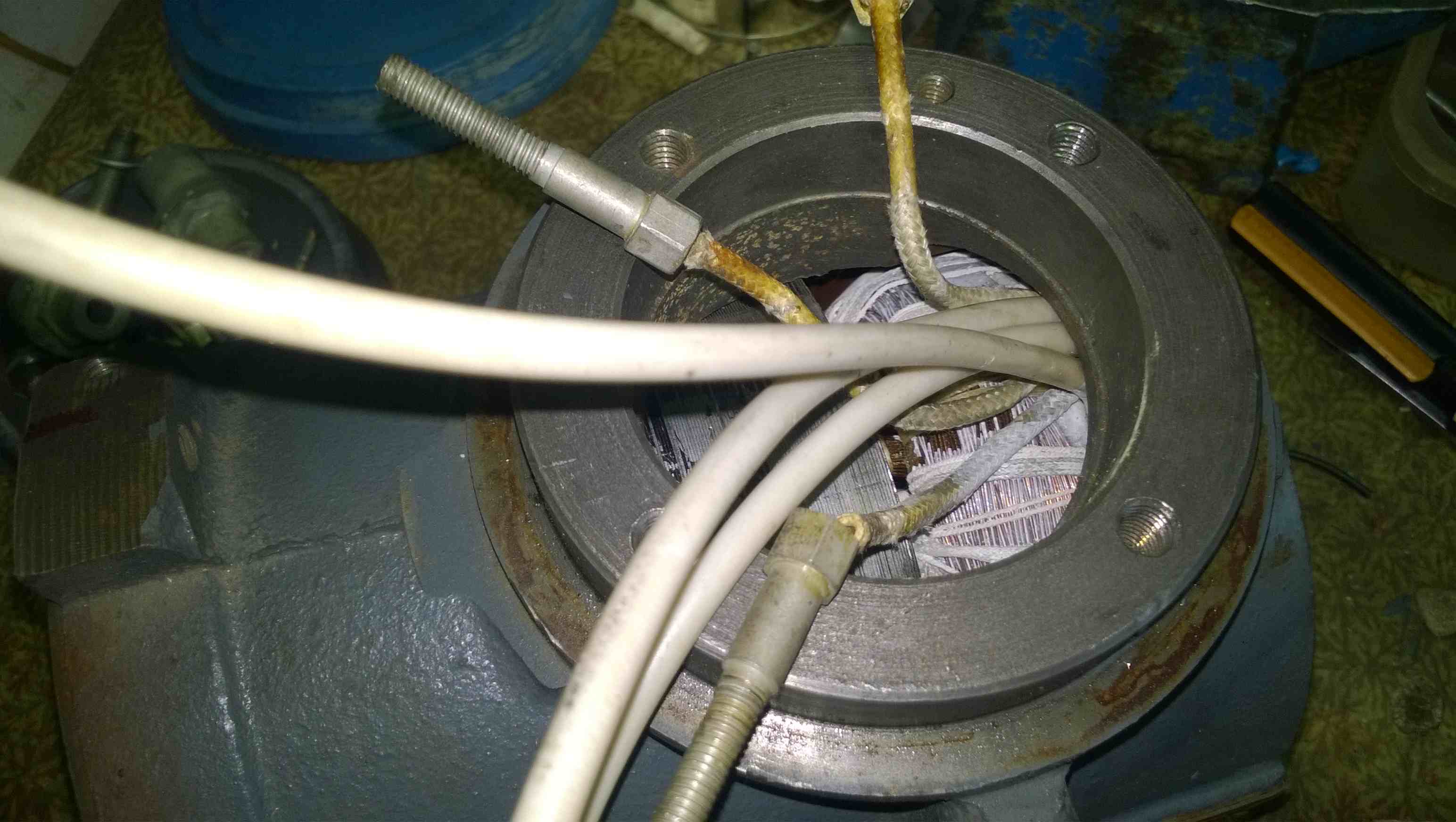

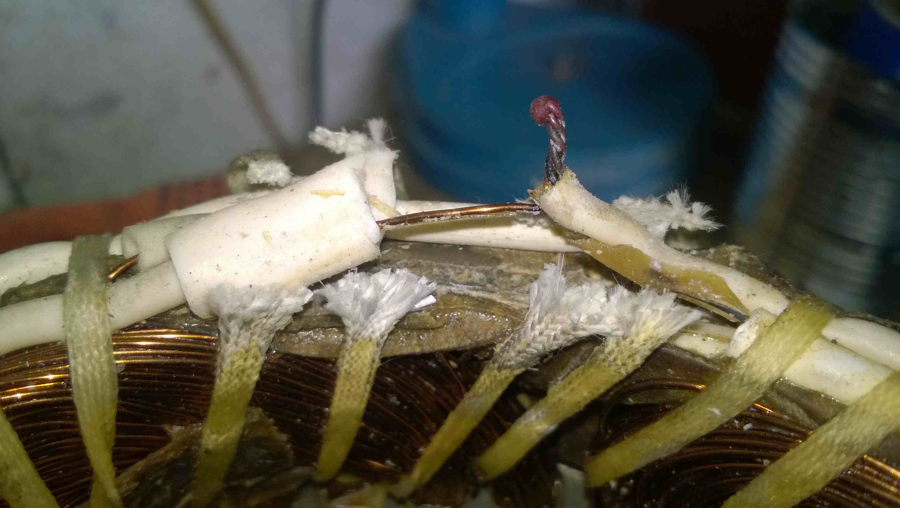

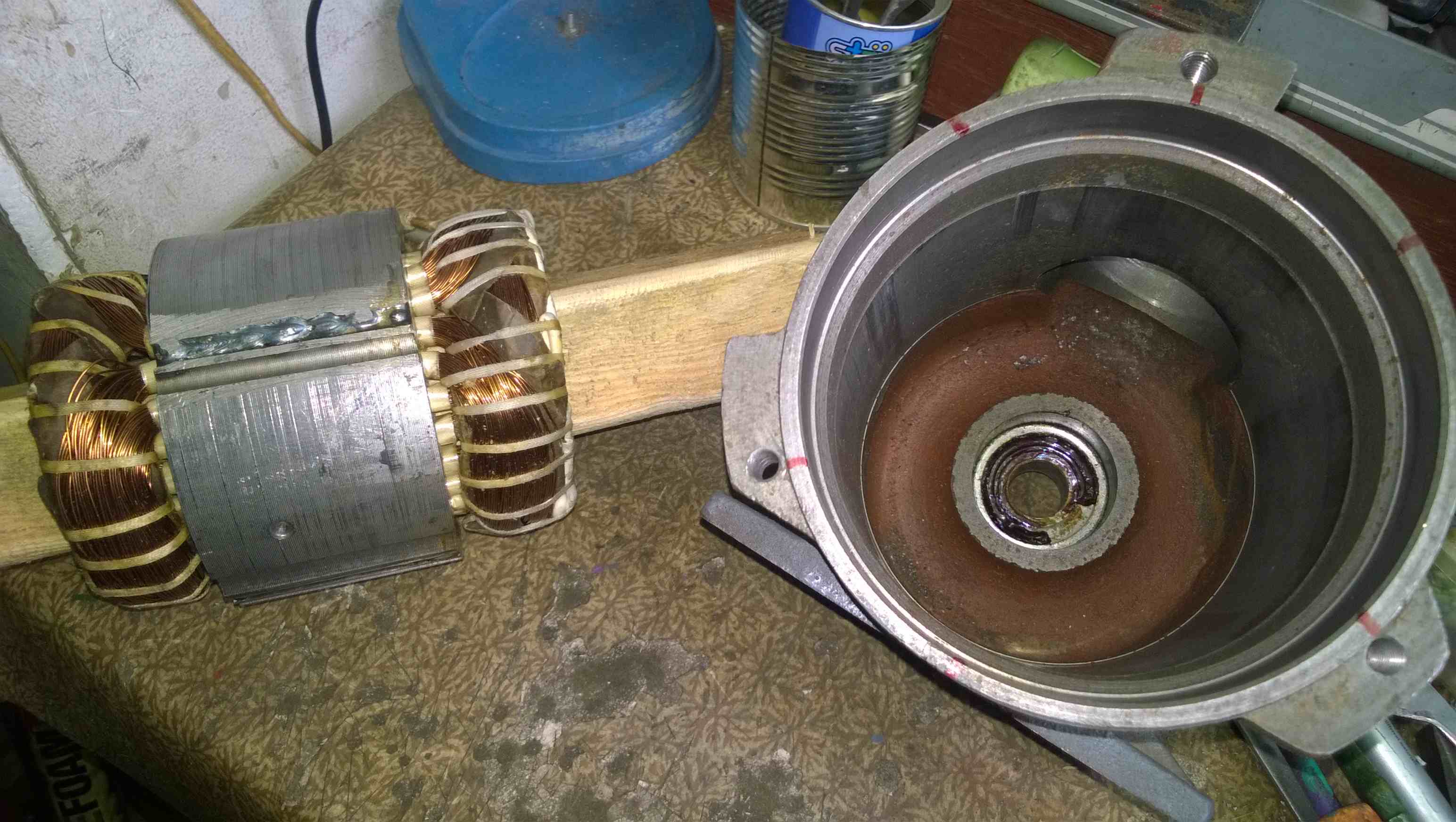

This electric motor is made to work in a 380 volt network with a connection to the star.
I disassembled it and brought out three more wires to connect to a triangle for operation from the 2209-volt network.
Here in the pictures I think that everything is clear. In what order I did.Attachment 18360Attachment 18360Attachment 18361Attachment 18362Attachment 18363Attachment 18364Attachment 18365Attachment 18366Attachment 18367

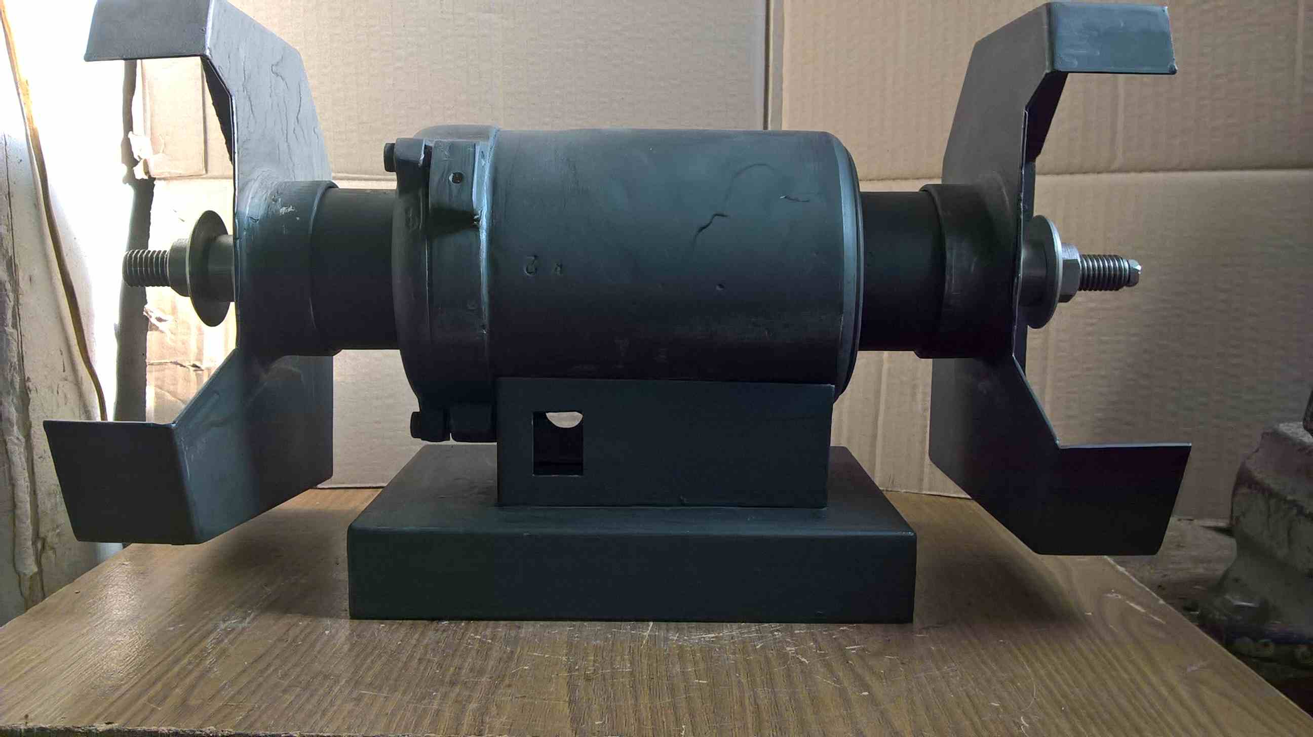

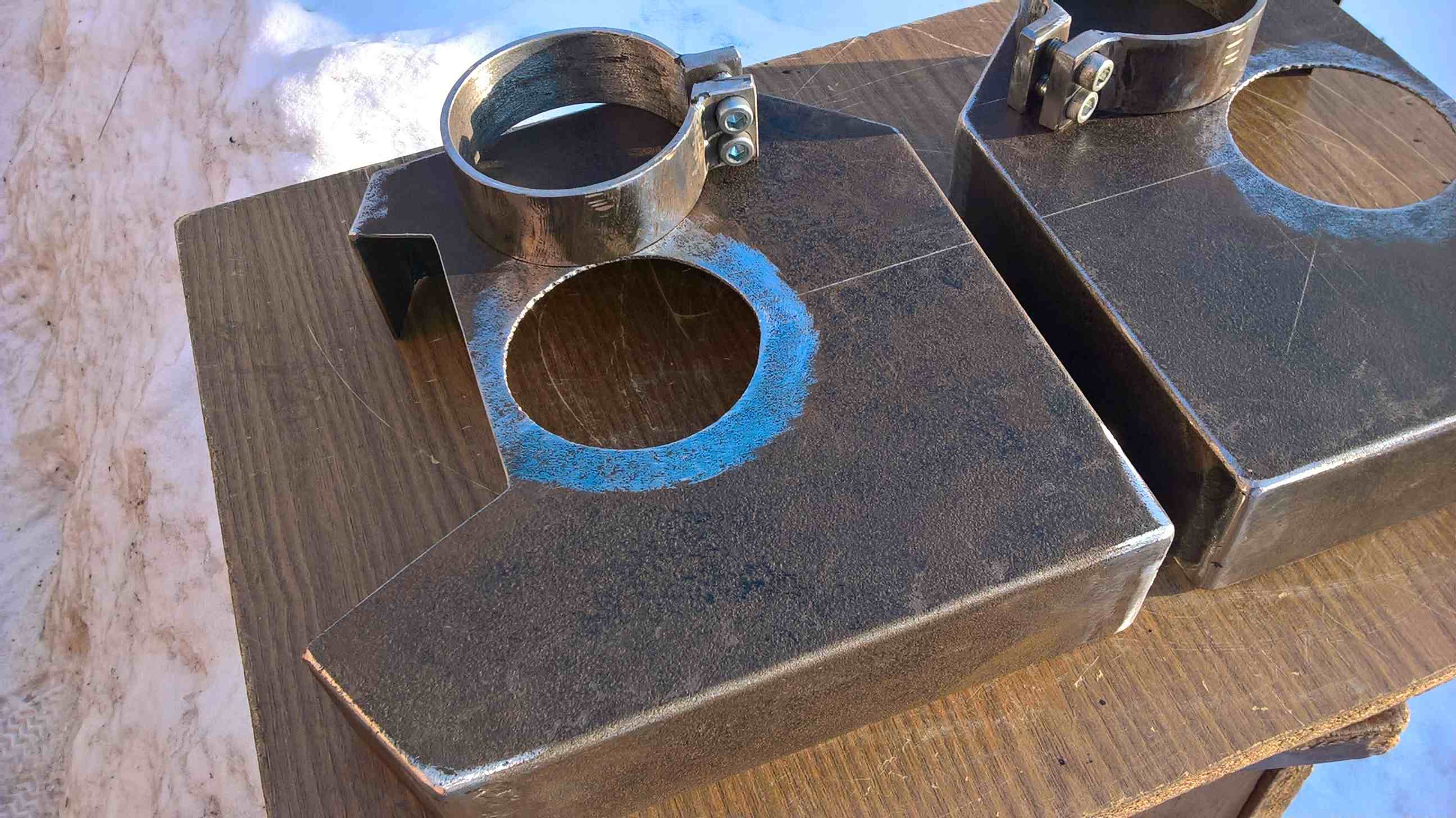

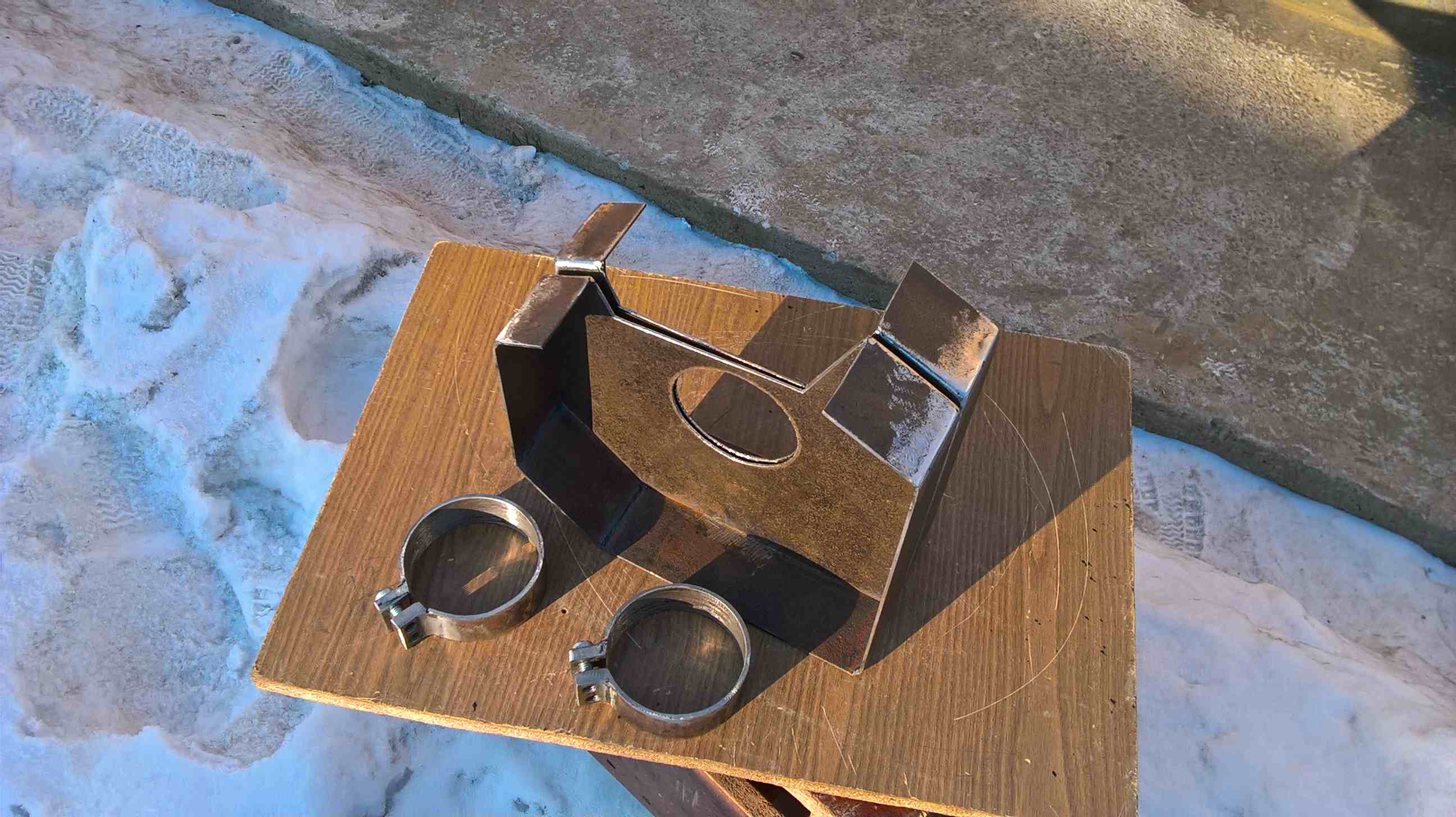

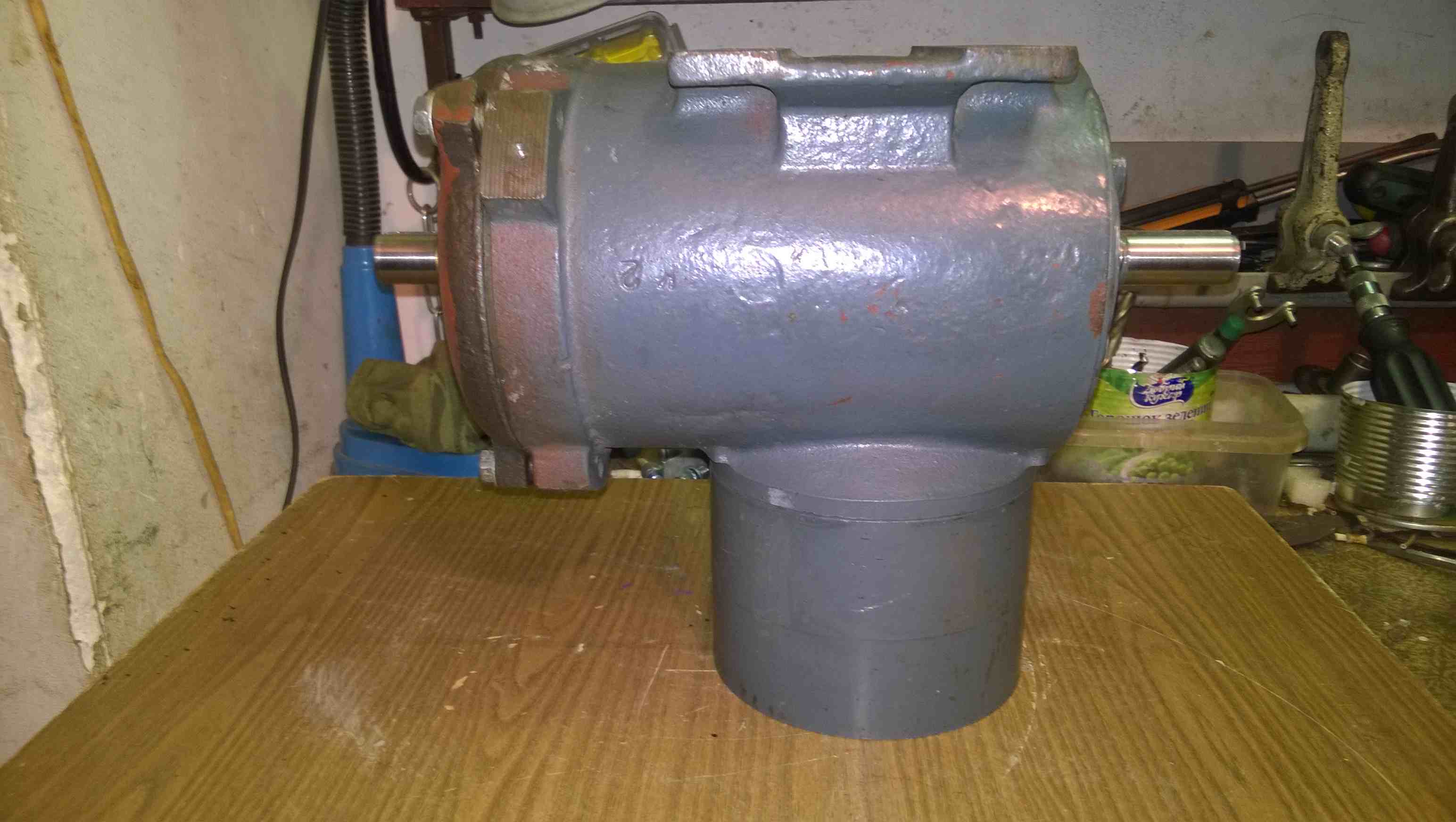

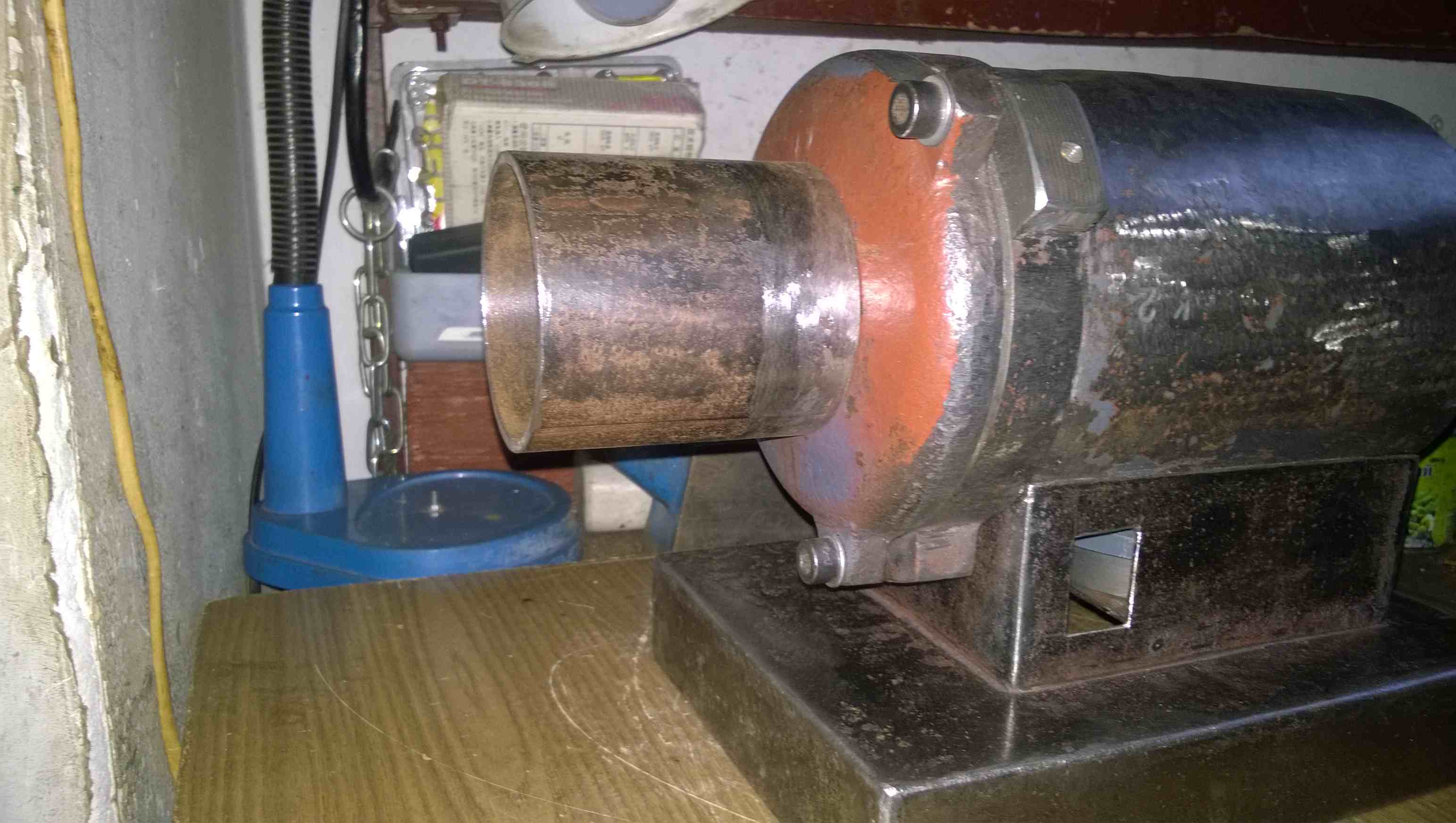

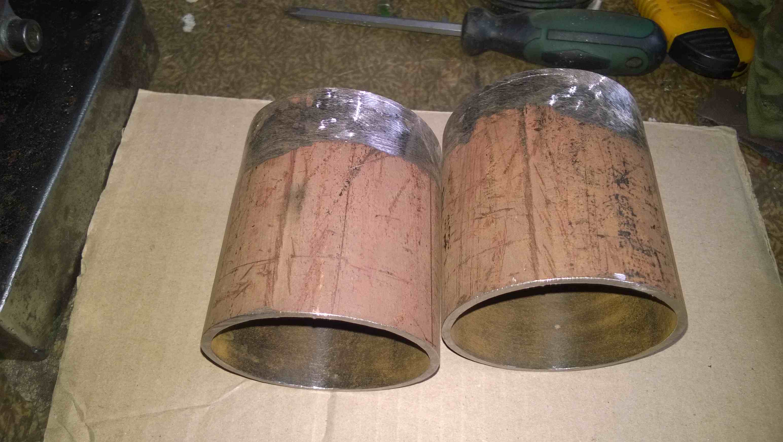

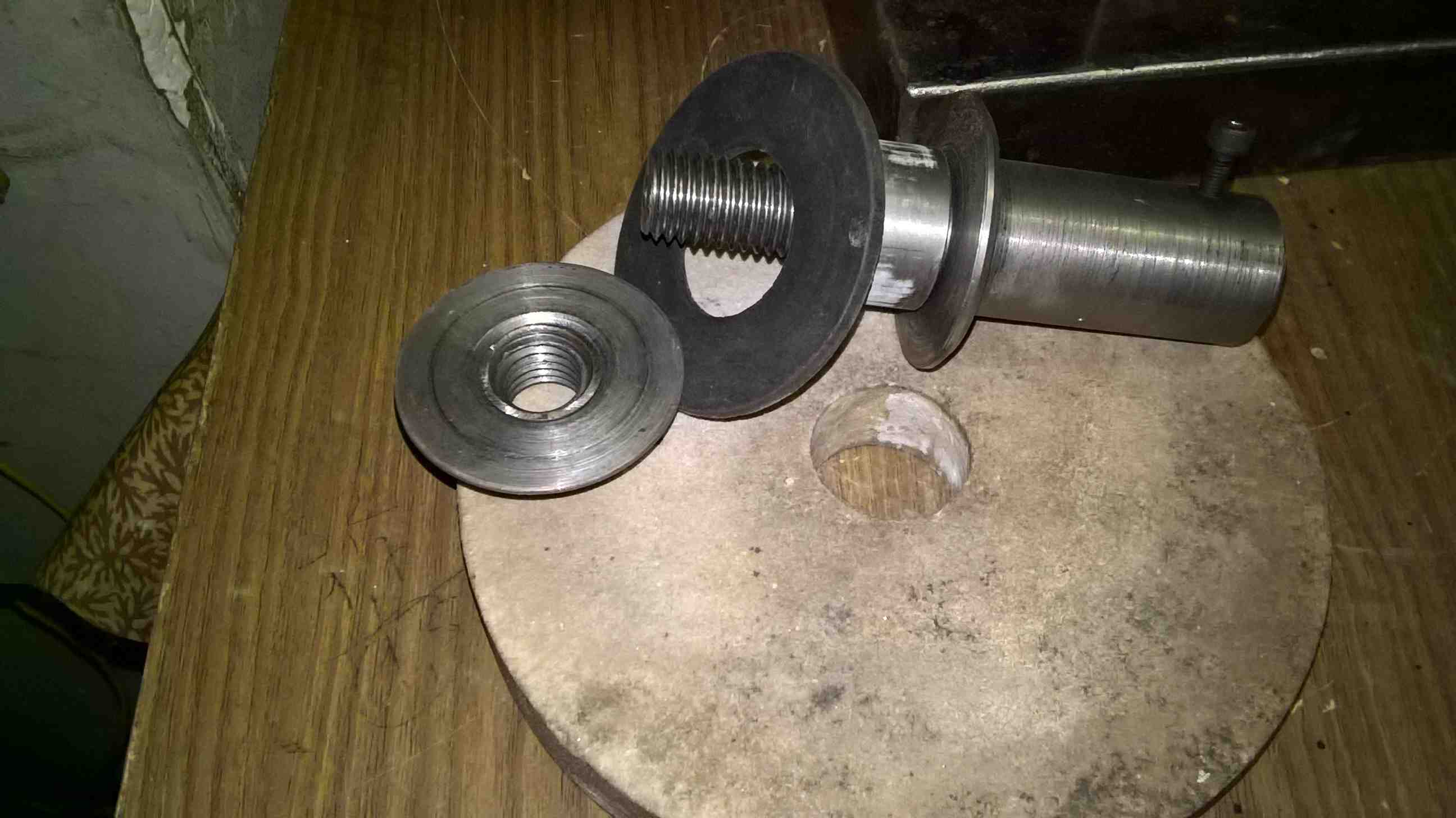

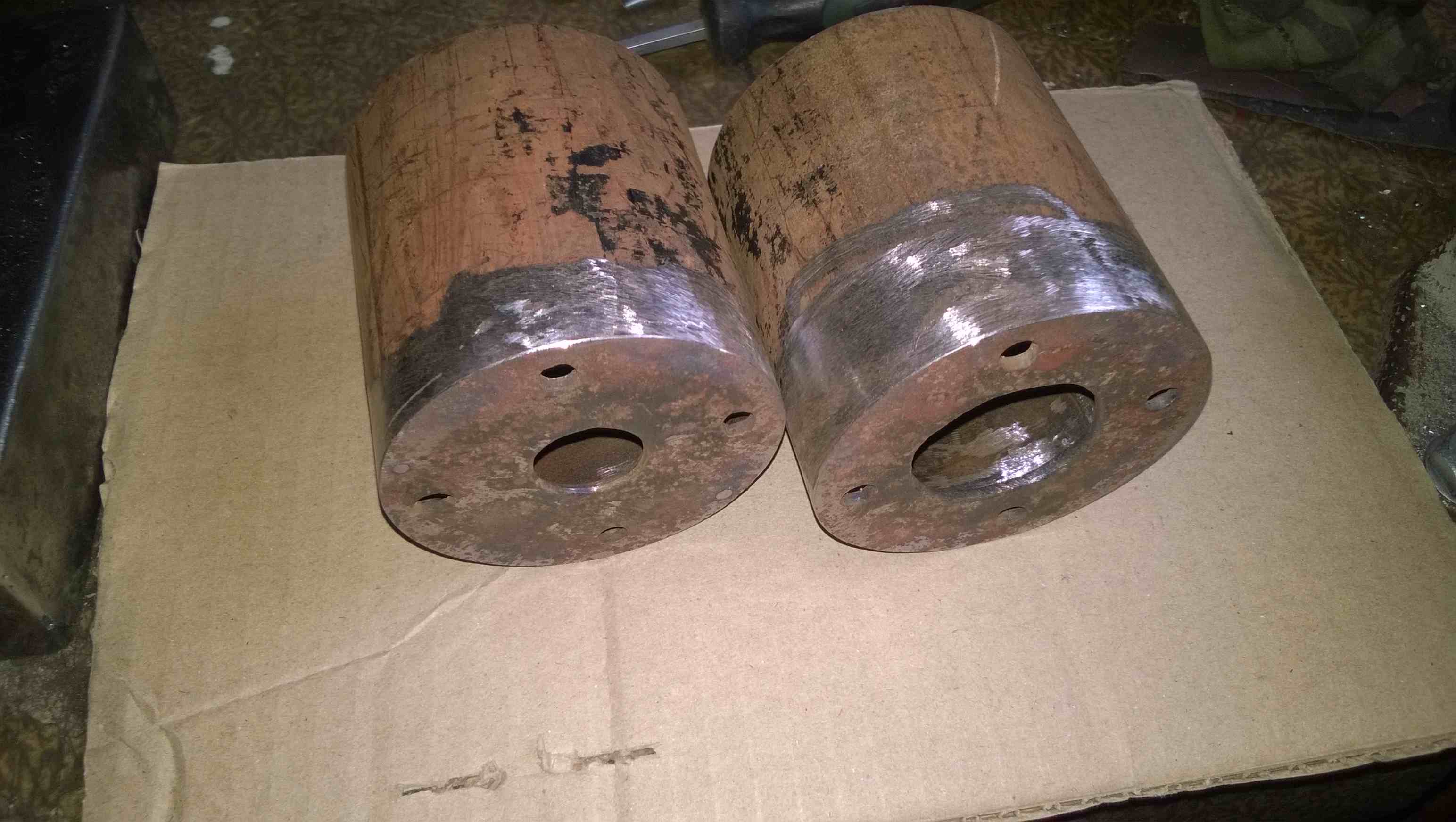

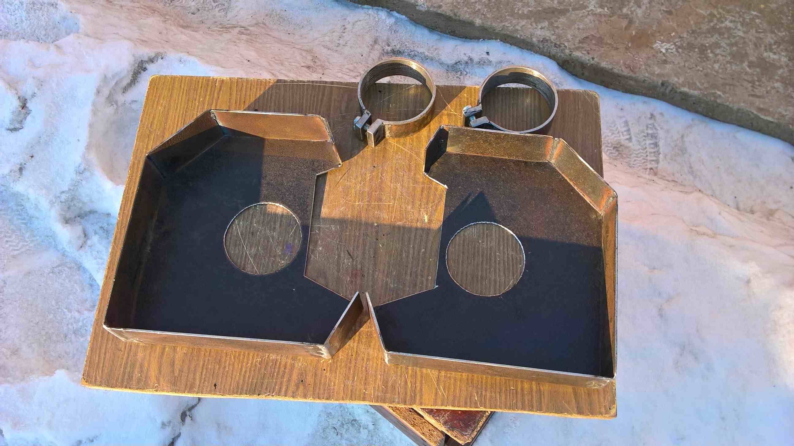

Protection of stone
Attachment 18378Attachment 18379Attachment 18380Attachment 18381

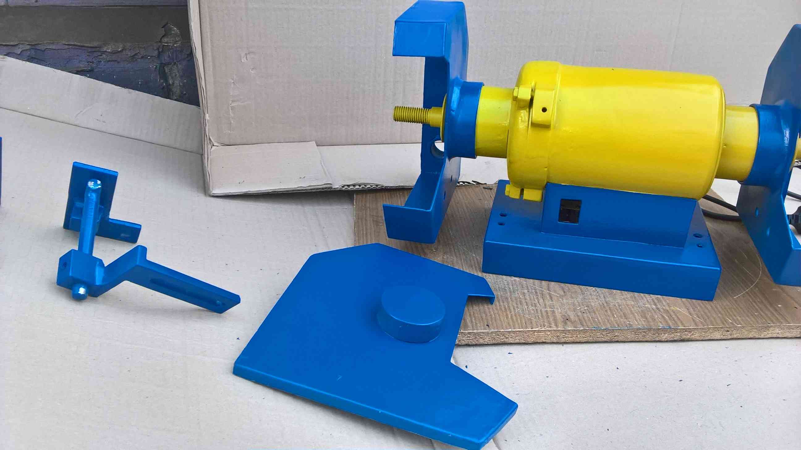

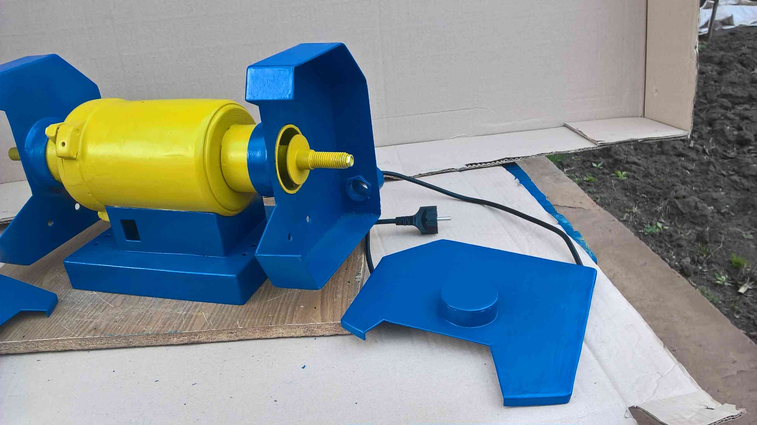

That's how it looks painted with a primer.Attachment 18382Attachment 18383Attachment 18384

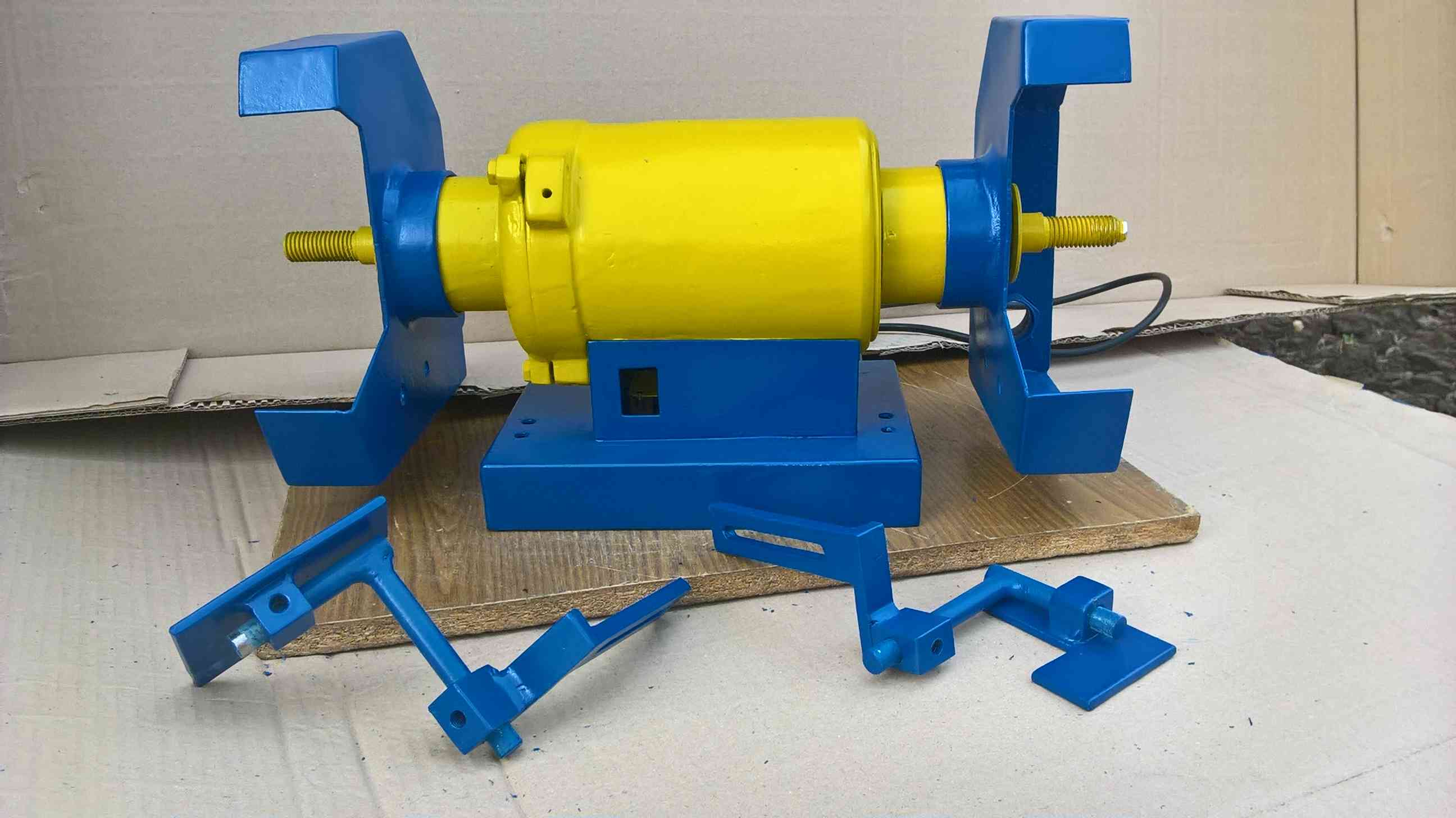

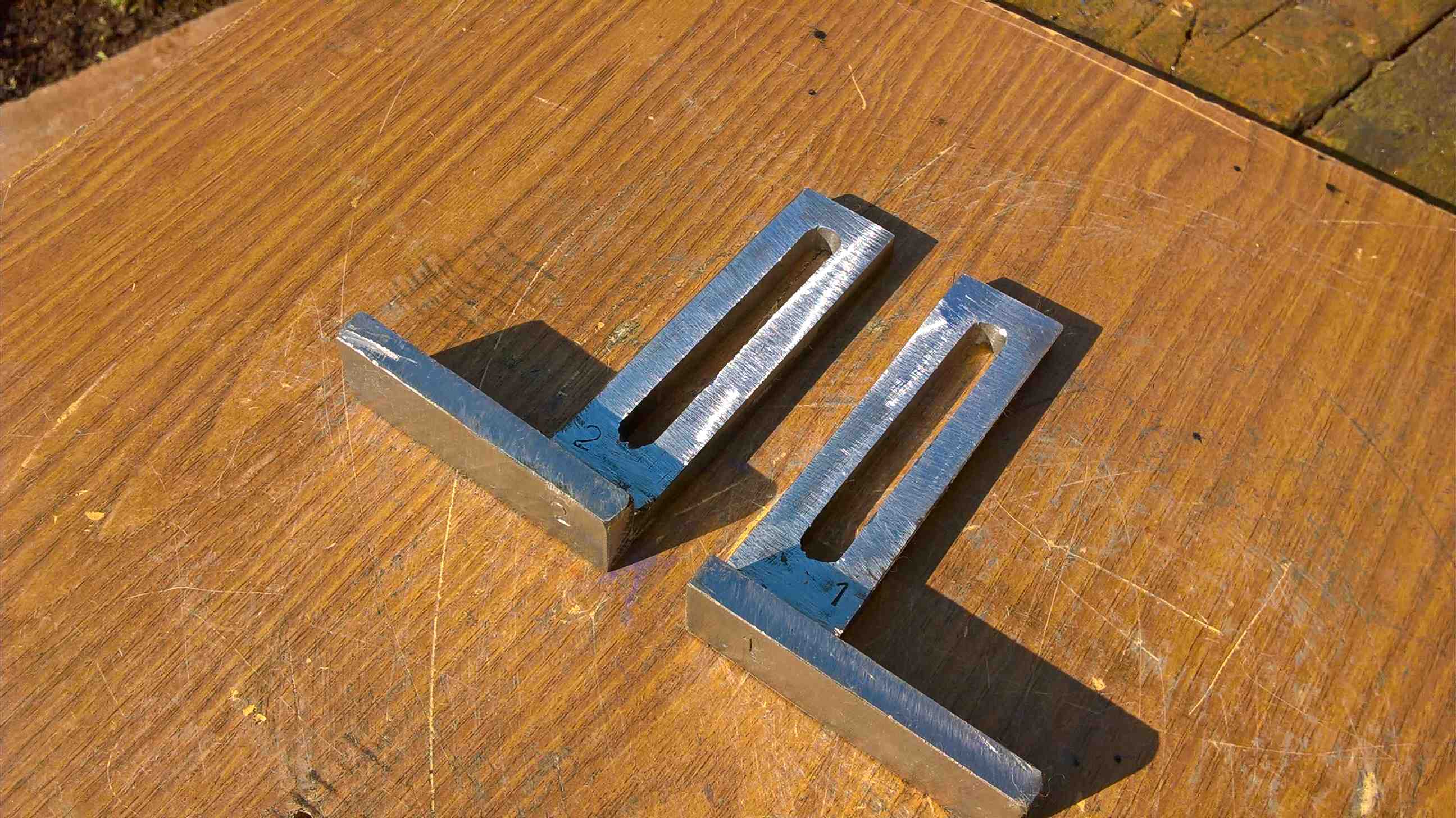

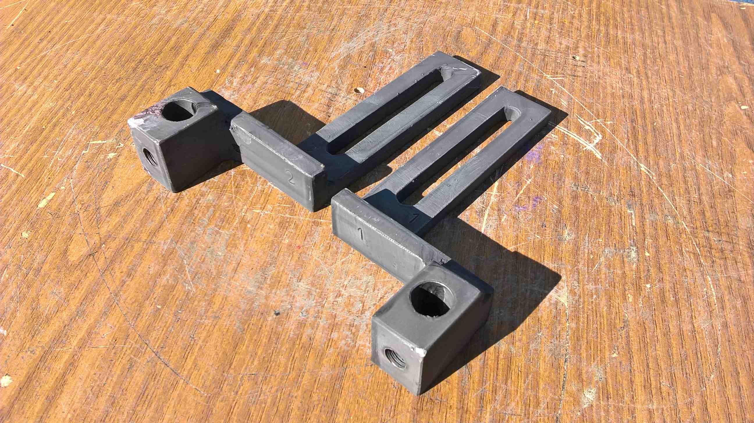

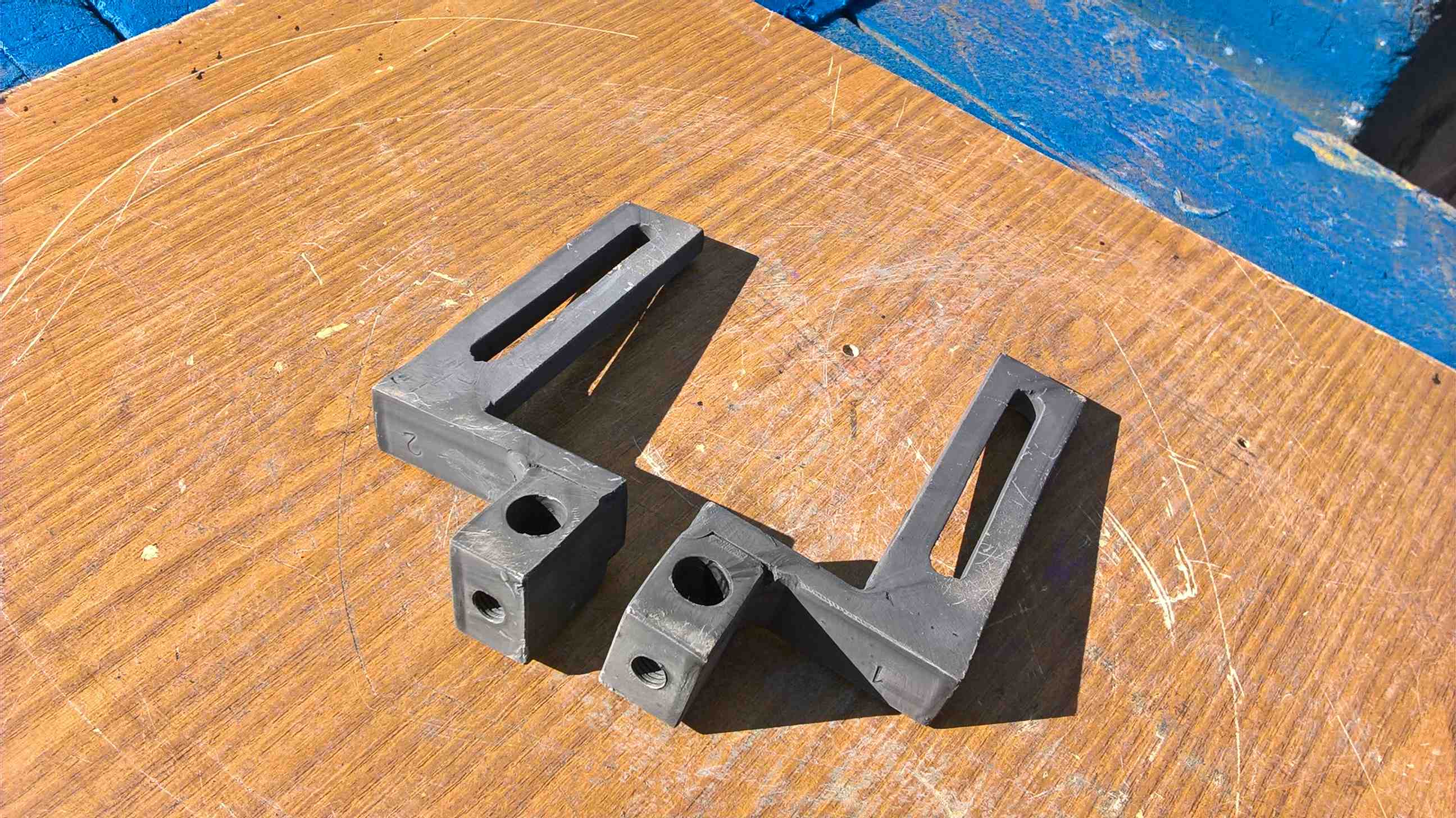

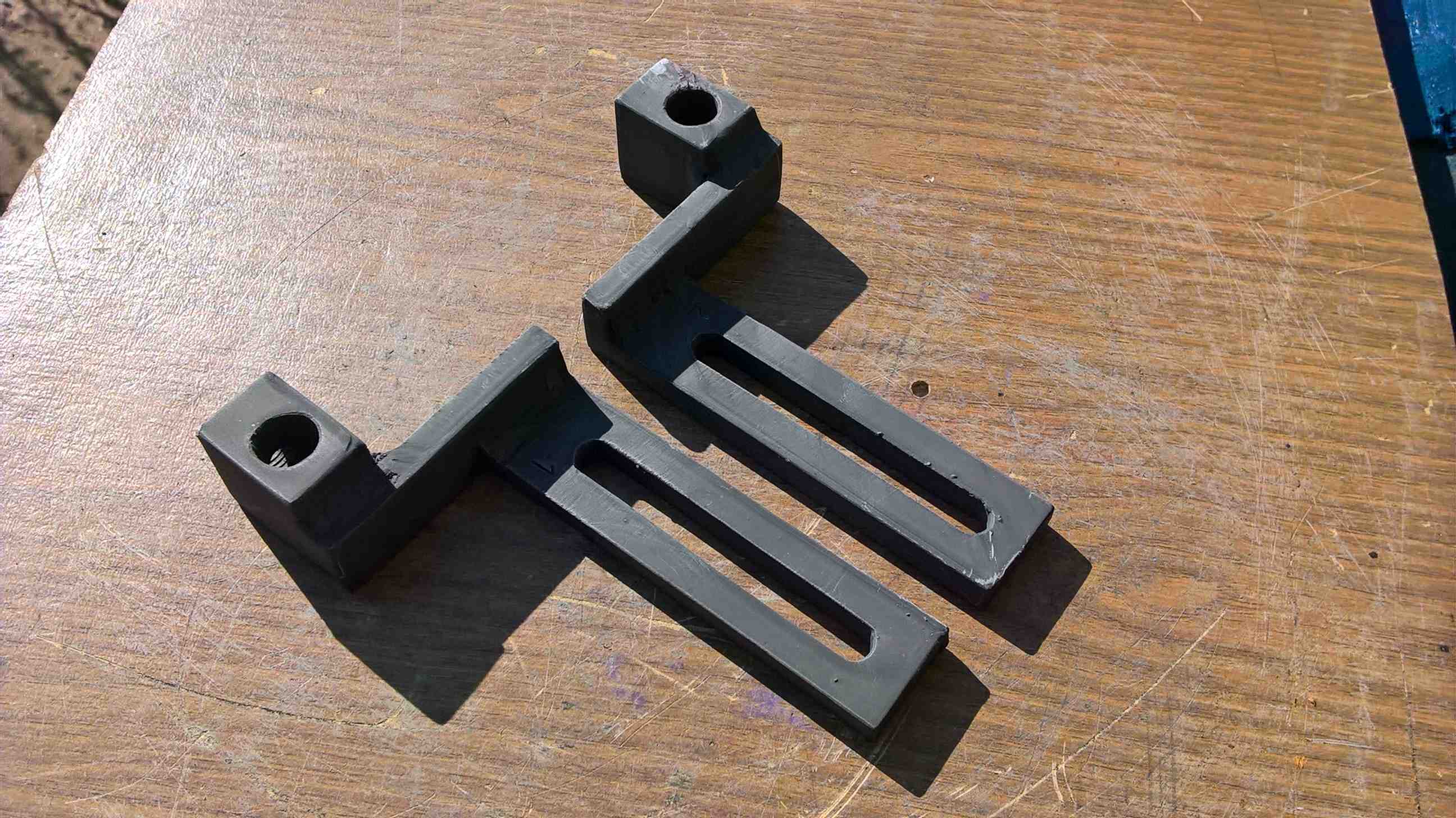

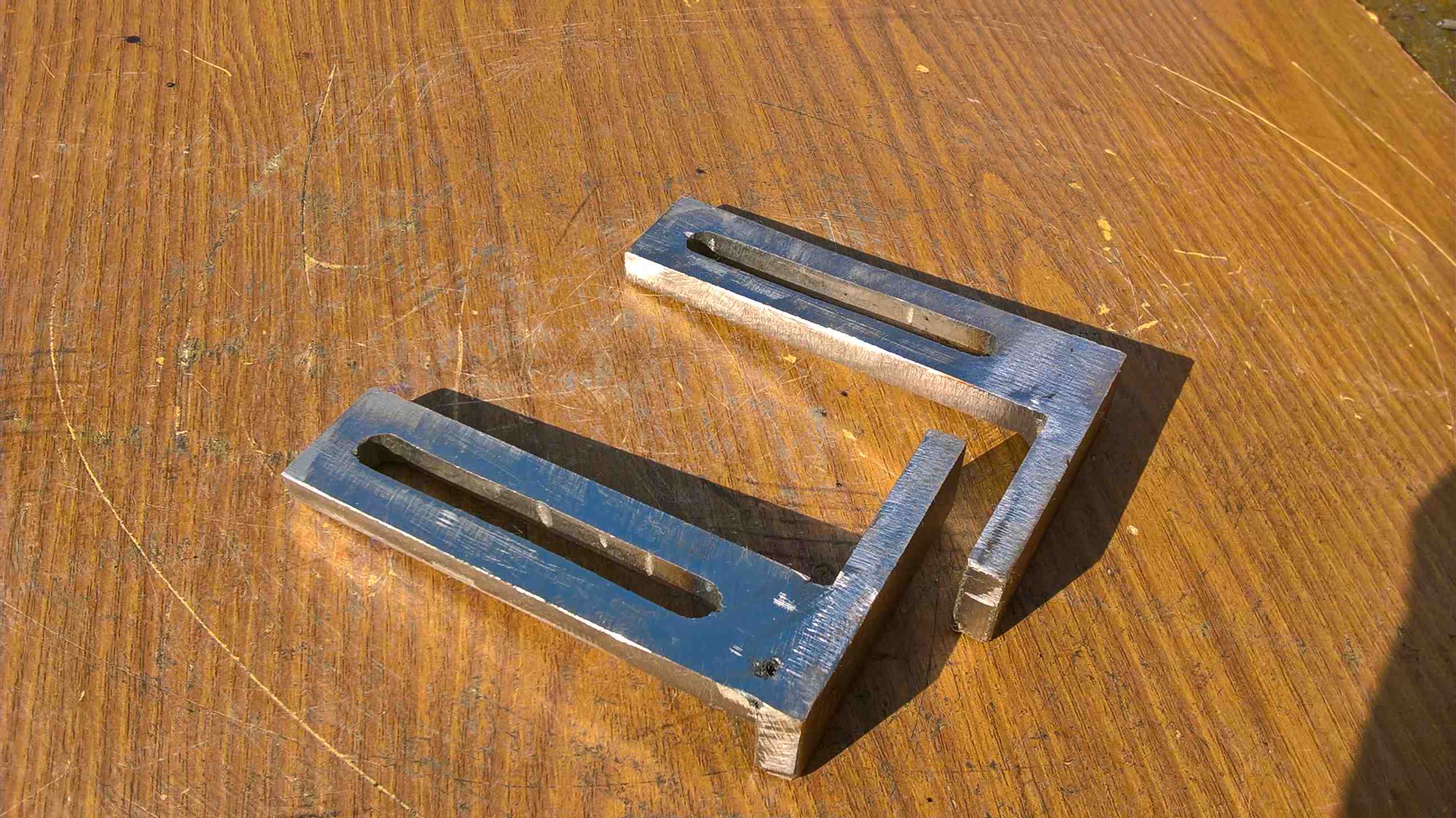

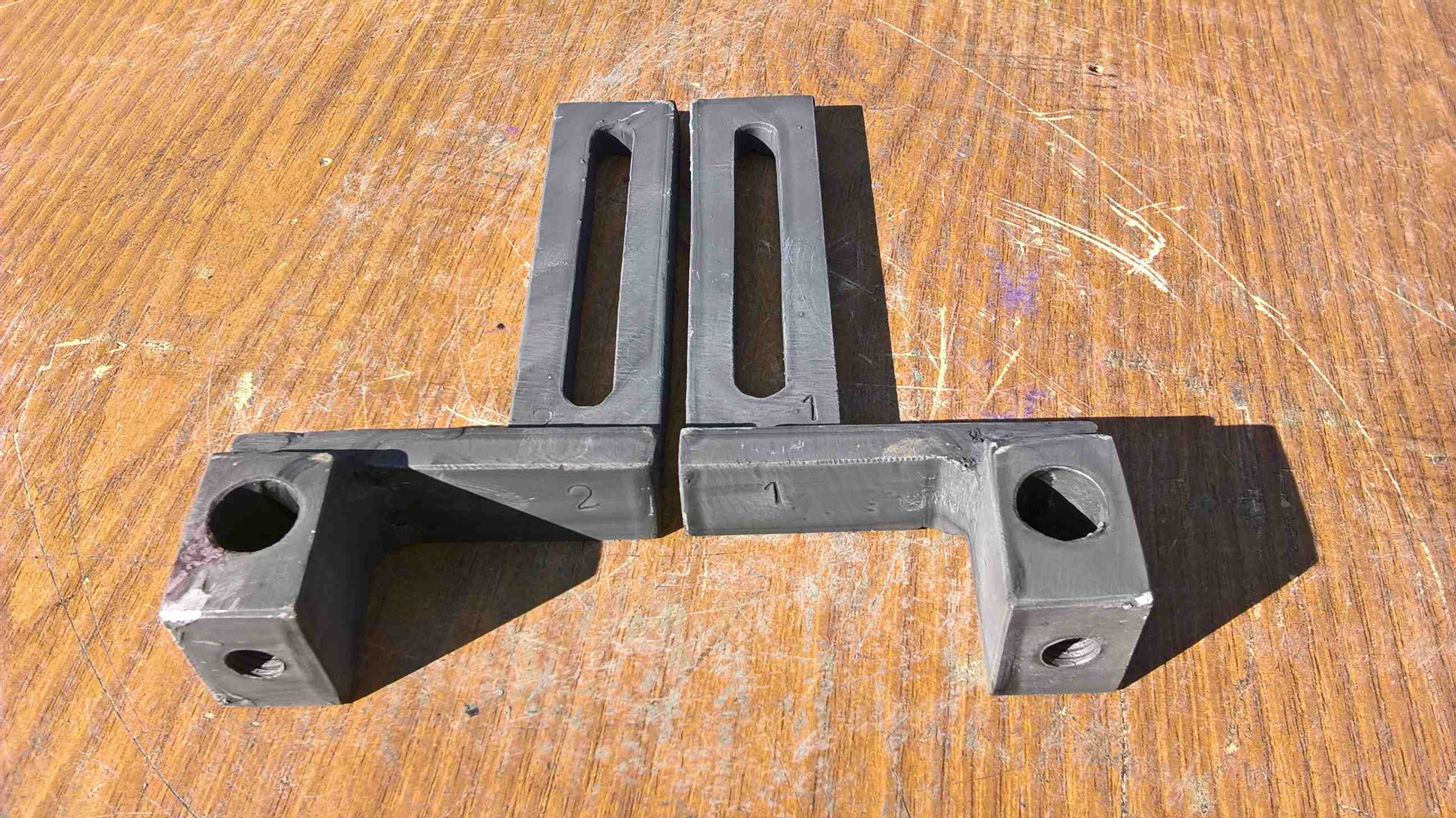

Stone supports.
Attachment 18385Attachment 18386Attachment 18387Attachment 18388Attachment 18389Attachment 18390

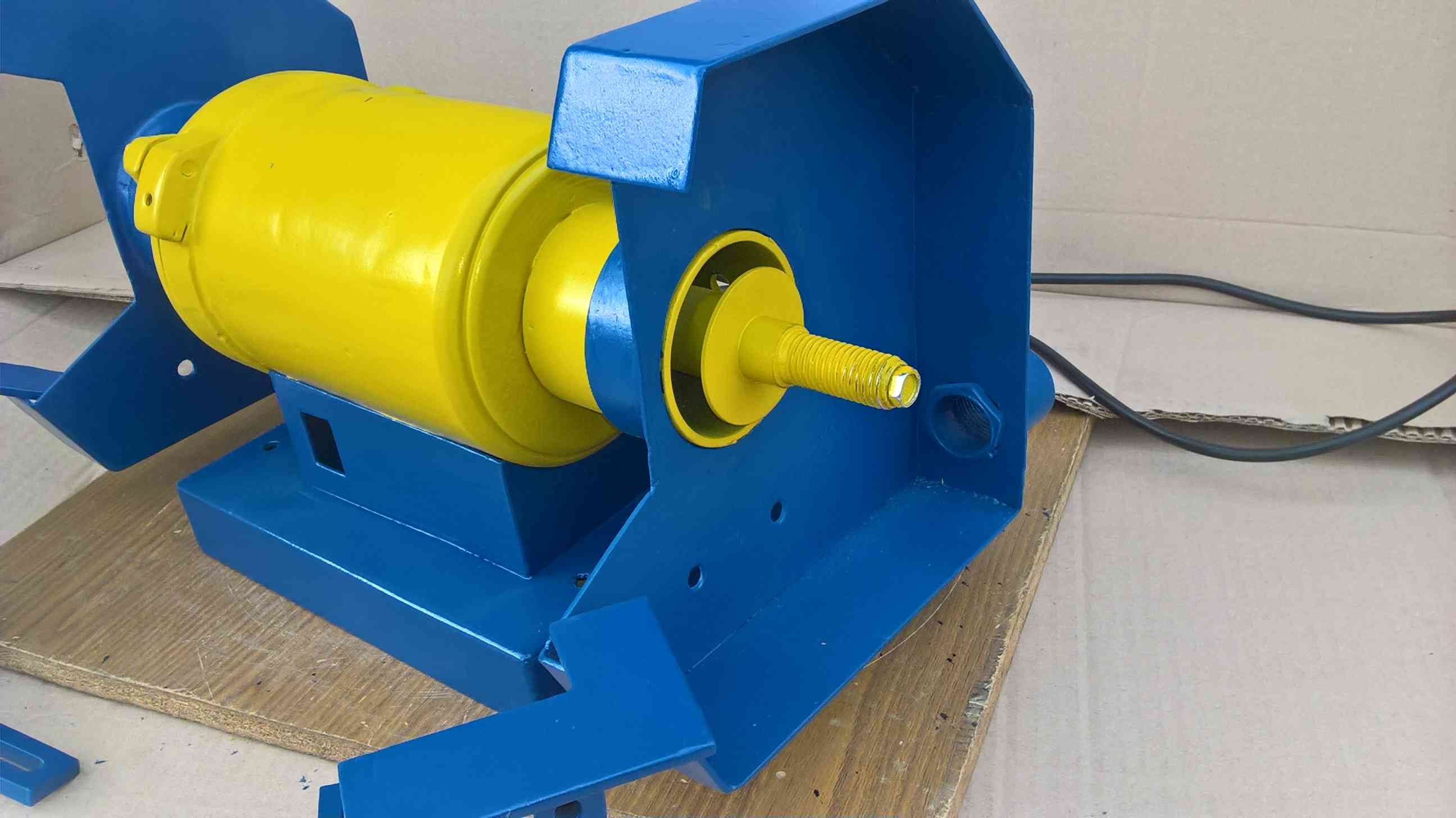

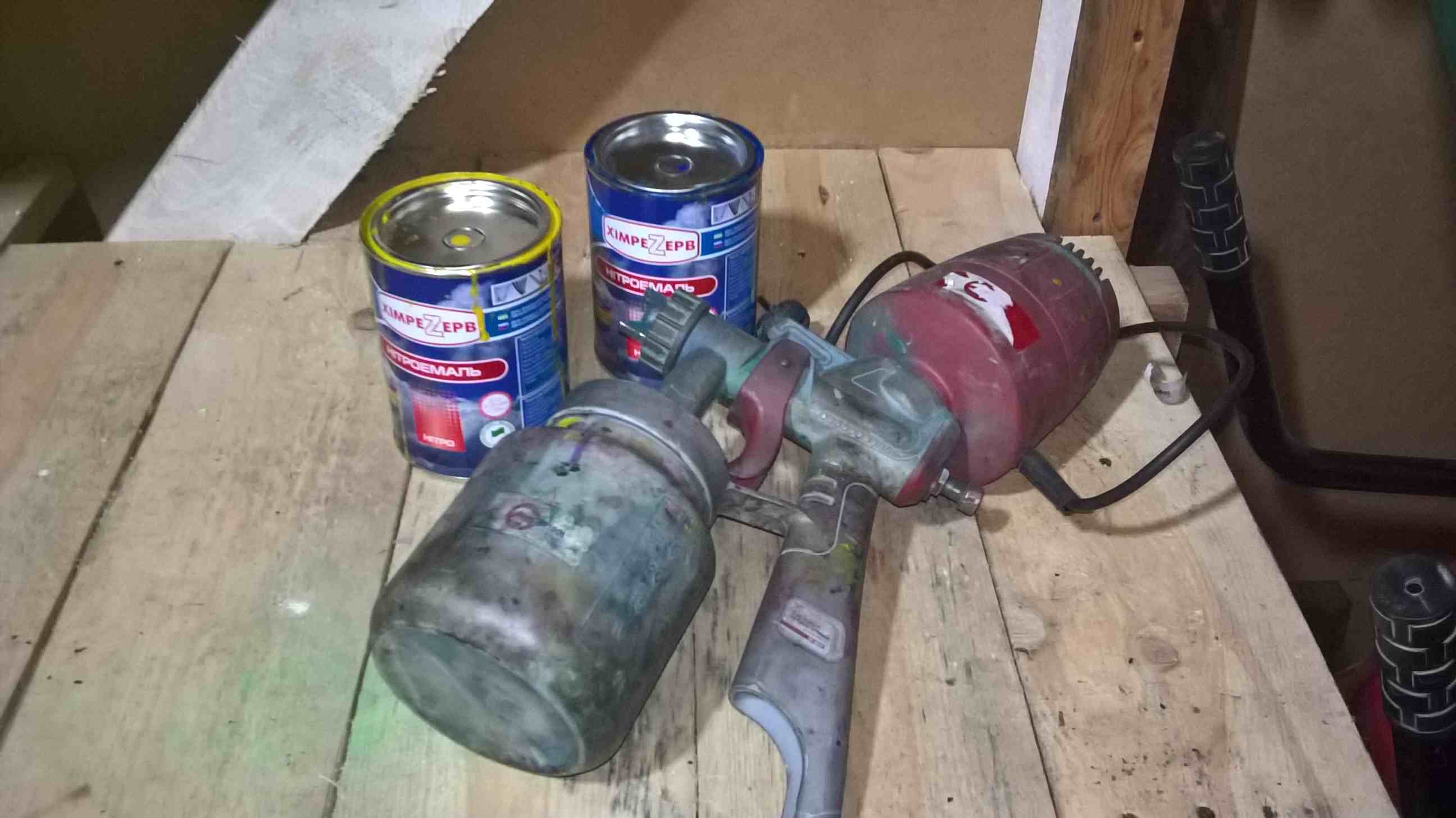

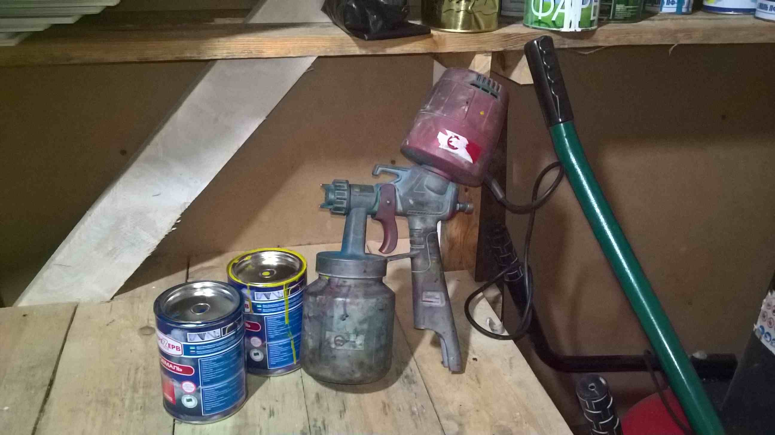

Coloring Bench Grinder Attachment 18391Attachment 18392Attachment 18393Attachment 18394Attachment 18395Attachment 18396Attachment 18397Attachment 18398Attachment 18399

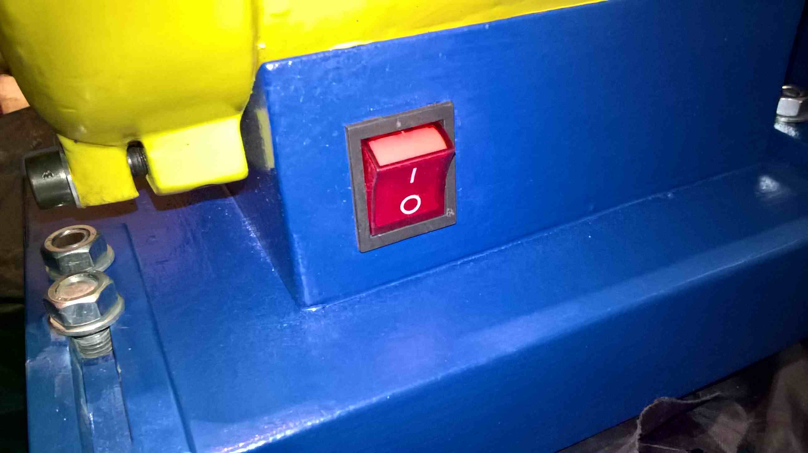

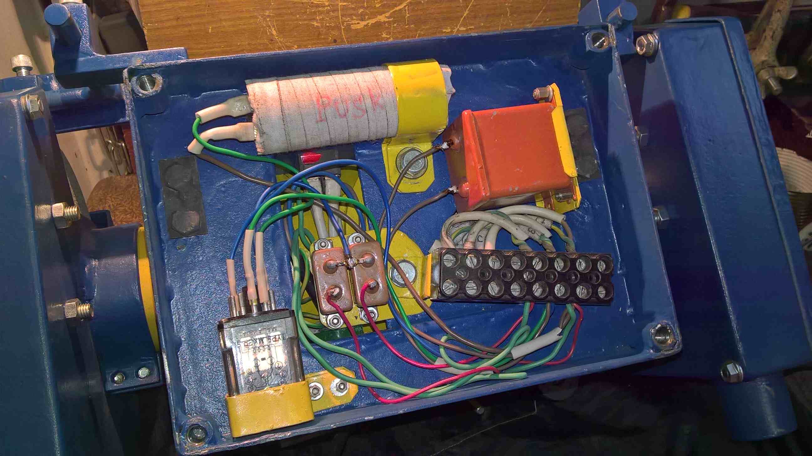

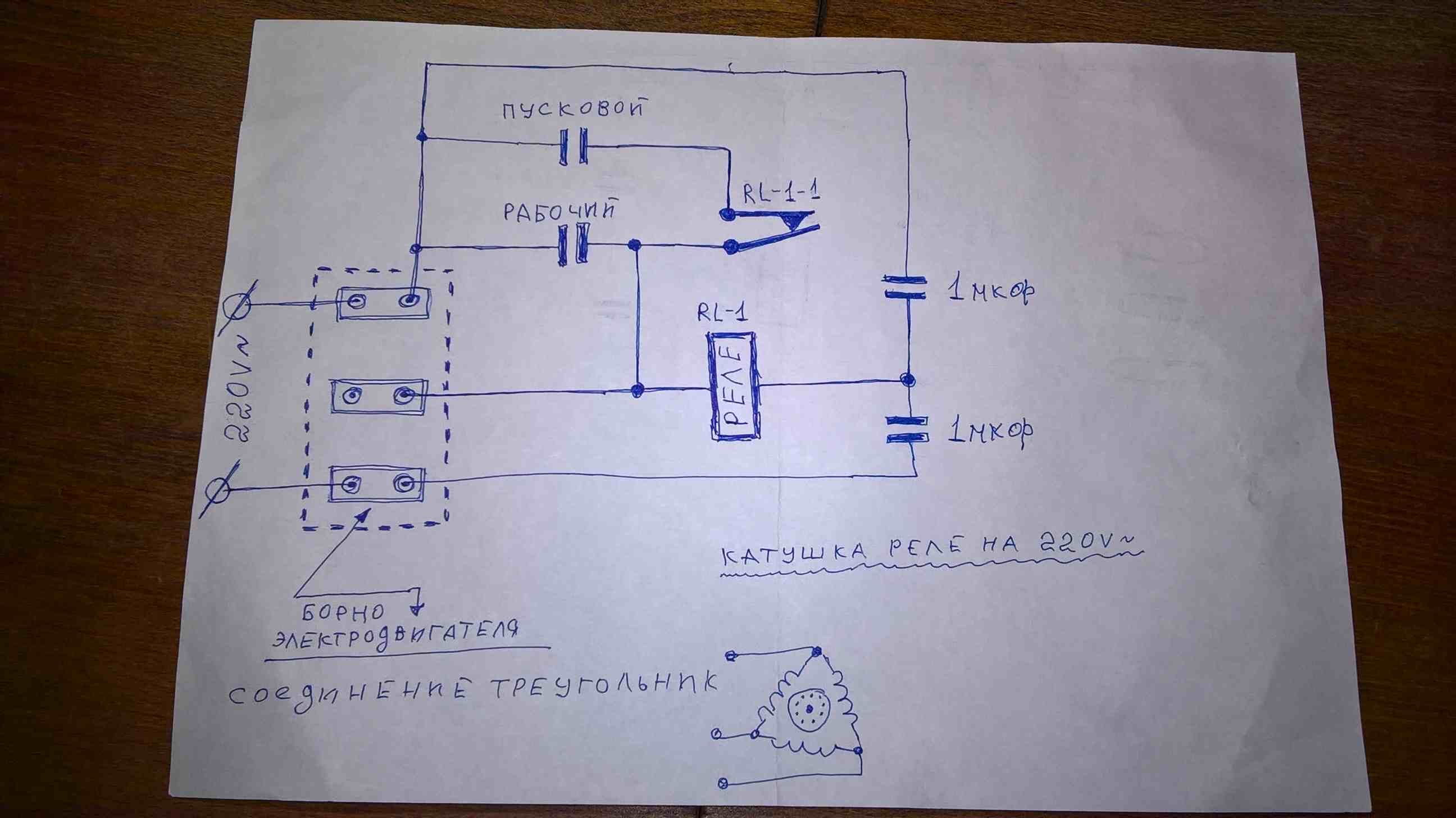

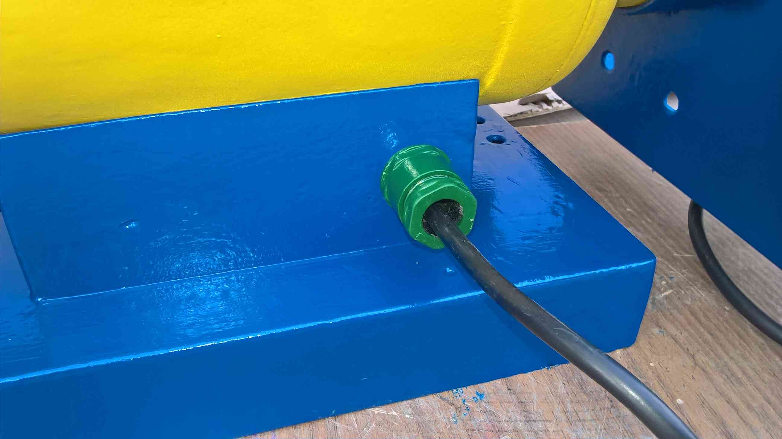

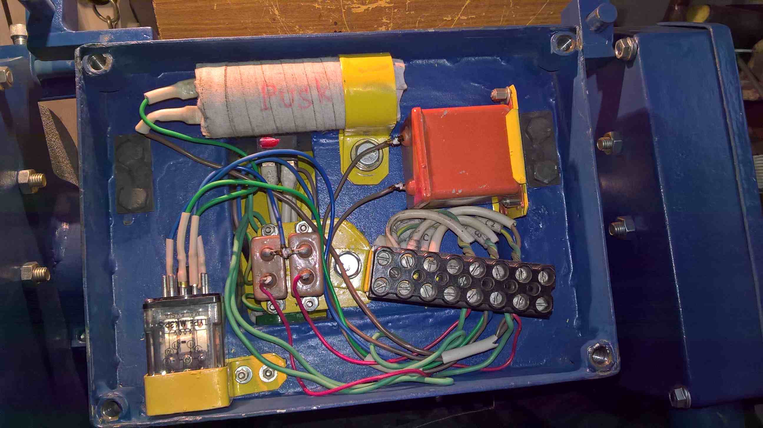

Electrics
The scheme of starting the electric motor from the network 220 volts.
Attachment 18400Attachment 18401Attachment 18402Attachment 18403

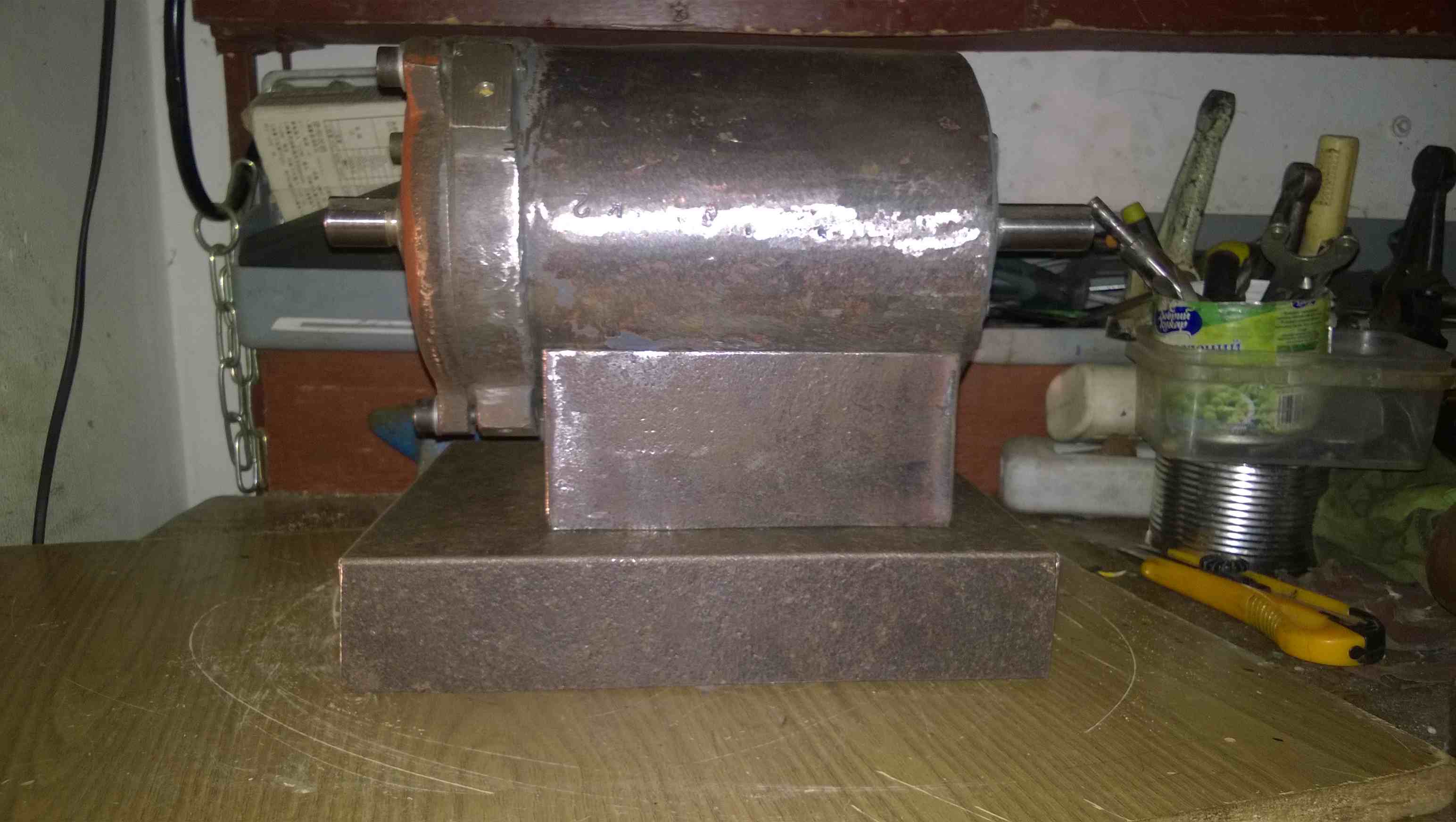

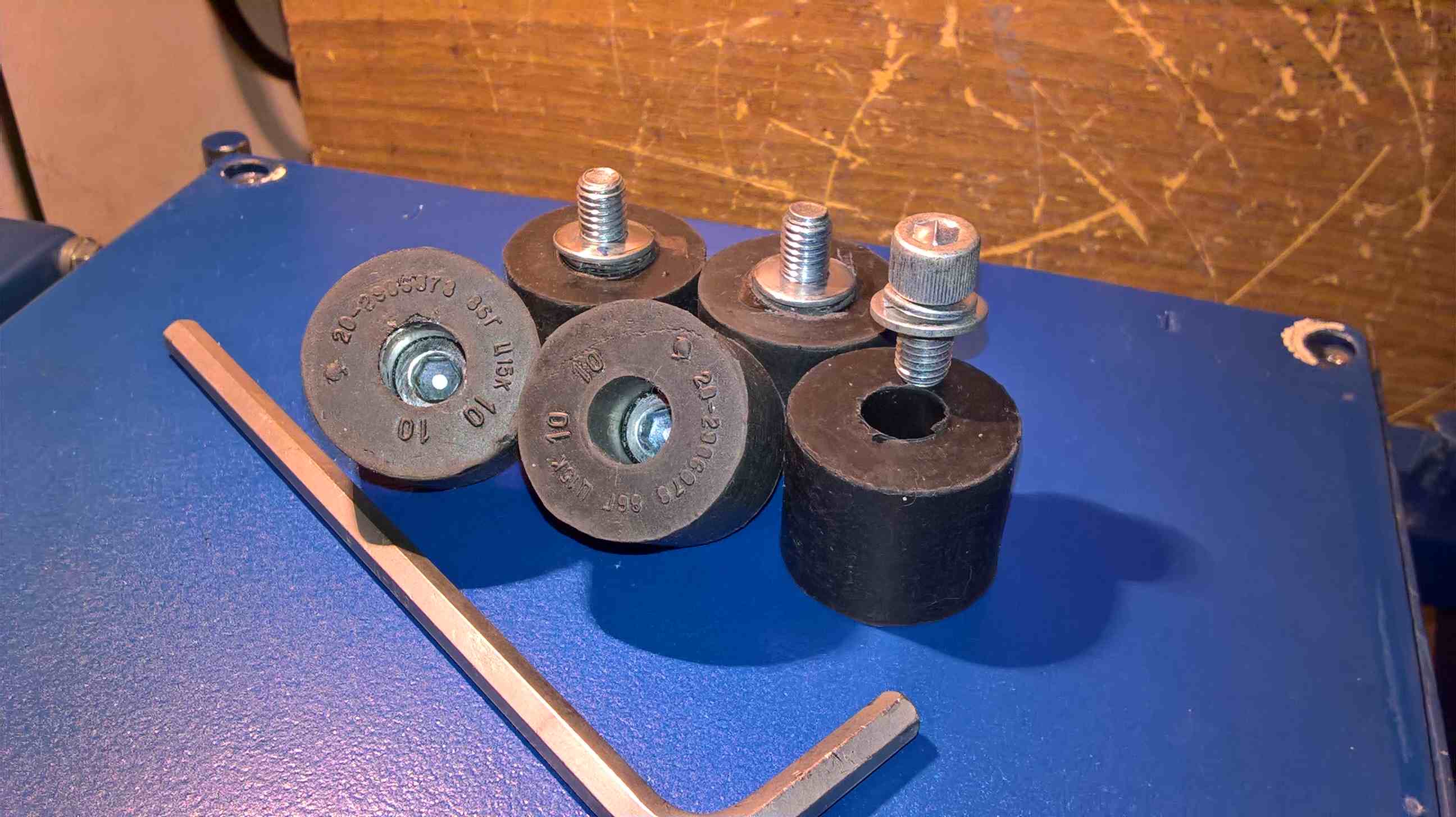

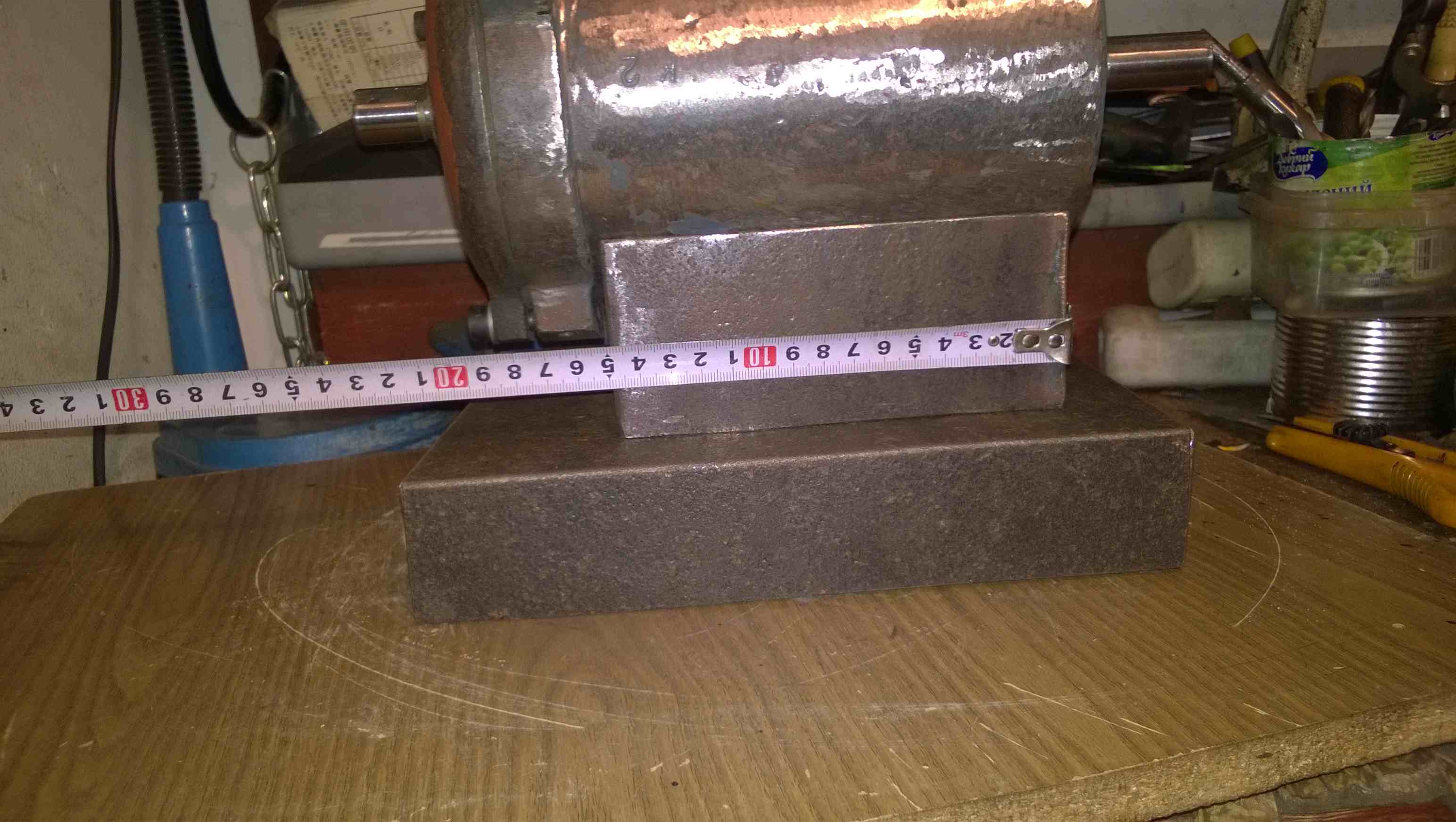

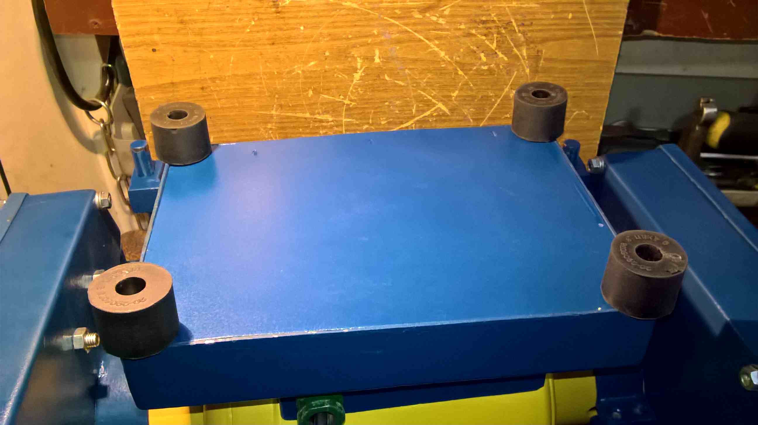

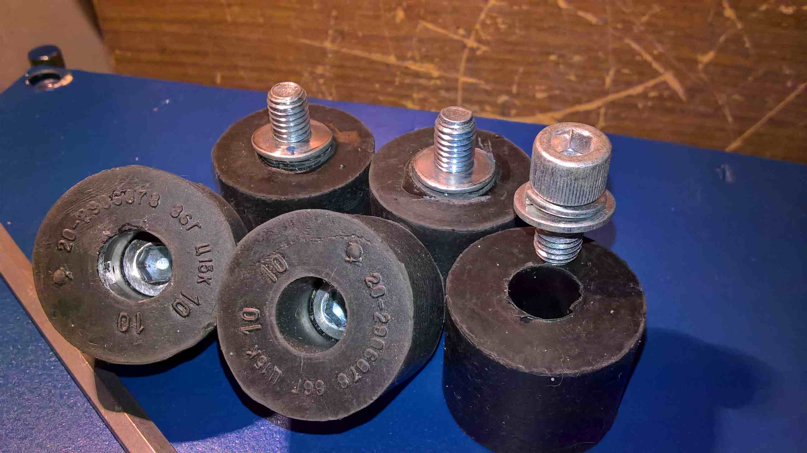

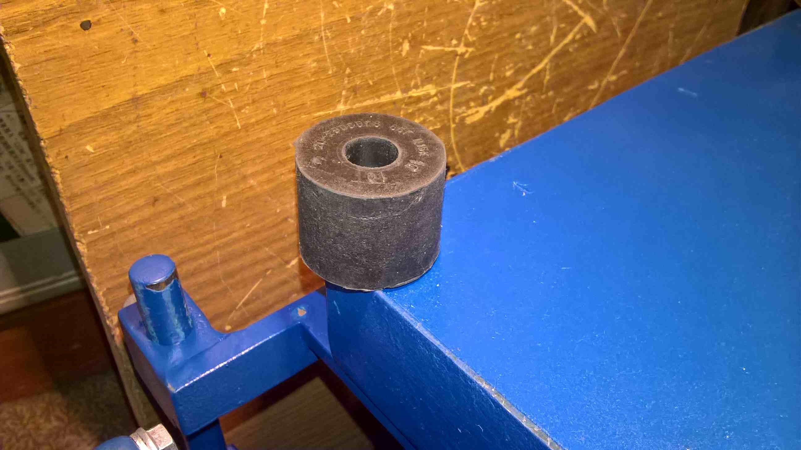

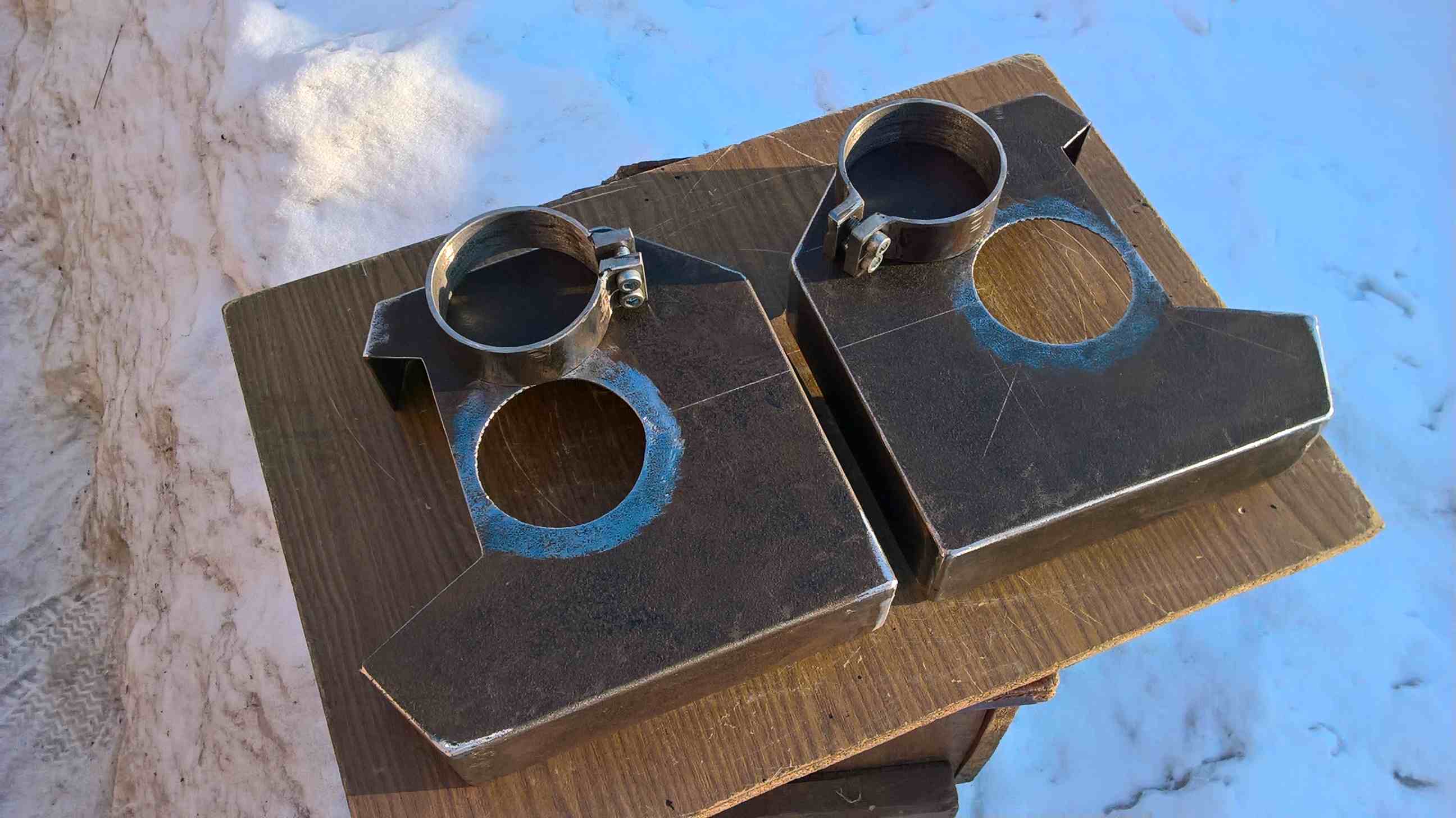

Machine supports.
Attachment 18404Attachment 18405Attachment 18406Attachment 18407
