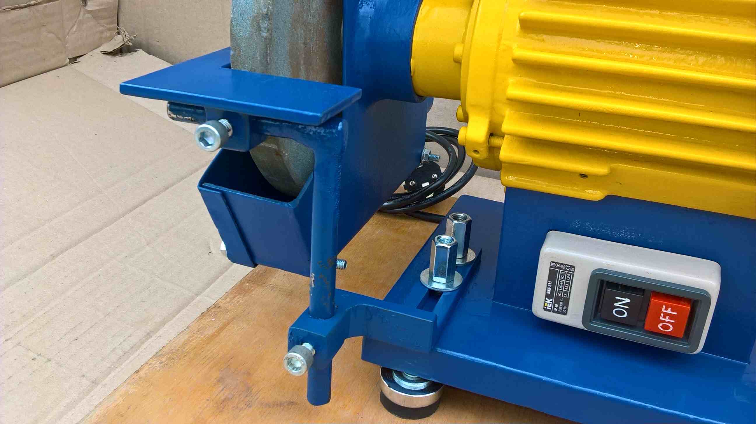

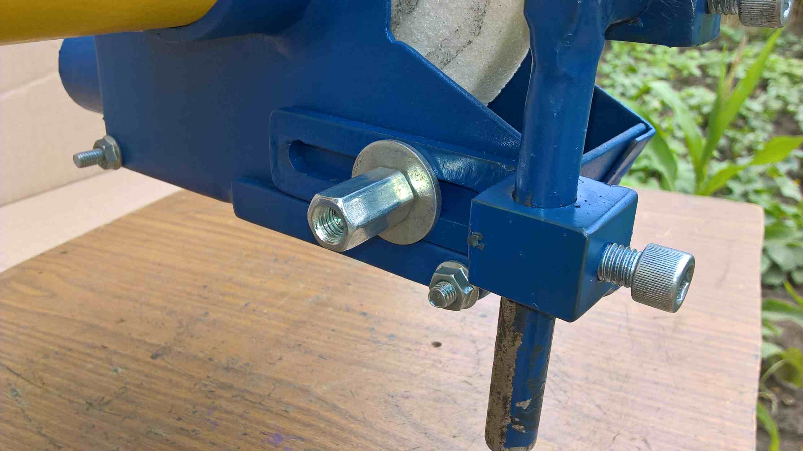

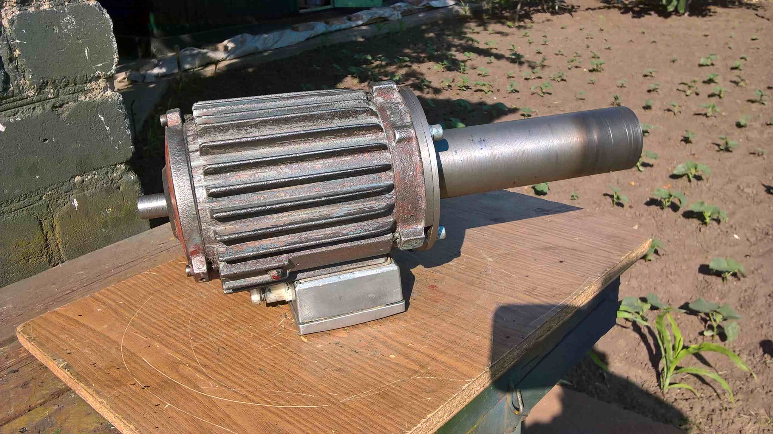

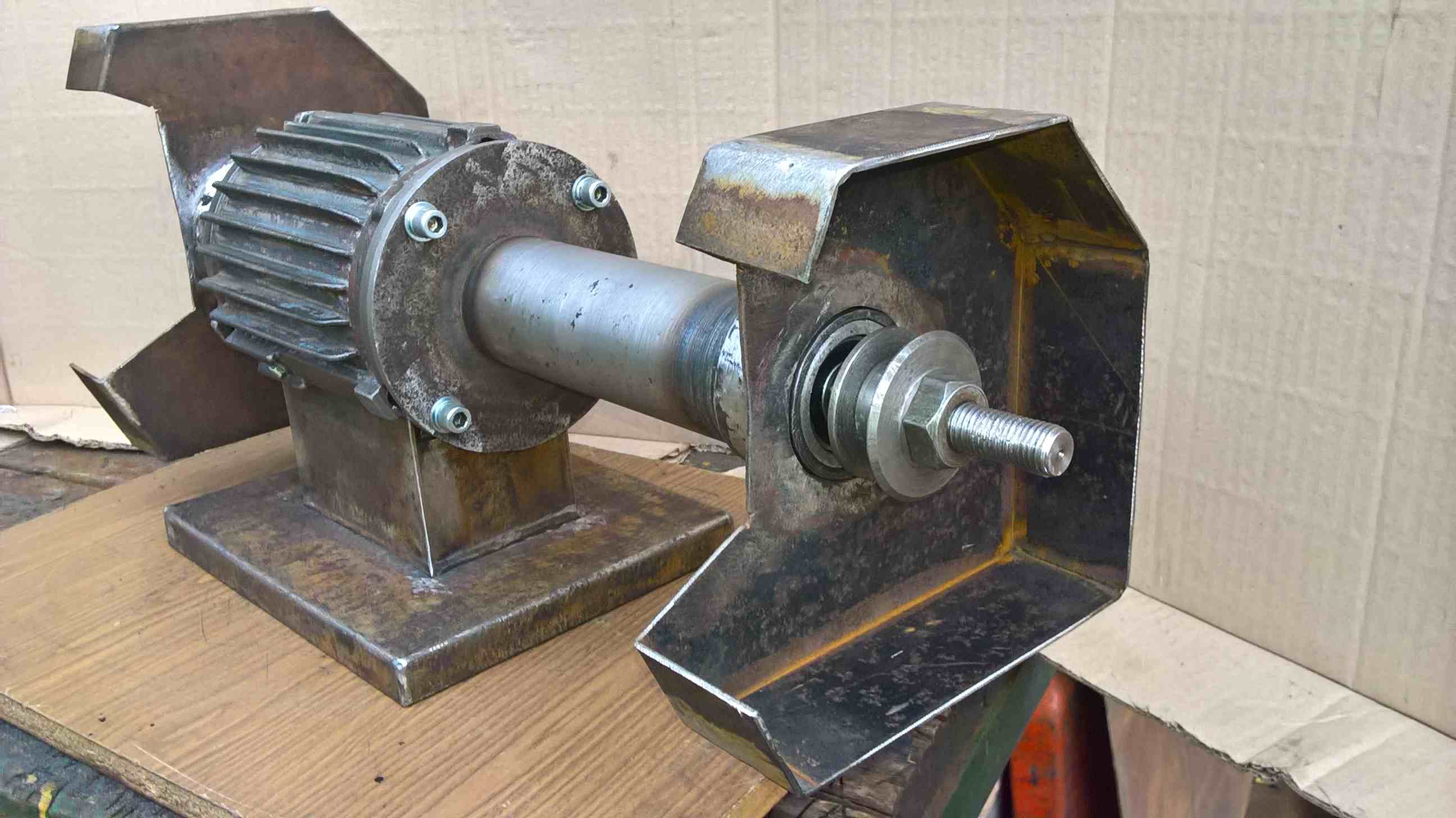

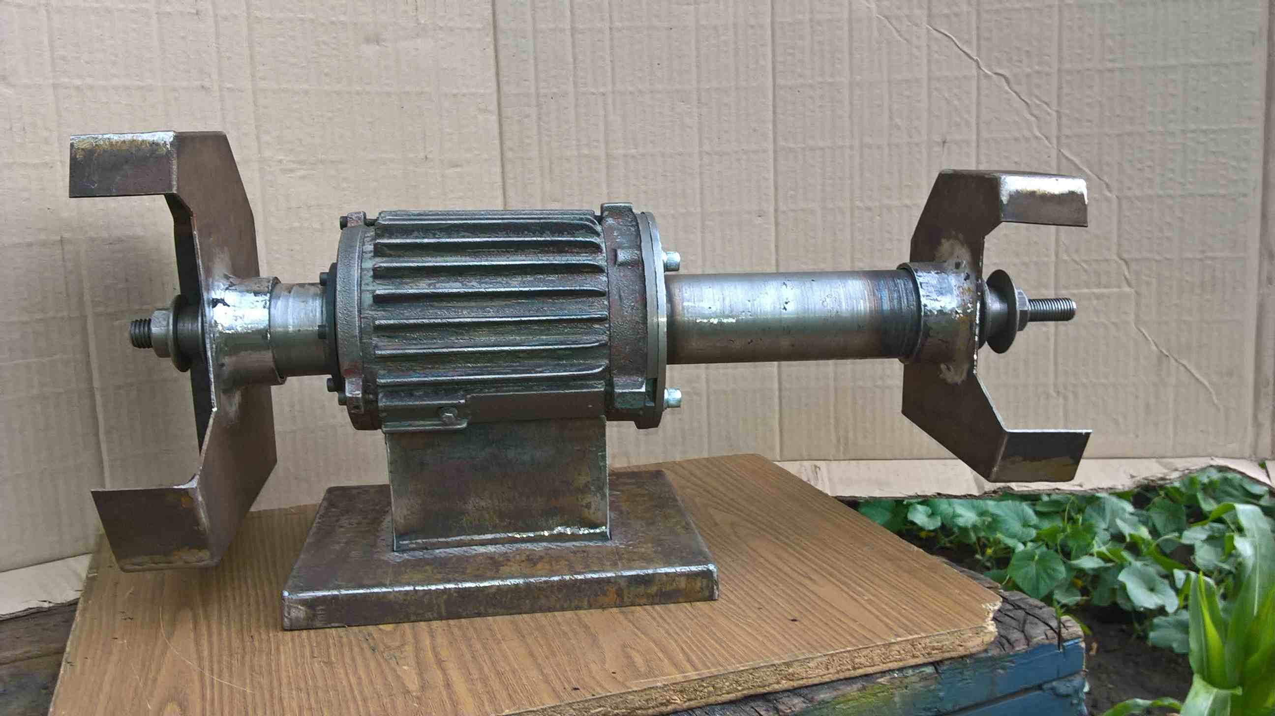

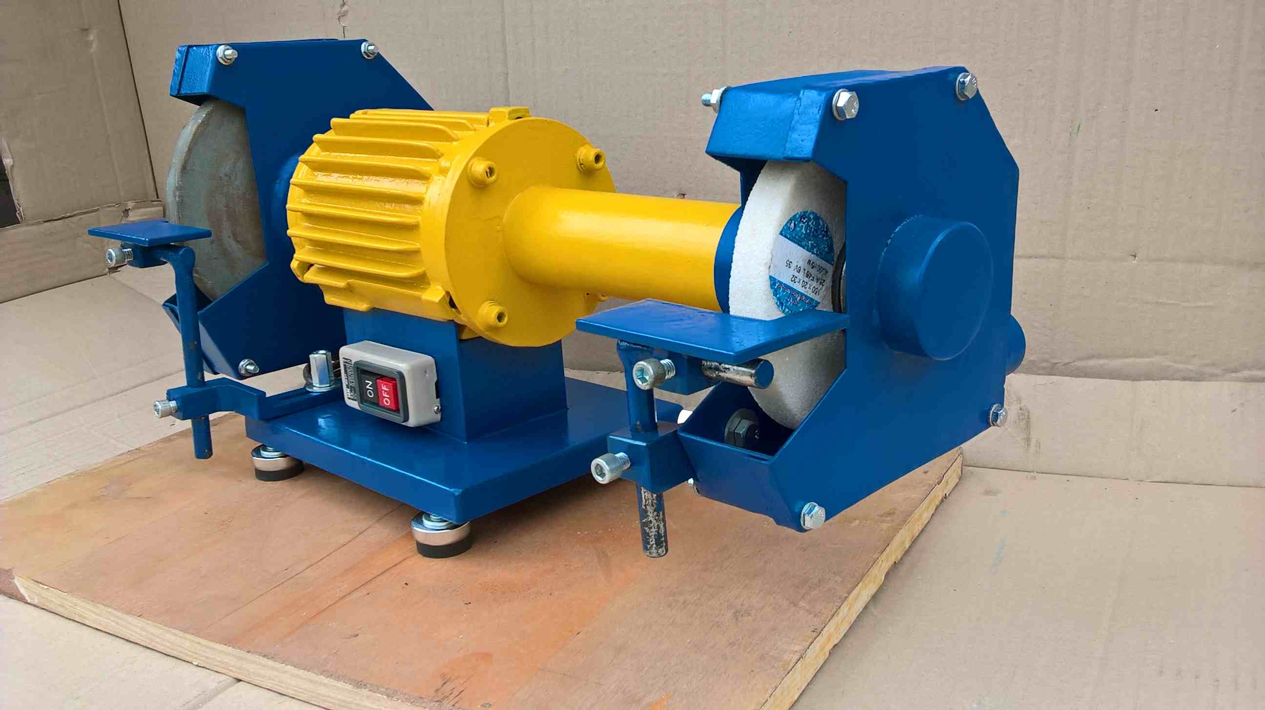

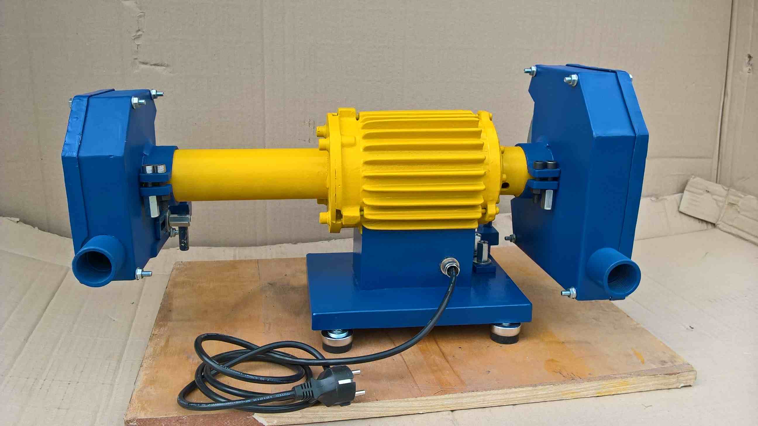

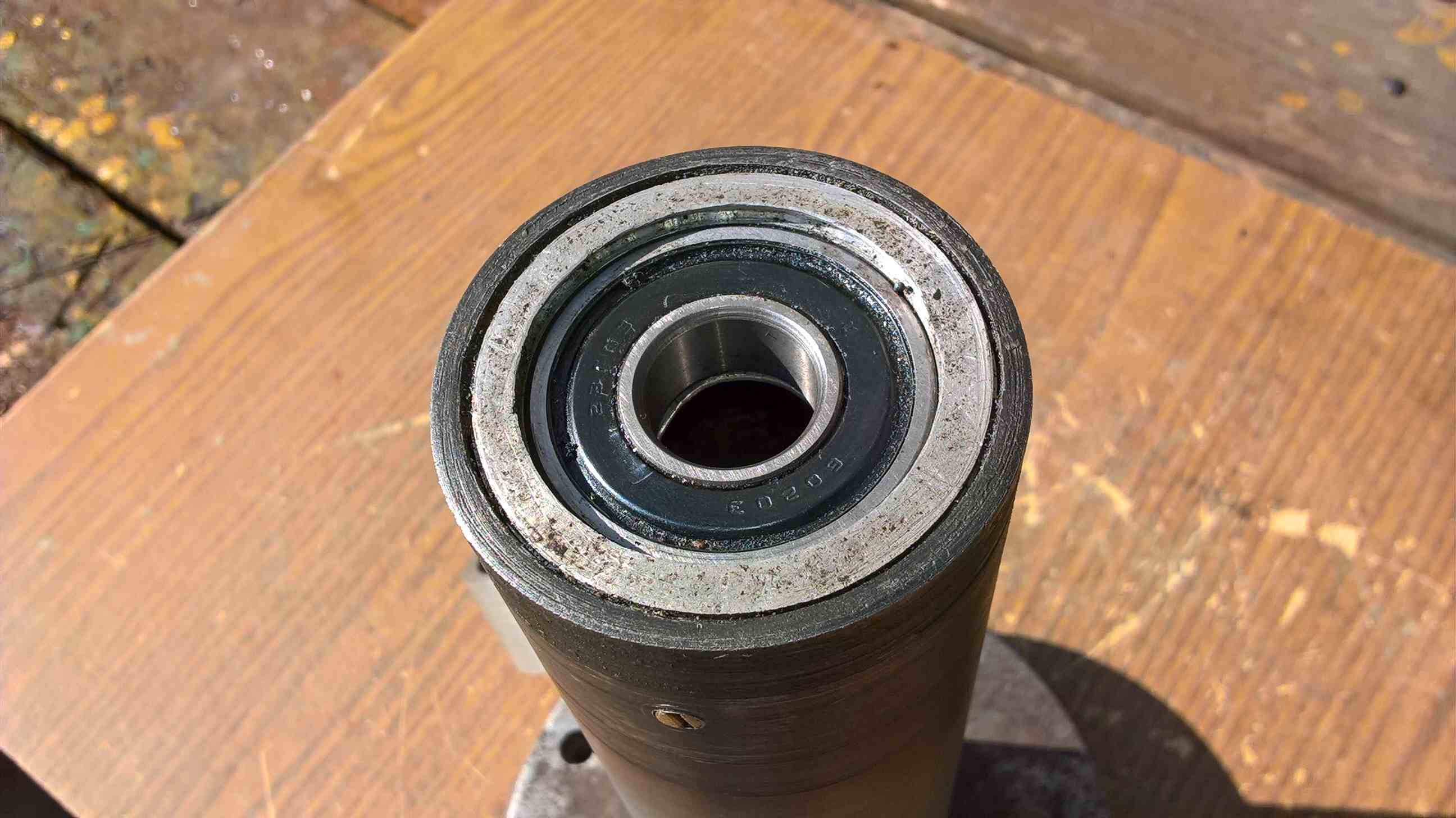

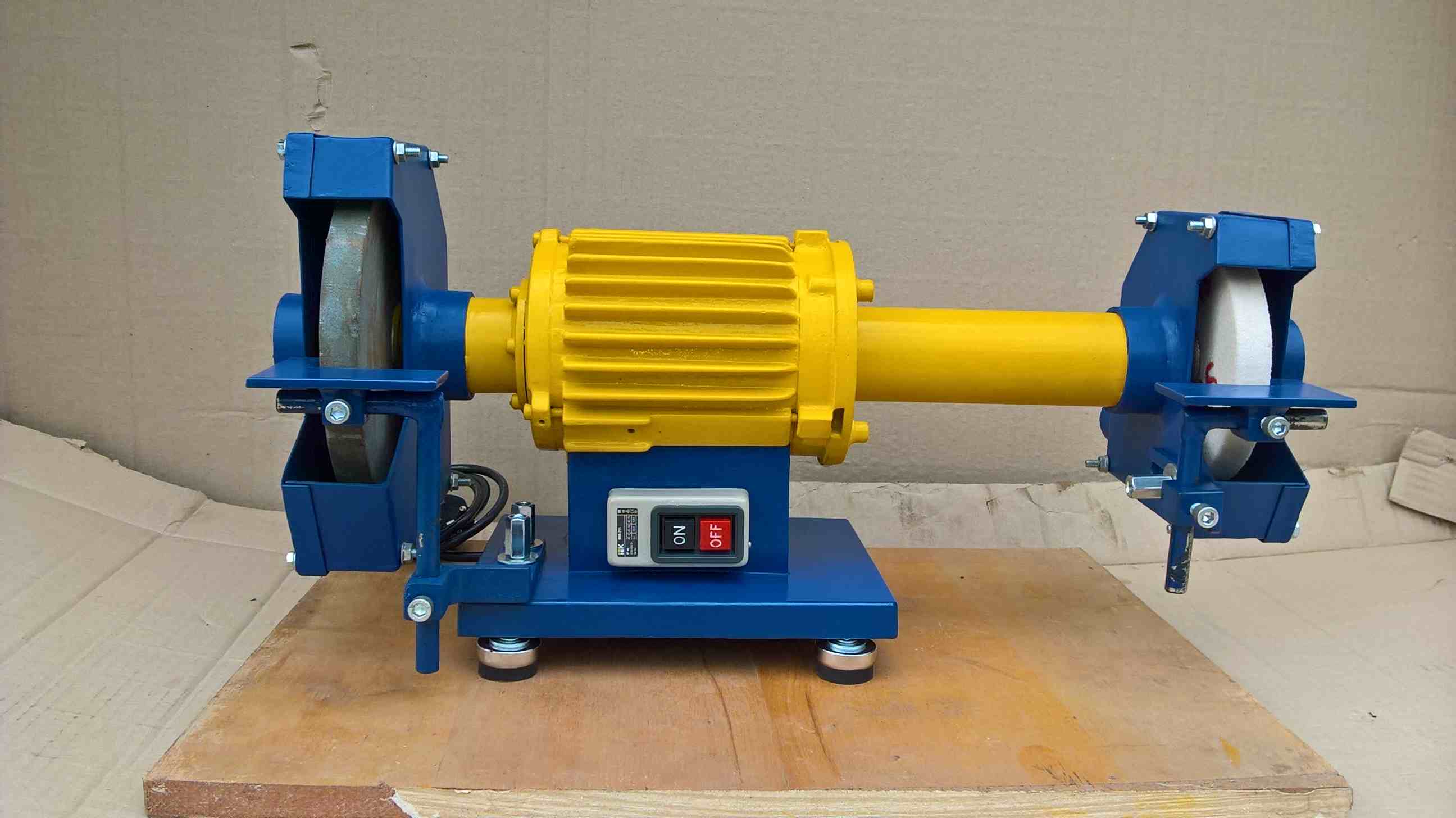

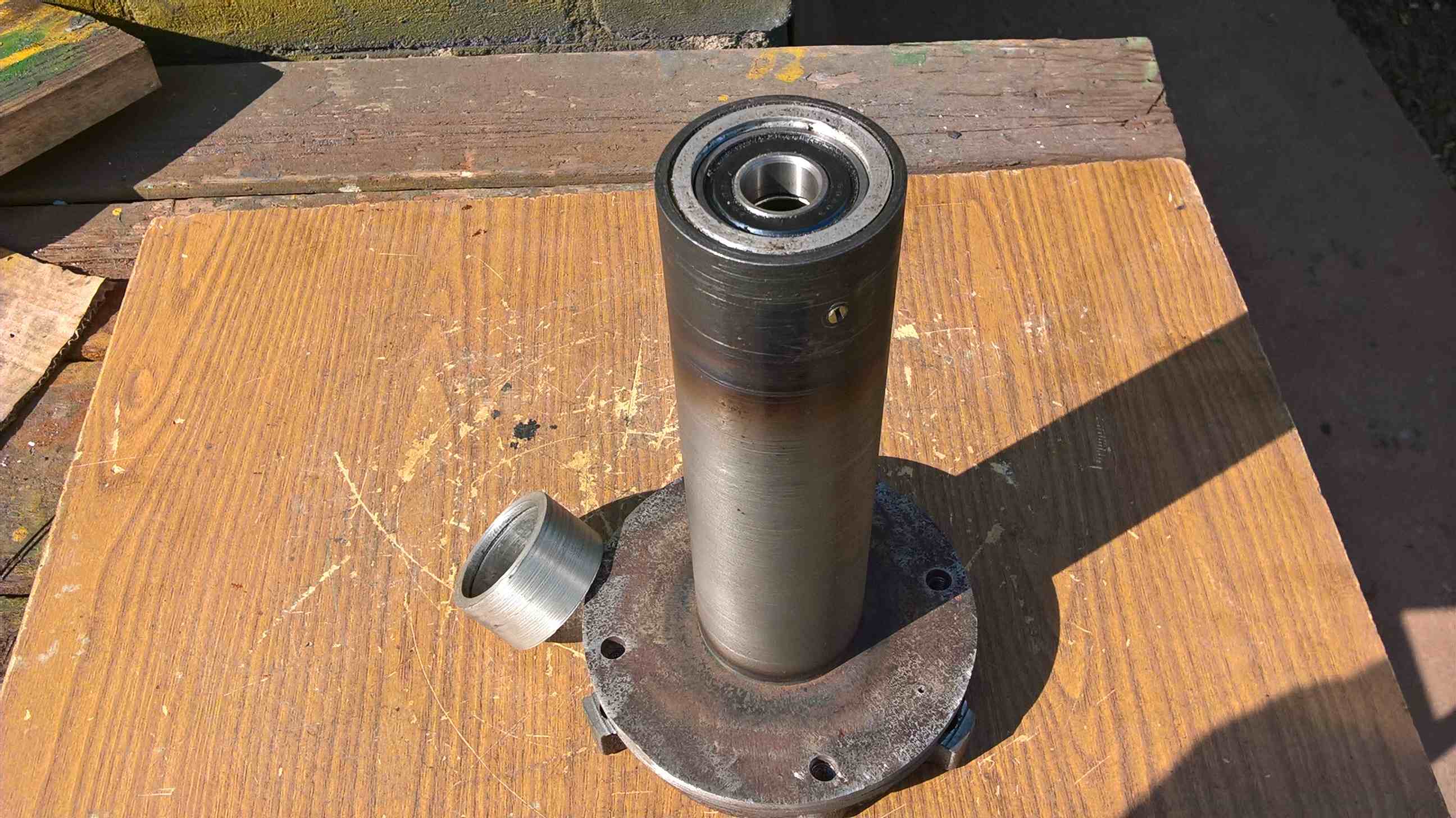

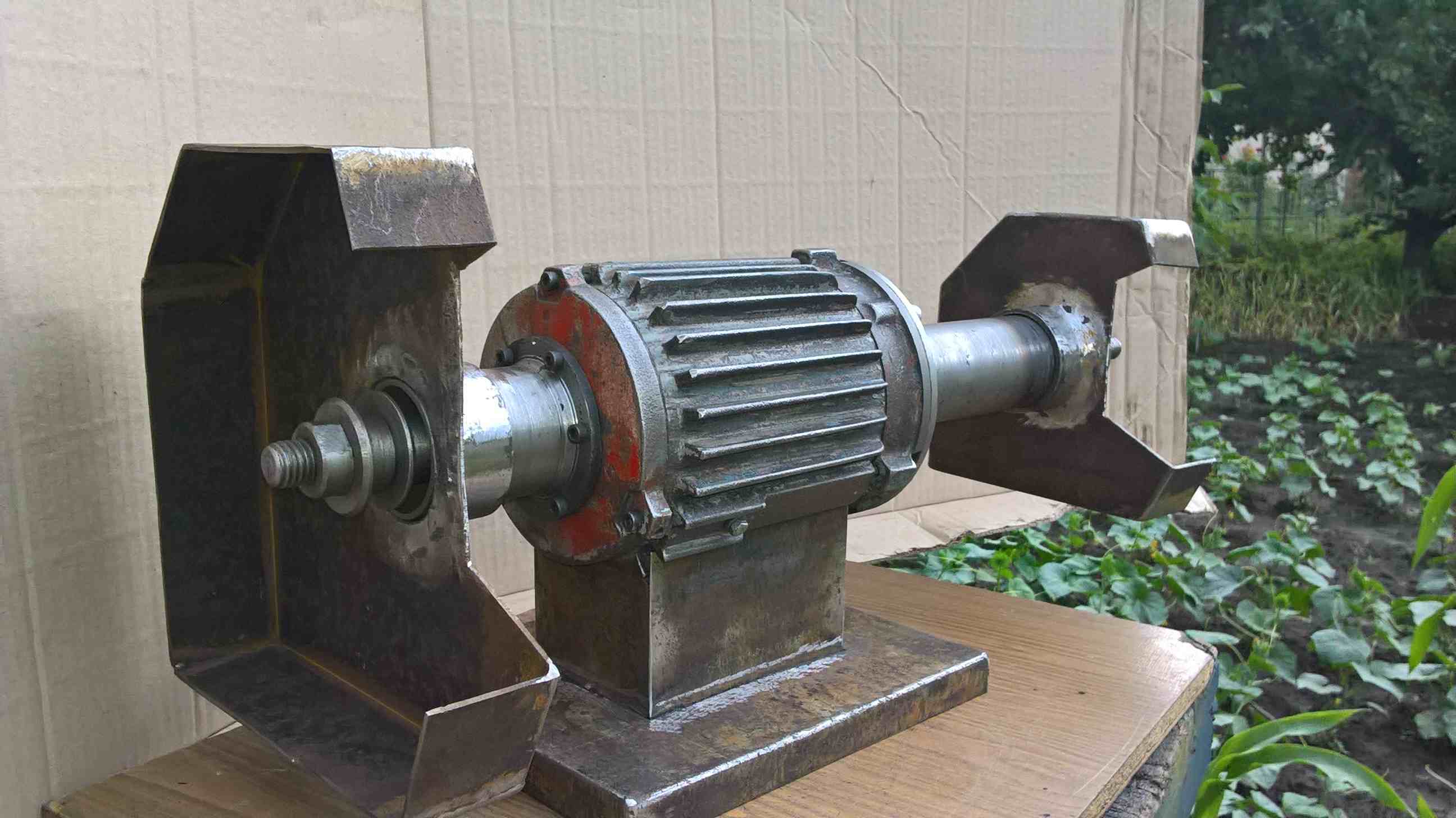

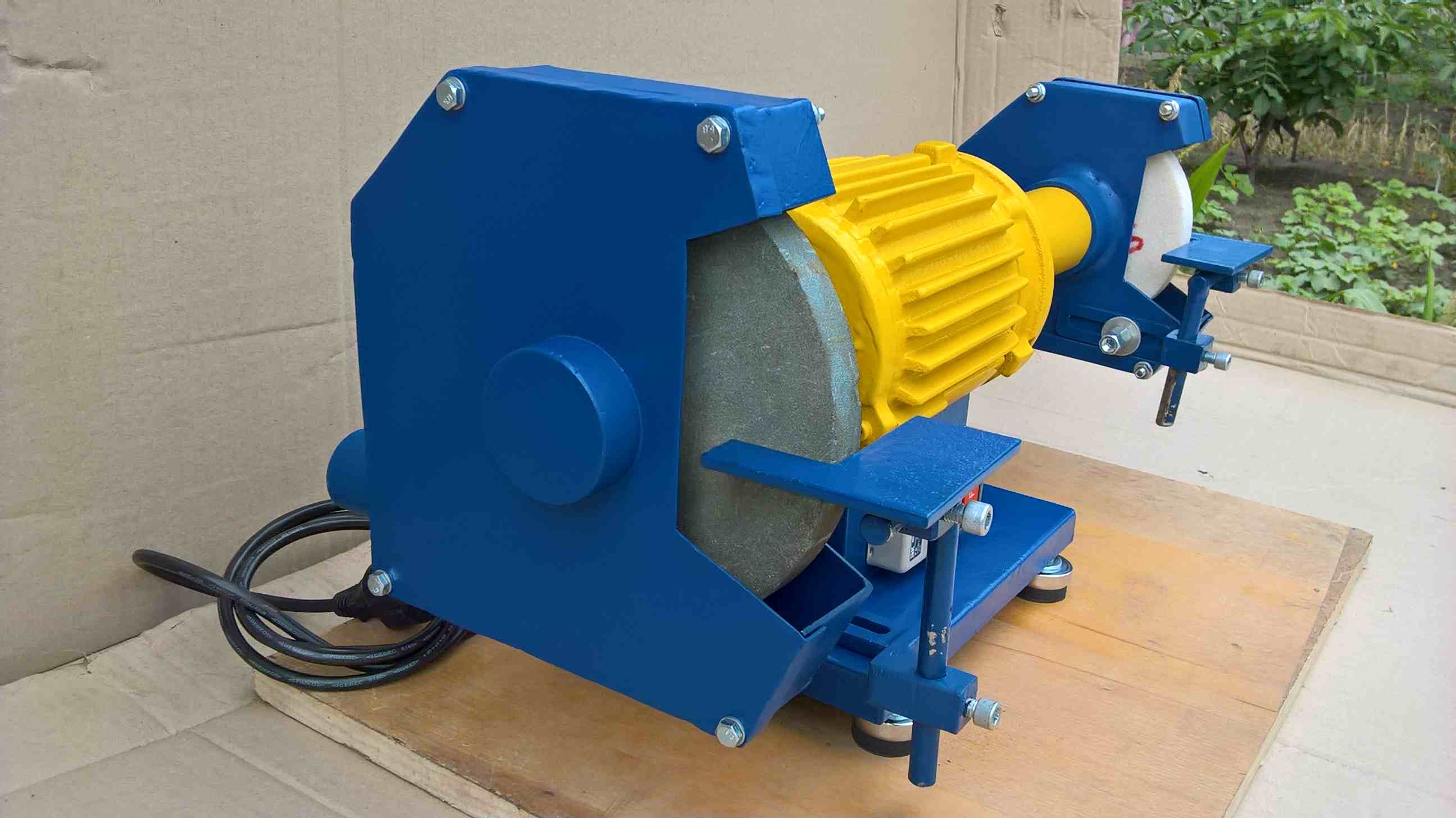

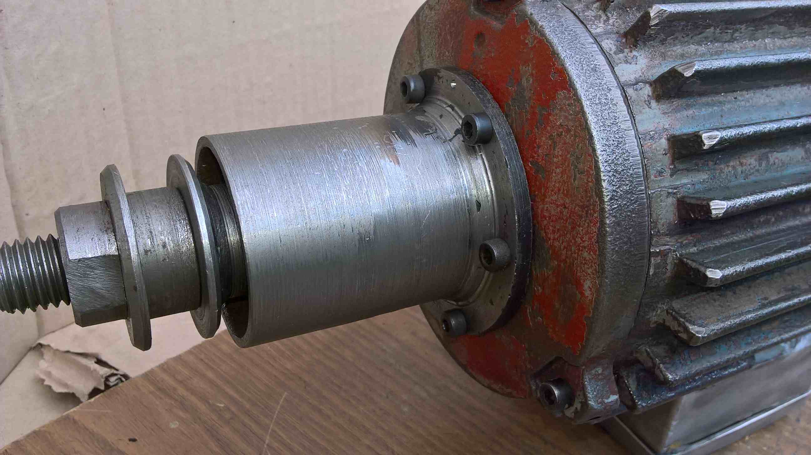

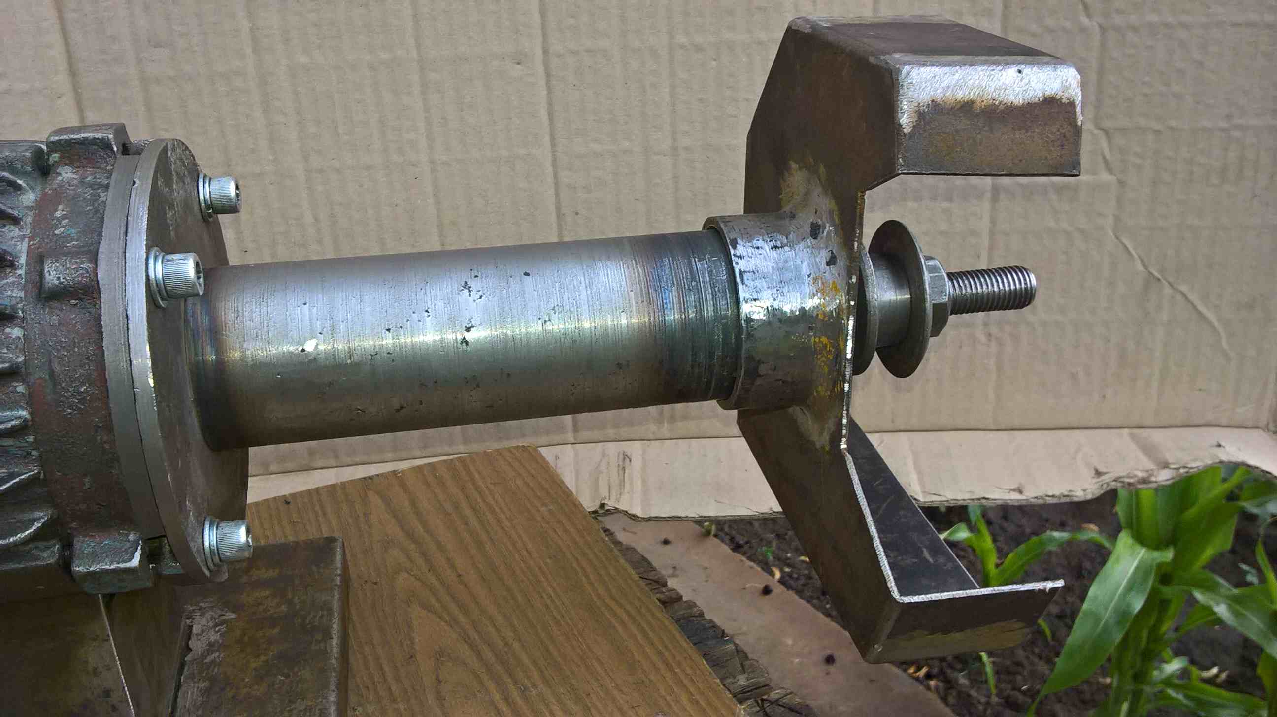

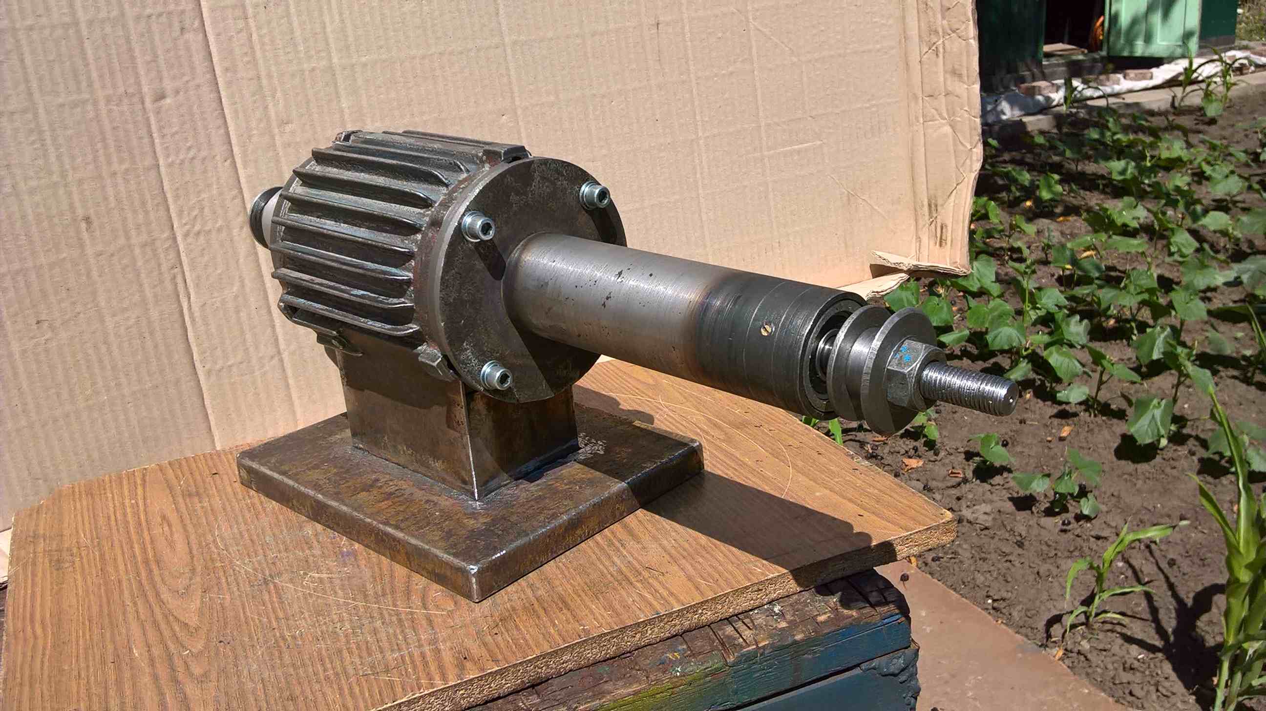

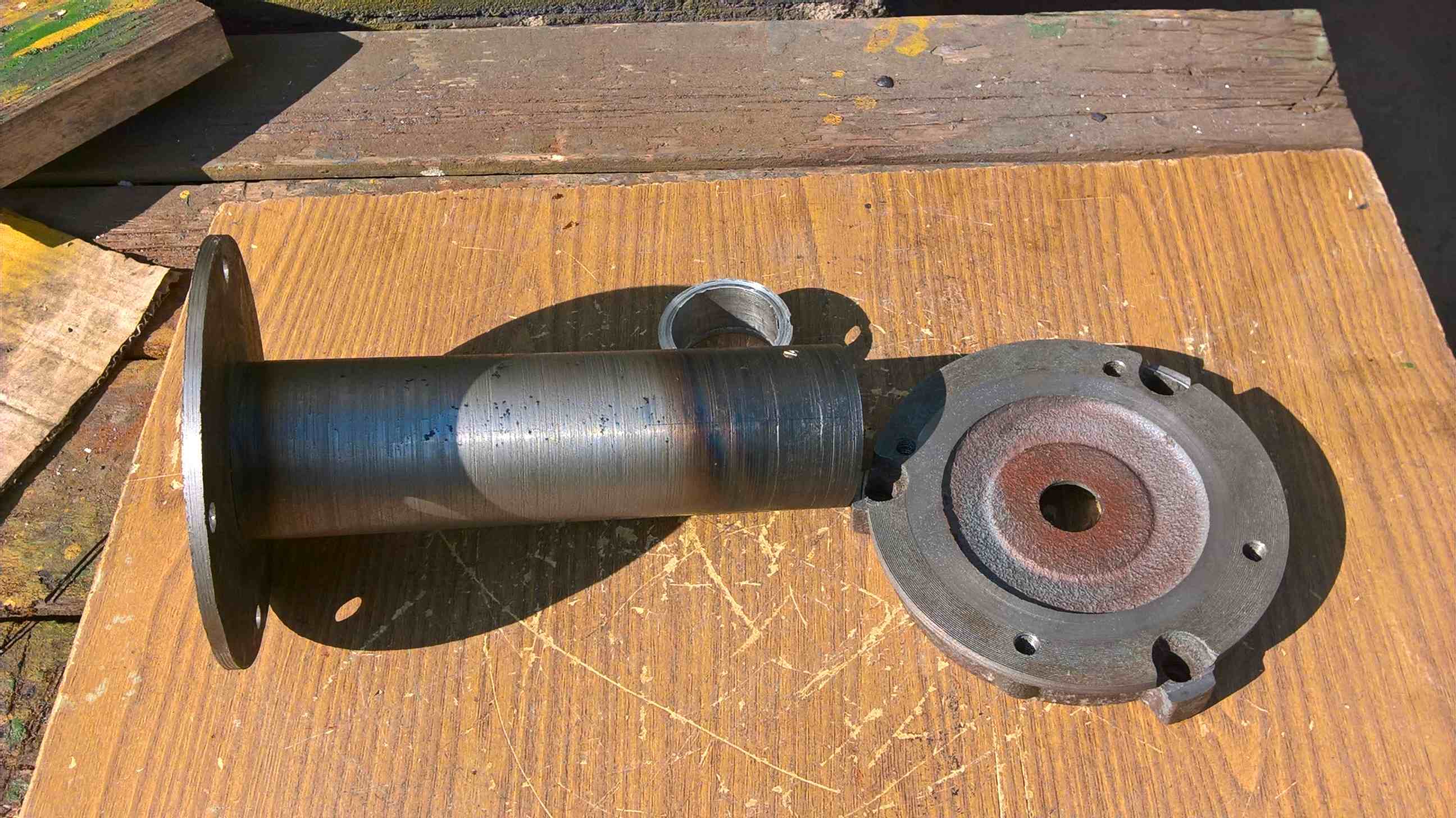

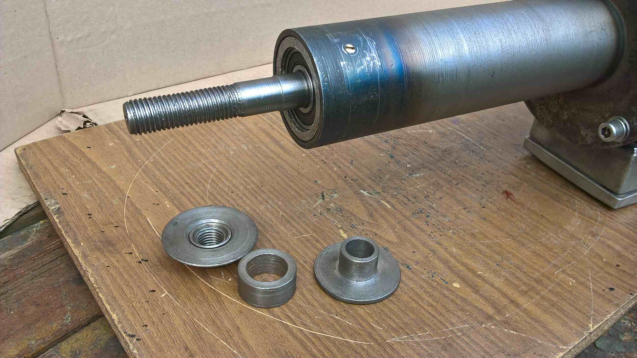

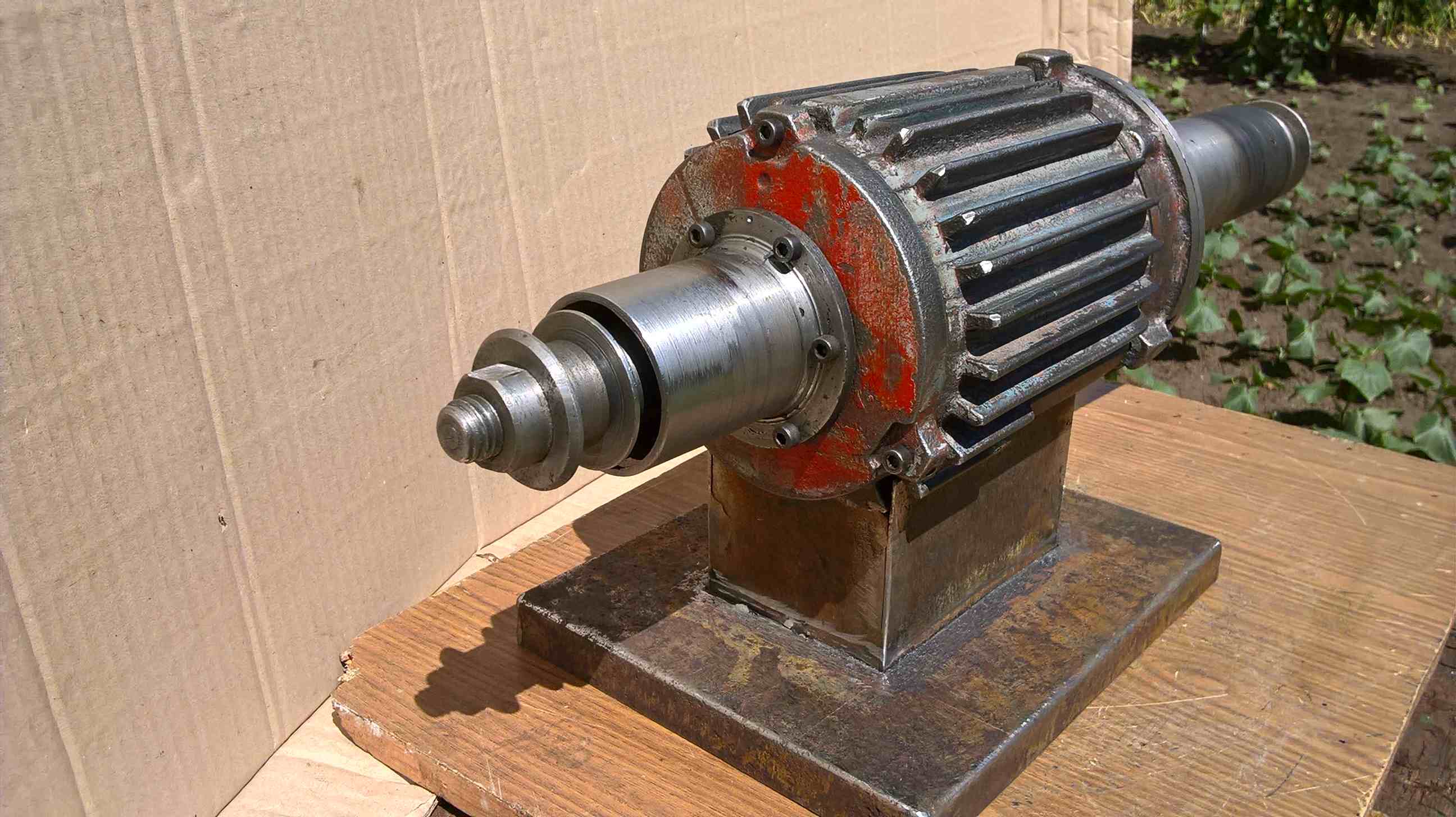

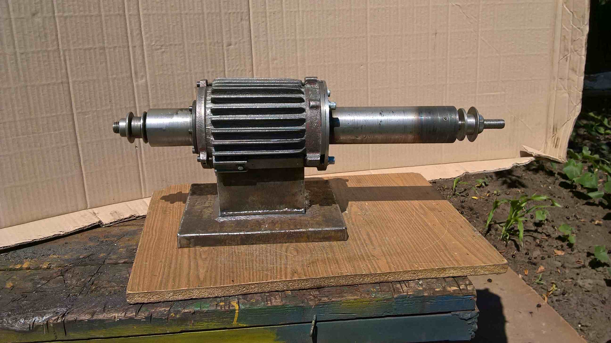

I began to do this.
Attachment 18664Attachment 18665Attachment 18666Attachment 18667Attachment 18668

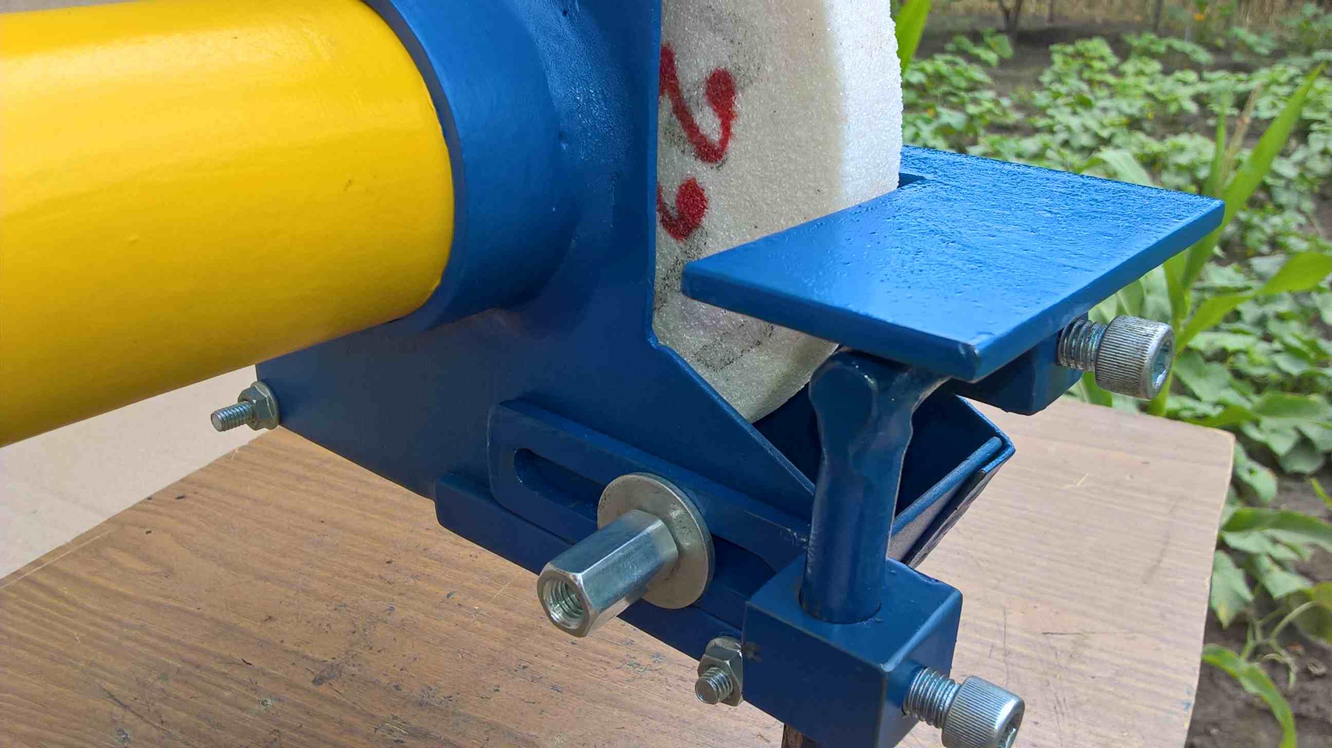

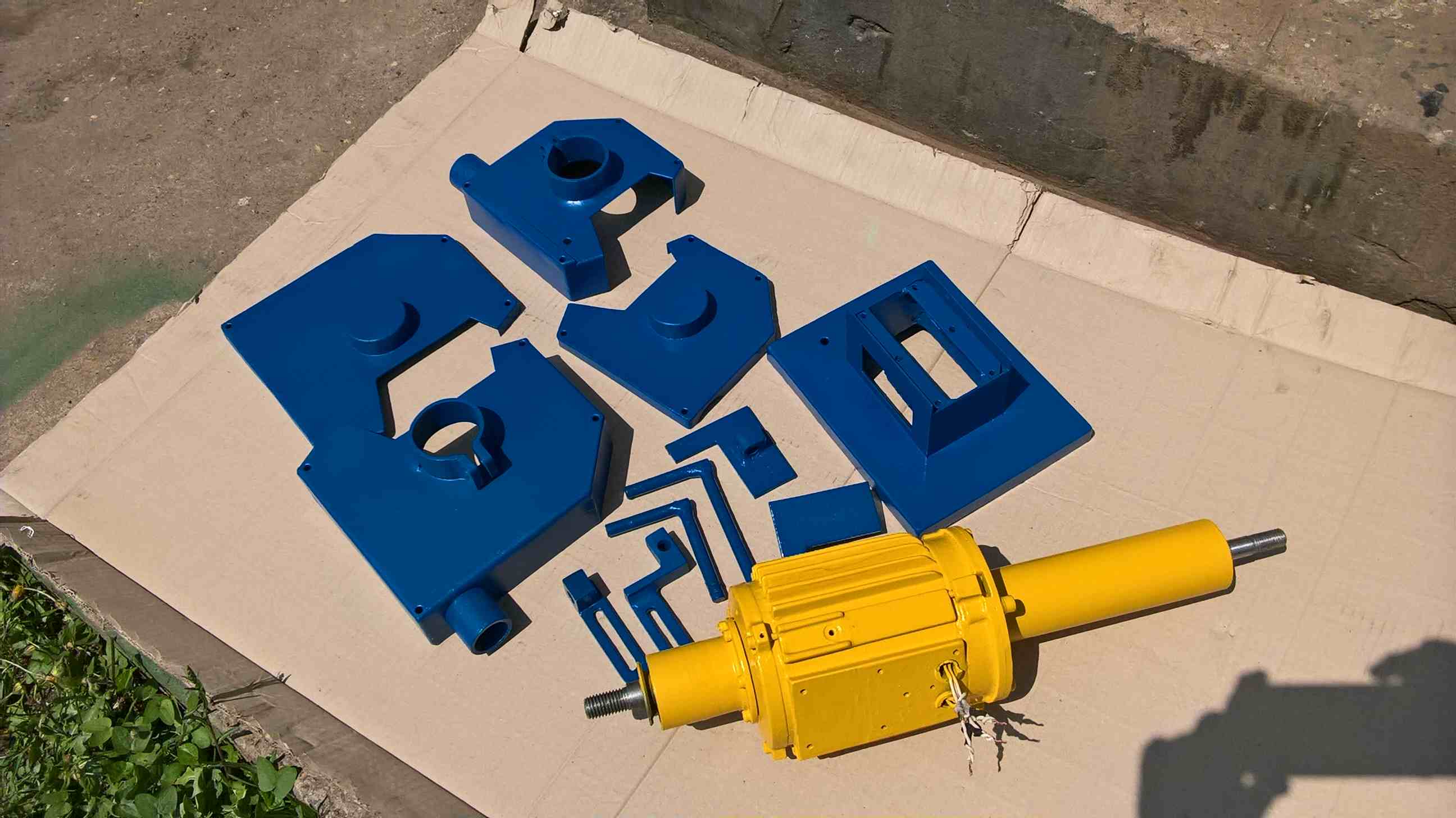

ComplementaryAttachment 18676Attachment 18677Attachment 18678
That motor case looks very strong. Is the electrical voltage 220 volts where you live? In the US we have 120 volts for most of our electrical needs and very little 220 volts for home use. It would be nice if our country went to an all 220 volts systems. When I was an industrial mechanic, I worked mainly on 220 volts and 440 three phase voltage. I prefer 220 volts.
I live in Ukraine in the city of Krivoi Rog.
We have a domestic voltage of 220 volts one phase.
In production in the industry, mainly 380 volts, three phases.

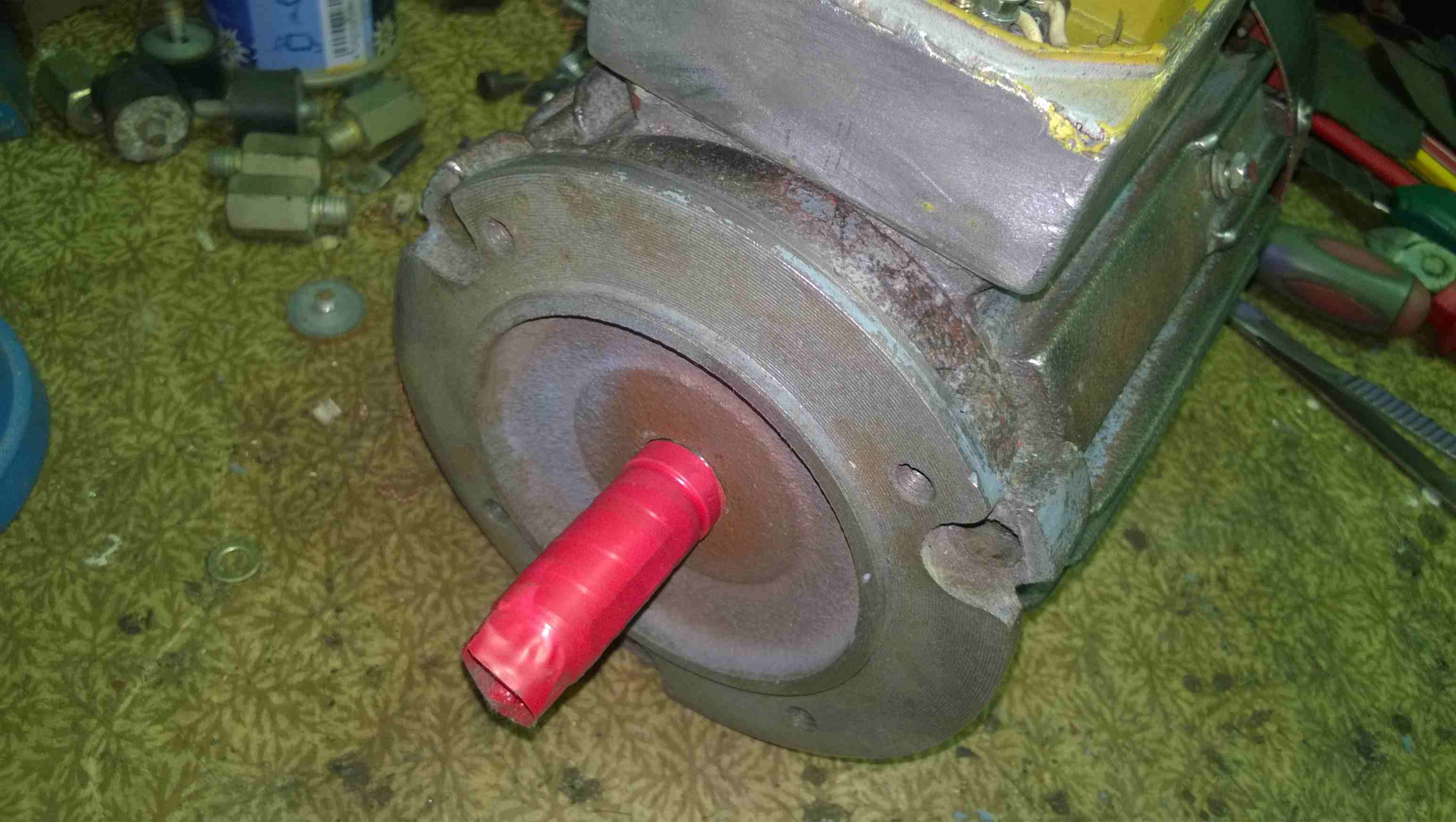

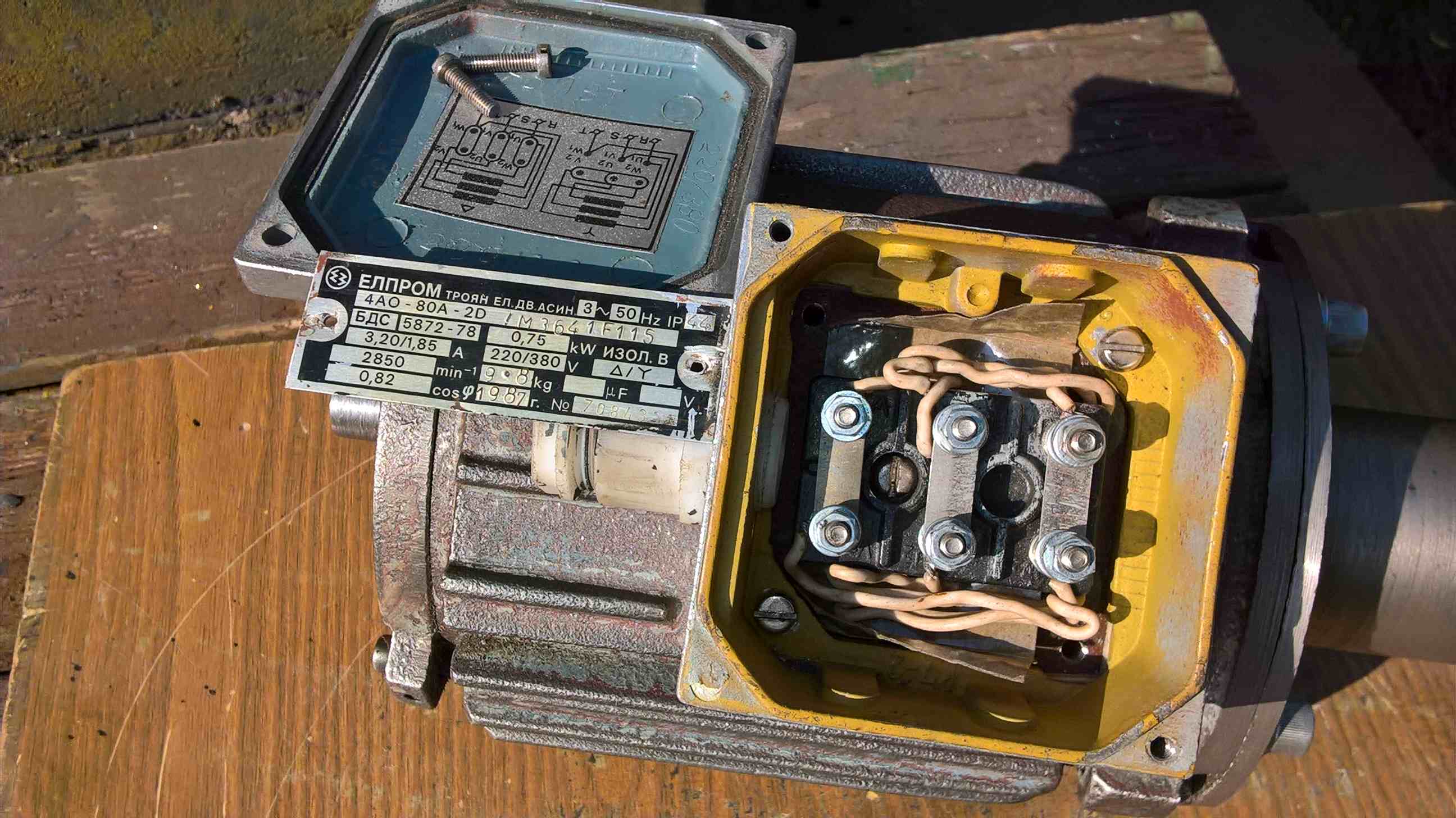

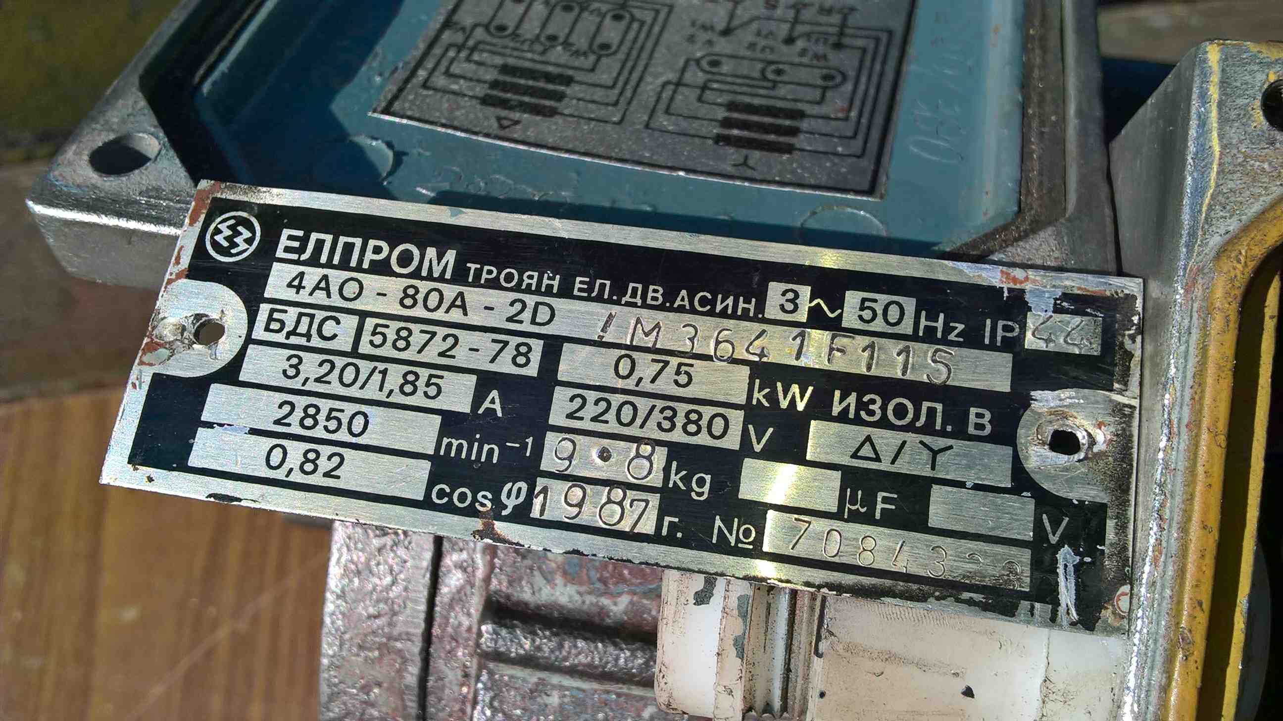

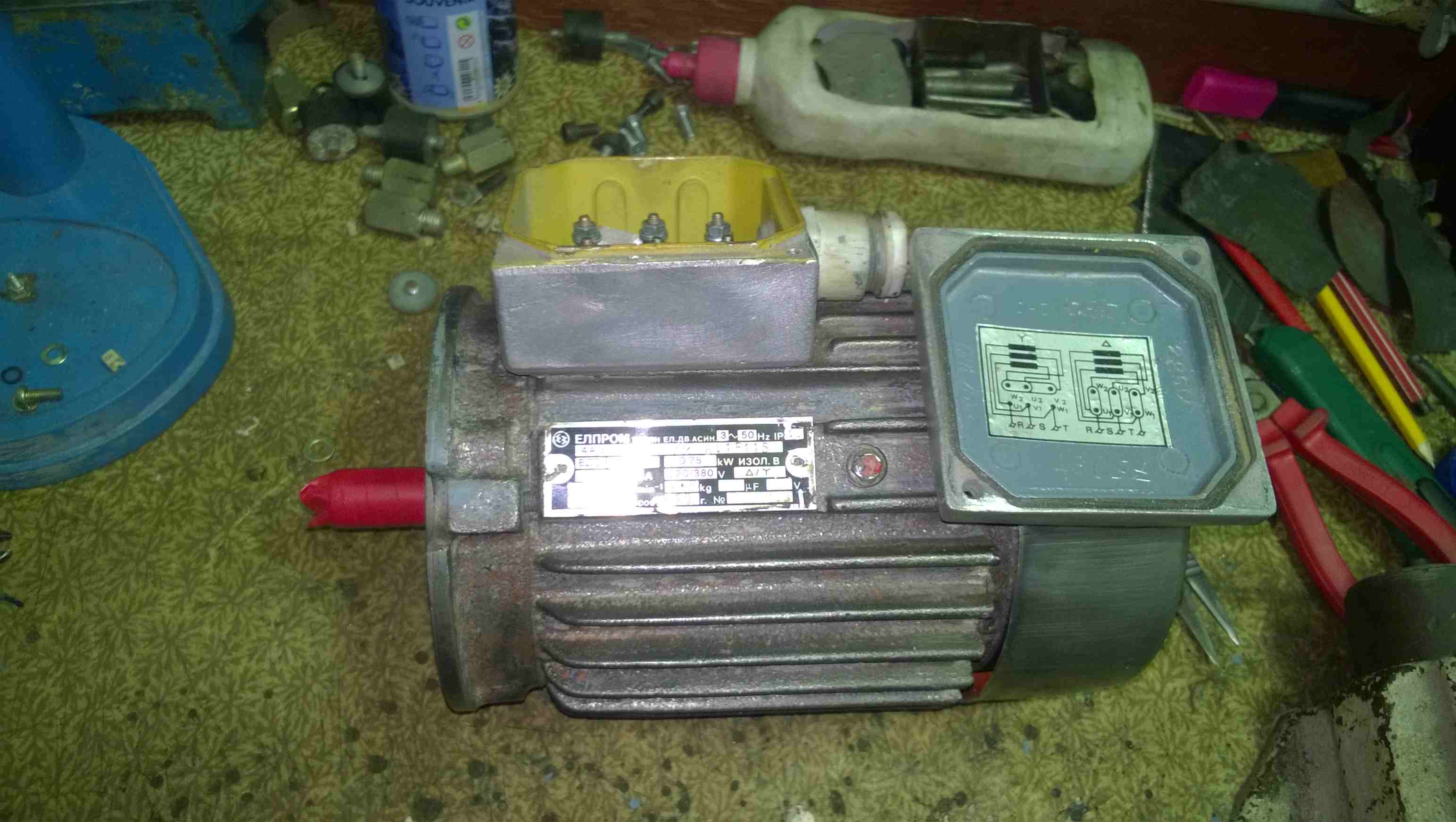

This is an industrial electric motor.
I will connect it to the 220 volts network at the bottom of the phase through the capacitor.
This electric motor.Attachment 18679Attachment 18680
Filmed a video about the machine.
https://www.youtube.com/watch?v=g0pMNhDkpoo
