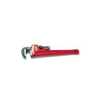

    I'm curious what GOOGLE thinks a "big MF pipe wrench" is. Around here (central NH, USA) the "F" part is an expletive and the "M" part stands for mother. It looks like this Improving hydraulic bottle jack-bigrigidpipewrencg.jpg only the handle is 48" long.
    Here's the WEB page. https://www.whitecap.com/shop/wc/p/r...iABEgICk_D_BwE
