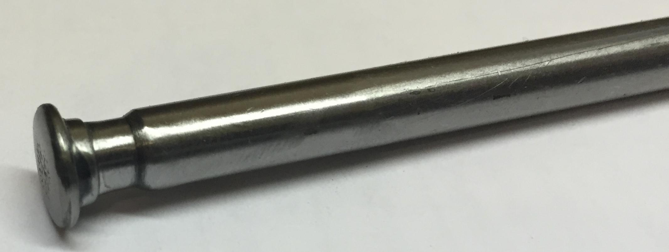

This video shows how to use friction to form a disk on the end of a rod.Attachment 2754

I love this trick Rick, thanks, will certainly find use for that, although my lathe cannot go as fast as yours ... maybe a little help with a torch ?

I've already used this trick to make blind threaded inserts. Article is out but have not submitted it to Homemadetools yet.

Nice idea with the forming method - certainly more regular finish than ordinary peening.

A word of caution. Touching the workpiece before the lathe stops turning can lead to some interesting cuts and wearing a ring is a real bad idea in a machine shop.
