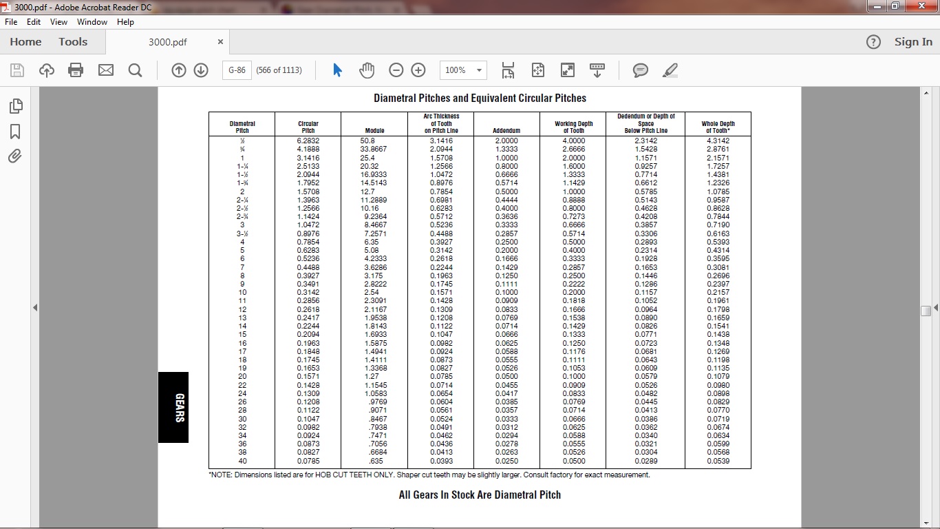

    To find what dimetrical pitch you have try this chart

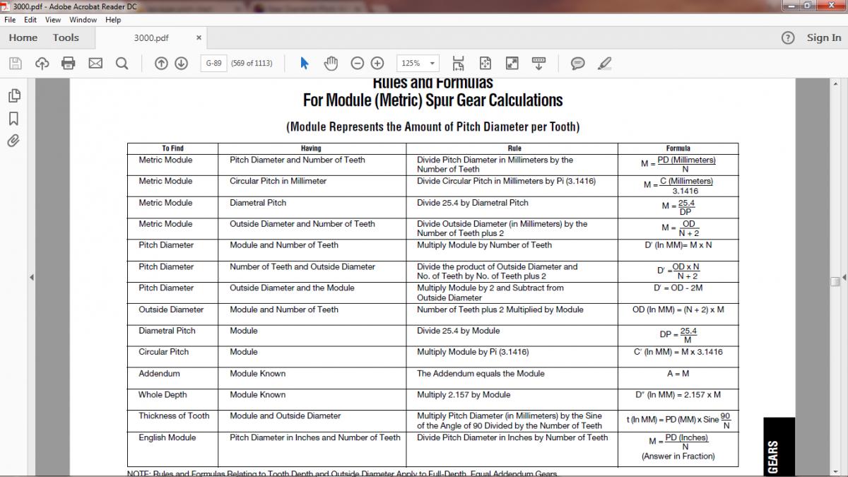

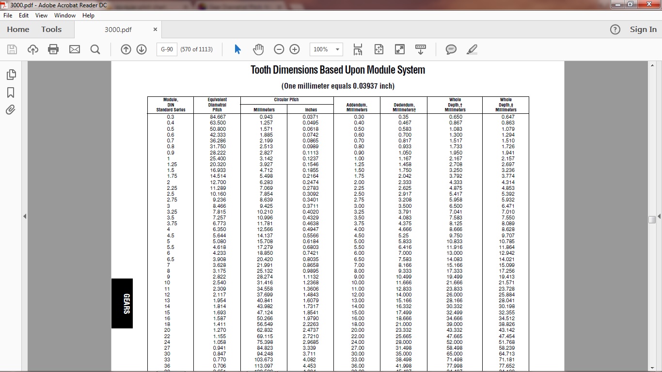

    some other useful charts

    the charts I posted were screen shots from the Martian Sprocket & gear catalog called the big catalog it can be found here free download but be warned it is 61,387 kb
    so it will take some time to download if you have a slow connection mine took about a minute but there are smaller target sections which can be downloaded on the same page these can be found here
