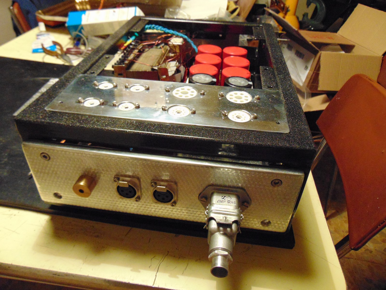

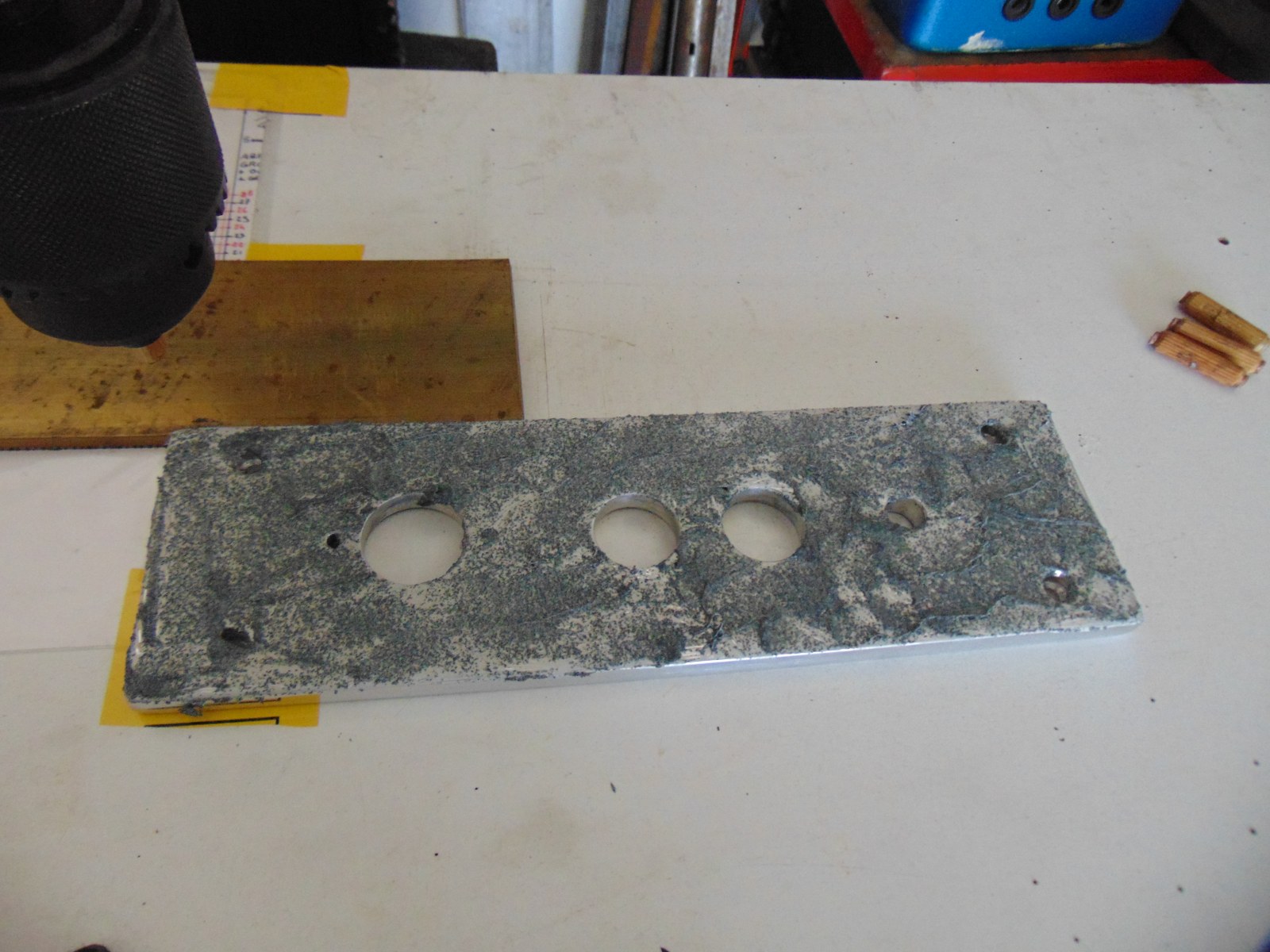

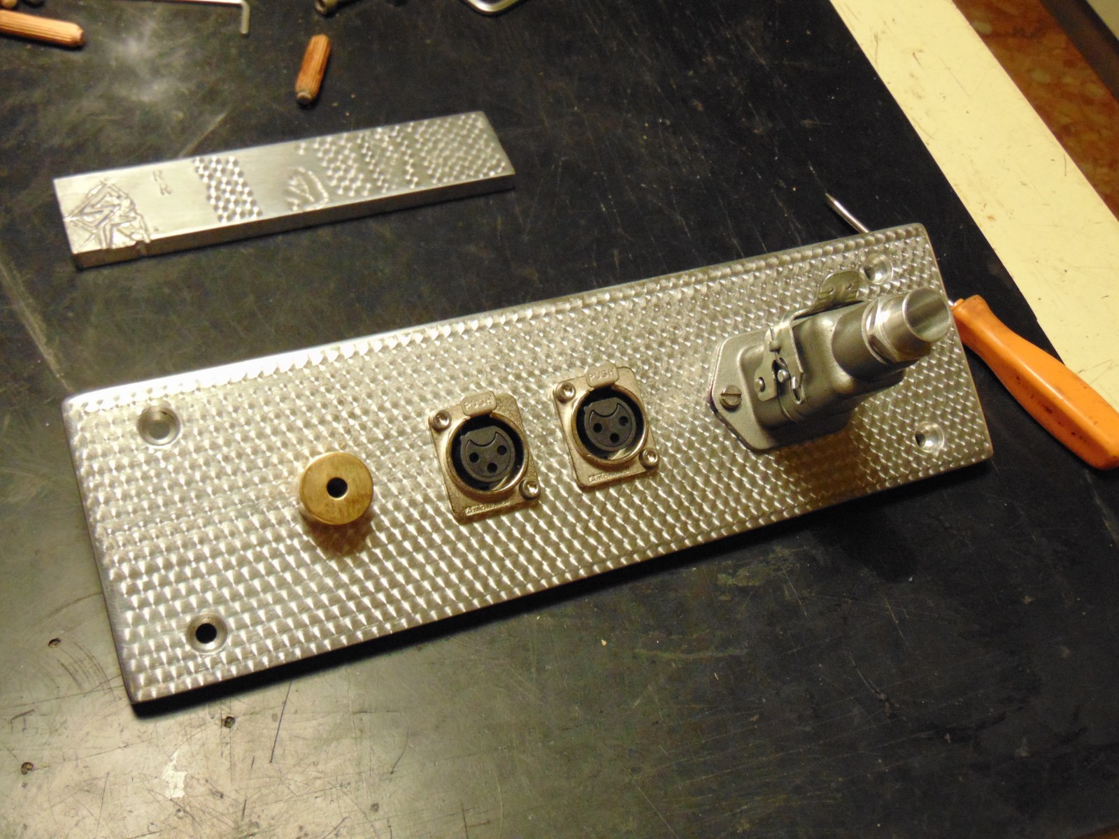

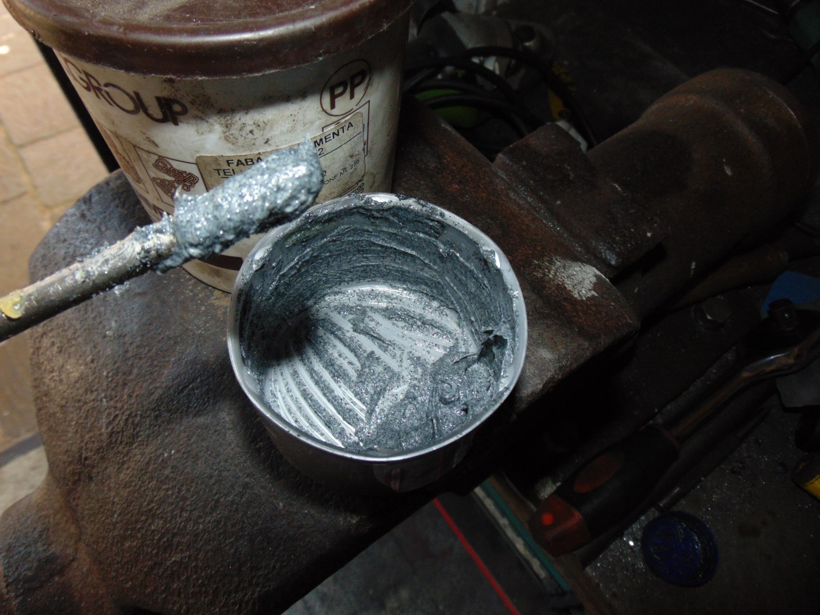

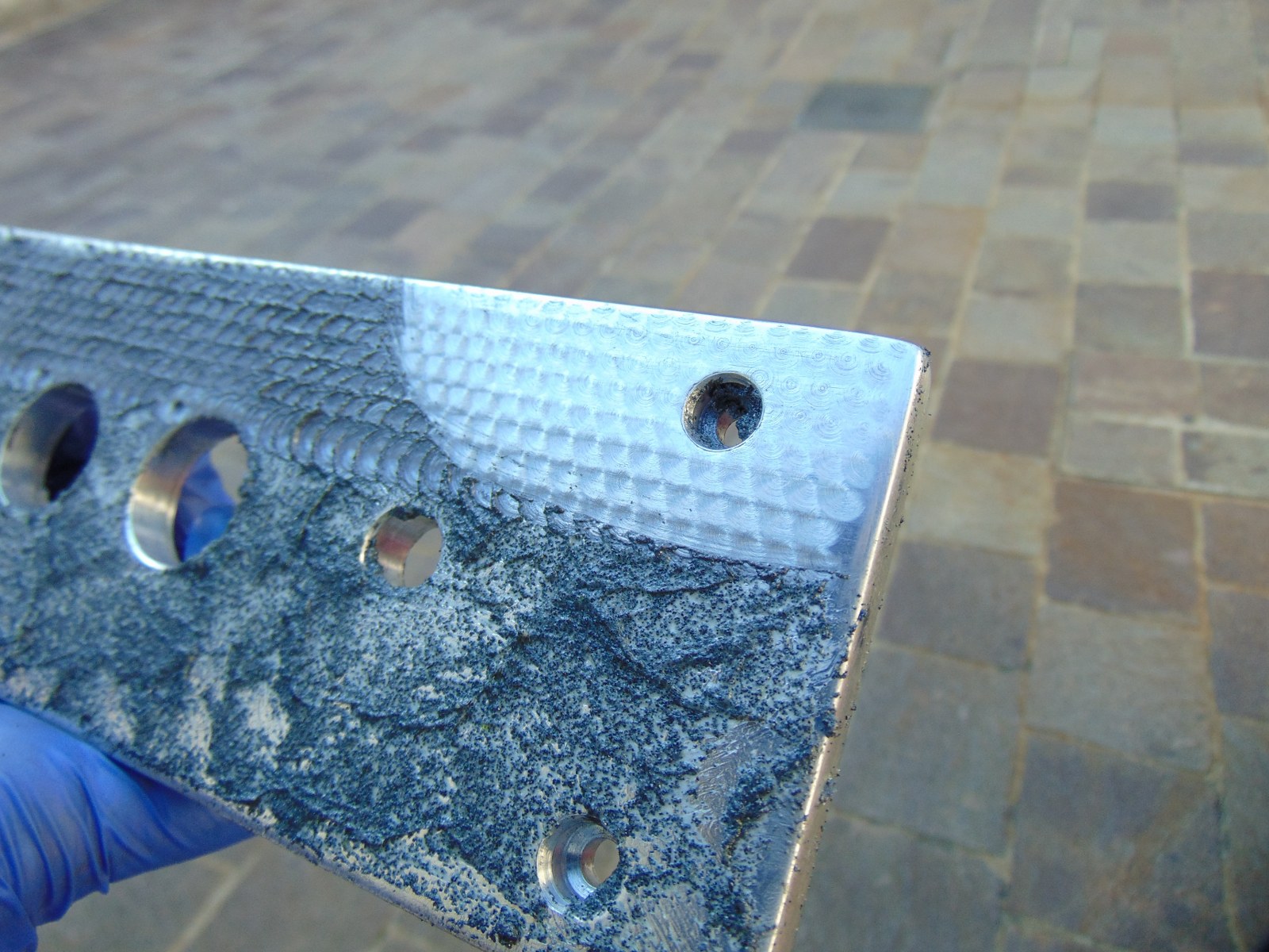

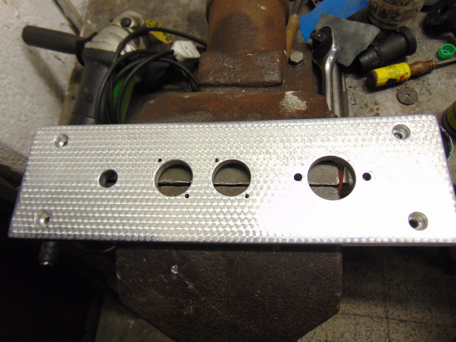

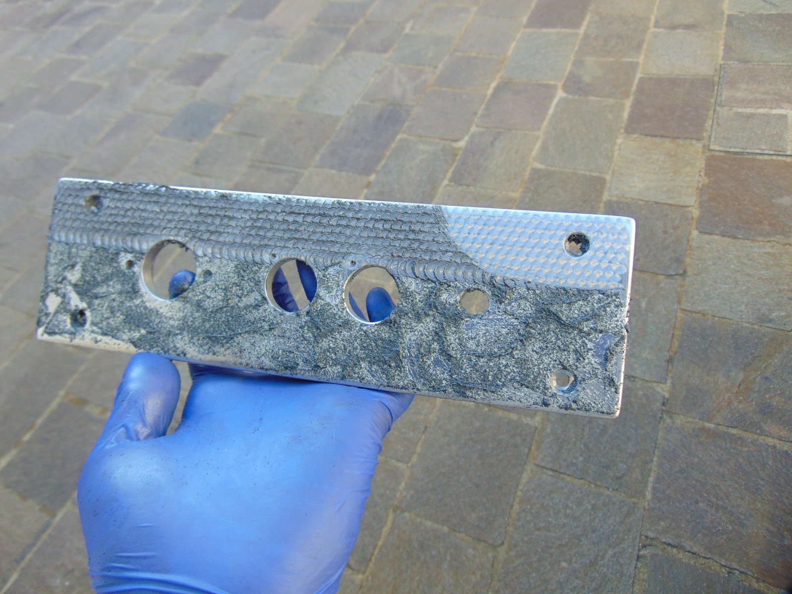

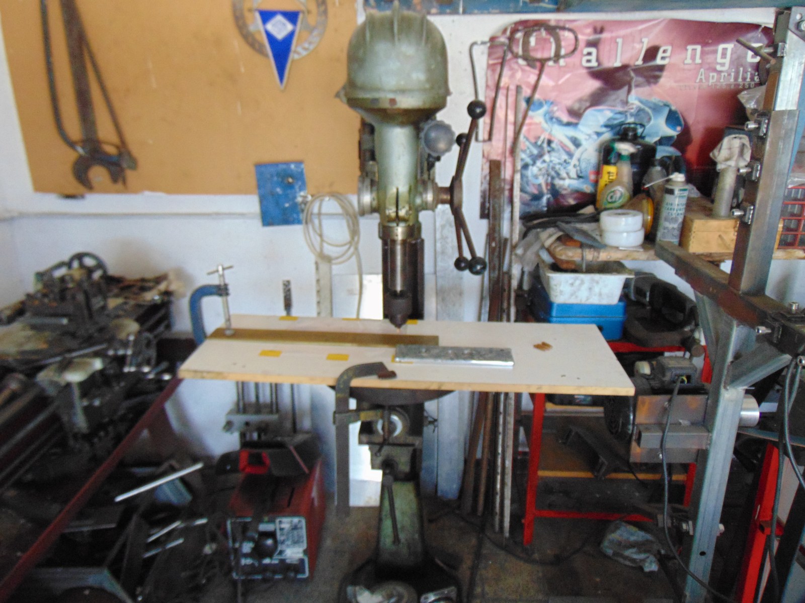

    I tried engine turning - jeweling, that's the front panel of my Esl headphone project. Not a perfect job, but good as first real attempt, not with small test plate.
    Unluckily leather pad glued to wooden rod disappeared, the wood did a nice job. Due to little experience in jeweling with the lack of a good tool, the circles are not all equal, plus I made some errors, it's hard to see the pattern under the emery paste without cleaning. Another difficult point is the square and large shape, it's easier to see errors, above all with more than 1K circles.
    I will trim and polish the edges, as scheduled.

    Rendoman I have a philosophy about slight imperfections which may occur when doing projects like this. First off your panel looks great to me from the pictures. Secondly any slight imperfections are proof that the panel was not purchased ready made. To me this makes it worth a lot more.

    Thank you cdakers!
    I'm thinking a good way to make the "right" tool, able to mark the metal every shot the same circle. In this little panel I made more or less 1150 dots, 3 seconds with light pressure, with a good layer of abrasive, maybe the wooden rod was too hard.
    I'm thinking about making another big plate (250x300mm soft alu) with wine cork, for sure softer than wooden dowel. This panel will be the top casing, useful to stand the headset when not used.
