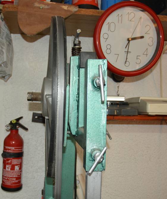

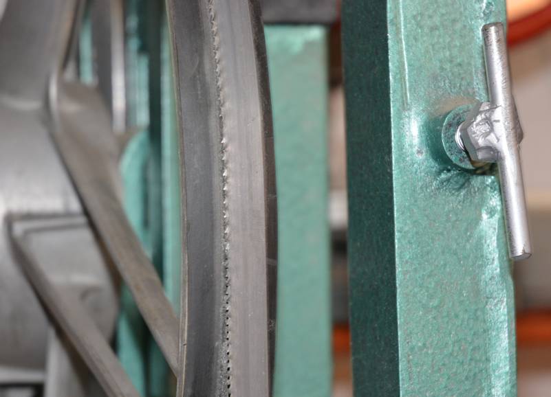

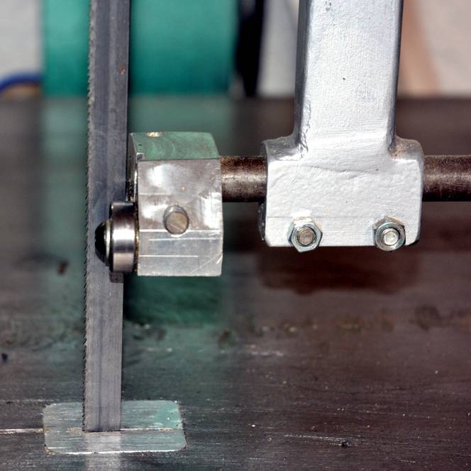

    On my own saw I only need the thrust guides to cut a dead straight line, I only have the side guides mounted toward the rear only for doing curves. The first two pix shows the blade position on the crowned wheel and the others show the side guides at the rear.
    Keep That Bandsaw Blade Tight!-blade01.jpg Keep That Bandsaw Blade Tight!-blade02.jpg Click images for full size.
    Keep That Bandsaw Blade Tight!-guide01.jpg Keep That Bandsaw Blade Tight!-guide02.jpg
    The preceding relies on the assumption that the blade is tensioned enough. If it is loose then, even with the tracking set as suggested, we lose that tight area about which the blade will twist and so we lose the well defined axis of twist. This can be checked simply by twisting the blade with your fingers at various tensions and also at the three tracking positions in the video.
    So Rick, getting back to your observations. A horizontal saw has to have wide guides to maintain an accurate and well supported blade twist. However it is the length of the blade between the guides that is relavent to the cutting stability. For best performance you still need the area with greatest tension to be just behind (above) the teeth. It could be possible that the twist in the blade changes the tension distribution across the blade and so in any particular machine you may need to alter the tracking from simply setting the front over the crown. Only testing can determine that. Twisting the blade with fingers is a very good guide as to which part of the blade is tightest.
    As mentioned above you lose a lot of the directional stability with a slack blade.
