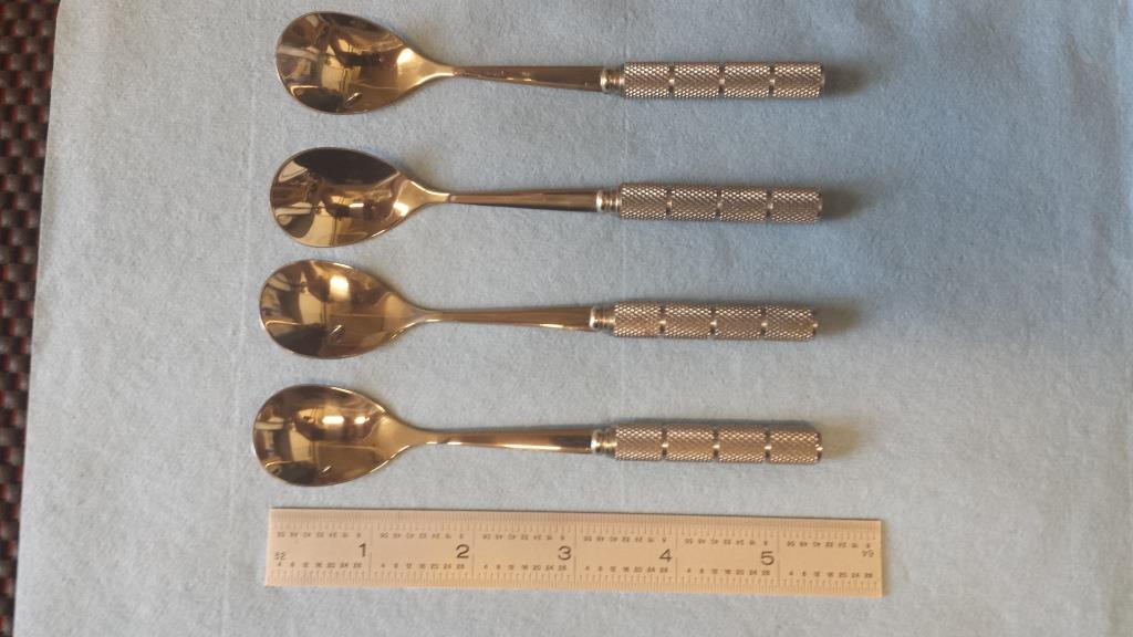

    This is another part of my "Kitchen Tool" series for small stainless steel tools I made for my wife and friends.
    The following photos include all new stainless handles for demitasse spoons. The smaller-sized spoon is smaller than a teaspoon and is traditionally used for coffee drinks. I made a series of 12 handles for the spoons using 3/8" diameter 303 stainless steel rod. The 3/8" diameter stainless steel rods were reduced to 0.364 diameter before knurling the 21 pitch knurl (by the way I used the Android app Kurling Calculator to calculate the pre-knurling diameter). The 0.052" grooves were machined with a right-hand Nikcole Mini-systems tool holder and carbide inserts. Also, AR Warner makes T15 inserts for this tool holder and I have used these with success.
    Kitchen Tools - Stainless Steel Handles for Coffee Demitasse Spoons-group-stainless-steel-coffee-demitasse-spoons-ready-using.jpg

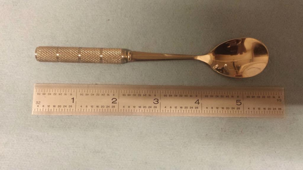

    Dimensions for spoons
    Kitchen Tools - Stainless Steel Handles for Coffee Demitasse Spoons-dimensions-stainless-steel-coffee-demitasse-spoons.jpg

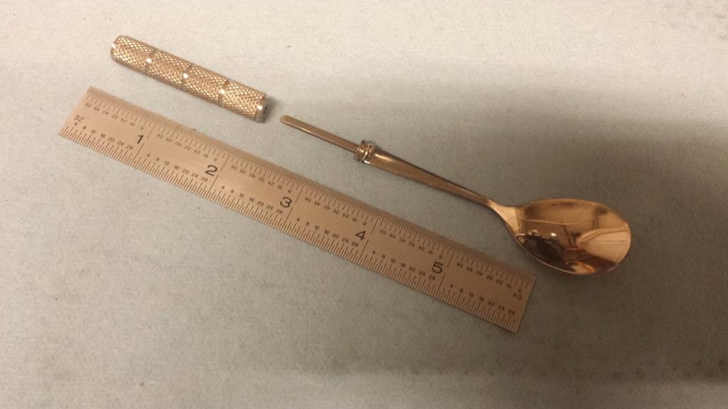

    Parts to Spoons
    Kitchen Tools - Stainless Steel Handles for Coffee Demitasse Spoons-parts-stainless-steel-coffee-demitasse-spoons.jpg

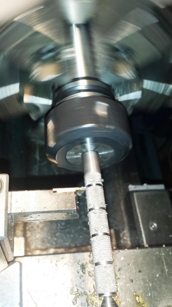

    Kurling the 21 pitch into the 0.364 diameter 303 stainless steel rods
    Kitchen Tools - Stainless Steel Handles for Coffee Demitasse Spoons-placing-21-knurl-pitch-stainless-steel-demitasse-spoon-handles.jpg

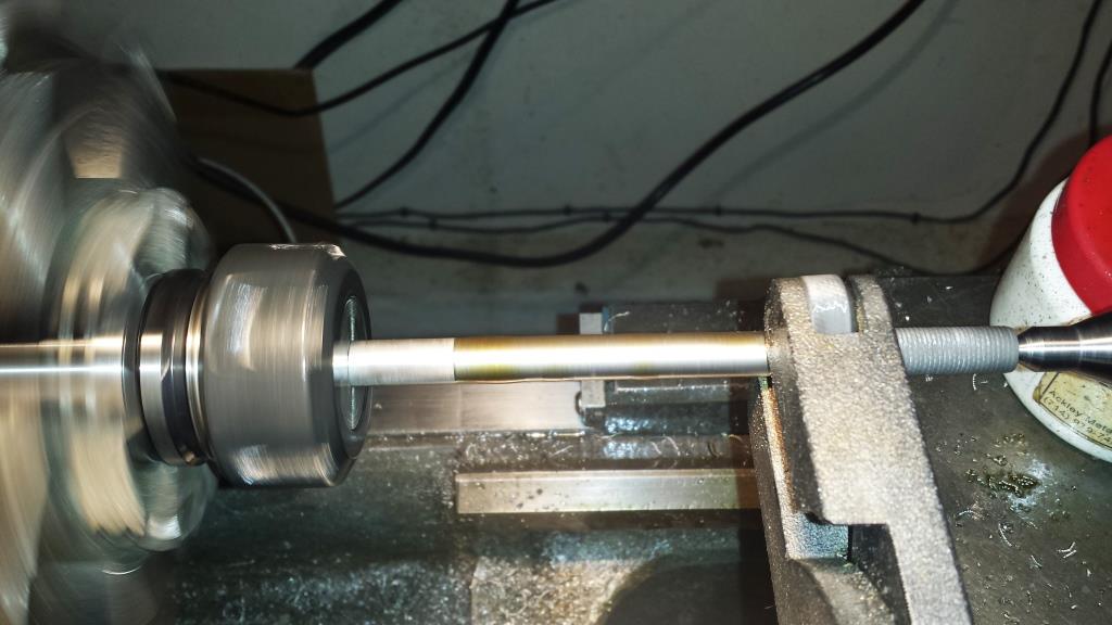

    Machining 0.052" wide grooves into the stainless steel handles
    Kitchen Tools - Stainless Steel Handles for Coffee Demitasse Spoons-machining-0.052-inch-grooves-303-stainless-steel-handles.jpg
