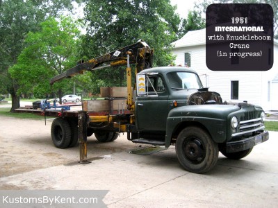

    Knuckle boom crane onto 1951 Int'l Truck
    Knuckle boom crane onto 1951 Int'l Truck-1951-international-truck-knuckleboom-crane-v2-e1402565599171.jpg
    Knuckle Boom Crane |
    Here's a knuckle boom crane that I grafted onto a 1951 Int'l truck. I slid the flat bed back to make room, strengthened the frame, and revised the hydraulics to have enough volume to operate the crane.
    It came in real handy when I lifted my "new to me" lathe off of the shipper's trailer.

    Well thought and executed Kent. How much did the crane/materials set you back?

    I spent $2500 for the crane, $500 for shipping, and then around $500 in misc parts.... maybe more, maybe less, I didn't track those parts very well.
    I already had the truck, so this just makes the truck more useful.
    Seeing it work after all that hard work was priceless!
