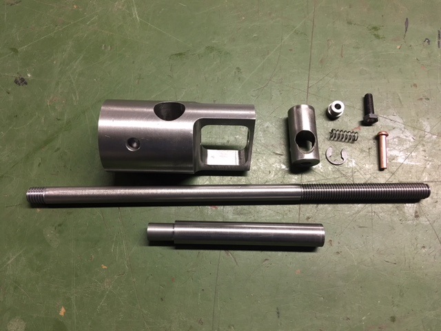

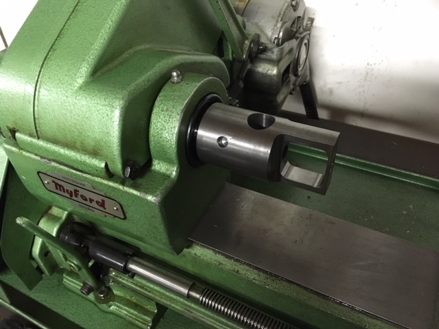

Hi JR
Started the lantern build this afternoon it is coming along and hope to have it finished by the end of next the week. I have ordered an Aluminium hand wheel which I hope will be delivered Wednesday, this week so I can get it finished. The quick release design seems to work so far. Thank you again for posting your chuck design it has been very useful in my build.
The Home Engineer
Here is a photo of the chuck so far.
Attachment 21495Attachment 21496
Very good. I think I see how the quick change will work. Great idea.
I like your Myford...Nice sturdy lathe.

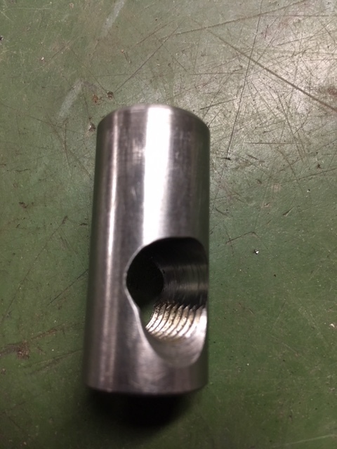

Hi JR
All bits are now made, just waiting on the aluminium machine handle to come in the post. Once here can fit and test to see if it works as I want it too. Will do a full post when completed.
Attachment 21509
