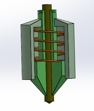

    A project I wish I had never started led to the need to transfer the location of a 22 mm hole. My usual transfer punches only go to 1/2" and my expanding punches (top in picture below) don't go much farther. The commercial spring-loaded one-size-fits-many only goes to about 3/4".
    Then I remembered the hole-centering-aid I described earlier here...
    http://www.homemadetools.net/forum/h...6216#post35510
    The largest of these goes to 1". Pop it in a collet, drill and ream for a close sliding fit for the one-size-fits-many punch and Robert's your mother's brother.
    The new hole wiped out the center but that was quickly restored with a slightly larger center drill. Now the tool serves two purposes-a goal for which I always strive when making tools.

    I no longer have any pictures or the tool but your adjustable transfer punch looks alot like the drawing I have of one that I made
    It worked on holes from .5" through 1.75" as long as the material was thick enough
    a snap ring not shown held the adjustable punch in the squaring shell
    just hold the outer shell to the work piece to make the punch perpendicular to the part and strike the center punch

    Functionally, they look to be identical although my commercial one is much smaller than yours.
