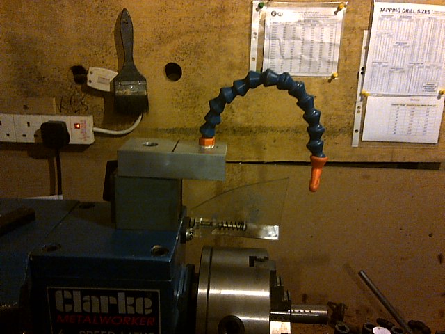

below is coolant supply unit i made for my lathe.
its made from 25x50x100mm block of ally drilled and tapped one end 1/4bsp and other end is drilled and counter sunk for m8 caphead allowing it to be fitted to spare on/off magnetic block i had.Attachment 718
