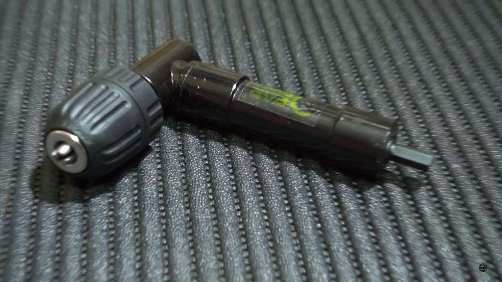

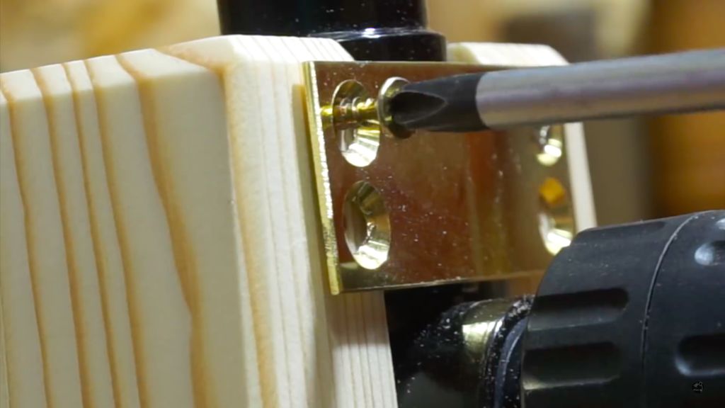

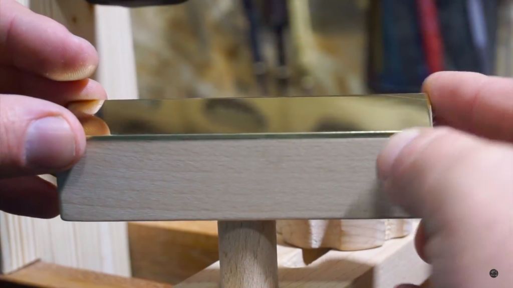

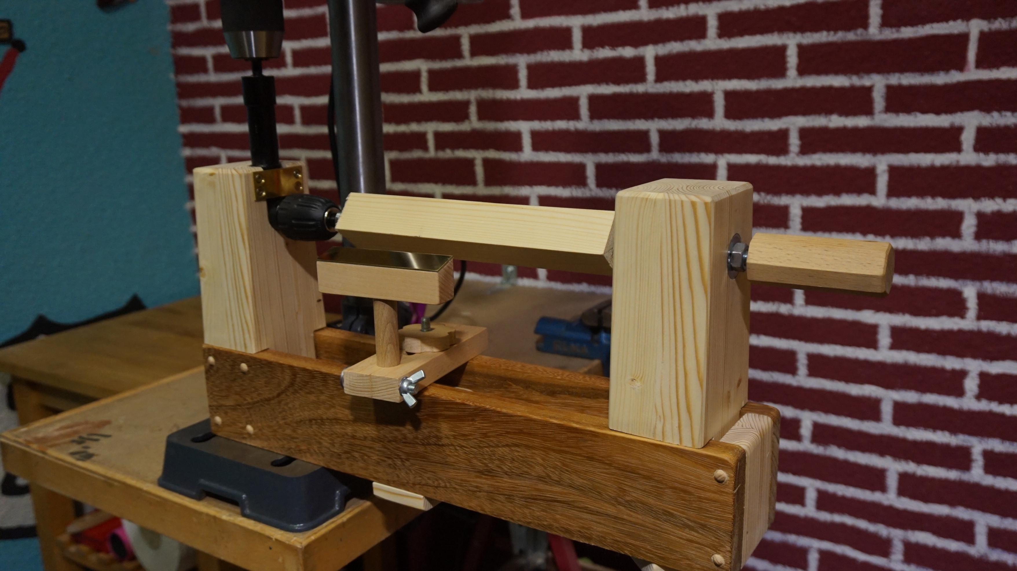

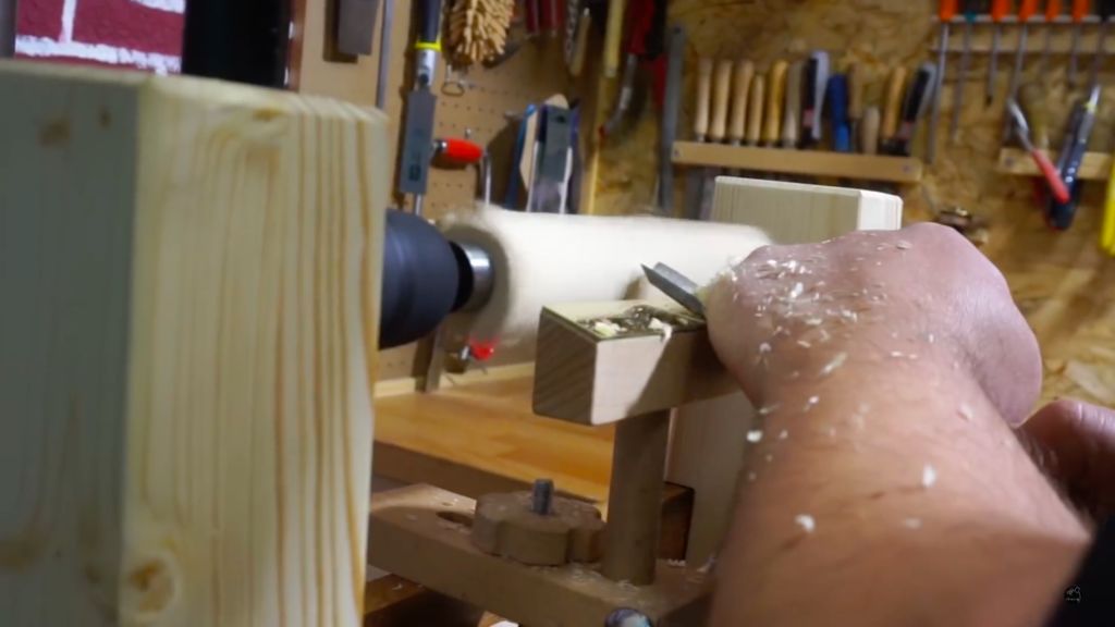

    I always wanted to have a lathe for wood but I don't have much space in my workshop, so I decided to build one myself using my drill press. For this, I used an angle drill adapter and after many tests I saw that the result could be good.
    The benefit of the angle drill adapter would be the absence of lateral stress on the drill press bearings.
    If you like the video please Subscribe to my Youtube Channel.
    In this video I show you the step by step

    Inventive and resourceful, not sure how long the angle drive will last but they are cheap enough.
    Very nicely made as is all your work.

    Thanks for the comment Olderan!! I will try to use it with soft woods
