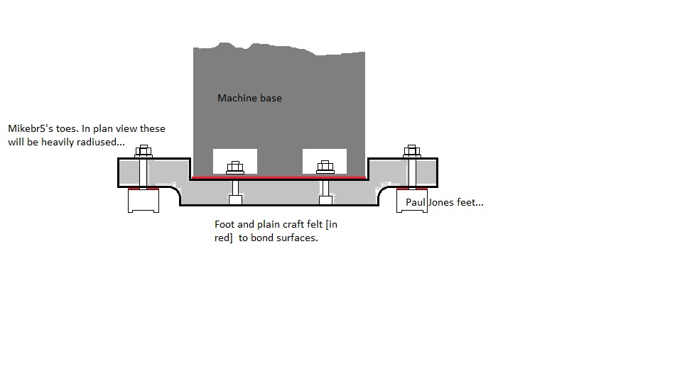

Extending the feet on a lathe would work if a 'bond' was made between prescribed feet to added material. Like Mikebr5 I'd hate that impediment on the floor.
Seems I'll edit into this post when ideas pop up.
One will be a foot bolted to the original holes, 3x or 4x thickness of existing cast area. It is long enough to move pads outboard of footprint including wrench clearance to casting. The underside is cut away for the pads to function with out jacking up lathe higher and higher.
Drawing is jpeg, click it for increased size.

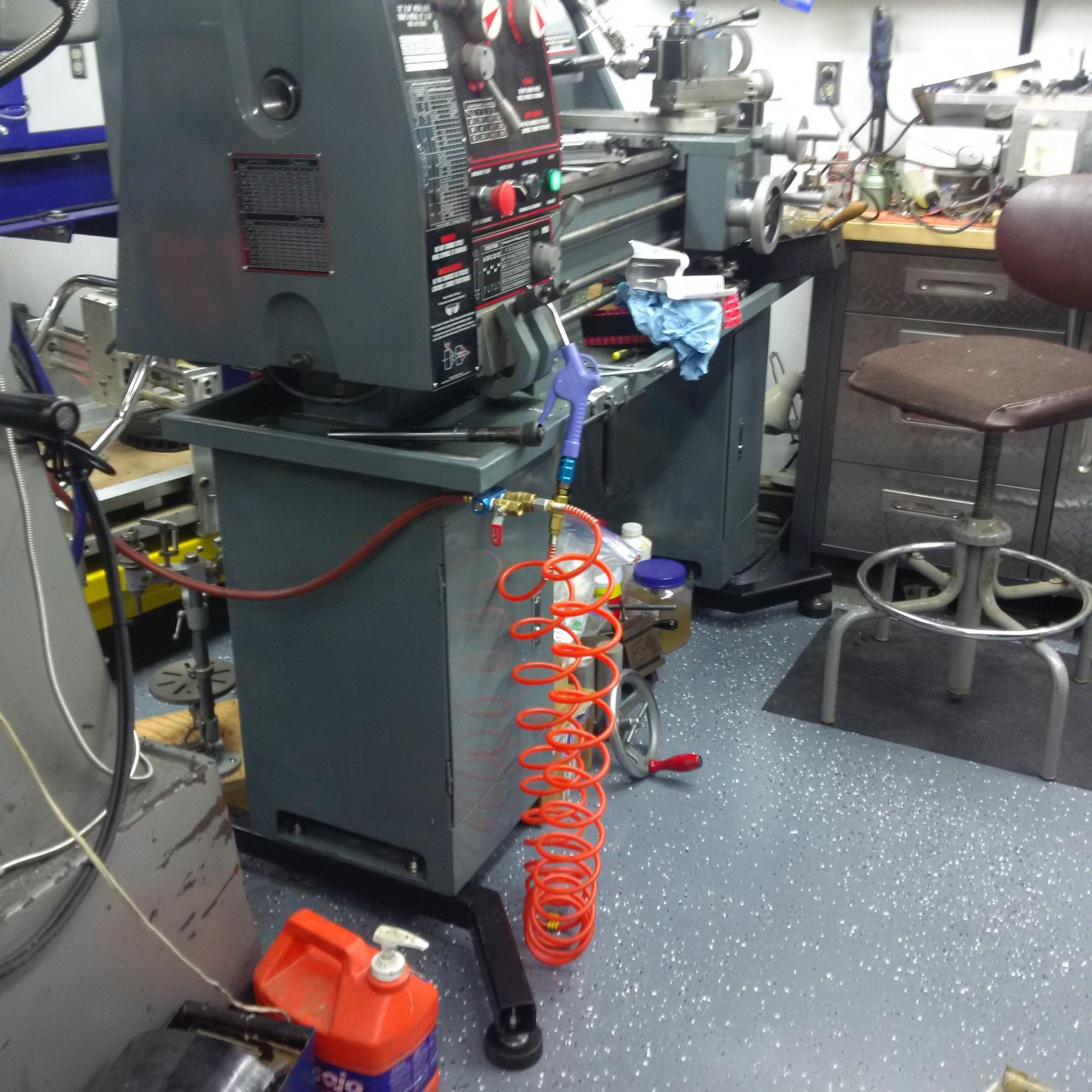

Nice job on the feet and I originally did something similar on my own 12x36 lathe however I found the lathe was far too tippy on such a narrow footprint as offered by this cabinet and ended up adding outriggers to increase the footprint and make it dramatically more stable.

Truth be told I bought a cabinet with these stabilizing legs attached and it was a simple matter to drill 4 new mounting holes and bolt them up to the lathe. I often use handcrank to do short threads up to a shoulder and if you got carried away it was easy to rock the top heavy lathe on the small footprint. On these outriggers it is rock steady. Had I made them from scratch I would have just done straight 2"" tubing. The increase in height was also a bonus!
