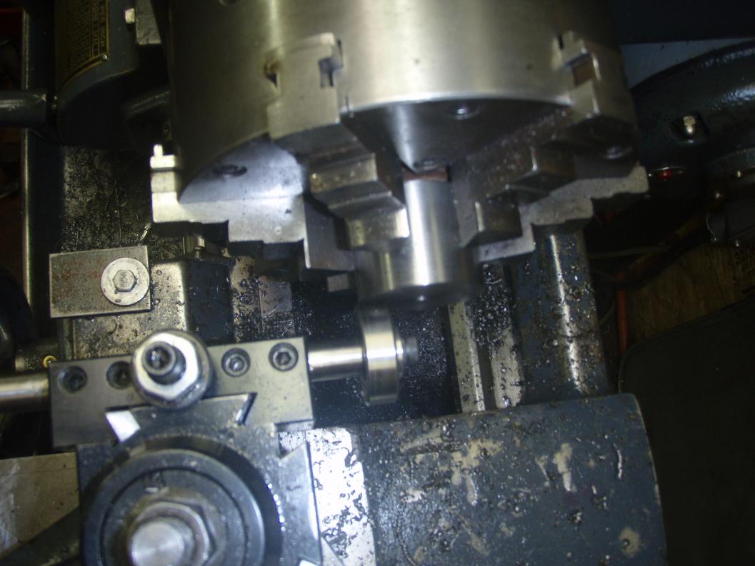

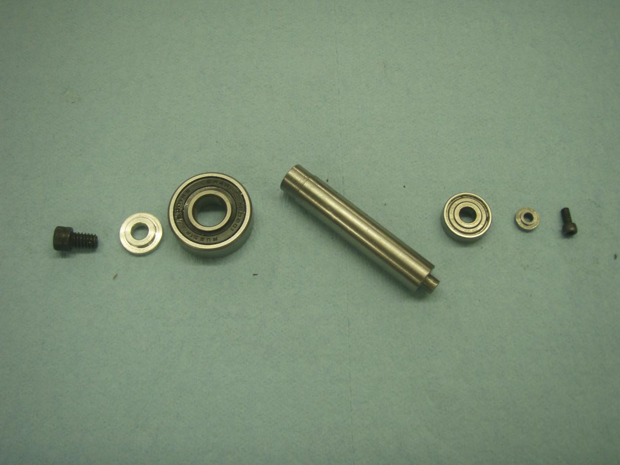

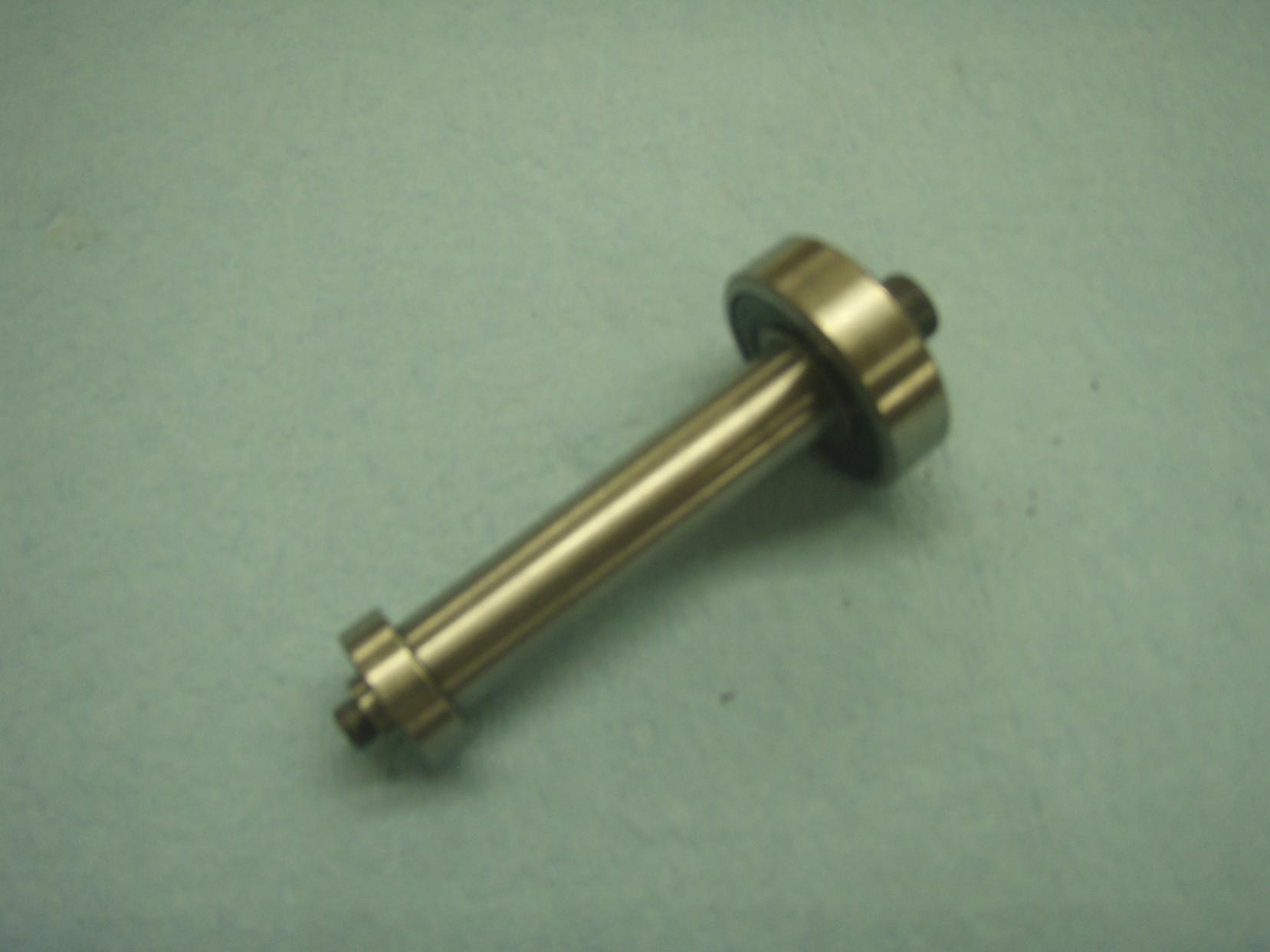

Lathe Workpiece Alignment tool. Lightly hold the workpiece in the chuck and run the bearing up against
the workpiece. Apply enough pressure until the workpiece runs true. Great for small/short pieces.
