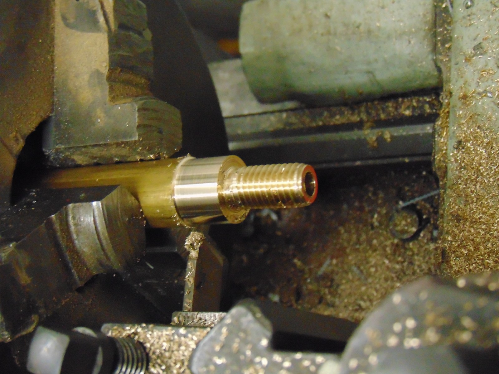

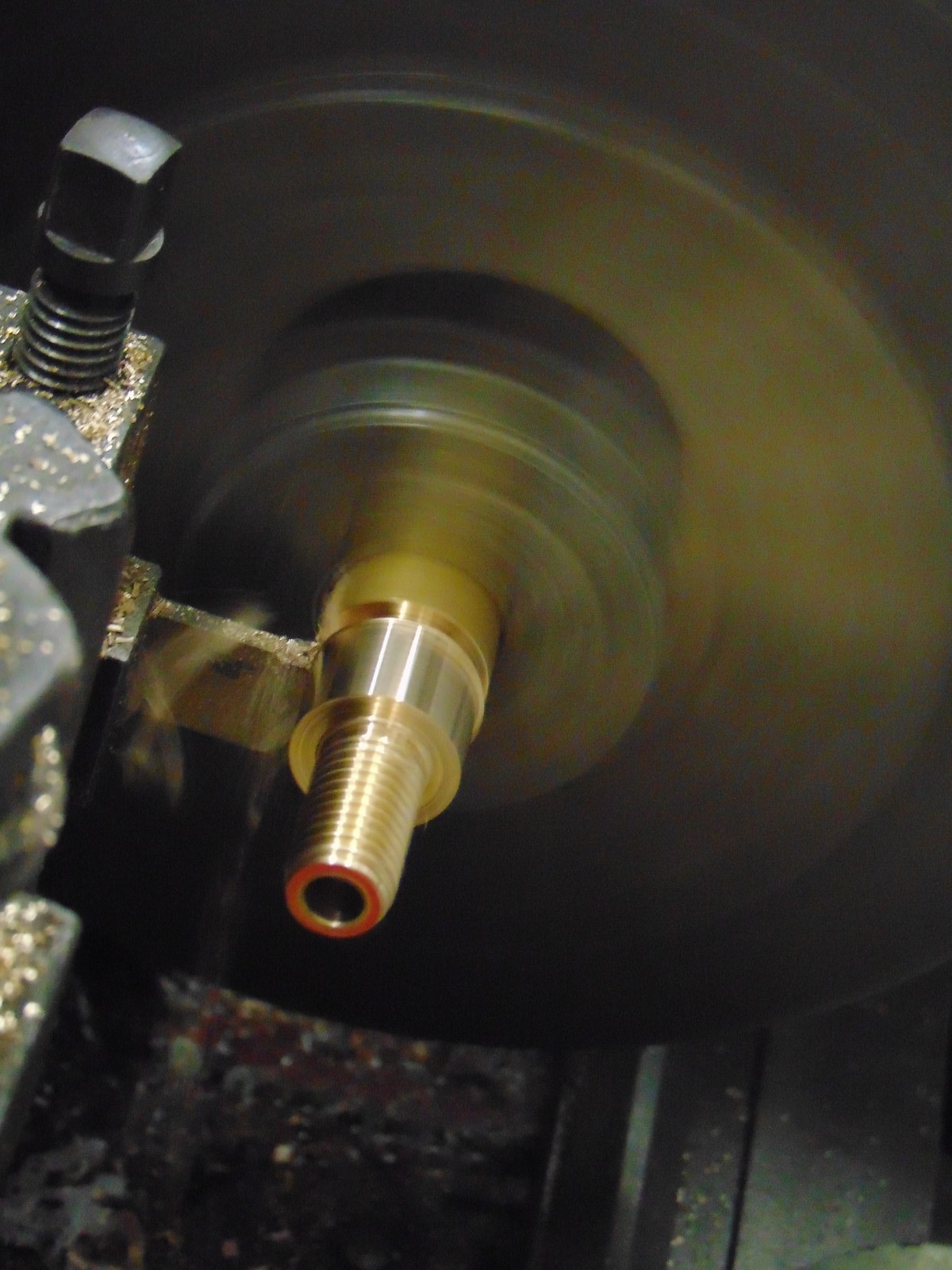

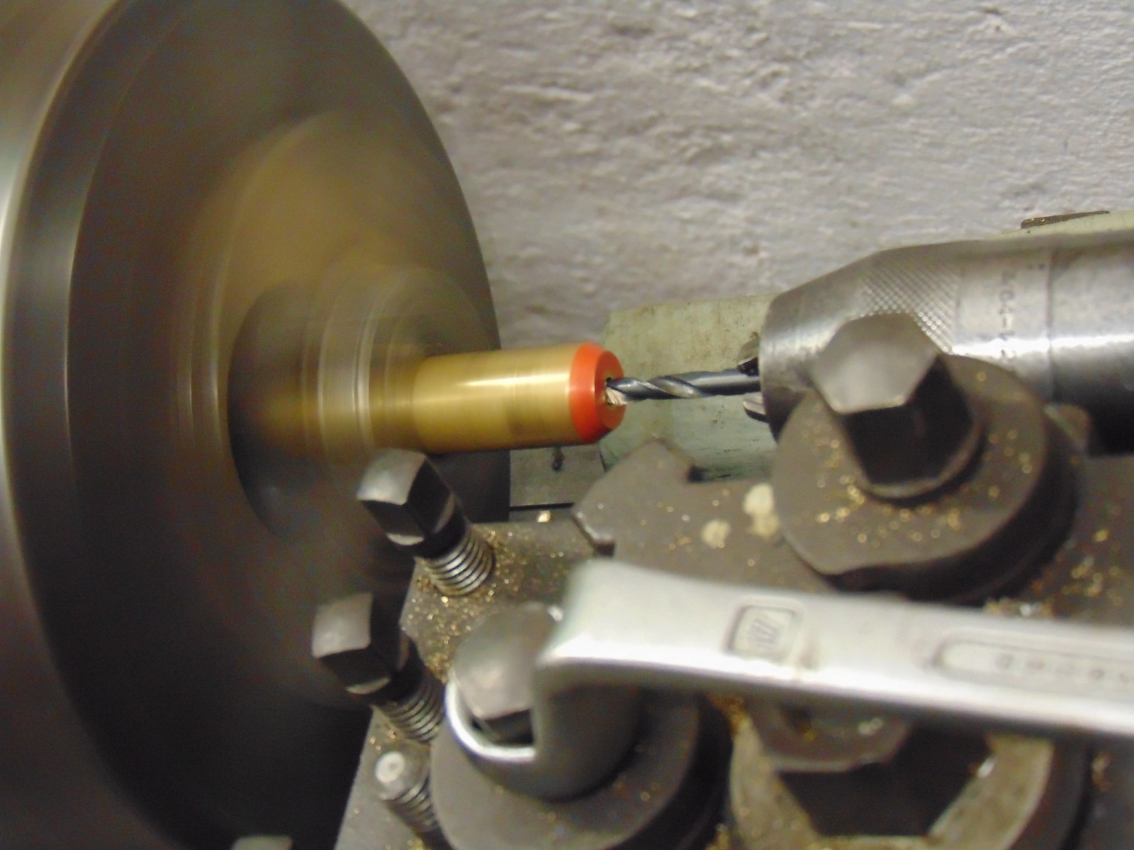

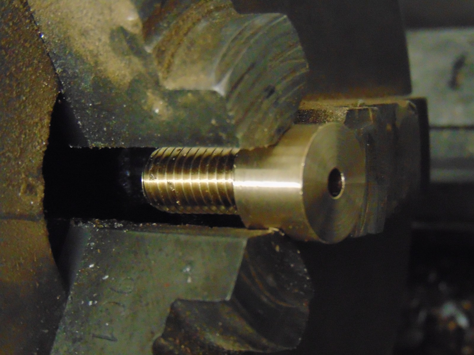

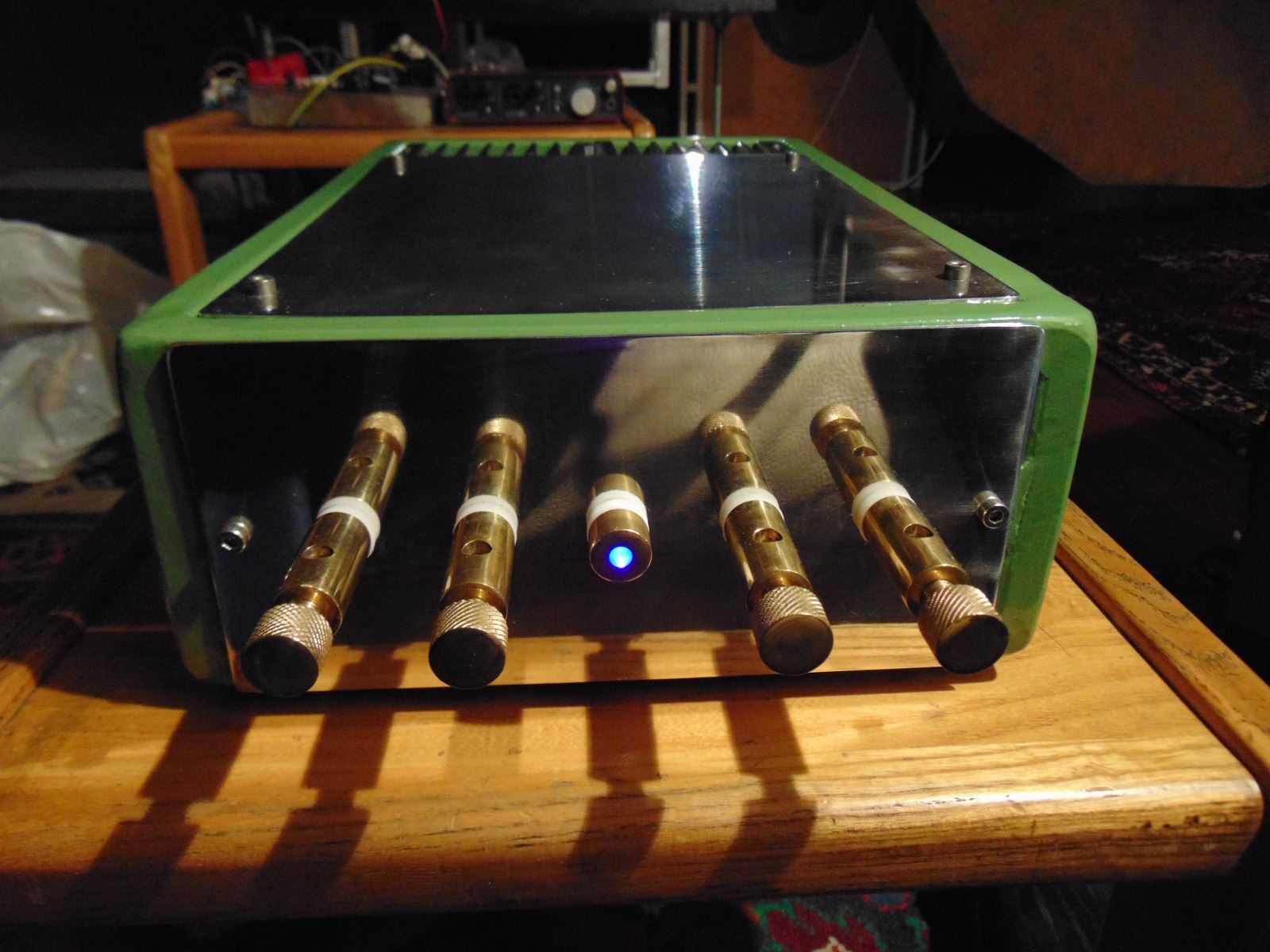

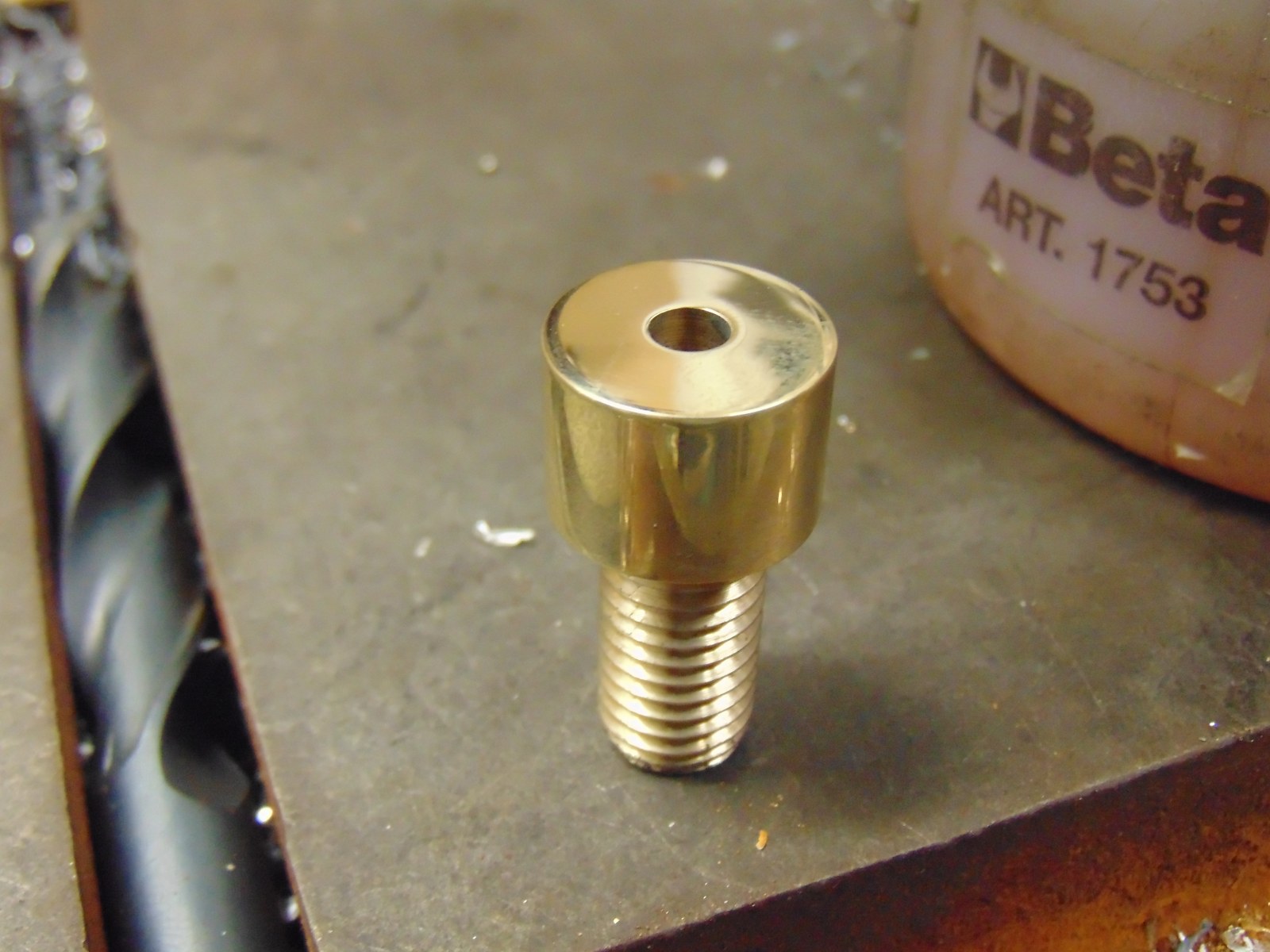

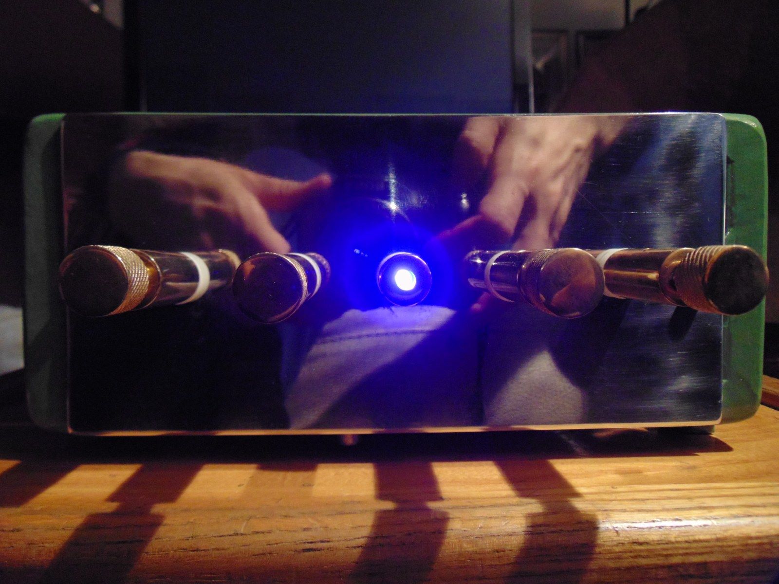

Hi all!

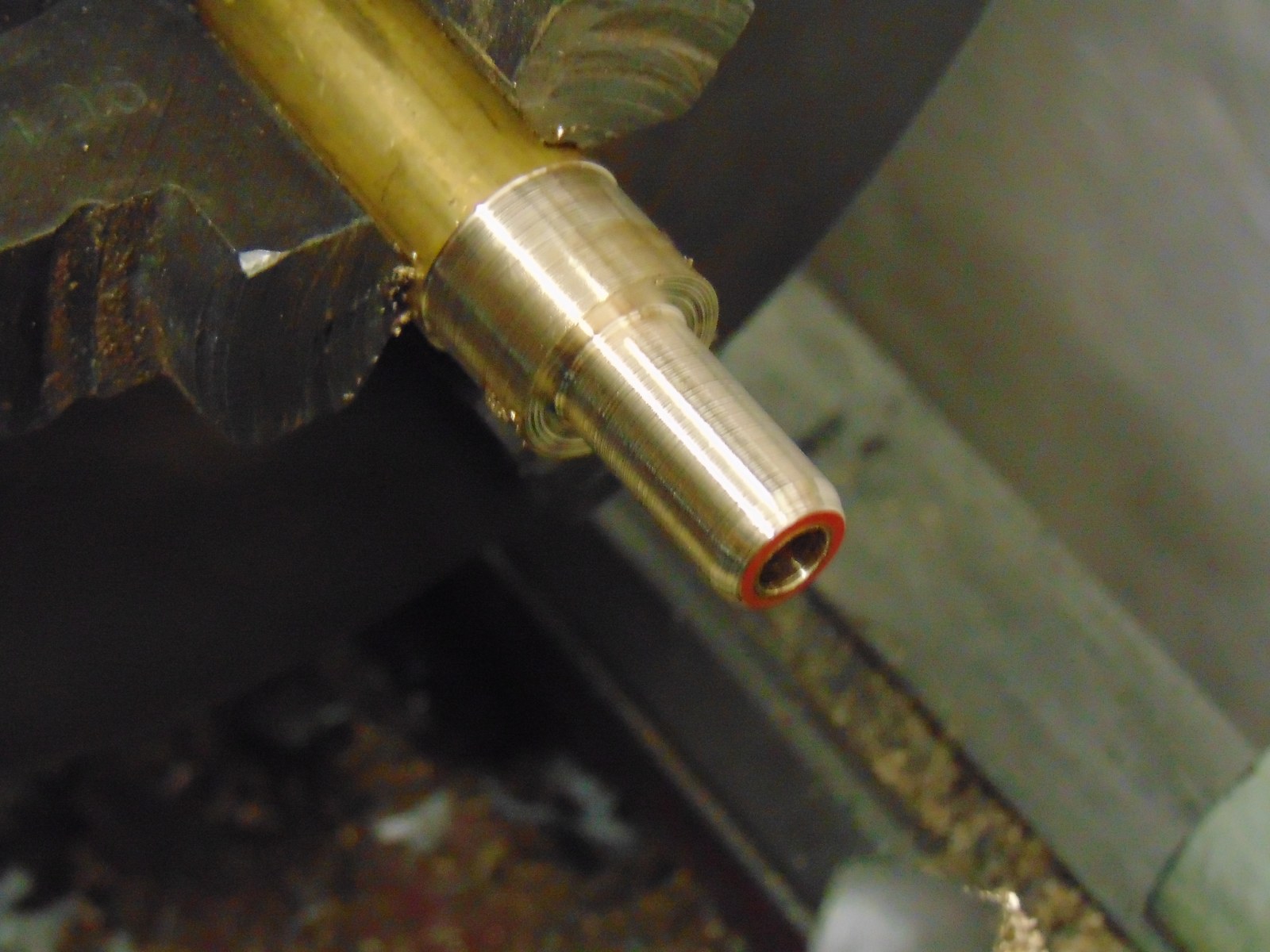

I built with a friend a second version of Led holder.
i will use on my new amplifier for ESL headphone, I also have to build one for my milling machine, as main voltage indicator.

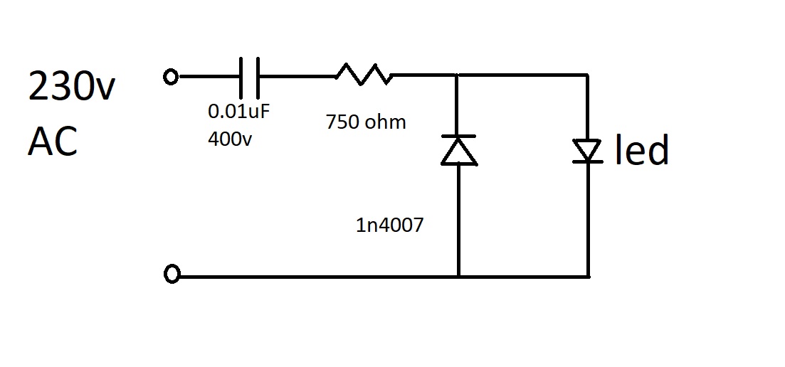

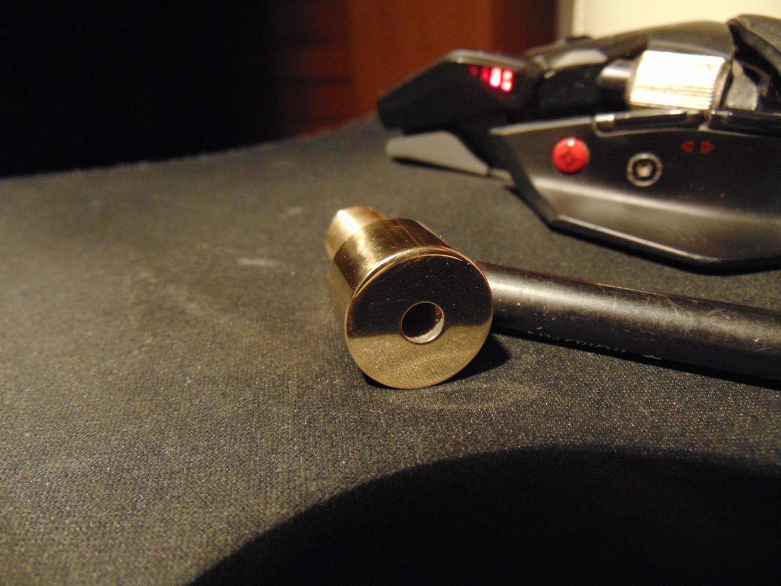

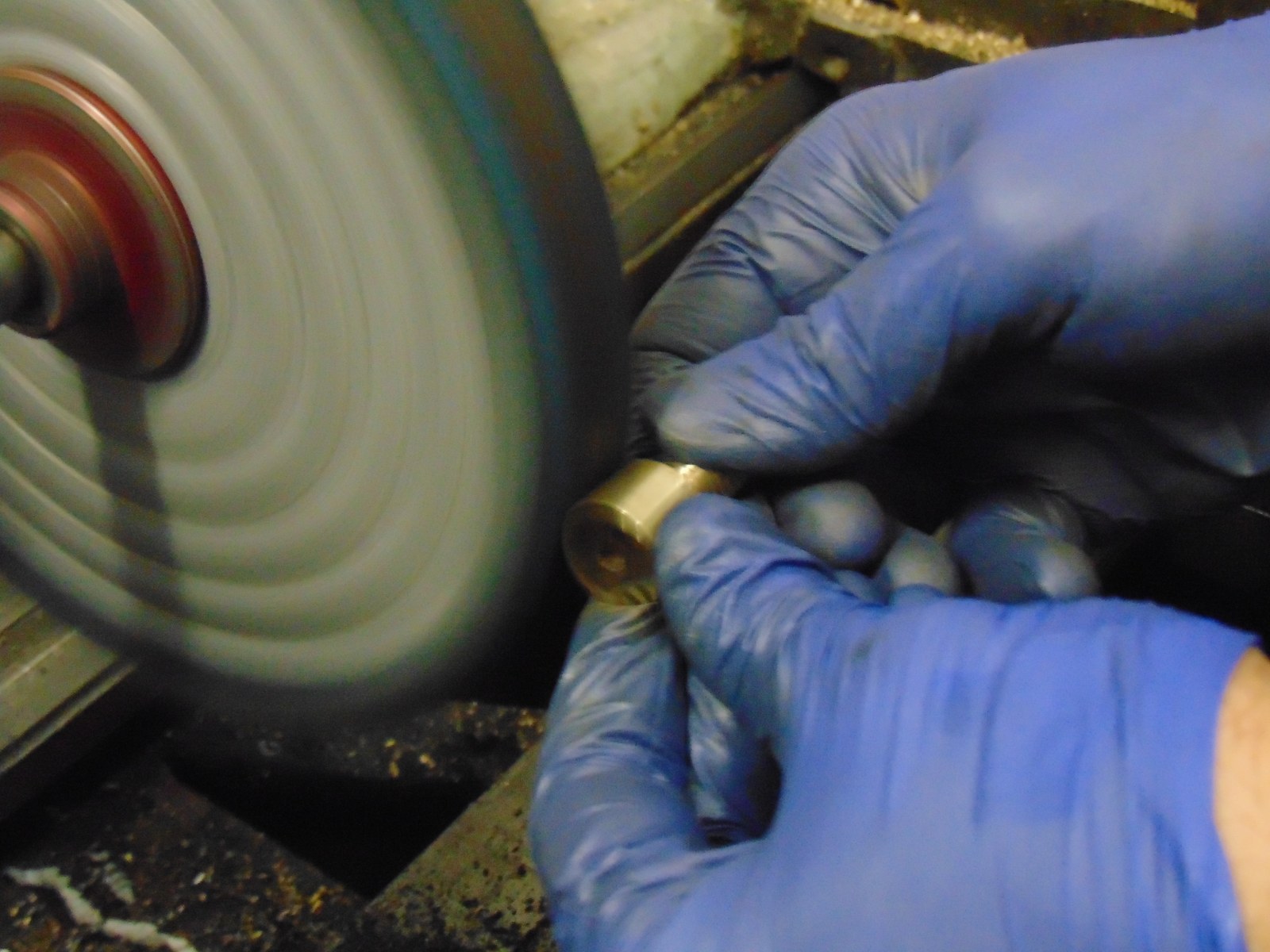

i used solid brass, hand polished with M12 thread, 19mm dia, useful for ultrabright 6mm unit, connected to 230v single phase with cap-diode-resistor.
Heavy and shiny, as I like. I decided to make it big because the new Esl power unit will have only the headphone connector in the right position of front panel, I needed something to balance.
Attachment 23968 Attachment 23969 Attachment 23970
Attachment 23971 Attachment 23972 Attachment 23973
Attachment 23974 Attachment 23975
