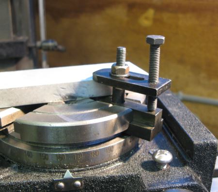

Longer T-Nuts
I find that it is difficult to even use the full diameter of the table and so I've made longer T-nuts
Attachment 22528
The benefit is the support studs for the clamps can then be positioned outside the diameter of the table, gaining precious mm.
Full article on these: Longer T-nuts – Warco HV4 4″ / 100mm Rotary Table – glue-it.com
Double T nuts are very handy for just that I've had some that I've made for years
http://www.homemadetools.net/forum/d...6086#post65895
Great idea :hattip:
What timing, I've just started making my own set of T nuts for the first time. My mill table isn't very deep, so some extra long would be very handy to have around. Thank you very much for providing the inspiration :)
https://i.loli.net/2018/03/04/5a9b44cb8c4fb.jpg
The thing to be careful about is over stressing the "T" slots very easy to do with extended "T" nuts
