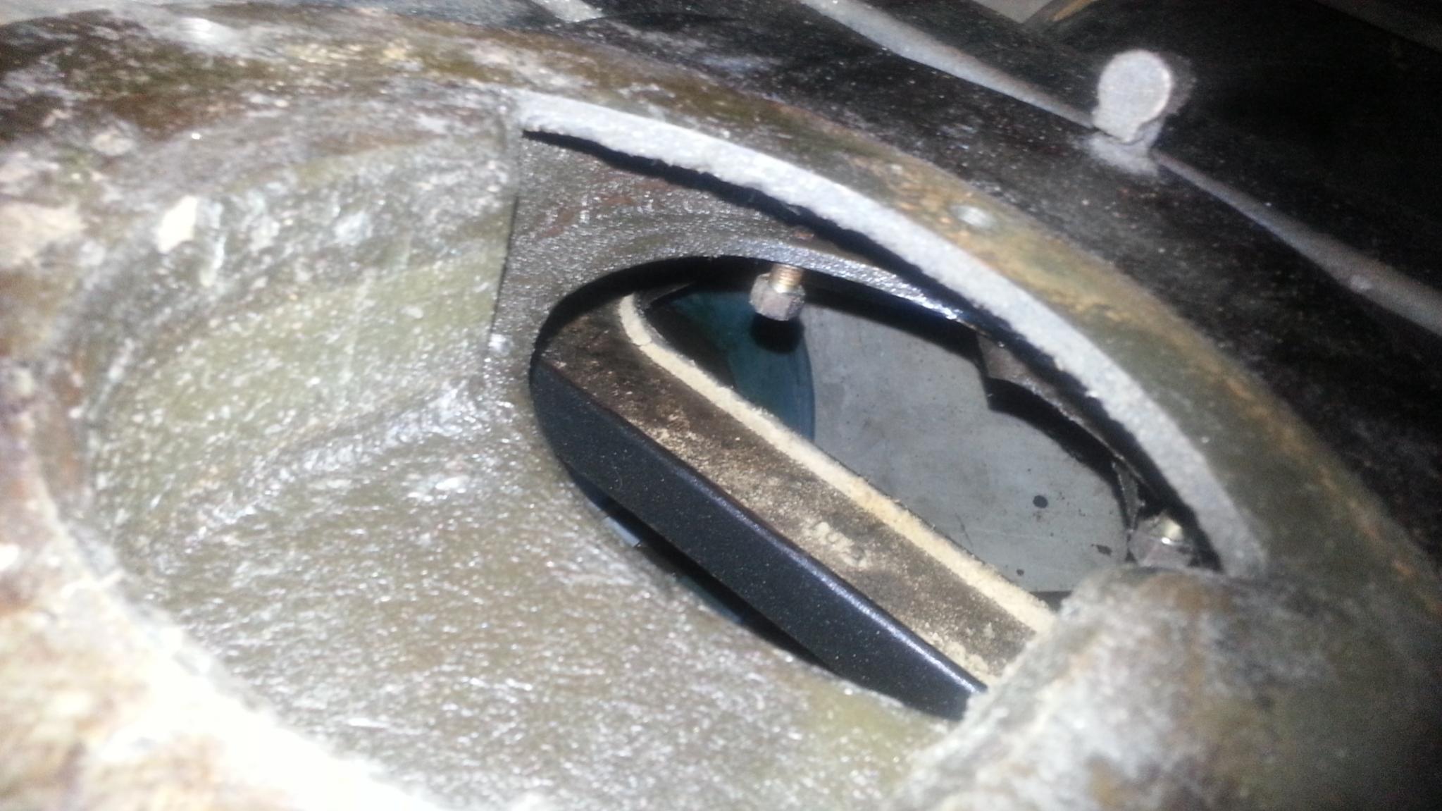

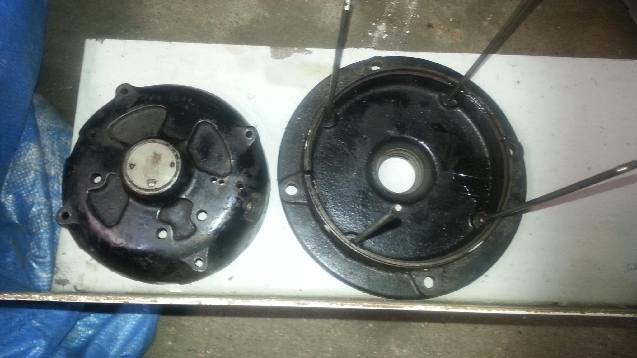

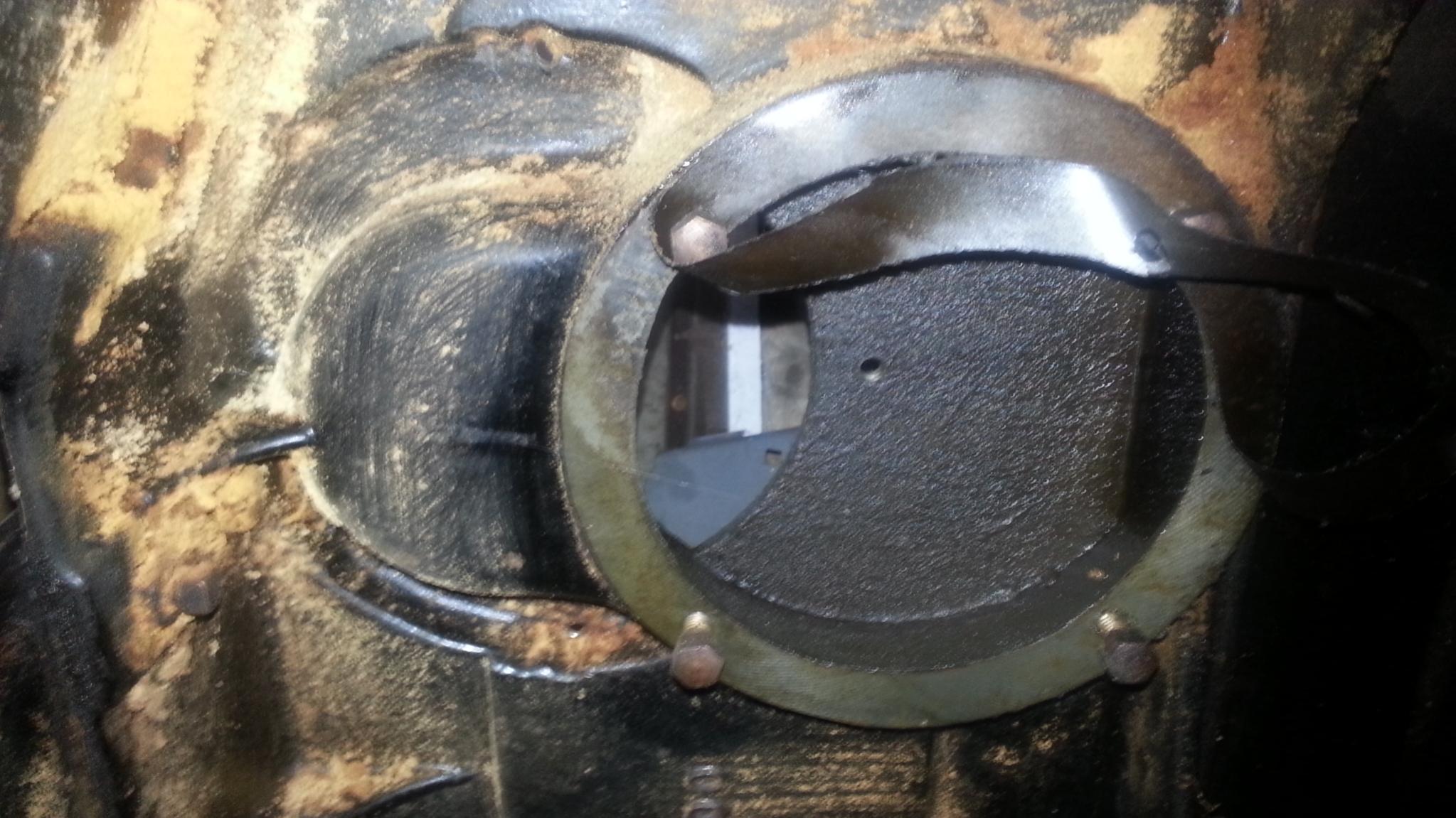

Here are some shots of the ( I think these sections really are original) original motors housing ends. No good mounting points that I trust at least. I am thinking about drilling 4 holes in the section that bolts to the machine body. the holes would be concealed, and would leave room for mounting plates and or some adjustable hardware. then I could use "L" brackets to mount to the sides of the treadmill motor.
That photo has some ⅛ galvanized mild steel sheet that I am thinking about making the mounting plates from. it won't be fun cleaning the zinc/paint coating but it should work and is the thickest steel I have around. I have some exhaust tubing that I could make a sleeve for the treadmill motor to weld some triangle braces to supplement the "L" brackets.

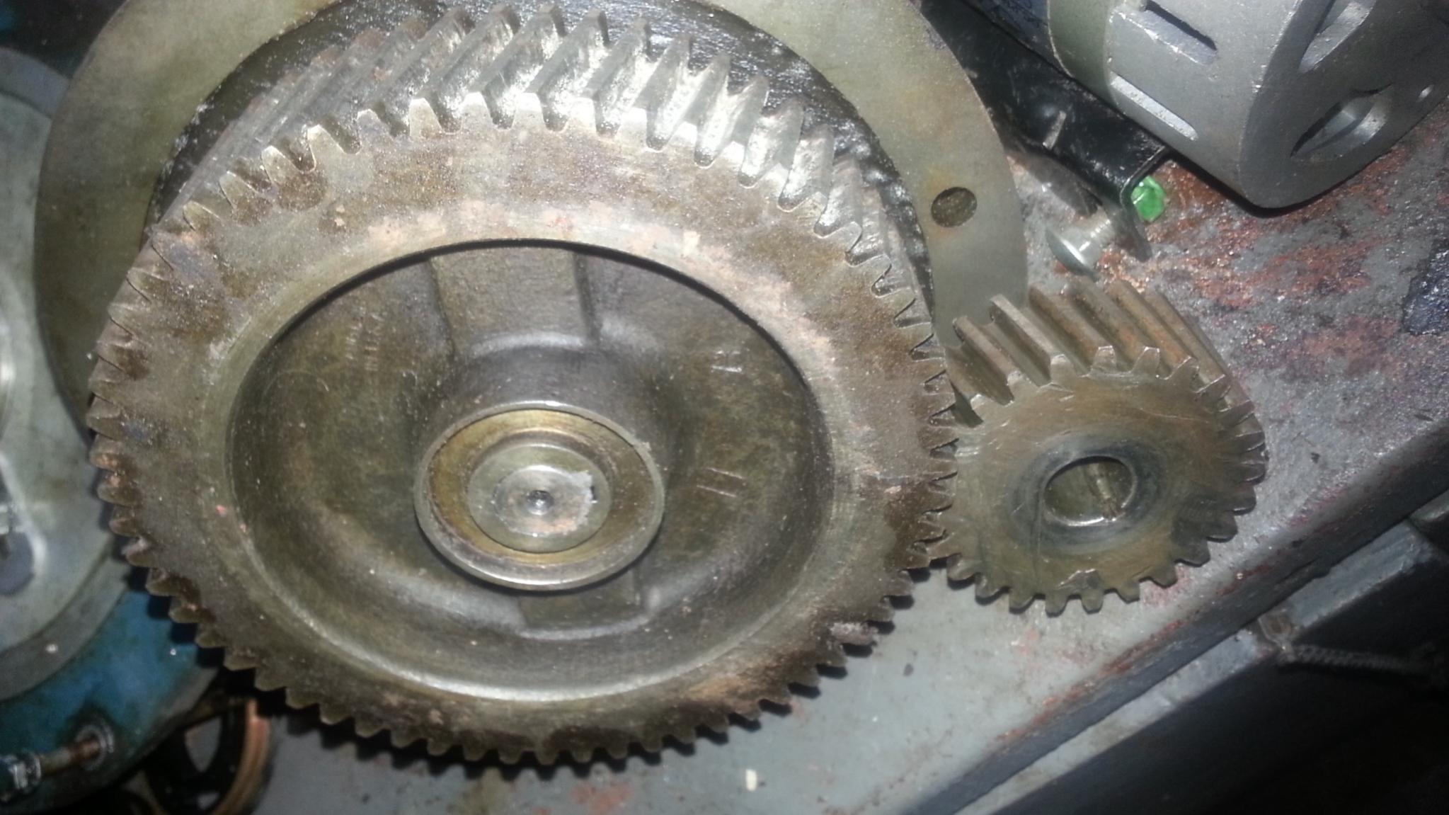

here are the 2 gears and the section they spin in. the gear housing has an oil bath. the opposing side of the motor is where the larger gear, lower bandsaw wheel and bearing case mount. ( sorry not much room to get the best photos)

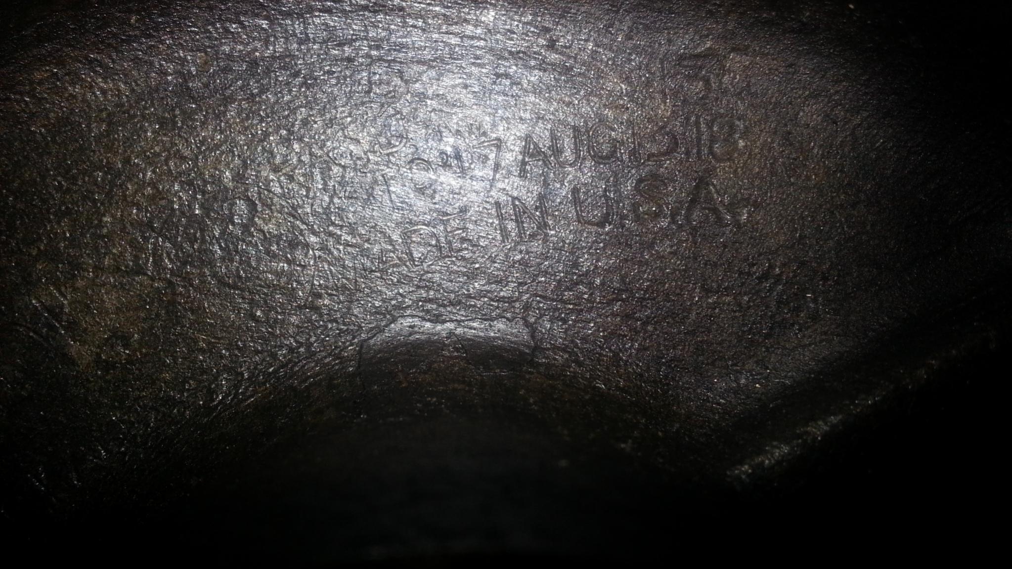

I found a date stamp on the larger gear "Aug,13,18" with a pat date in 1917. it's the only date I have found yet on the machine.
