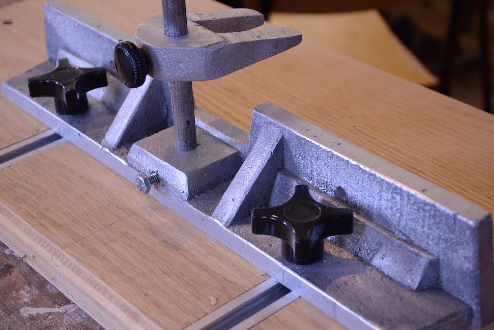

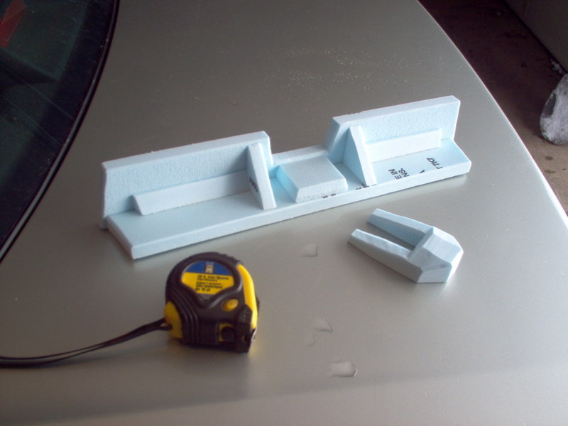

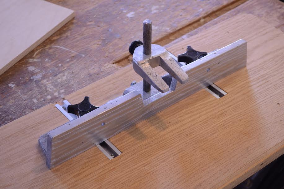

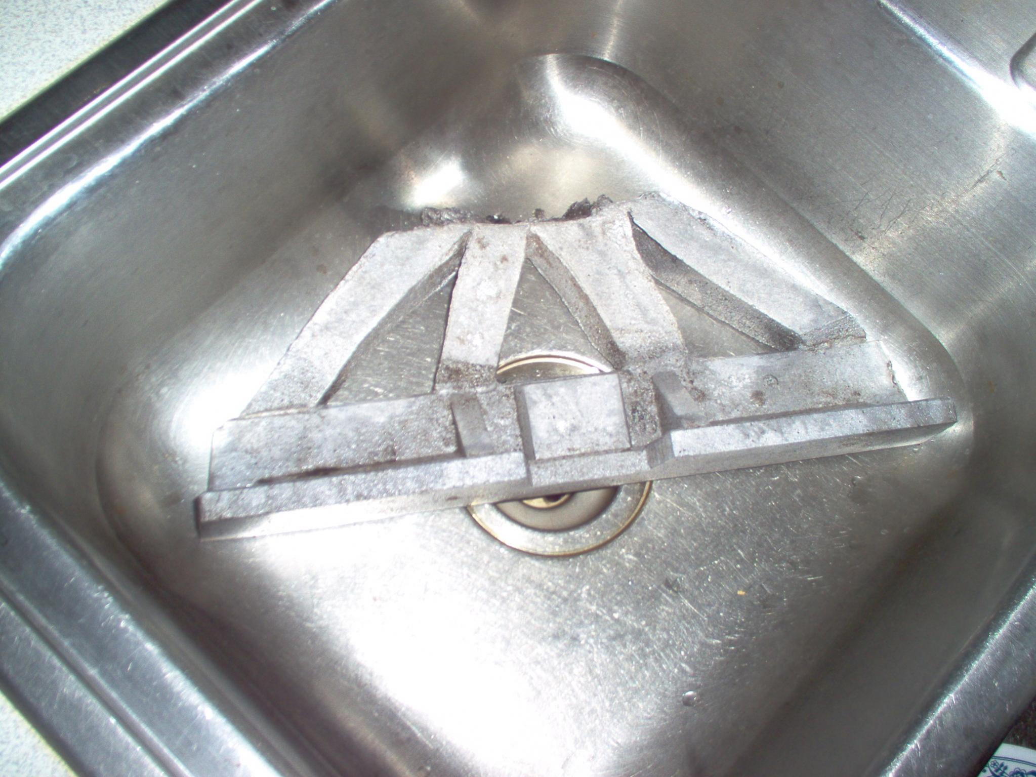

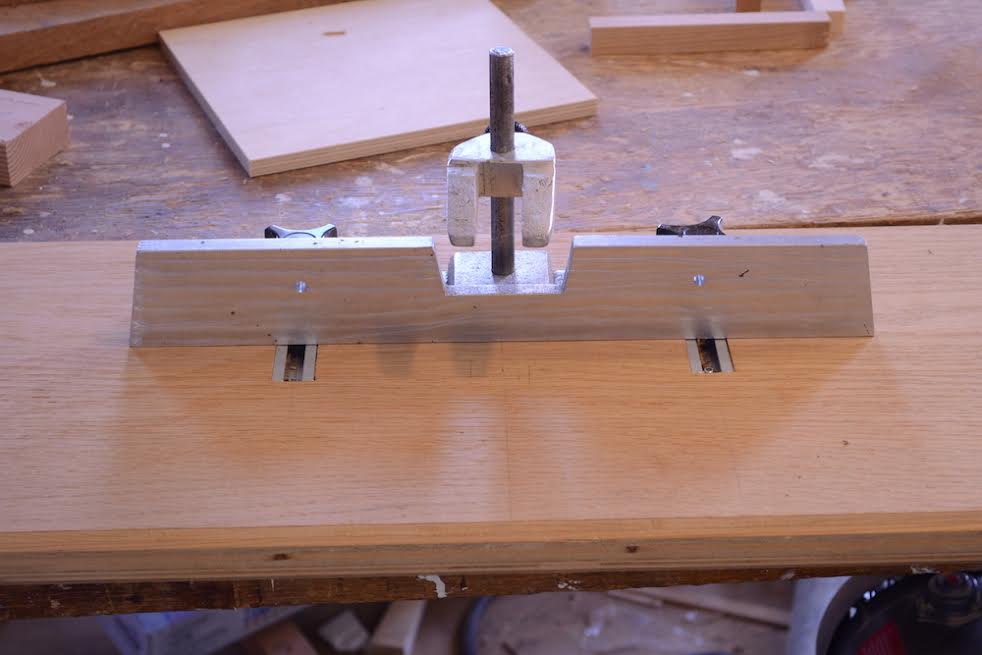

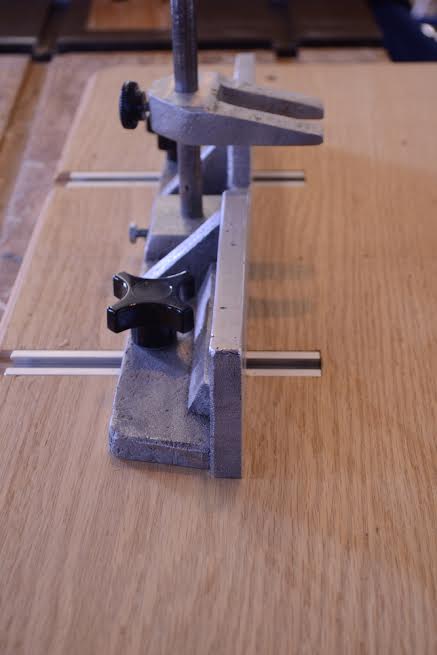

    Lost foam casting for mortising fence-im000928.jpgI promised this mortising fence earlier and here is the rough casting in our kitchen sink of course.
    The blue item is the Styrofoam pattern for the lost foam process.
    BobLost foam casting for mortising fence-unnamed-1-.jpgLost foam casting for mortising fence-unnamed-3-.jpgLost foam casting for mortising fence-unnamed.jpgLost foam casting for mortising fence-unnamed-1-.jpg
