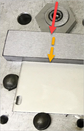

    ok, maybe I need to start at base principles. I mistook the rail for the part. And now I see the dowel pins which are acting as fixed stops. So dumb question, if the hex is acting on the rail with clamping pressure by screwing in the eccentric, could you not just as well clamp directly against the part? Maybe this example is illustrating thin stock, but I mean just in principle?

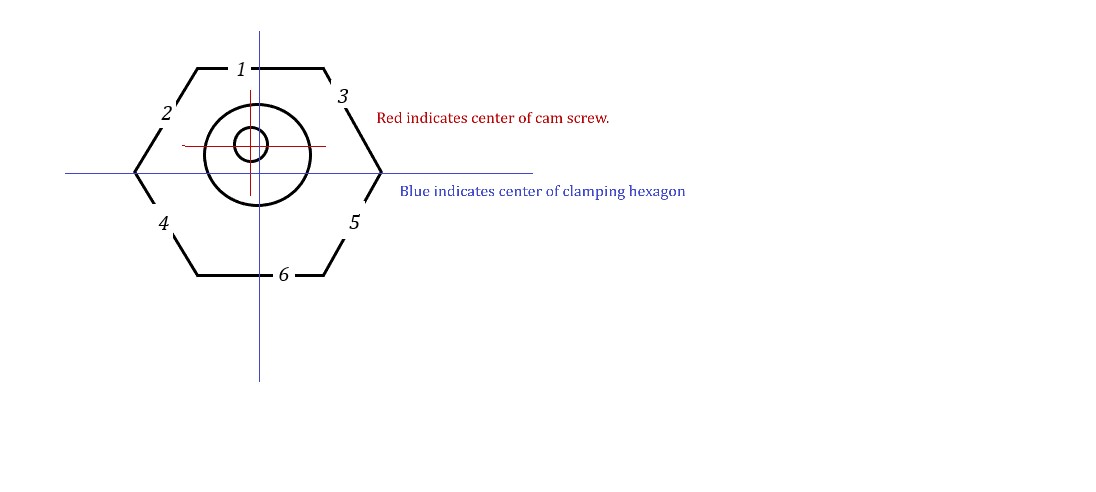

    Likely thehomeengineer and I will both agree generating low profile lateral motion is akin to how a vise works. If, by "clamping against the part" you mean to push a clamp against the workpiece with a thumb while clamping, will have only a fraction the mechanical advantage a cam produces.
    By selecting the 'correct' face of the hexagon, maximum force will be near the clockwise apex of cam rotation. At least one face might not contact at all, probably one or two won't allow enough rotation to let cam turn sufficiently.
    So in principle, just pushing would register location effectively, minus effective clamping. The sketch might illustrate this better than a mere description.
    Low level edge clamps-low_profile_clamp.jpg [click on this to view at size]
    Numbered sides simulate increased amount off center from cam screw center to edges of hexagon. Turning the screw [which is press fit in cam] causes shift in position of hexagon, both toward and away from intended clamp surface. One of the faces will press heaviest on workpiece when screw+cam rotate in the bore of hexagon.
    Quick action like this is used in production vises; using a screw to approach size, a cam to actuate clamp action. Only the cam needs to be opened and closed to exchange parts.

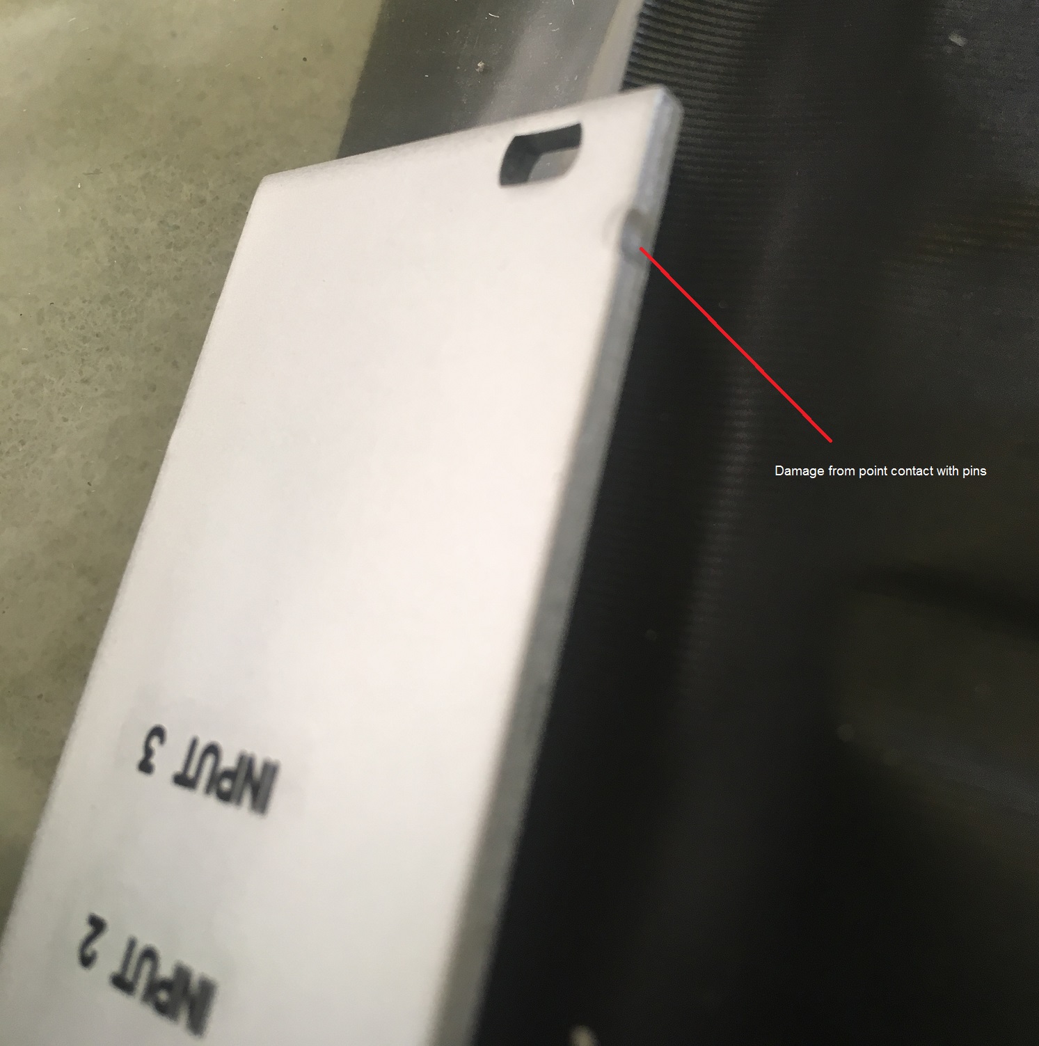

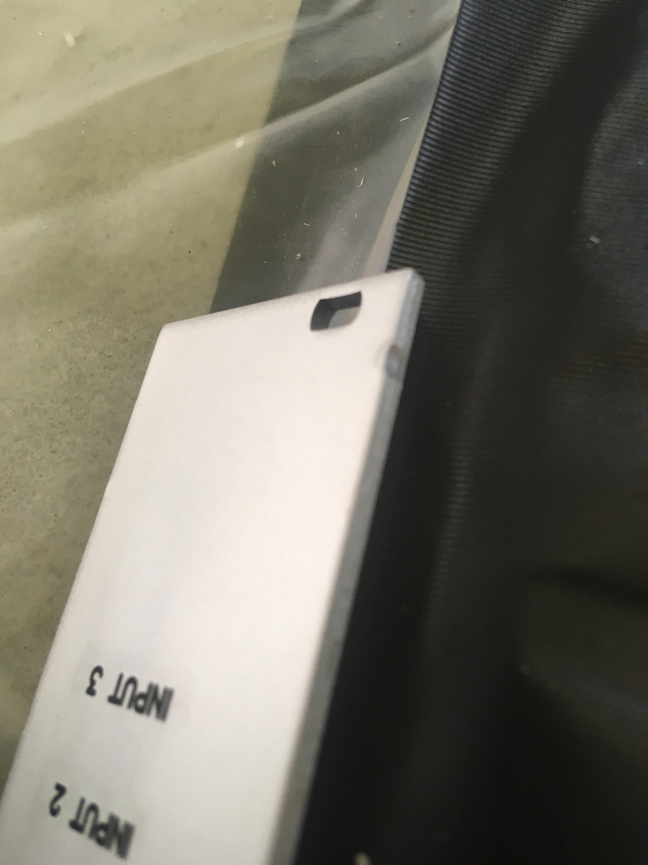

    I was teaching last night so did not get a chance to reply to the question (sorry) but you have done a great job in explaining the clamps. These clamps like you say clamp really well, to well in fact that the point contact of the dowels against the work piece has marked the material which is unacceptable. So a second flat piece of stock will be used to prevent this damage (like toolmaker51 stated this is like a vice). Will add some photos of the setup later.

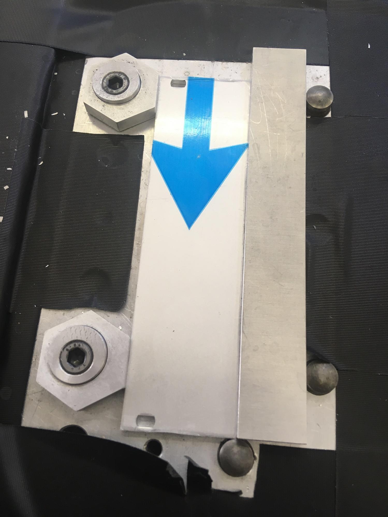

    I simply moved the flat stock to the opposite side to stop the pin damage when clamping as the Hexagon is flat anyway.
